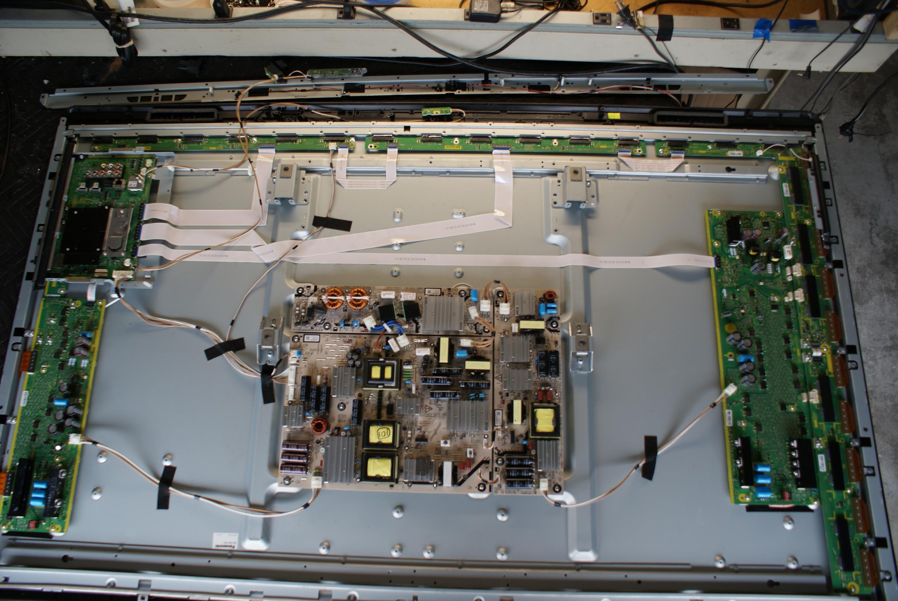

    I have a 60 inch panasonic plasma 3d hat it won't turn on. led light give 7 blink. I had check all fuse and they are good Change board ss, ss2 and main board and still soing the same.( the board i put on were used ) Any idea what can it be?

    7 blinks is SC, SU or SD. Not SS. And SS2 is a piece of copper disguised as a circuit board, really nothing on there to go wrong.

          In which case it is the A Board misdiagnosing 8 blinks, possibly. Check TP_SOS8 on SS board. There is also the possibility of it being a bad panel.

              ok, I put another a board and still doing the same, 8 blink, i went ahead and disconect the three ribbon atach and went i turn it on it no longer blink. I attach ribbon a32 and still power on no blink but went i attach ribbon a31 or a20 the led light start blinking. Any idea or the answer still the same?

                This is possibly a bad panel (detection error, not necessarily too bad to display an image.) You may be able to disable the 8 blink code to see if the picture is good. Short the TPSOS8 to ground using a 100 ohm resistor, and it should fire up, although you may see a 6 or 7 blink error.

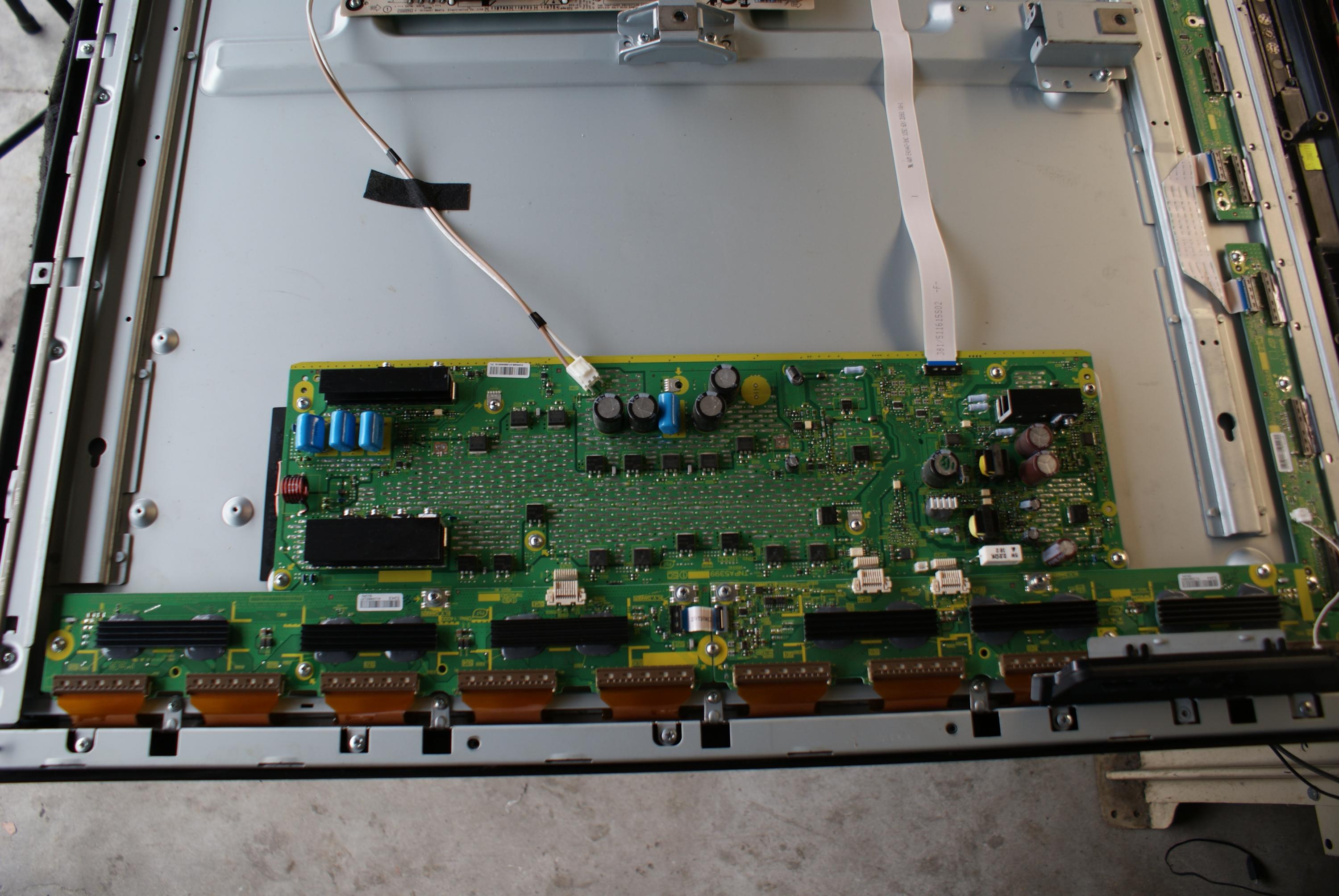

                  sorry but what do you mean when you referred to TPSOS8? IS THAT SUPPOST TO BE ON THE MAIN OR ON THE SS BOARD
                    Re: panasonic tc-p60st30 won't turn on
                    It's on the SS board near the connector going to the A board.
