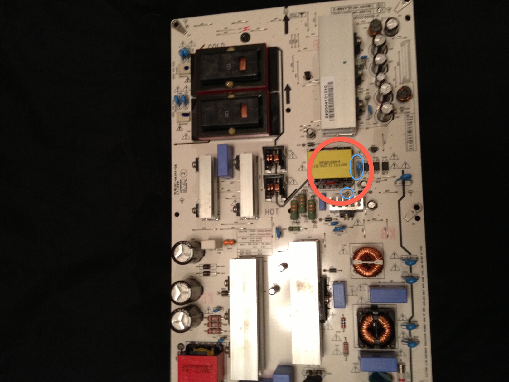

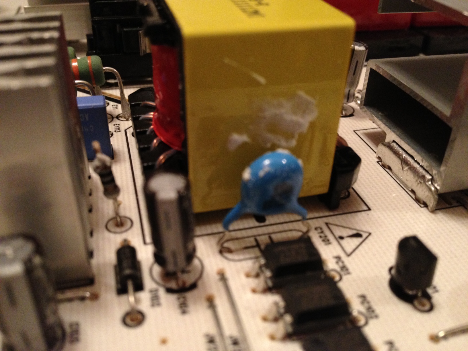

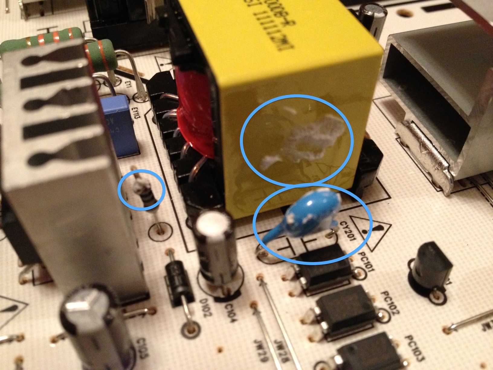

I took the boards off to do some underside checks and see if there were any bad soder points but everything looks fine no cracks or looseness. But I did see this on the PCB. Yes I know sometimes there is some white stuff on the boards but this is interesting. I see it on three different components in a certain area and two when I pushed them closer to each other it isn't tall enough to touch the other component in the same area it has white stuff. Also the resister standing strait off the board has a little bit on it also. Any explanations? I will be ordering my EEPROM tomorrow Waiting on paycheck to clear.
Meanwhile thought that was weird.
Thanks to all that are very patient with me!
Someone please circle the areas I should test further also because some of this doesn't look familiar to me.
Pics:Comment
Re: Another E470VLE with "Orange Light of Death!"
That is white elsstic glue, they use them a lot to hold the caps and small components in place during wave soldering.Never stop learning
http://www.badcaps.net/forum/showthread.php?t=24809Comment

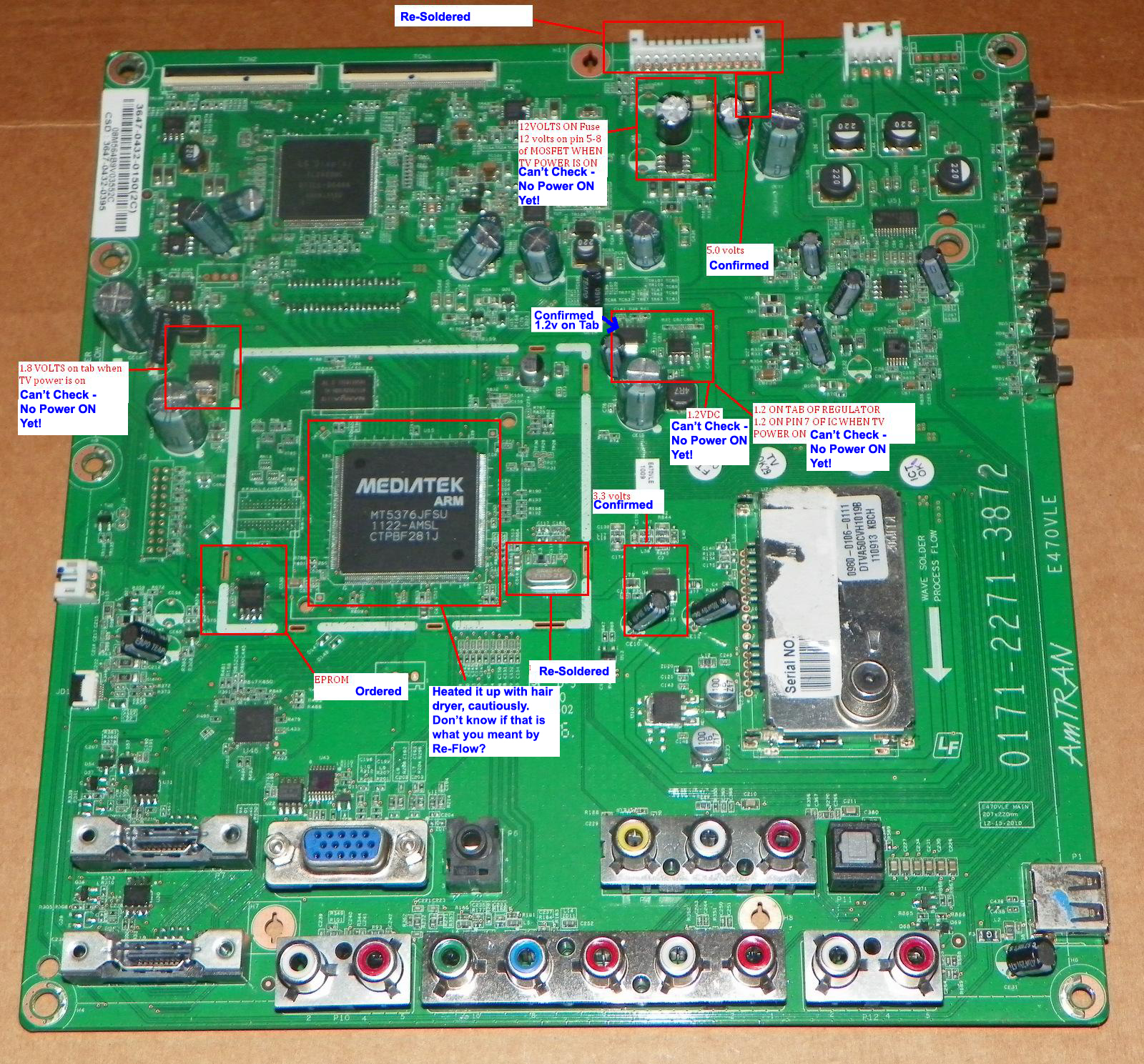

I have a working E470VLE main-board, I took measurements with the TV is in stand by and then power on.
measurement in stand by:
only U4= 3.28VDC
F1 FUSE= +5VDC
Measurement TV power on:
See picture.
The sound like an EPROM problem
hope this help
ecking767Comment

Ok checked it against mine. I get 5v at the fuse on both sides. So while waiting on the EEPROM I will re check solder points where you suggest. Since I cannont check any connections that would have voltage with tv on.Comment
you didn't check U4? Its a 3.3 volt regulatorComment

* Update: With ecking767's Picture I measured 3.3v on U4 Tab and 1.2v from the tab directly north of U4. Still no sign of the new EEPROM yet...Comment
You didn't read my measurement correctly, I only had +5 volts on the fuse and 3.3 volts on U4 regulator. all other regulators became active when the TV power is on.
I will reconfirm my measurements laterComment
I didn't test the 8 legged IC next to the north chip, because I cant get the tv on. Stuck in what appears to be stand by. See Attached!Last edited by Venomhatch; 01-22-2013, 04:10 PM.Comment
