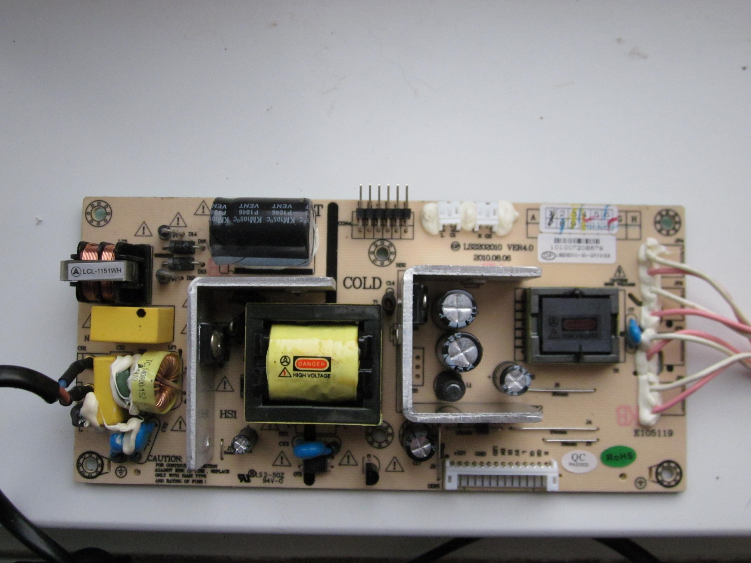

    morning guys just picked one of these up still in the box looks great condition but the sets dead as in no led on the front so far i have tested both fuses ok disconnected the very small power board and tested output volages as per board spec none present except the 240 volts ac in i have now noticed a regular ticking noise about every 1 second coming from the yellow transformer between the hot and cold side i have checked the diodes for shorts none seem present at all can you advise me next step on trouble shooting please let me know the meter settings you want the items tested on the power board is a LS2202010 ver 4.0
    same board as this shows you the specs etc cheers vince

    Does it tick with nothing connected?
    Suspect startup cap or Vcc winding diode.
      Re: Bush btv d91216b dead
      yes it does tom i have took this small power board out so i can test it. with nothing connected ticks away lol all capxon caps start up looks 22.uf 50v will go and look for one now pity i still dont have a esr meter yet but have got a capacitor tester just does not give esr which diode is the winding diode?

            Also measure voltage across startup cap and let us know what PWM controller IC it uses.
              will do your tests in a while (visitors just turned up with a faulty wii they have worked on lol want me to look at it whilst they wait lol) tom what pwm controller ic can you point out in the pic for me ? selldoor will also do your test cheers guys.

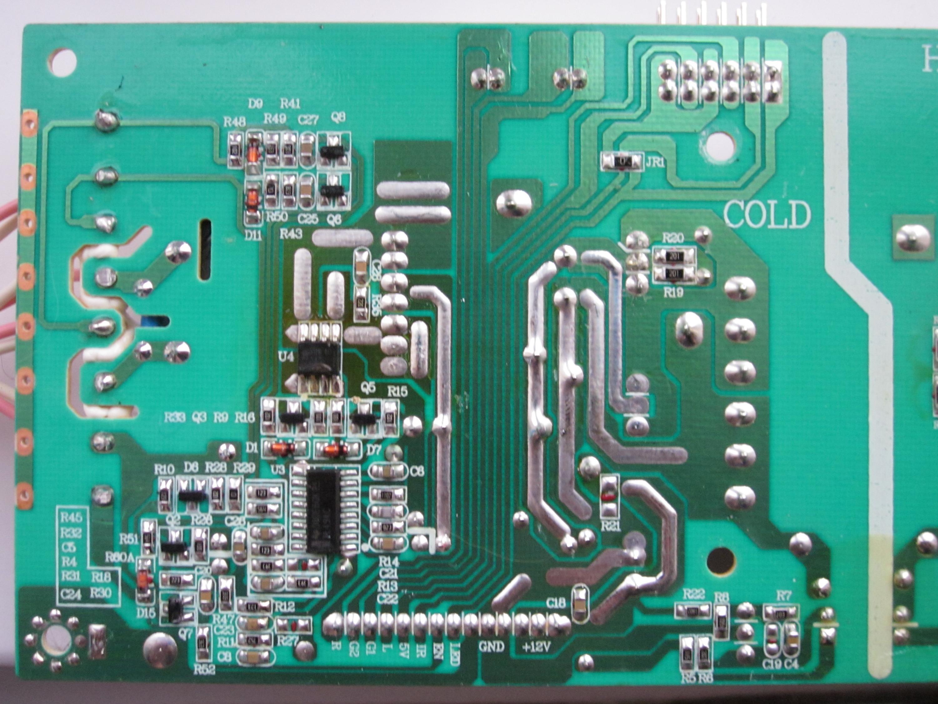

                Its the 16 legged Ic on the back= U3
                  Possibly not... may be U1... looks like one of those "tiny switchers" from STMicro.

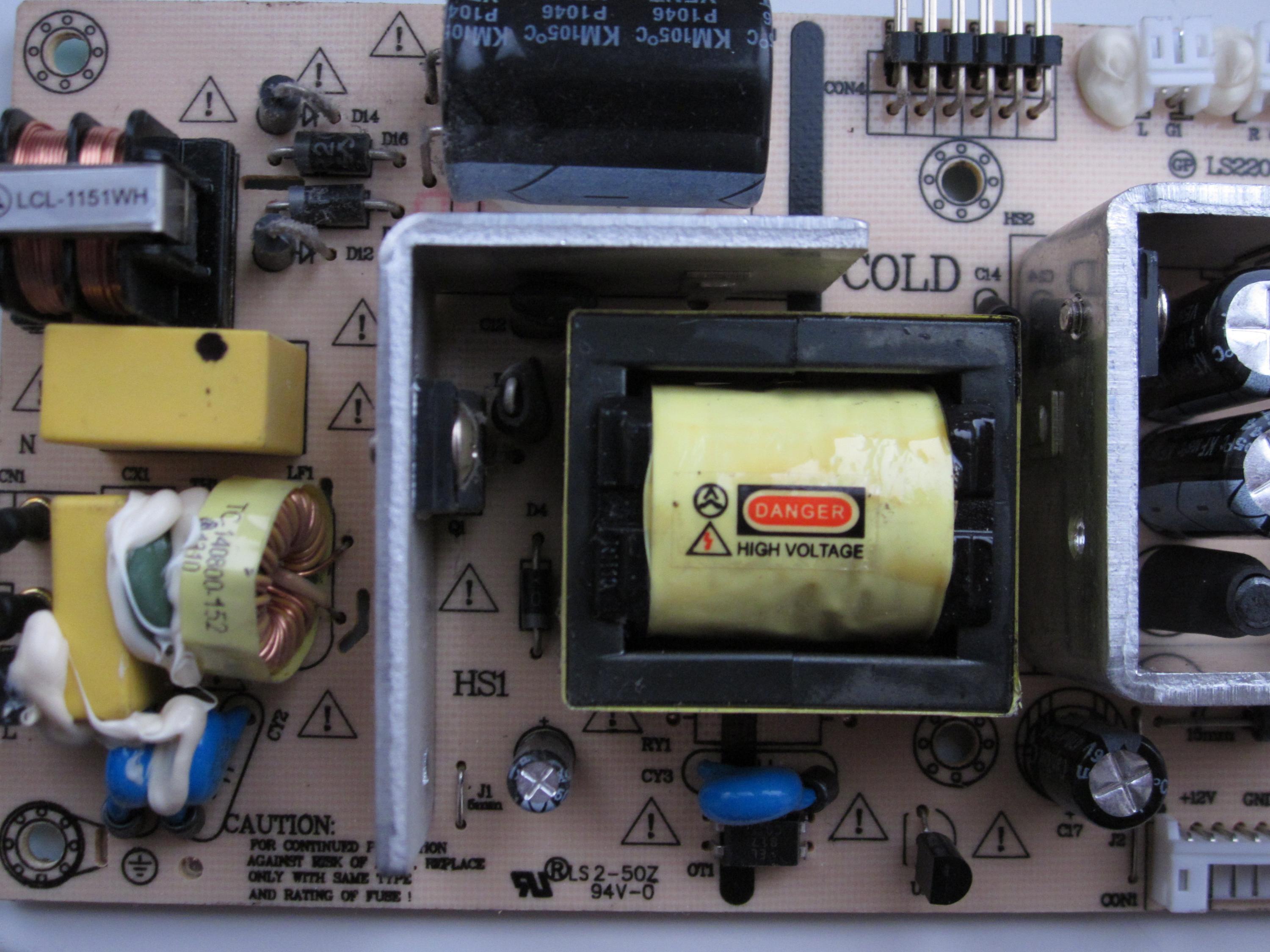

                    just a question i have had to put this back together for now as i need a set of new multi meter leads (have a break in the wire somewhere lol) so will do more testing shortly but what i did notice that i thought one last time i would try to see if it would turn on and guess what red standby light came on flashed 4 times then snow and no signal screen so i thought i would turn it of and try again would not switch on. start up cap replaced with a new one. but by the mains wire going on to the circuit board there's a yellow oblong cap (the one with white glue on it) it also looks slightly discolored and maybe a little bulged at the board end? could this capacitor cause this issue? seems to go across the live and neutral wires. it seems it will turn on but very intermittently the person i got it from of free cycle said before it stopped working it had a sound hiss problem? never mentioned it never turned on.

                          u1 primary side 6 legs looks like jk1 with a small 35 top right of chip
                          u3 16 leg ic looks like 08de60k tl494c

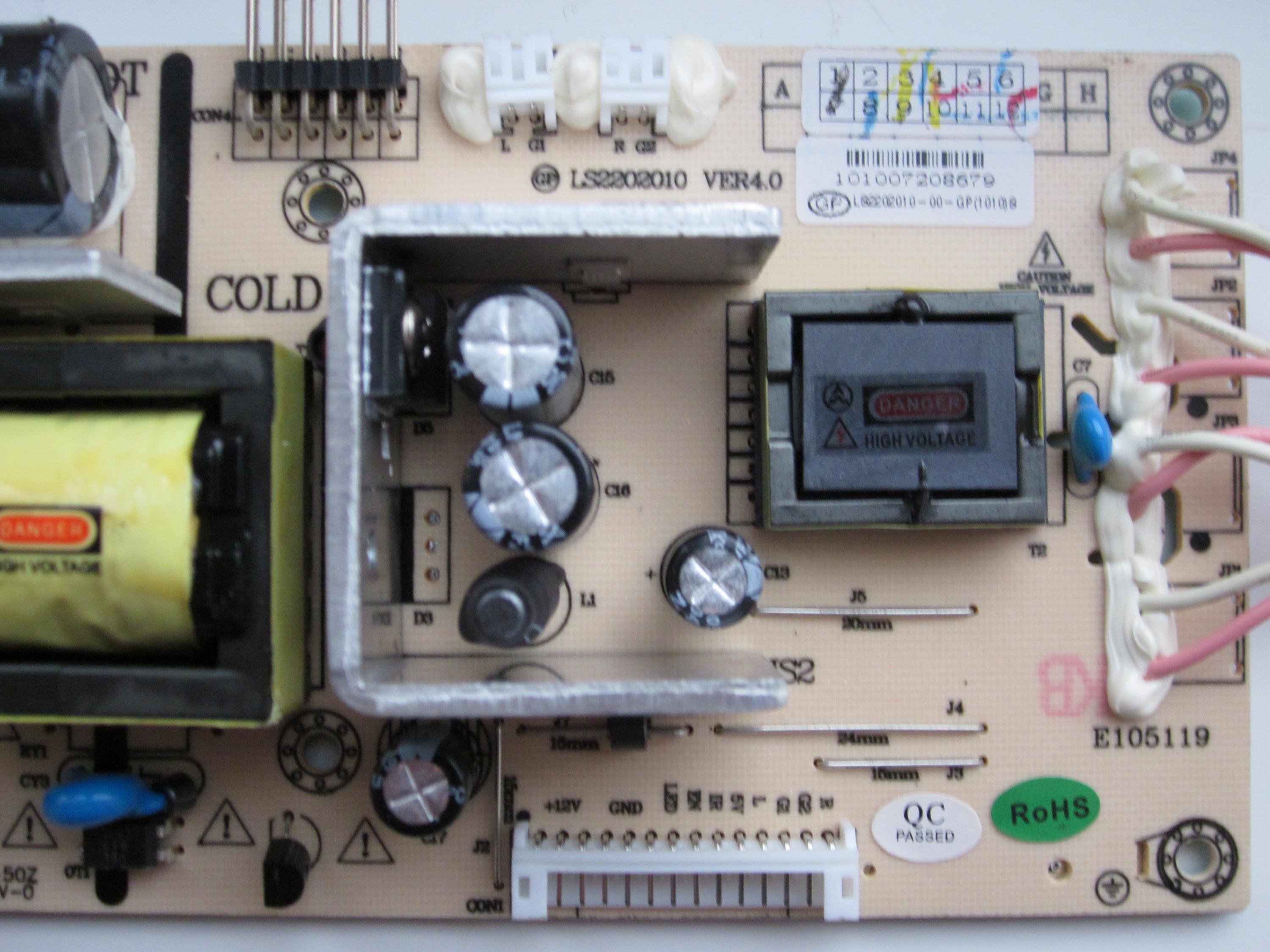

                                a question i cant seem to find any manuals on line etc do you think the sound crackling issue could also be a power supply fault as the speaker connections are also on the small psu board. tom did you still want me to test vcc on the tl494c? pin 12 i think it is the cfls are working great thought the couple of times the set has fired up a odd one also seems to come on if left for a good few hours will turn on once then thats it?. still think its a power board issue?

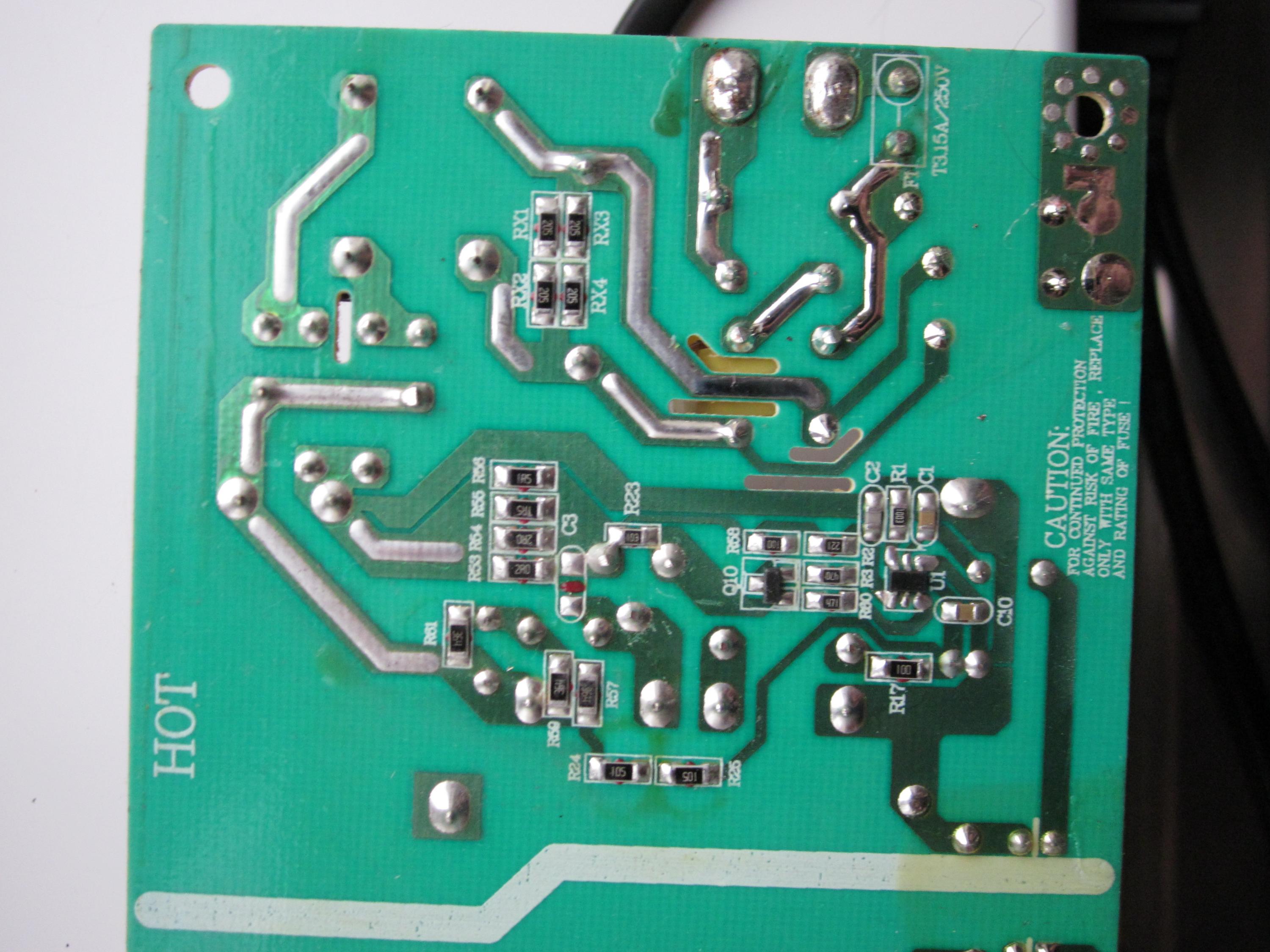

                                  Test Vcc on the 6-pin controller IC on the primary, that IC is the source of all our power! (Or, at least all the TV's power.) If it's unstable you could hear crackling from the speakers.
                                    its hard to read the id of it i can see the round indent on the corner the writing looks like square white box with a j in it then K1 WITH A SMALL 35 OR 36 in the top corner not sure which which pin is which this little 6 pin ic is about 3mm or 4mm so very hard to read anything on it.
                                      Close up picture of it ?
                                        used the otherhalfs glasses decently says j in a whie box then k1 then a realy small 35
