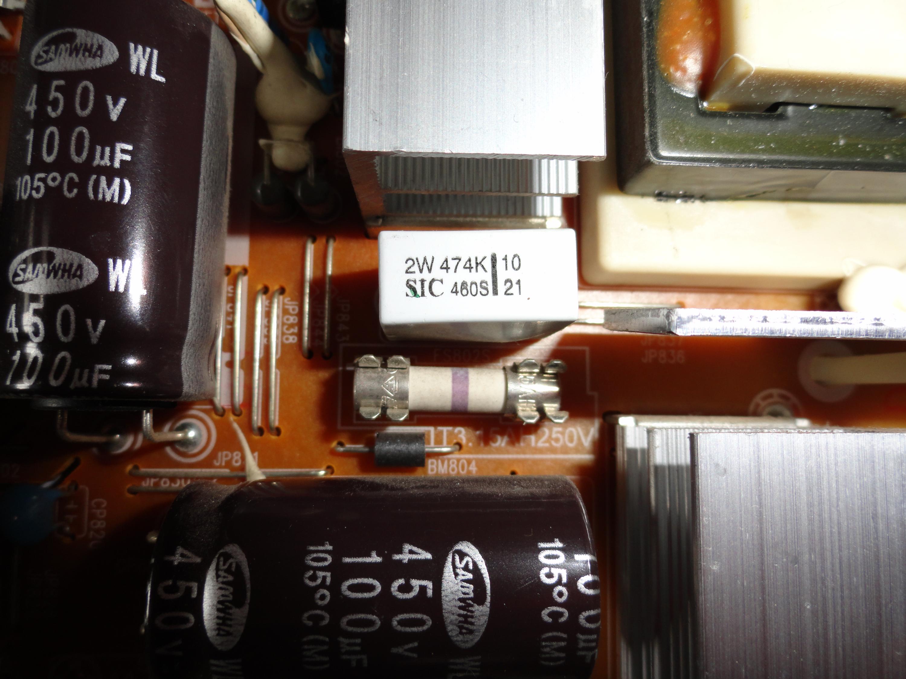

    Hi everyone, i have a Samsung 46ln46c610. I lost picture on it, but still have the sound. I narrowed it down to the power inverter board. from there i narrowed it down to a capacitor(i think). it is a little gray rectangle that says, 2w 474k. below that it says sic 460s. after both of those, there is a line and then the number 10, over the number 21. i have found that it is labeled cl818 on the board. this is the same amongst other Samsung boards. i found another board not from my tv that had same part labeled under the cl818. reading through the threads i found someone who found the part number as C-AL;1uF,20%,250V,GP,TP,6.3x11,5. where can i find this part!!!!! mouser and digikeydid not have it nor did any of the usual suspects. my feelings are repair shops have to be able to get this right? i have included a picture of it. thanks, Steve

                    i would unsolder it and measure the leg spacing with a small ruler you could probably do this whilst its still on the board but some of the various capacitors can hold a charge even though the sets turned off so be careful.
                      Re: samsung ln46c610
                      "i found someone who found the part number as C-AL;1uF,20%,250V,GP,TP,6.3x11,5."
                      Form the picture (474K = 0.47uf 10% tolerance) that you have posted on post1, that cap is 0.47uF not 1uF.
                      Are there any printings on the side of the cap at all? It has bulginf from the side, so it is bad cap.
                      The board looks like SAMSUNG P/N BN44-00341, not sure if Tom has the SCH for it or not.

                        thanks vinceroger69, now were starting to get somewhere. i was under the impression with the part number i would be able to find the replacement part. all i have right now is a standard measure of two cms

                            well budm, you know your Samsung boards! definitely a bn44-00341b, but no printing on the side unfortunately
                              OK, thanks to TOM sch, it is 0.47uf 450V polyester film cap.

                                thanks to budm and tom. i figured it out how to read every thing after almost an hour. I simply punched in 0.47uf 450V polyester film cap in my search engine and it pulled up element14. THIS COMPANY SELLS BOARD PARTS!!!!. MY CAPACITOR POLY FILM 0.47UF, 450V COAST .50!!!!!!!!!!!!!. i got no where with mouser and digikey. IF YOU NEED SAMSUNG POWER INVERTER BOARD PARTS, GO HERE!!!!!!. THIS WILL, AND CAN SAVE YOU $$$$ Sorry to all those tv repair places for blowing up your non actual fixing racket!!!!!!
