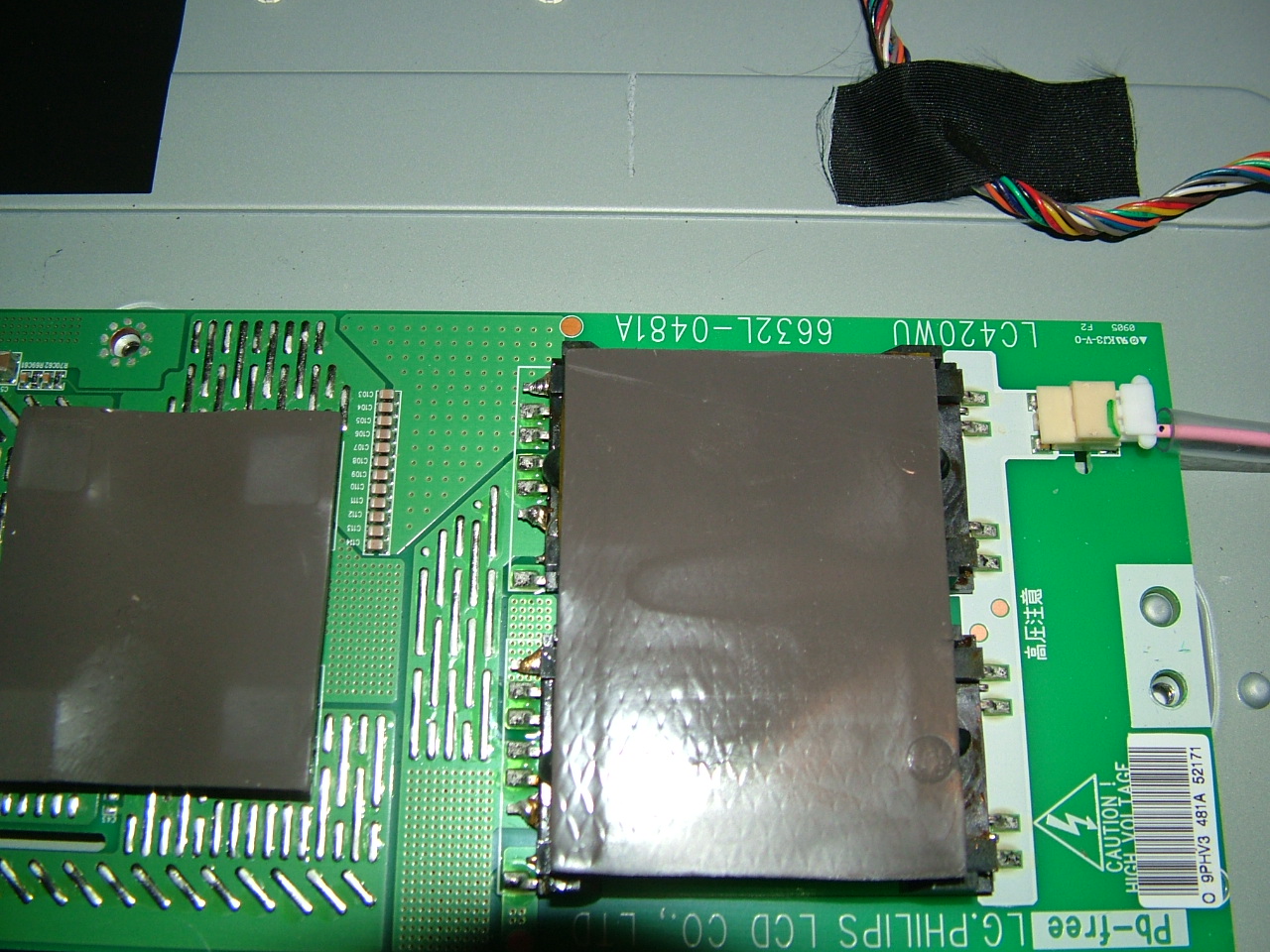

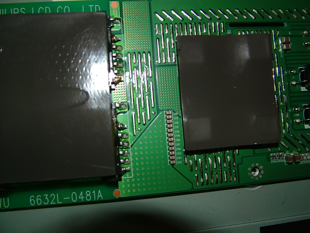

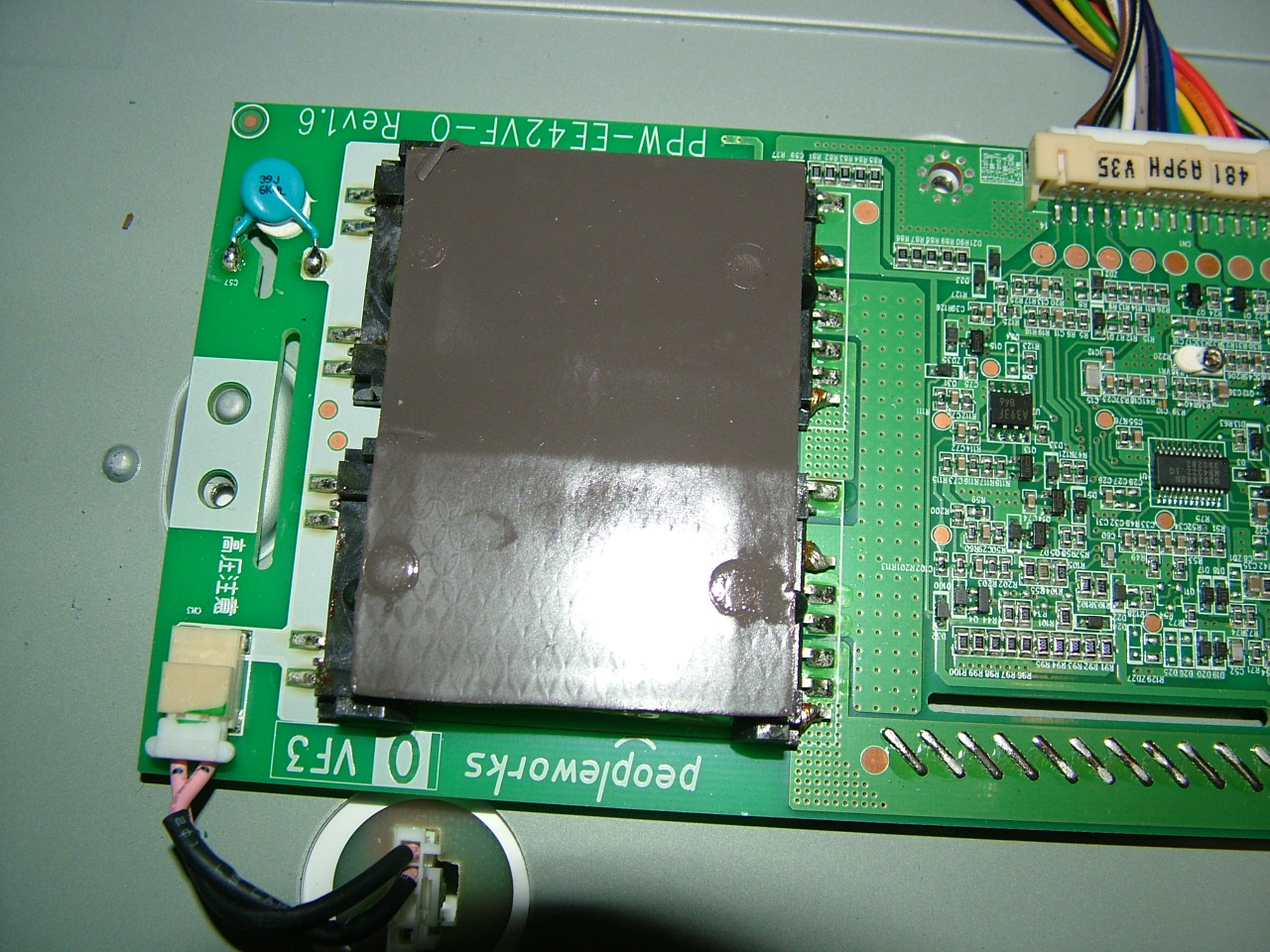

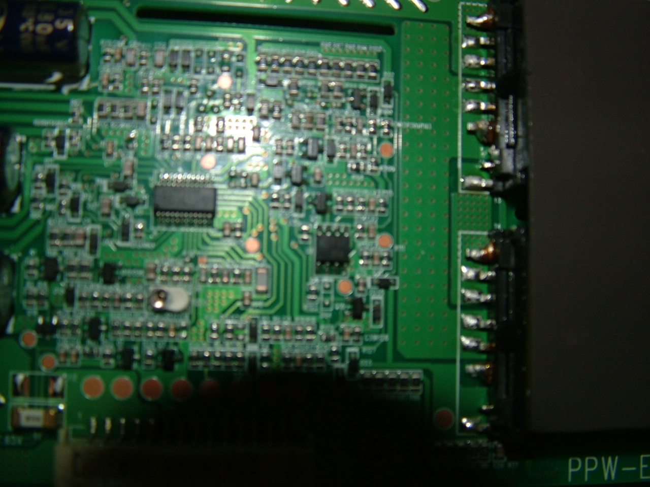

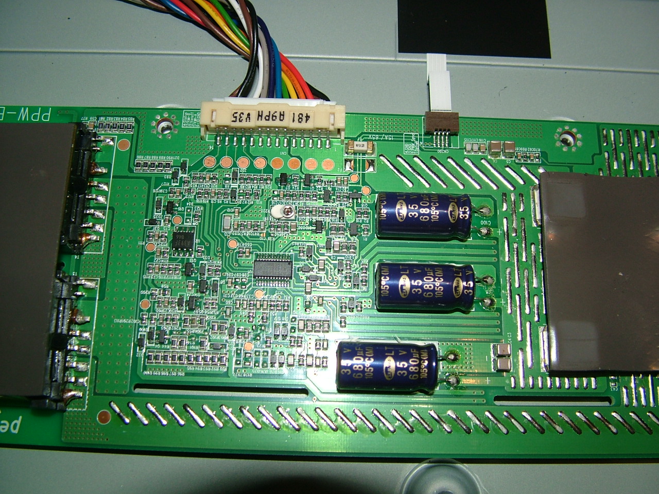

    OK, Voltages look OK, one signal is missing is the BL_ON signal for turning on the inverter boards. Did you check it at the inverter board to see if it is present? Pictures of your inverter boards?

      No I only checked 24 volts at Inverter board. Only have one inverter board. Will have to take apart and do photo.
