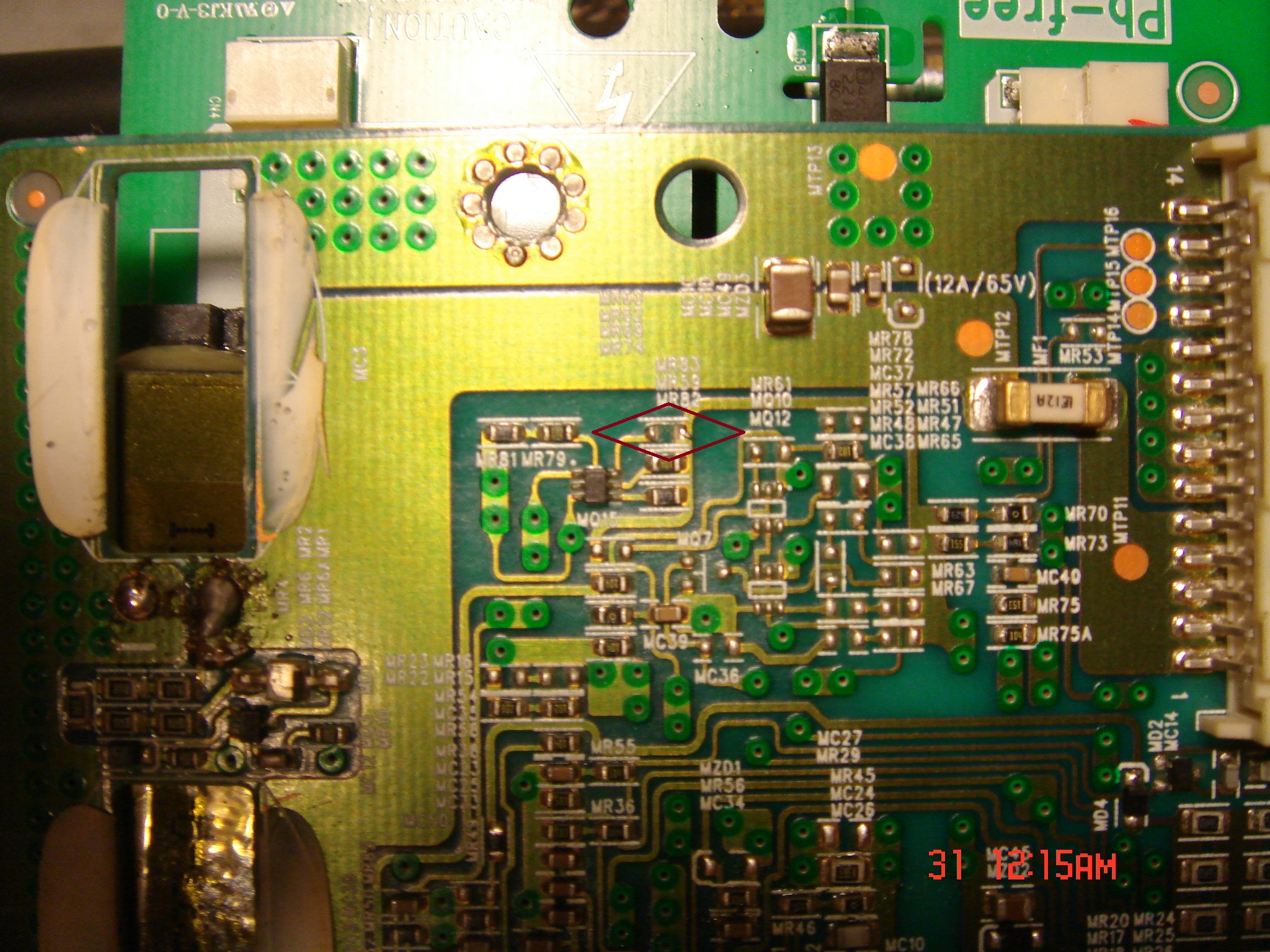

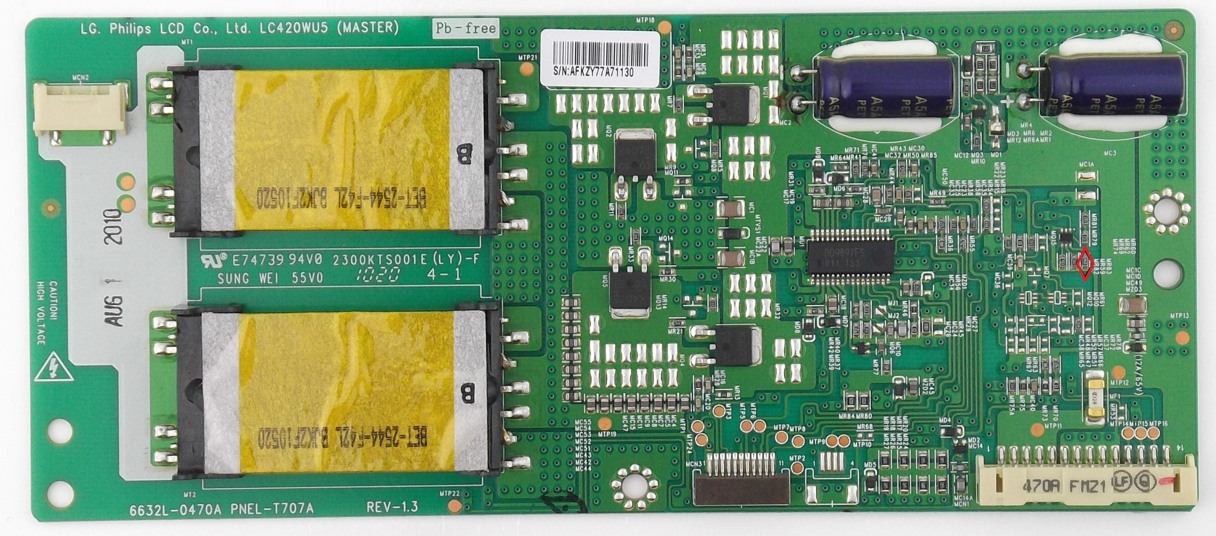

Hi all, I need a resistor, I don't know the value. maybe you can help me. Look @ the pictures , I put a red diamond around the location of the mr83 resistor...
Thanks for your help!

I just looked at a board that I have.
It is a rev 1.2
Part M83 is marked "102"
Mike

Sorry, I meant part MR83!

102 = 10 x 10Squared(100) = 1000Ω or 1kΩ

Thanks, I have a donor so when the repair kits get here I will have a good set of boards for a 42" LCD!
Mine are revision 1.2 as well.
