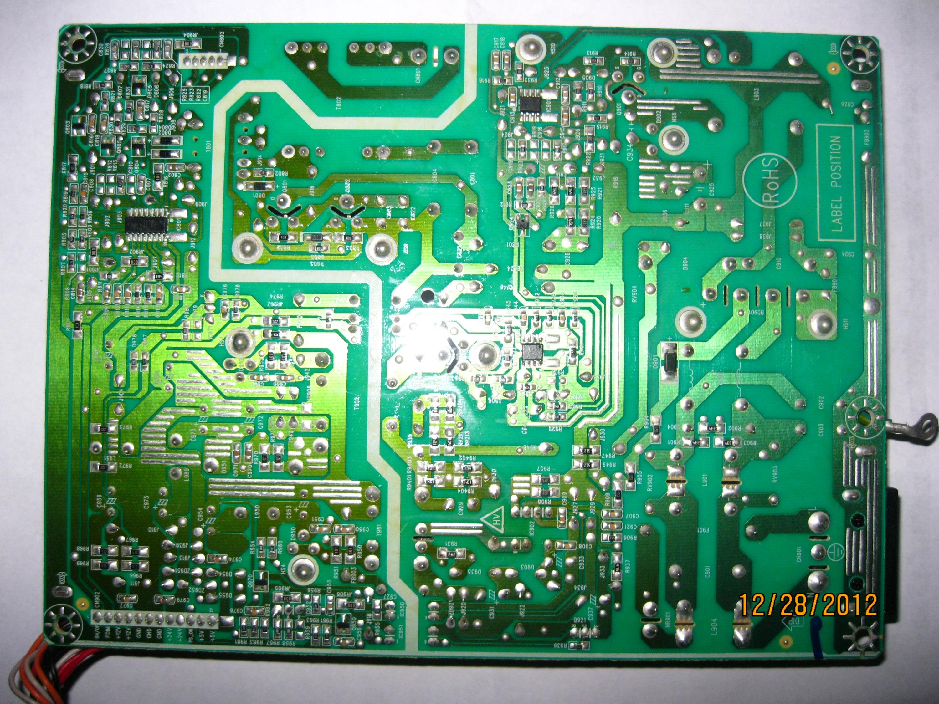

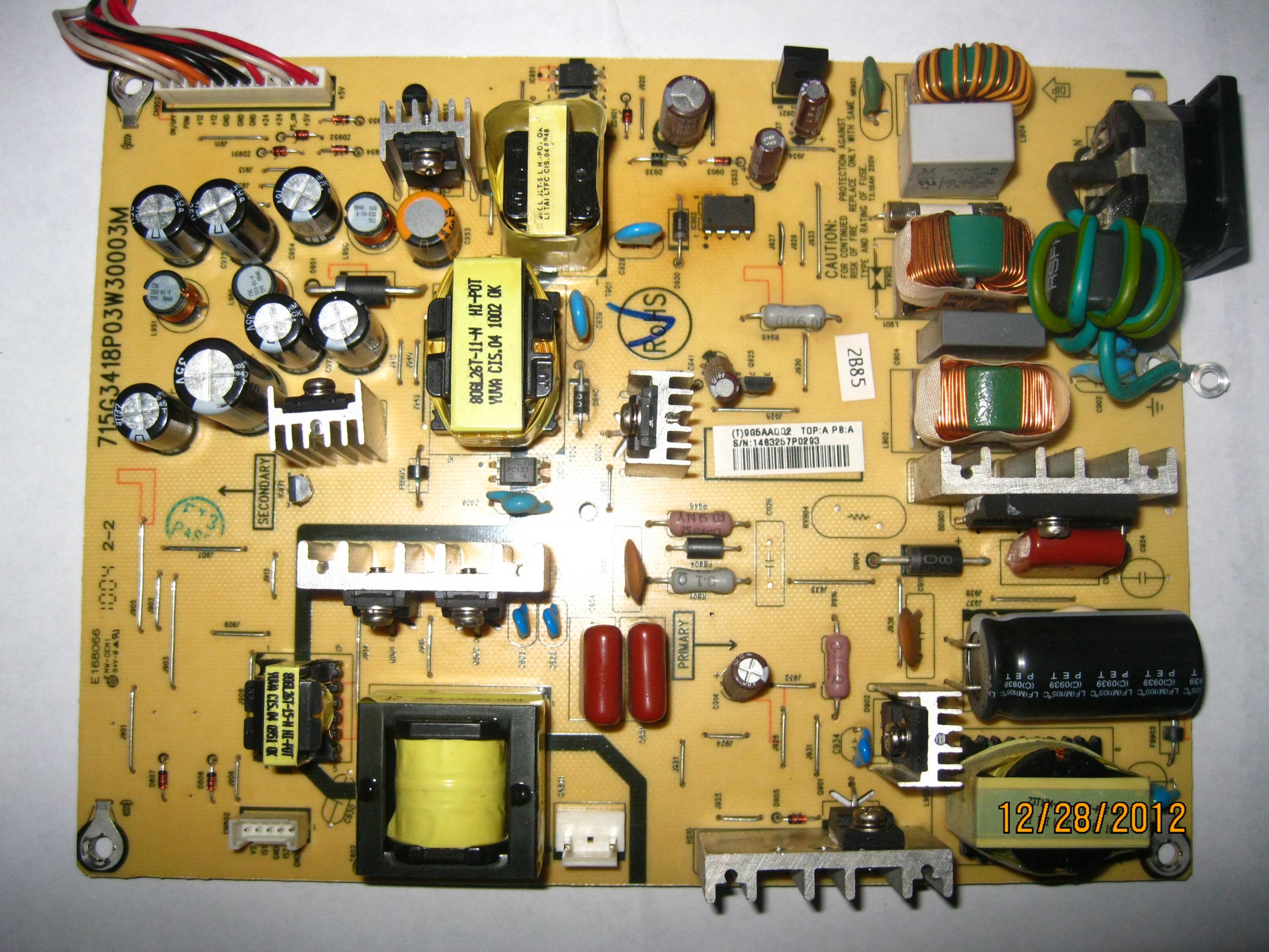

    Hi a newbie here.I have a va26lhdtv10t vizio i am trying to repair.vizio logo yellow and white when powered on screen lights up with back light and no picture just white screen with sound.Visually checked boards for bad caps and loose connections.Checked voltages to main board all correct except PS on only shows .998 volts.Changed main board with another from shopjimmy.com no difference. also twisted and wiggled front frame no change and unplugged ribbon cable to main board and tcon with no change. I have attached pics of power board. any help or suggestions would be great thanks to all. great board

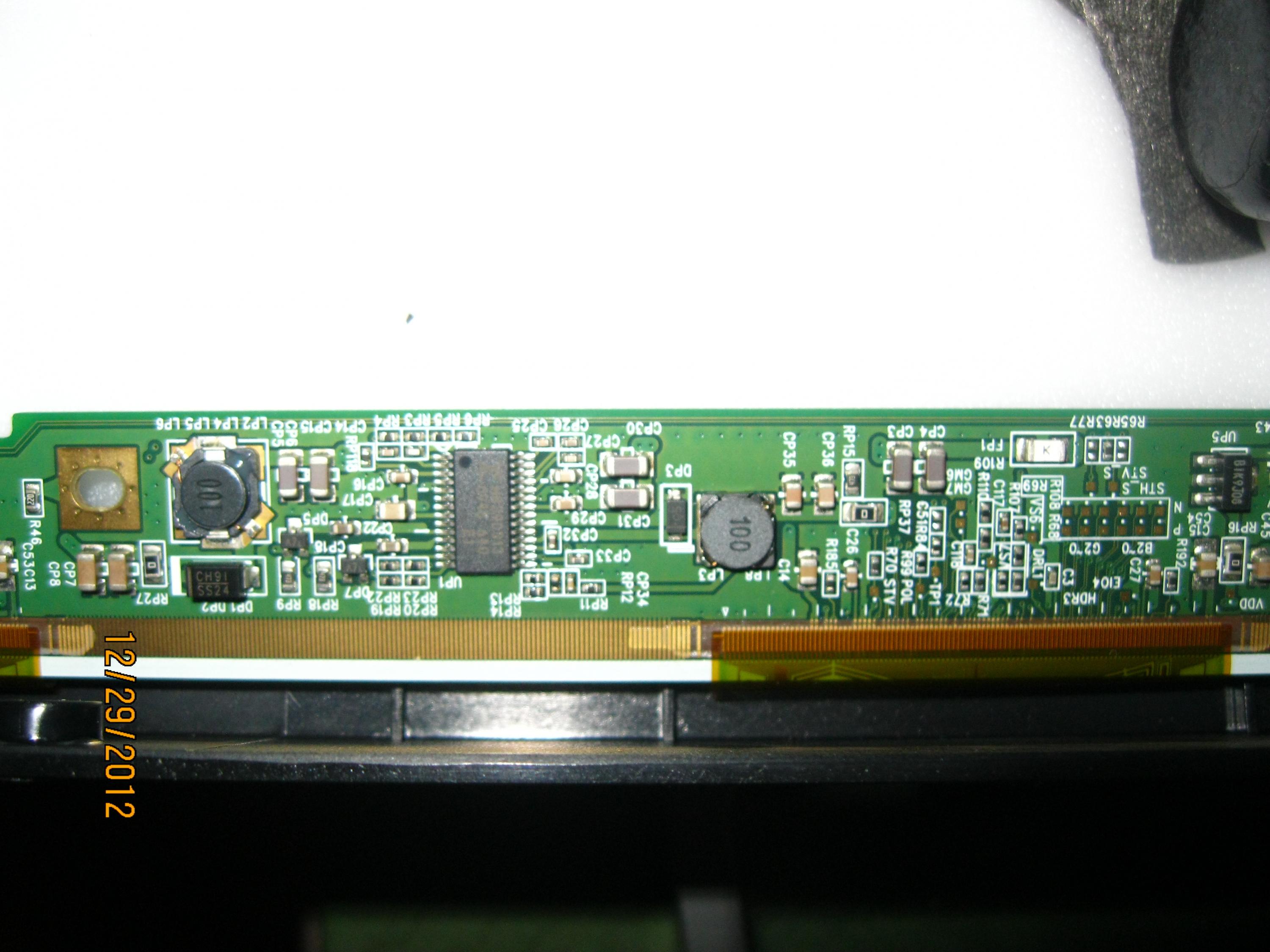

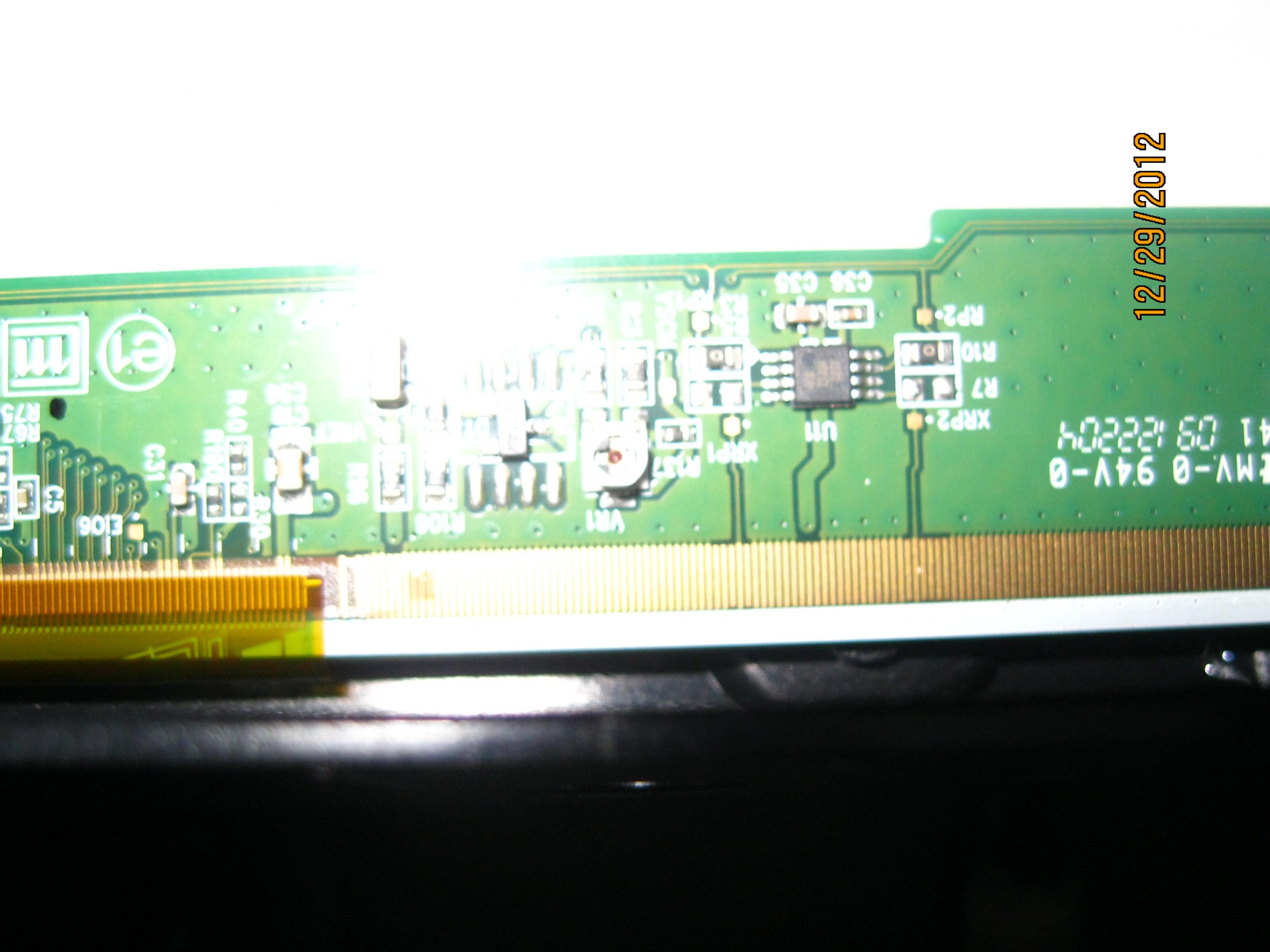

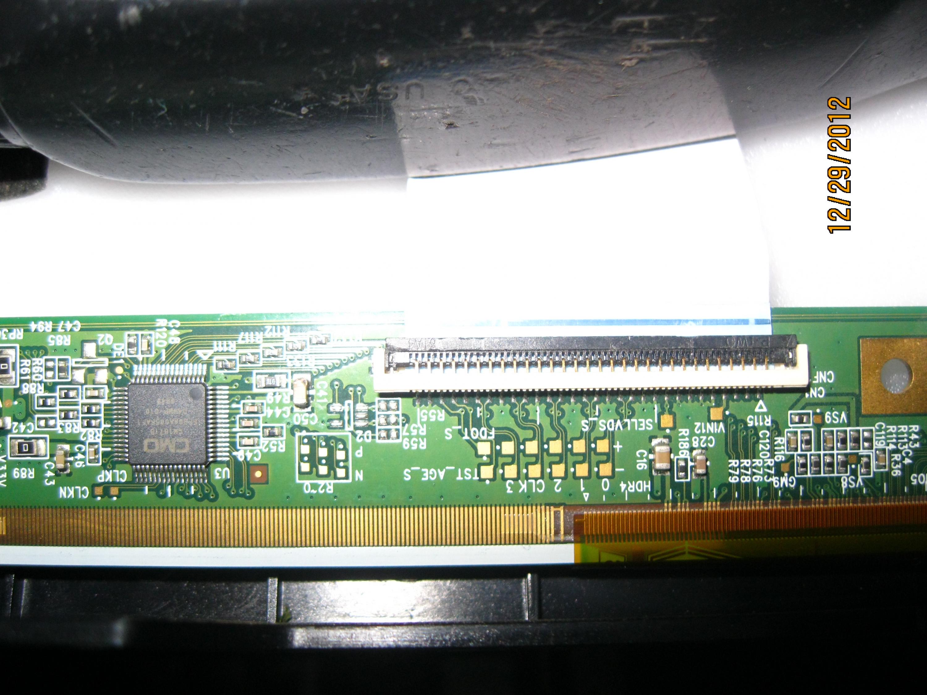

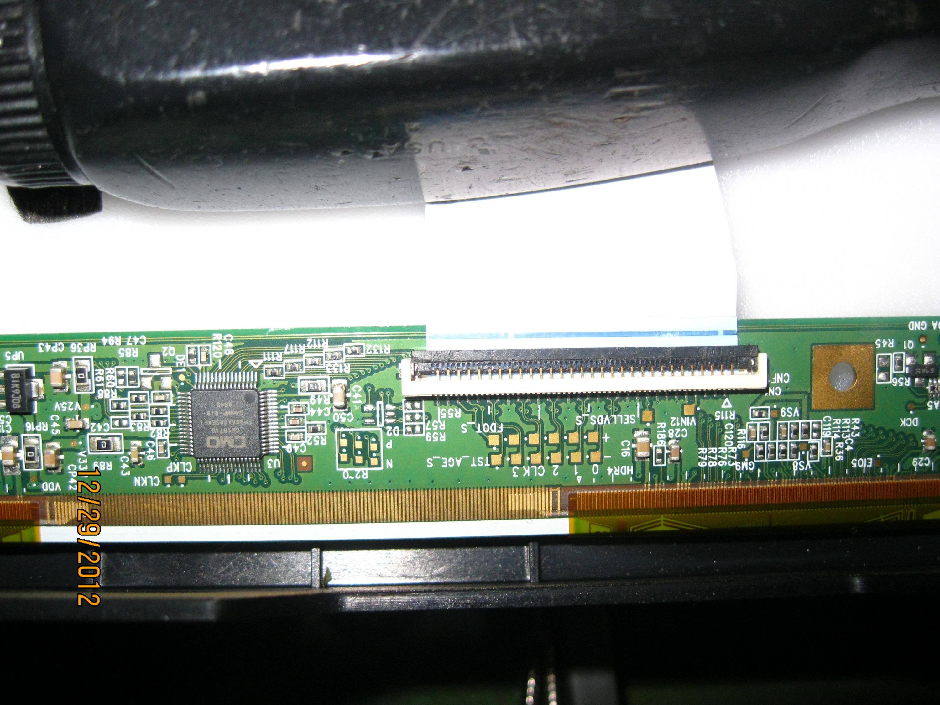

        I have it apart and tried to take some pics board is about two feet long and hard to get it all in one pic i took a few of different sections.Don't see any fuses are they surface mount gold things with no markings?.

          It looks like FP1 is a fuse, with the K marking on it. So there is no t-con board it's integrated in the panel right?

            There is one in Pic 5 - It is white with a K on it. Meter on 200 ohms should read the same as touching the probes together?

                FP1 fuse with k tests ok no open.

                              The ribbons look like they may not be fully seated try reseating all of them. I think that blue line is usually in further..
