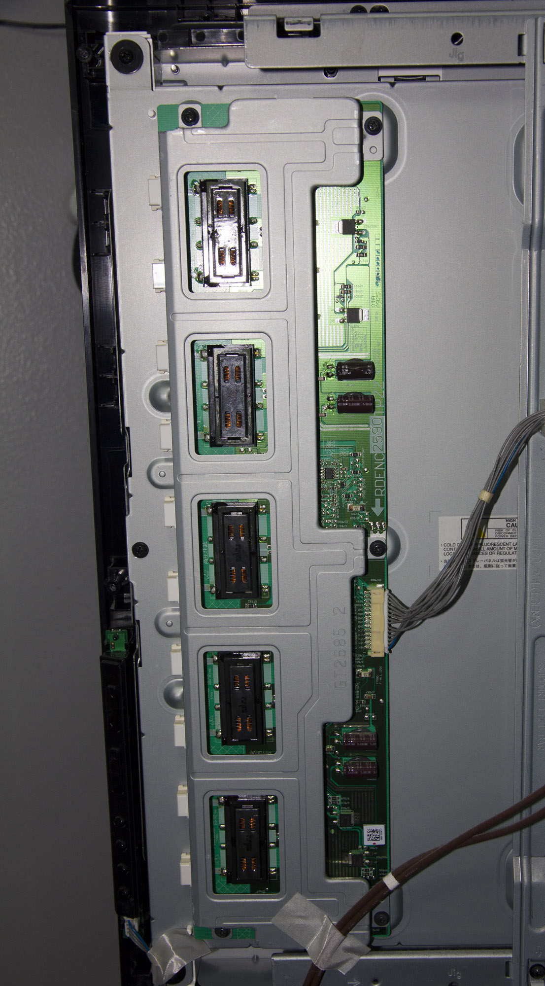

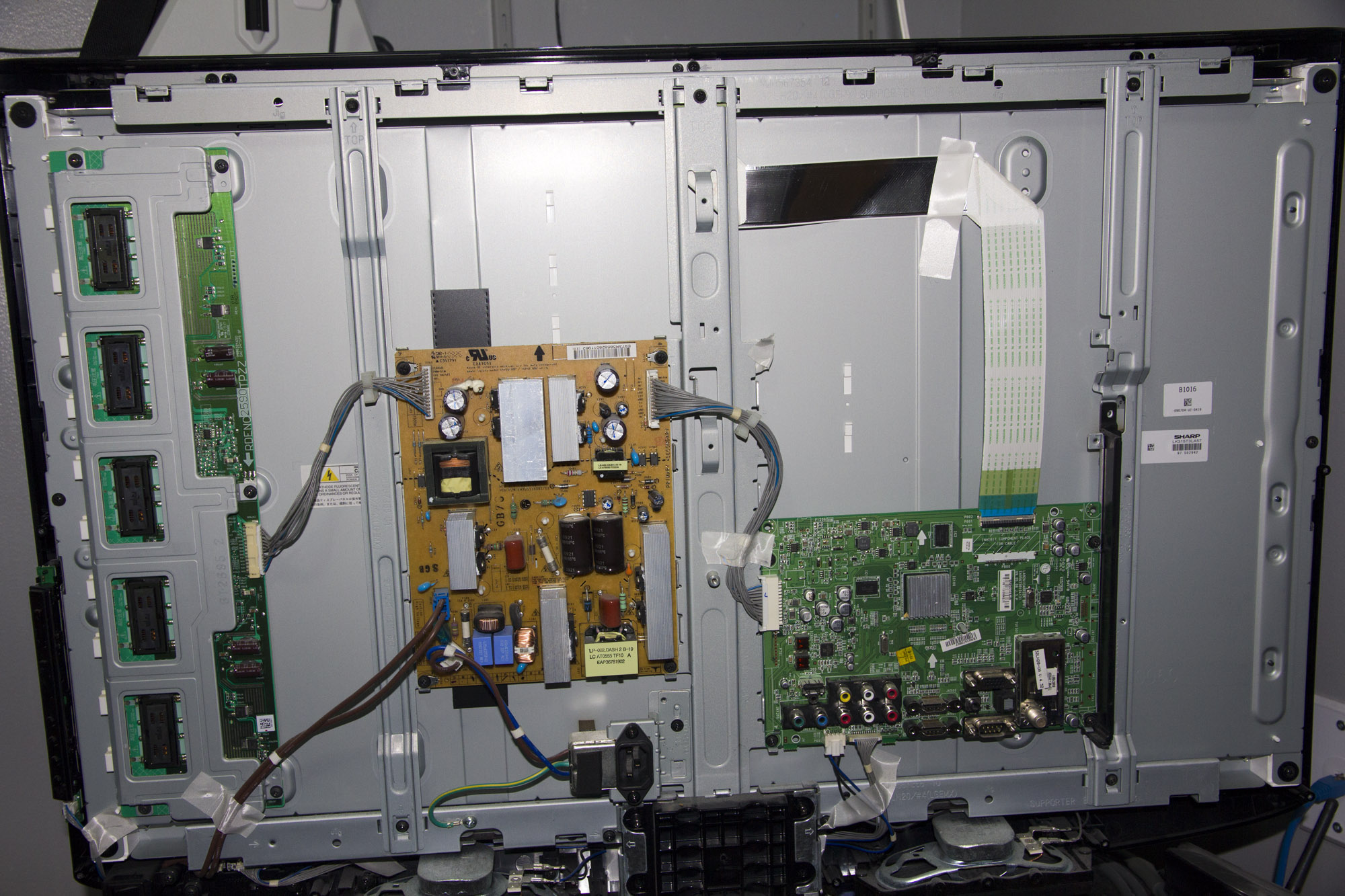

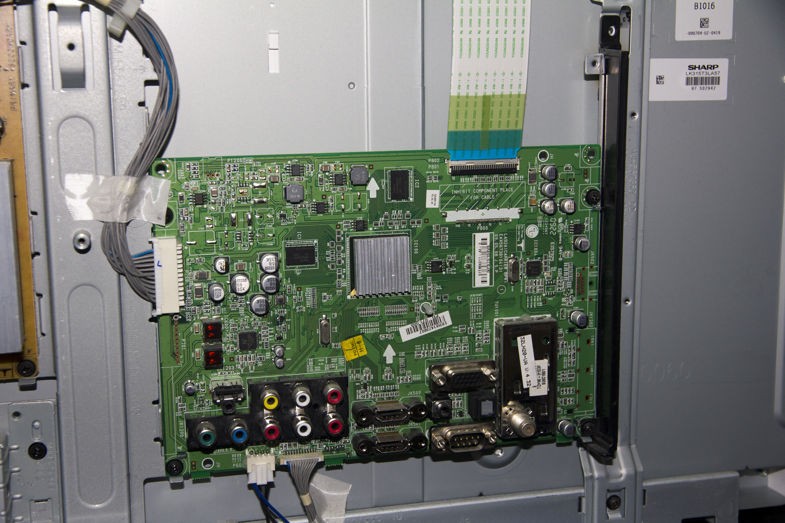

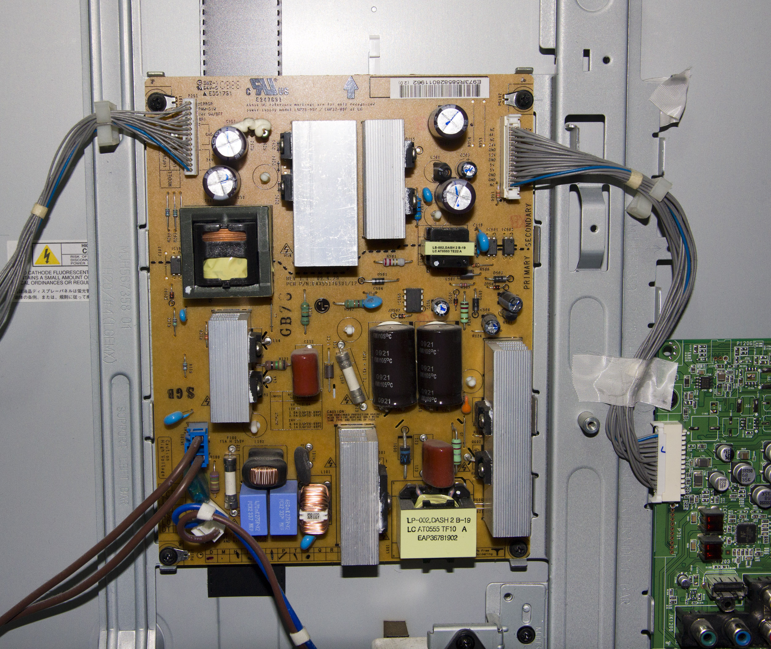

        Re: My LG 32LH20 LCD. Lines through picture, now no picture.
        OK here are the pics of the boards.
        When its 'running' there is one green LED lit up on the top right of the main board
        hope this helps
          Ooh, one of those non-replaceable T-CON that is integrated with the LCD panel assembly.
            It is a nice Sharp panel, but shame they did it like that. Wonder why LG used Sharp panel not one of their own?
                Try reseating the cable going to the hidden T-con. Otherwise I would suspect the main board. Looking again at the video I'm not so sure it's the T-con at fault. But it's hard to call.

                            Hi there! With regard this LG 32LH20, with the set off unplug the connector for the control panel, and turn set on using the remote control; if problem still there turn it off;
                            unplug the IR connector for the remote control; turn set on using the power button on TV. Also check soldering side of power supply for any signs of components legs touching
                            the metal frame causing erratic symptoms like the ones you're having; if so, use good insulation there to solve this problem.
