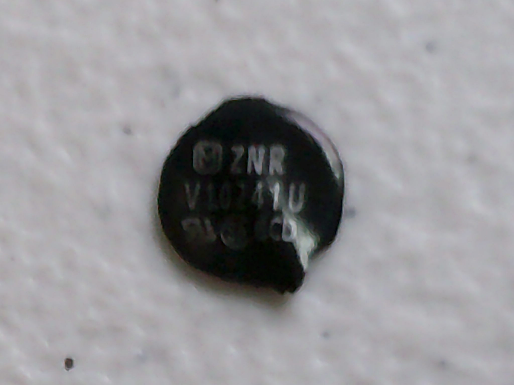

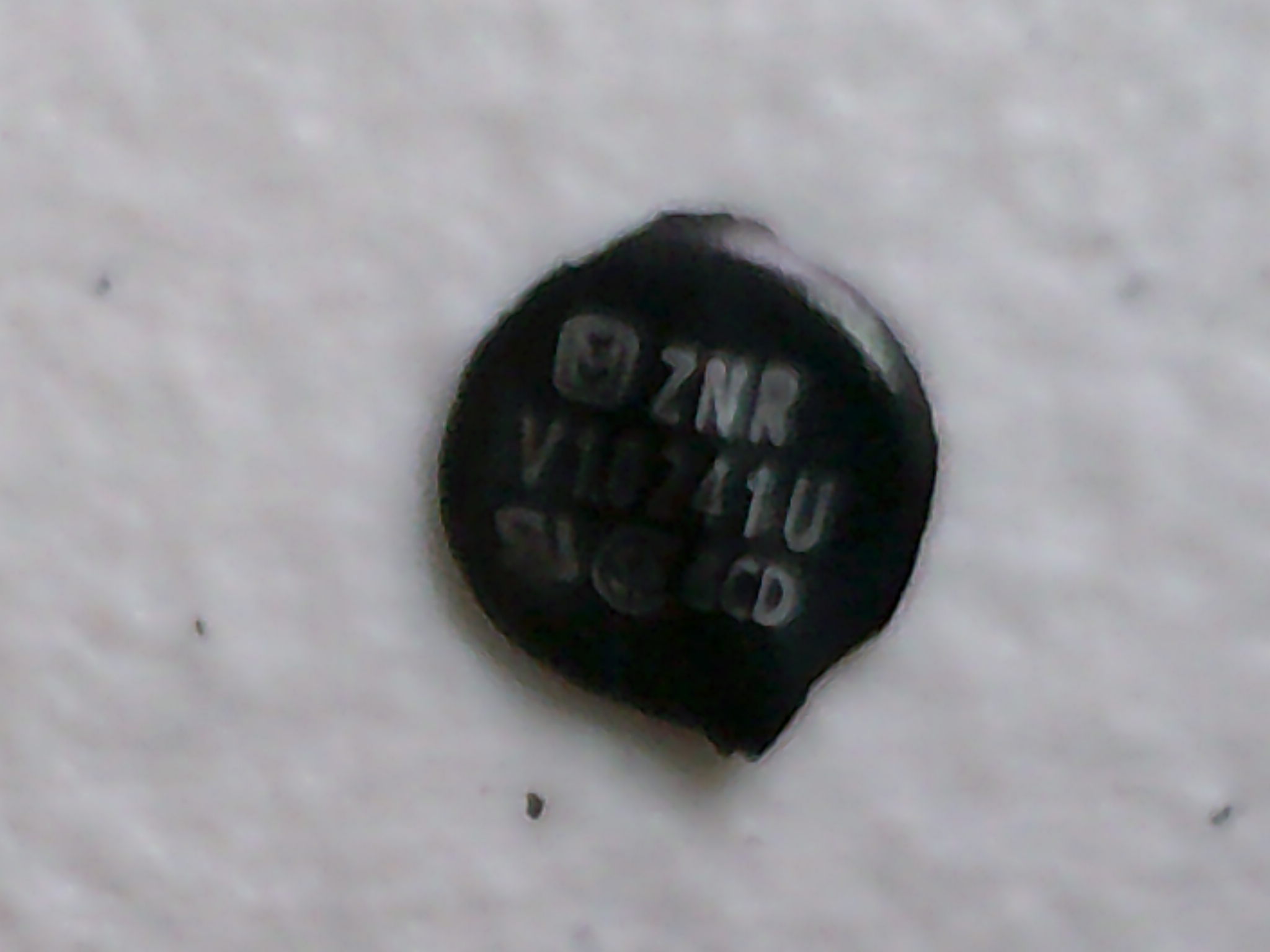

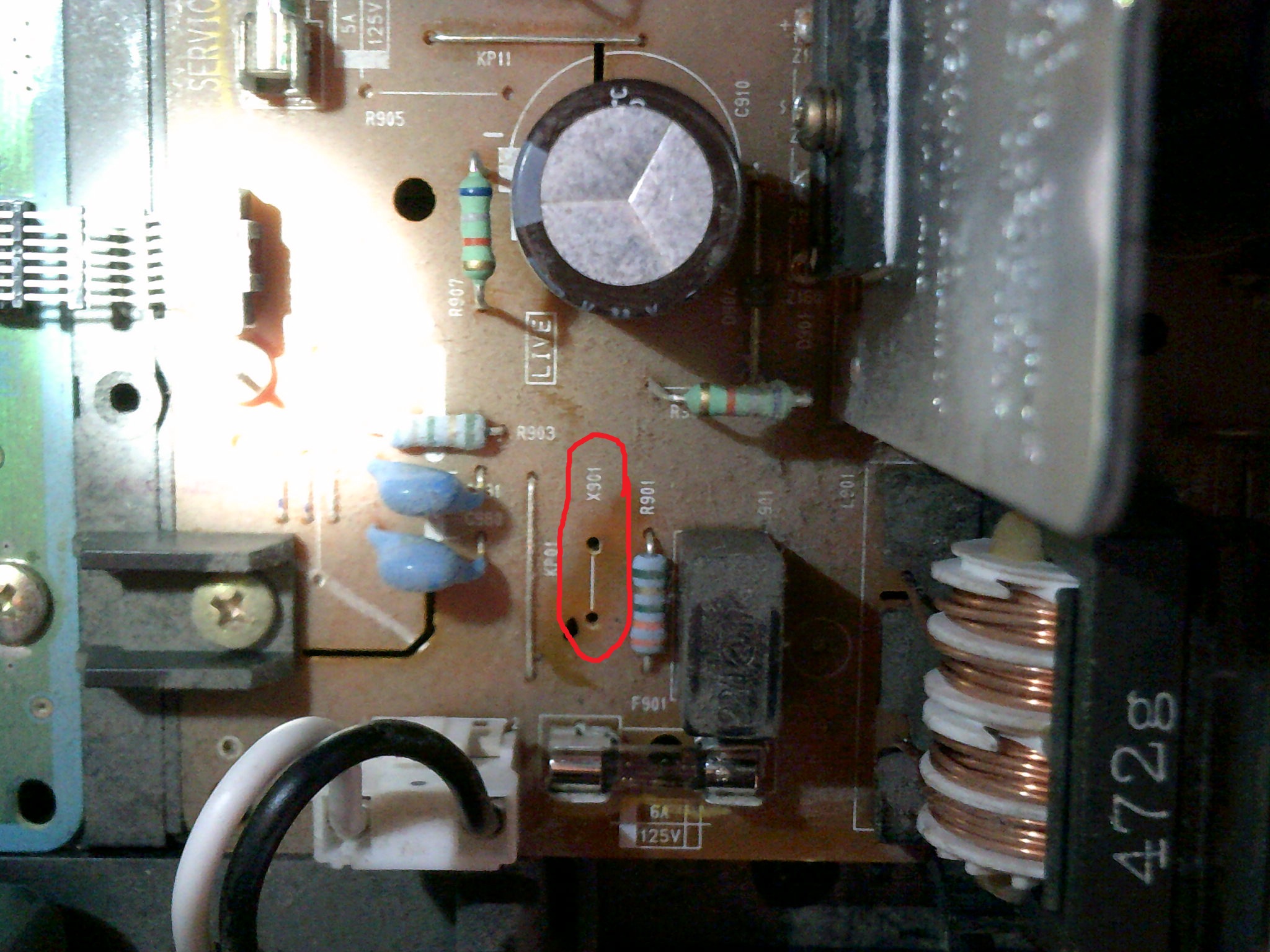

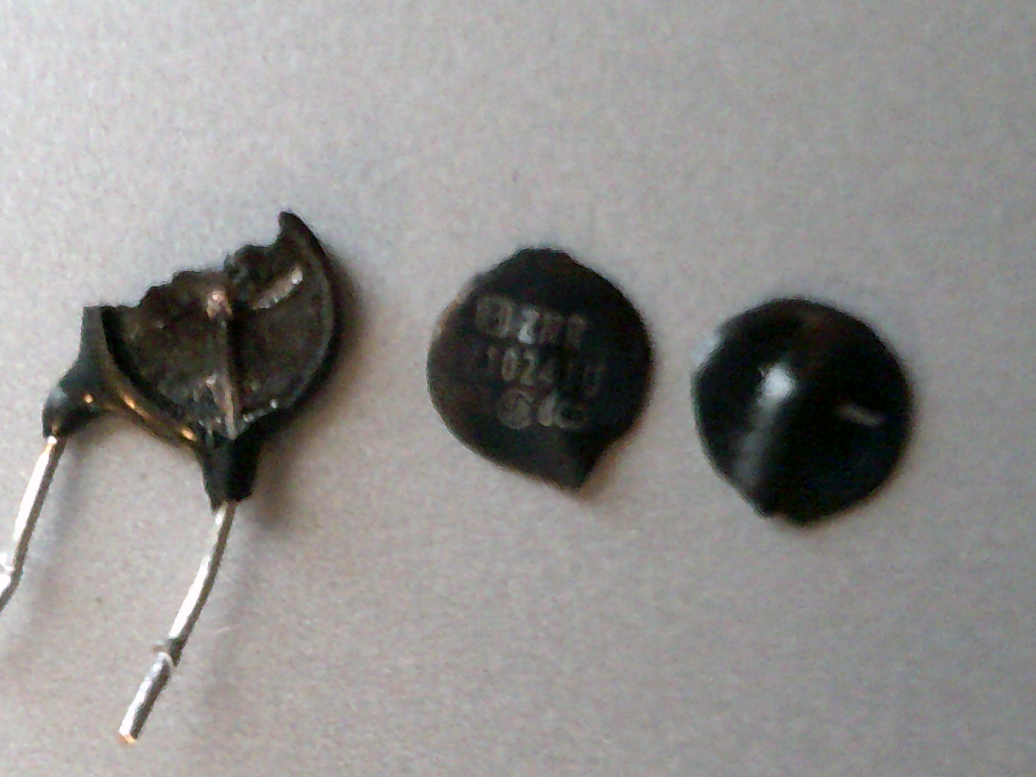

    Major power surge blew this tv and first thing I noticed was a bad main fuse 125V. 6A and what I think is a ZNR Transient/Surge Absorber ZNR V10241U.
    I dont know anything about surge absorbers.
    Nothing seems burnt on power board but the surge must have melted the solder on the absorber, it pulled right out of board with no heat. there are 2 other 125V. 5A. buss fuses that are fine.
    Im going to replace the absorber and fuse but I was wondering if the surge would have MOST LIKELY stoped at the absorber when it blew. I will order 2 just in case.

      If you're lucky that's where the damage stopped. Hopefully it didn't come in through any of the video inputs and fry something on the main board.

        Part seems to be obsolete and Im having trouble reading the last part on it, it is a little burnt.
        ZNR
        V10241U
        ?CD
        Im not sure of the manufacturer/replacment.

          You do not have to replace the MOV yet, if nothing else is damaged, the TV should power back up OK. I would suggest using 150W lamp in place of the fuse, if the lamp stays brightly lit when power caord is plugged into the outlet, that will indcate you still have shorted out circuits in the TV. The TV will work without the MOV, the MOV is put AFTER the fuse so when the first surge comes along, the fuse will blow so if there is a second surge the TV will not be exposed to the second surge.
          By the way, that is 150V (code 241, Max allowable =150VAC/200VDC ) MOV, it looks like either 10mm or 14mm diameter. You can get it from Mouser or Digikey.
          14mm:
          http://www.digikey.com/product-detai...41K-ND/2799114

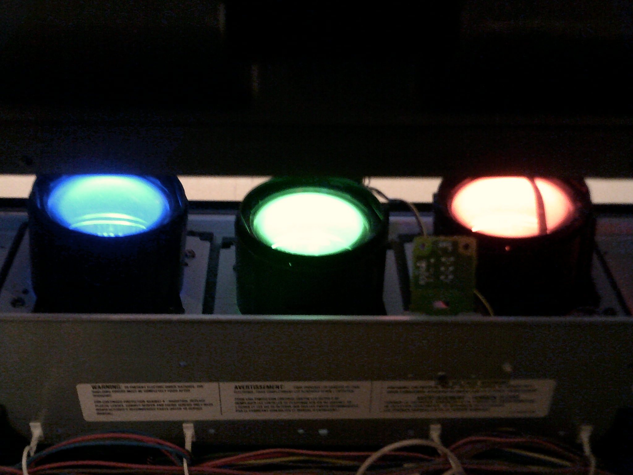

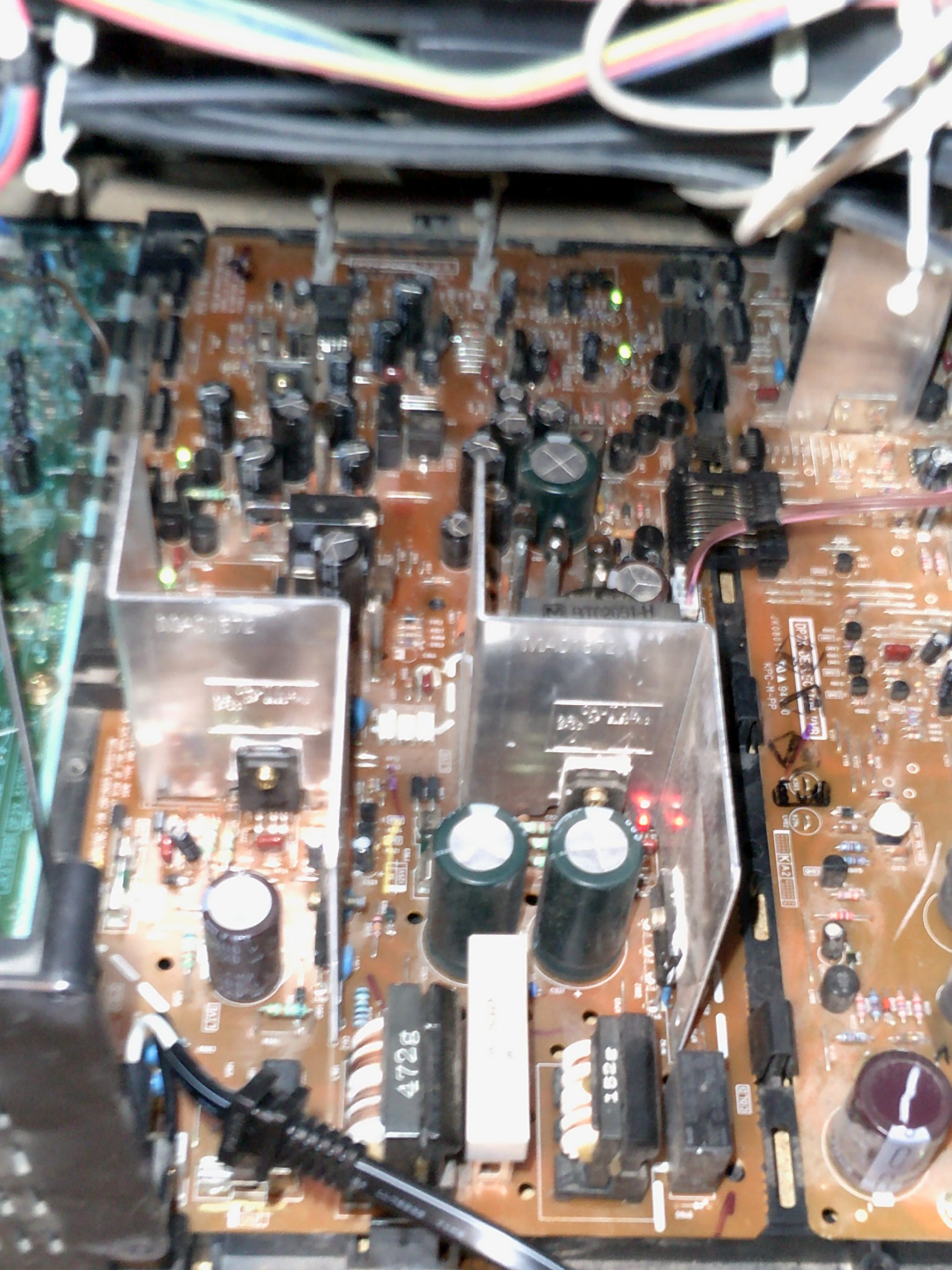

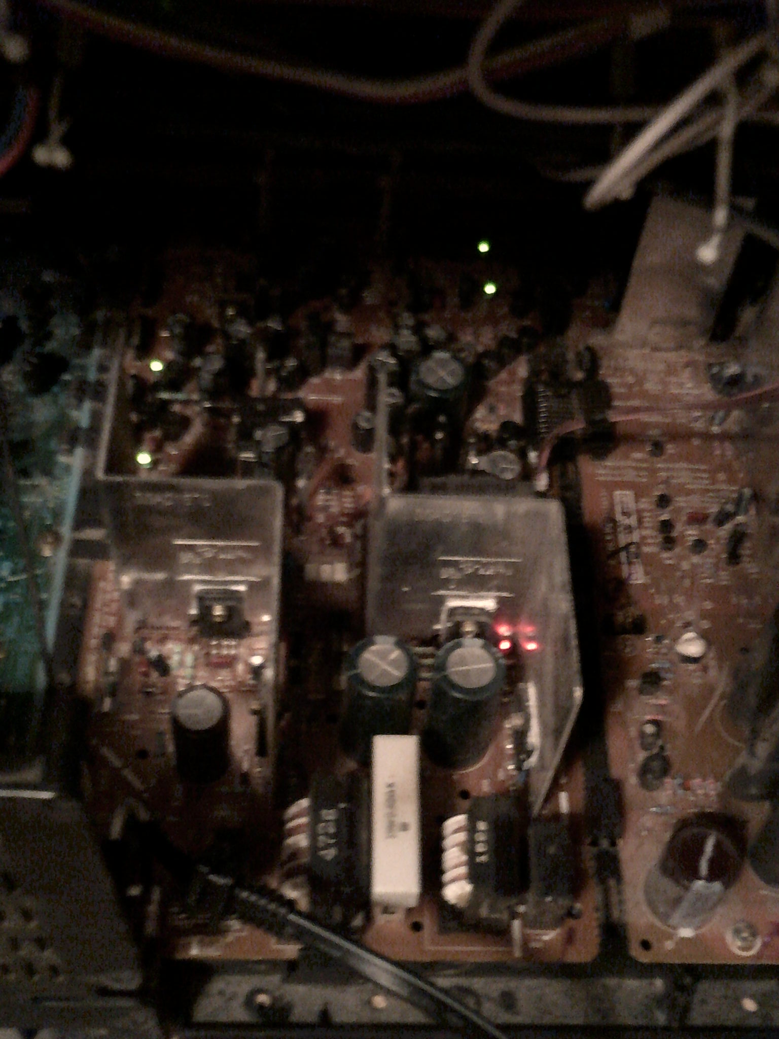

              The boards were filthy so I cleaned them and replaced fuse and have MOV removed.
              Set powered on and I could see the lamps start to glow red green blue untill they shut off after 5sec. set remained powered(red front led).
              The power board has 5 led on it and 1 is red. see pics
              --Edit-- seems to be working. I have cable hooked up and it has pic and sound.

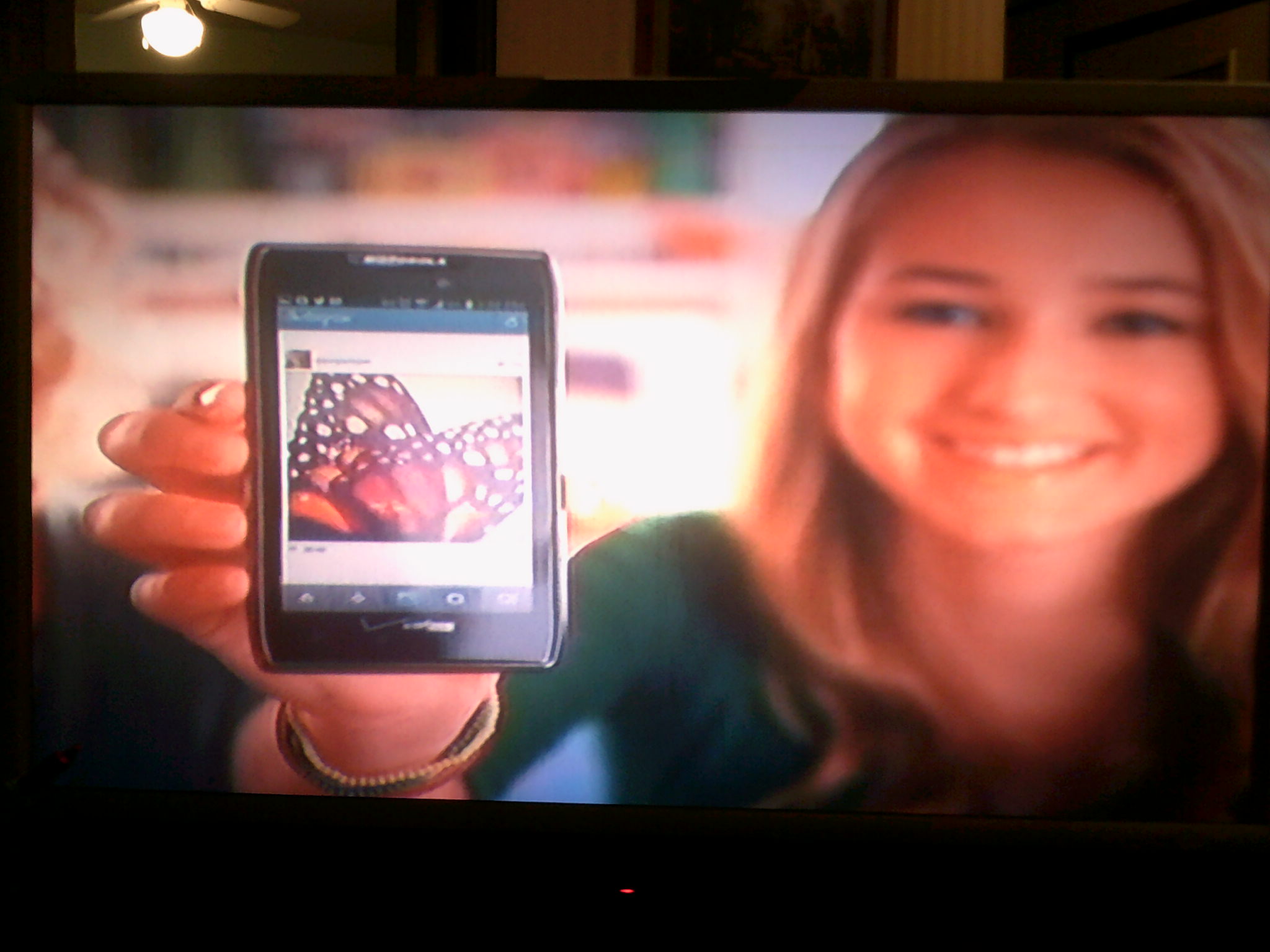

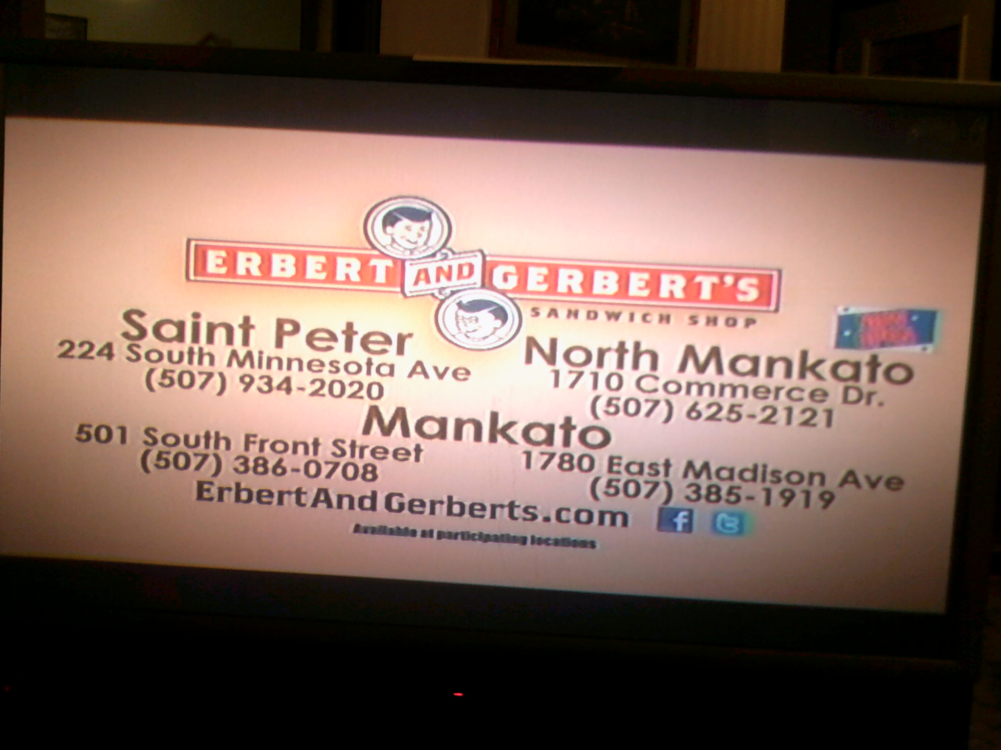

                      I just read a bit about it.
                      thought I would take a couple pics from about 4ft away.

                      the original part diameter is 10mm
                      I found this also same as mousers part
                      http://www.digikey.com/product-detai...41K-ND/2407562

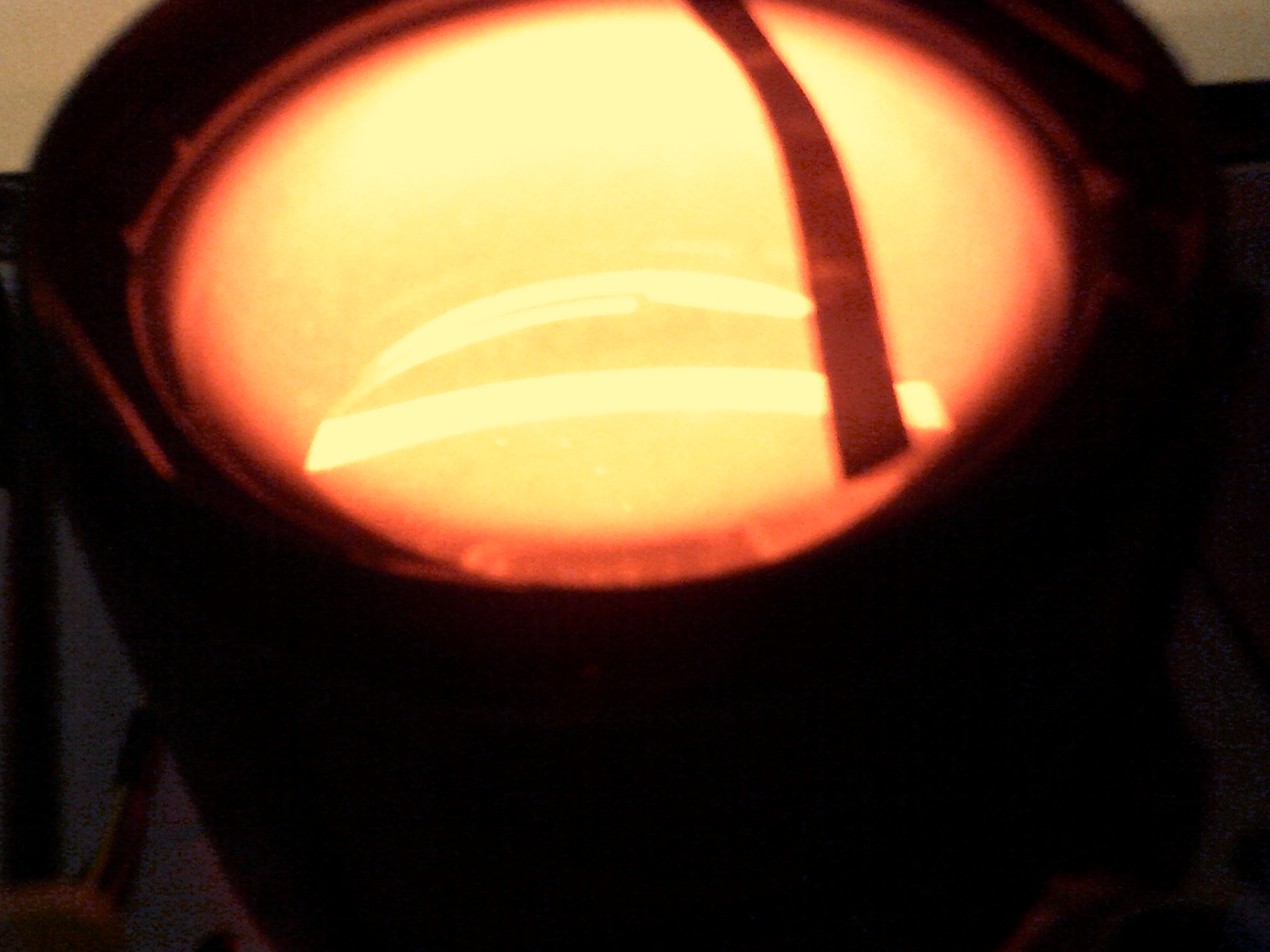

                        I was looking inside to see how dirty the mirror was and saw something odd on red lamp.
                        it looks like a thin strip of electrical tape.
                        Is windex ok inside on lamps and mirror?

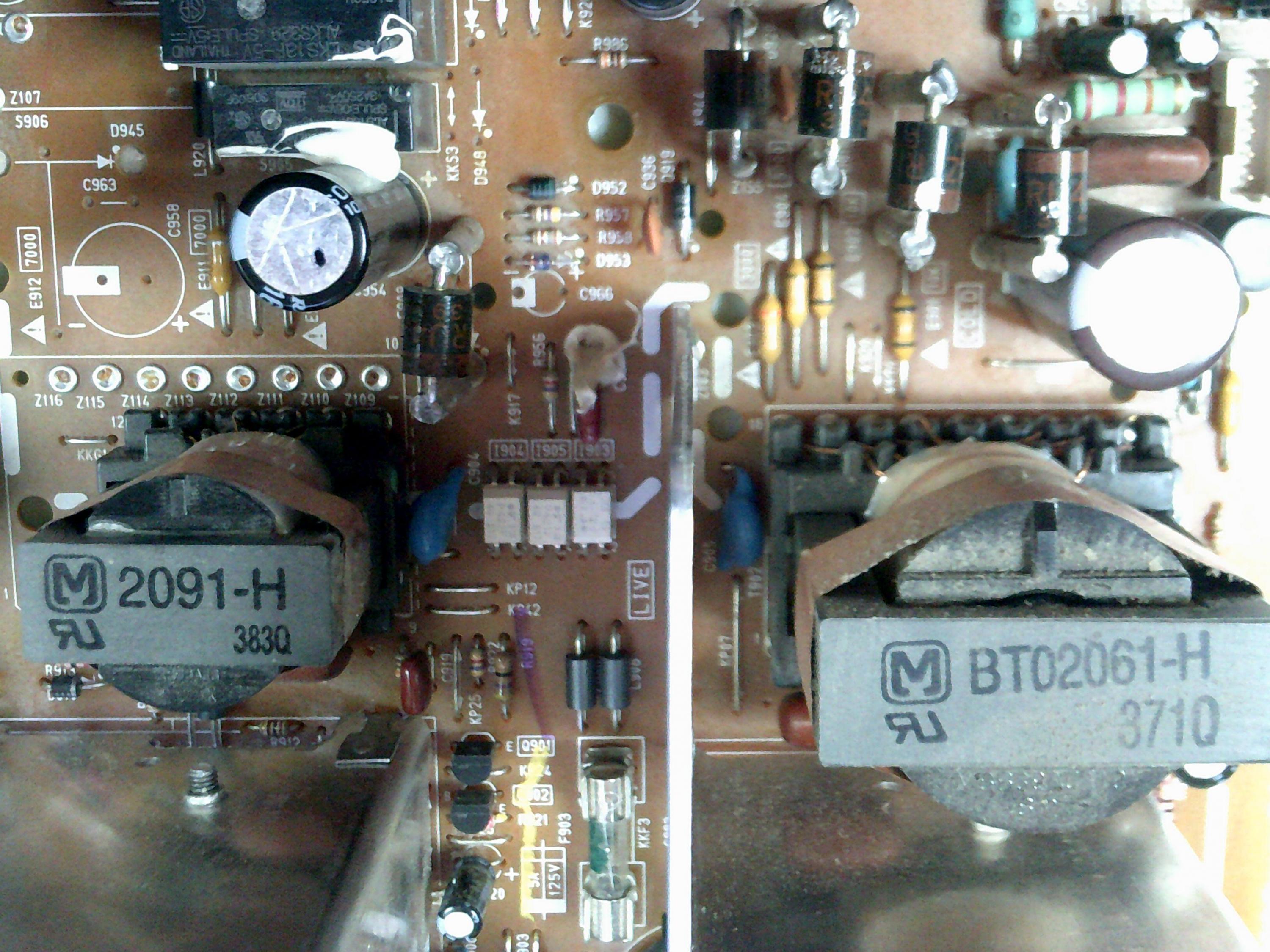

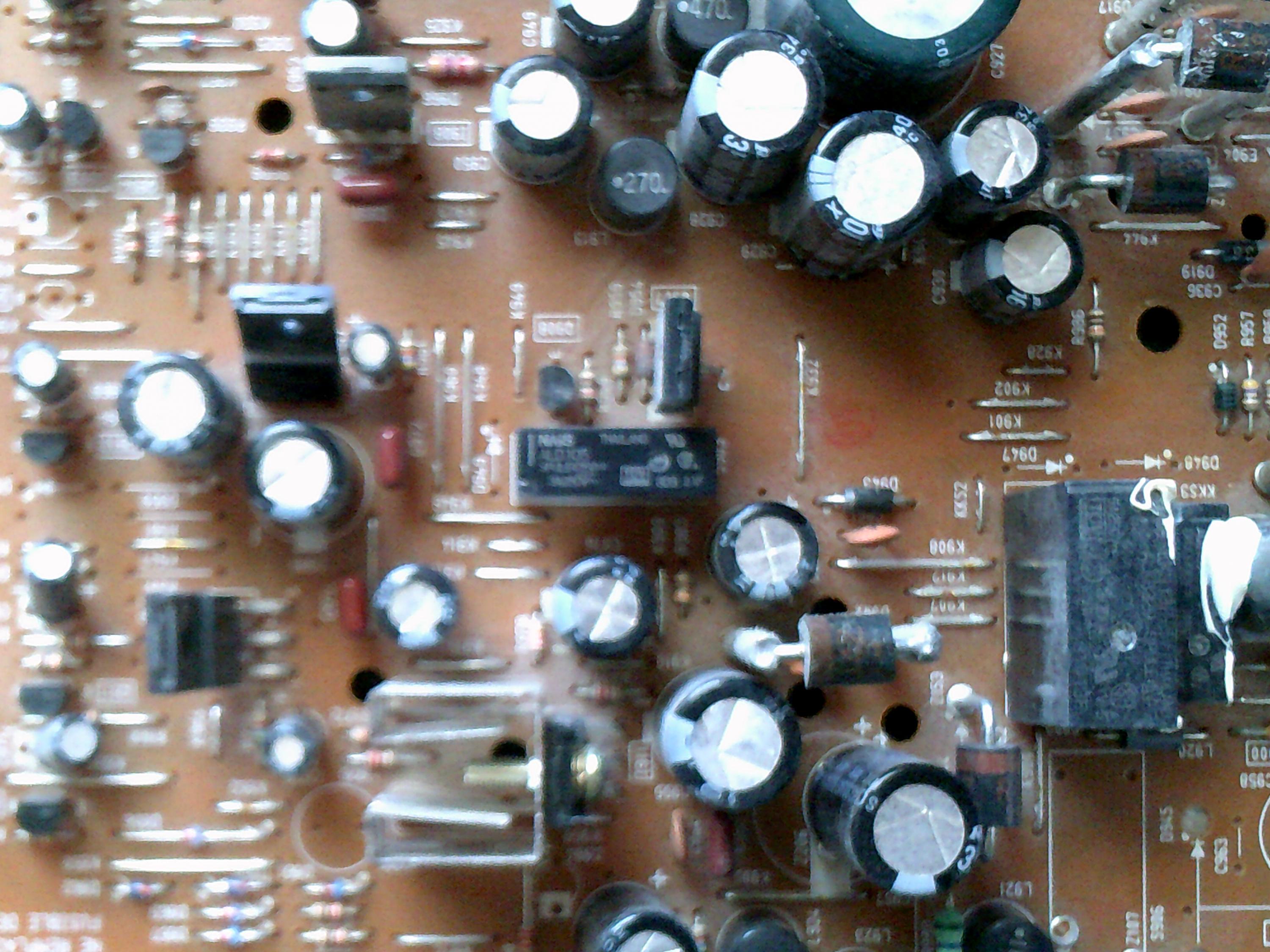

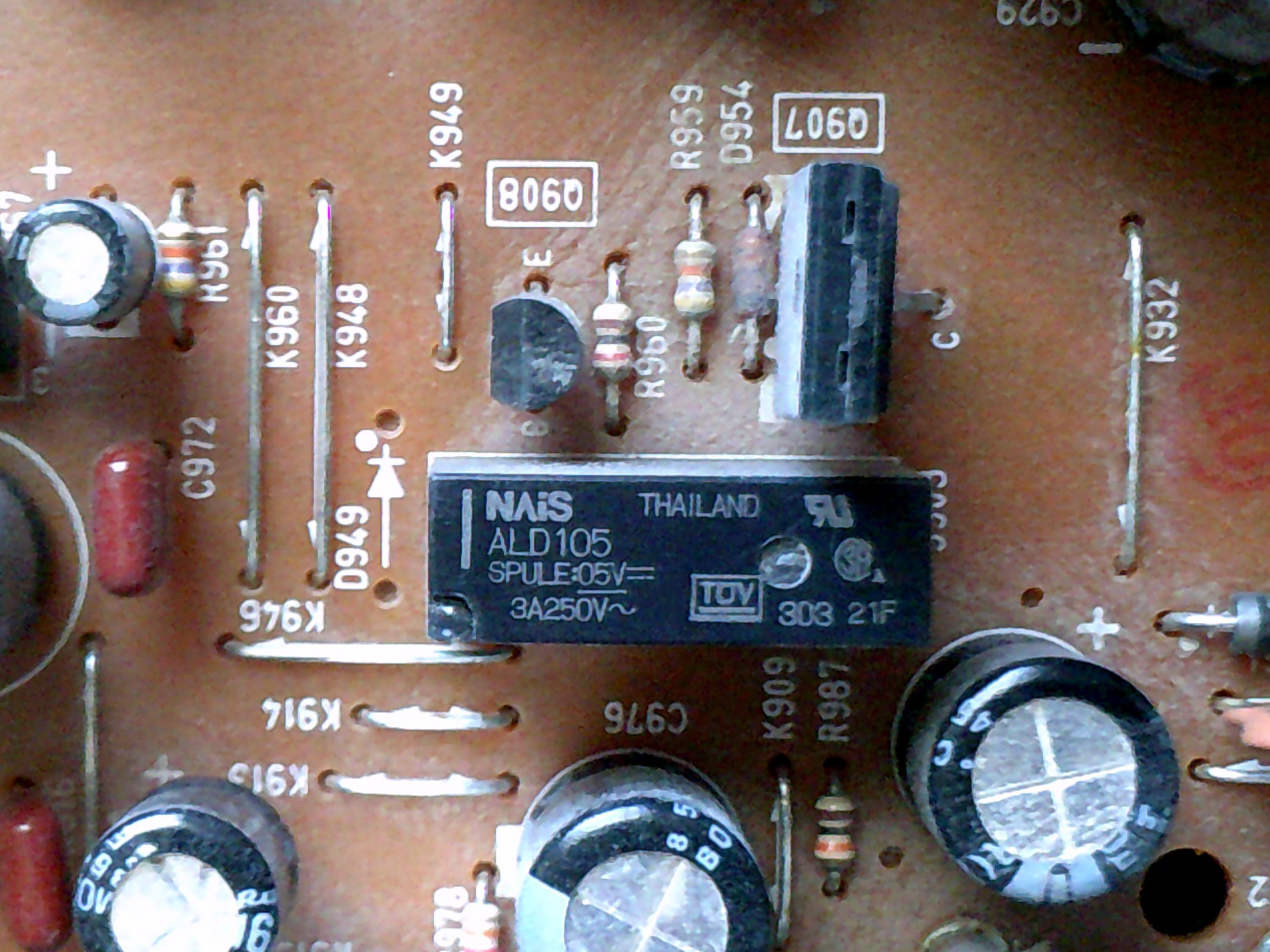

                          I removed the board and when I plug it in it makes noise around what I think is a relay(pic 2).
                          After 5-10 sec noise stops and led's light up on board.
                          Its not a chirp or squeel but more of a vibrating buzzing sound
                            I think this has something to do with calibration from what I have read on other sites.

                              I removed the power board and when I plug it in, it makes noise from the relay in pic above. this is probly from a bad relay or voltage issue. I have bad luck locating fet's and leaking caps that havent completely failed so I would like to verify correct voltage at relay.
                              Any tip for troubleshooting or schematic?
                              Im not possitive it is a power supply issue but pretty sure and I dont have service manual/schematics.

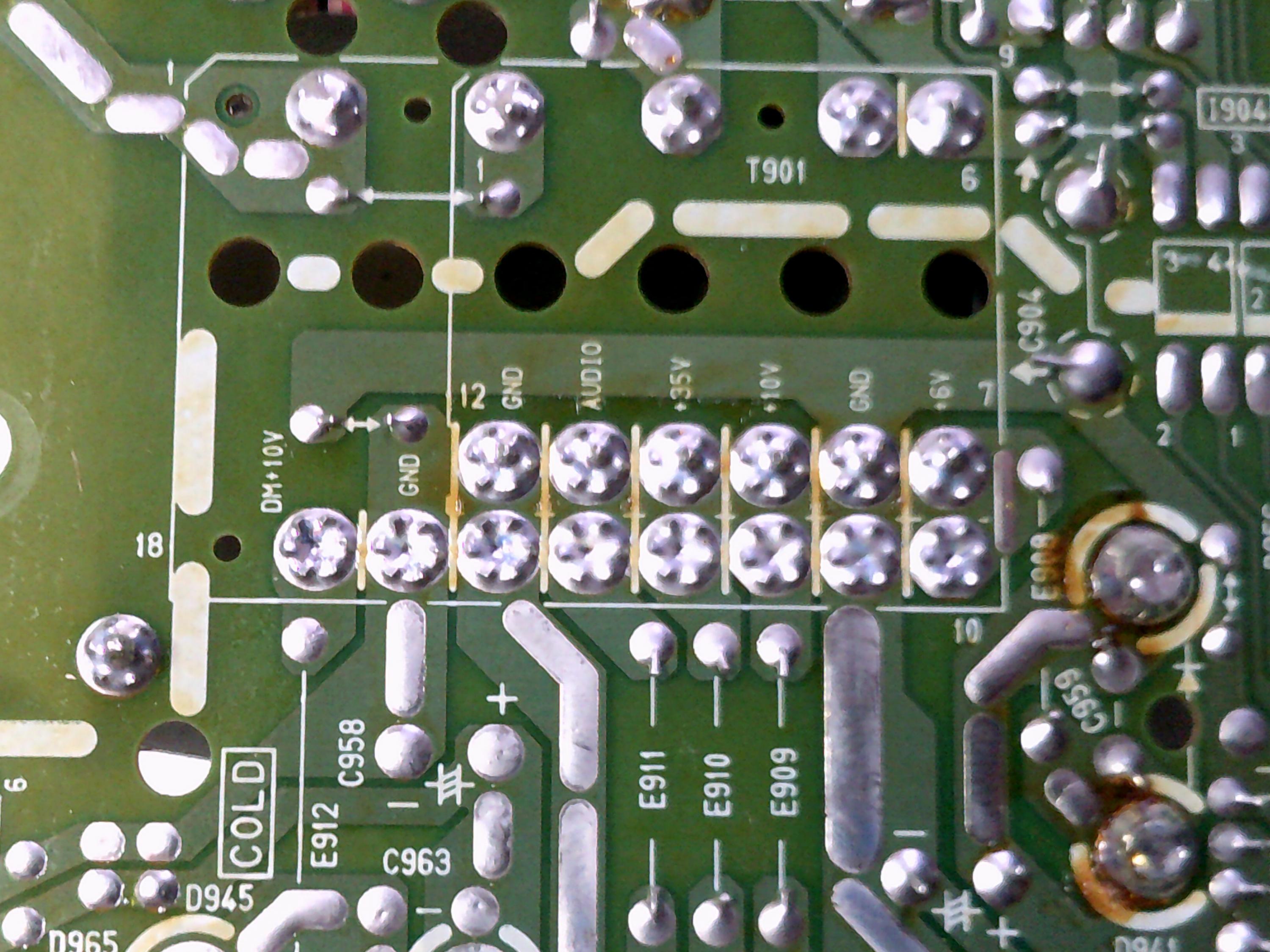

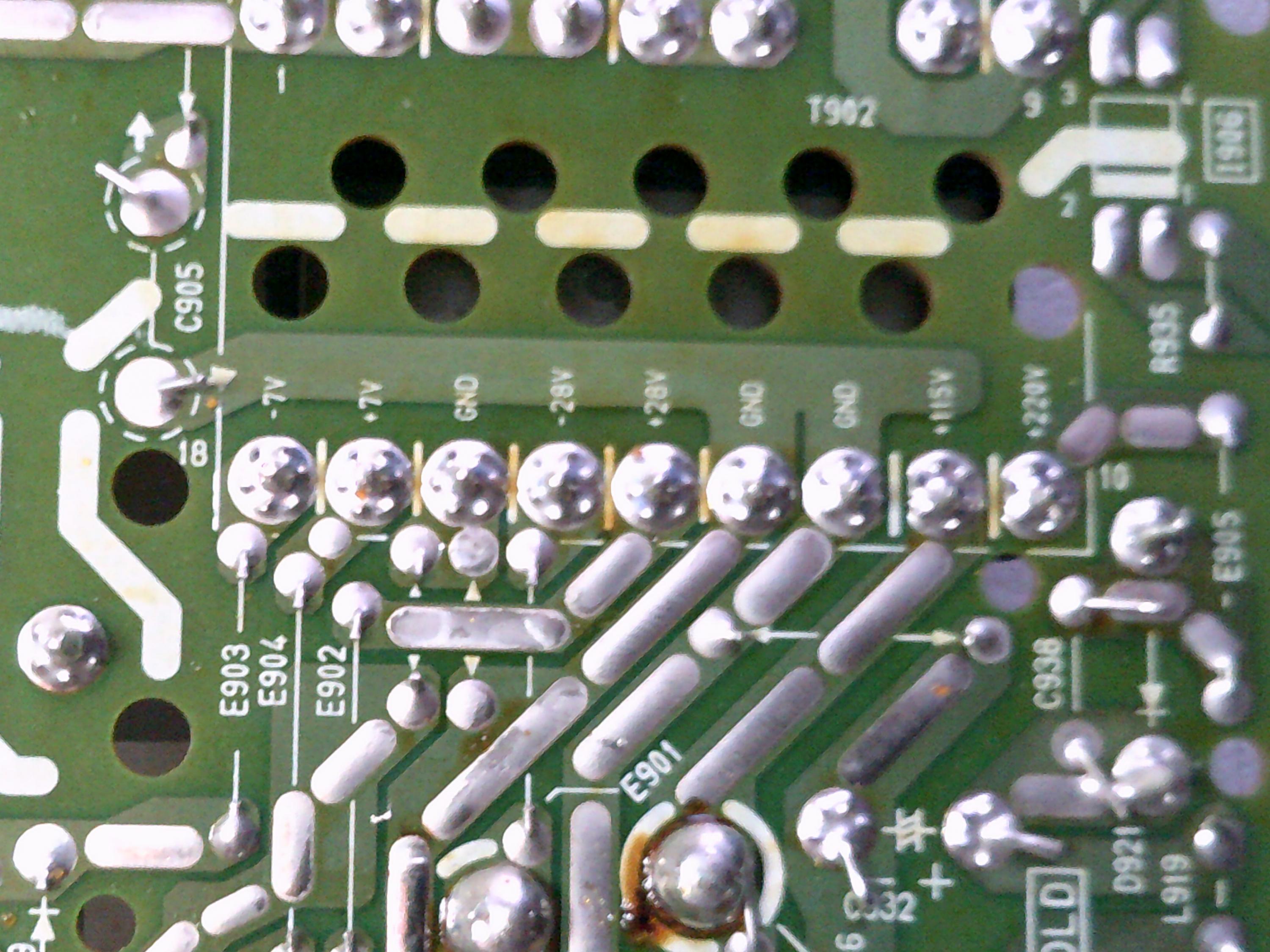

                                Any time you suspect the power supply, first rule is, "thou shalt check voltages." Basically all a PSU does is give you voltage rails. Are they there or not? If they're there, look elsewhere, otherwise, consider the PSU.
                                  Re: Hitachi 46F500 power surge
                                  I noticed voltages printed on bottom of board so I checked each pin.
                                  Most were 13v while the relay made noise then went up to 20v and the led's turned on board.
                                  The 10v was only 3v.
                                  I also noticed when power is applied to board I only get 55v at main fuse.
                                  Seems to be low voltage overall.
                                  The varistor I replaced looks ok but I may pull it and see what happens if I power up the board.
                                  Any tips as to what I should check now?
                                  Edit- I swear I was reading 20v off ground pins also. I may have to recheck that.
                                    The transformer outputs are ac, you cannot measure them with dmm.
                                    You need to measure the output voltages on the connector.
                                    Leaky caps don't cause this problem, high ESR maybe, board uses very good ones though, so it is unlikely.
