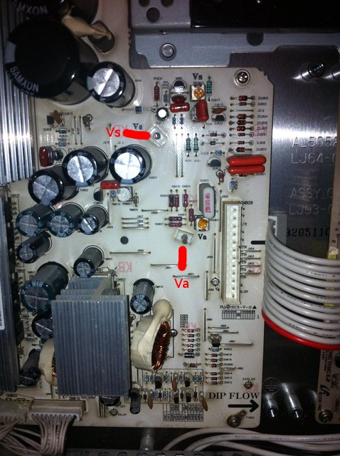

                  Re: SAMSUNG PS42D51SX bad picture
                  Have you adjusted Yrr too?
                  Post a close shot of your power supply (both the main one and the smaller sub-one), I can help you locate the test points.
                    I change and Yrr picture changes but not enough.
                    I checked these values of Volt in the picture -ОК
                    This is a picture of the entire Board
                        OK, the first step is to adjust the VS, VA voltages so that they are within 1V of the specification. (Ideally +/-0.2V.) The specification is on the back of the plasma panel, the sticker that says NTSC/PAL.
                        To adjust you need to measure the voltage at the particular test point and
                        Once you have adjusted those post a picture of the white board adjacent to the power supply -- it has the other voltages on it which are also important for the plasma display to work properly.
                          Va and Vs are perfect
                            Good. Now check Vscan and Vset. There could also be a Ve voltage, though that might only be present on newer displays.
