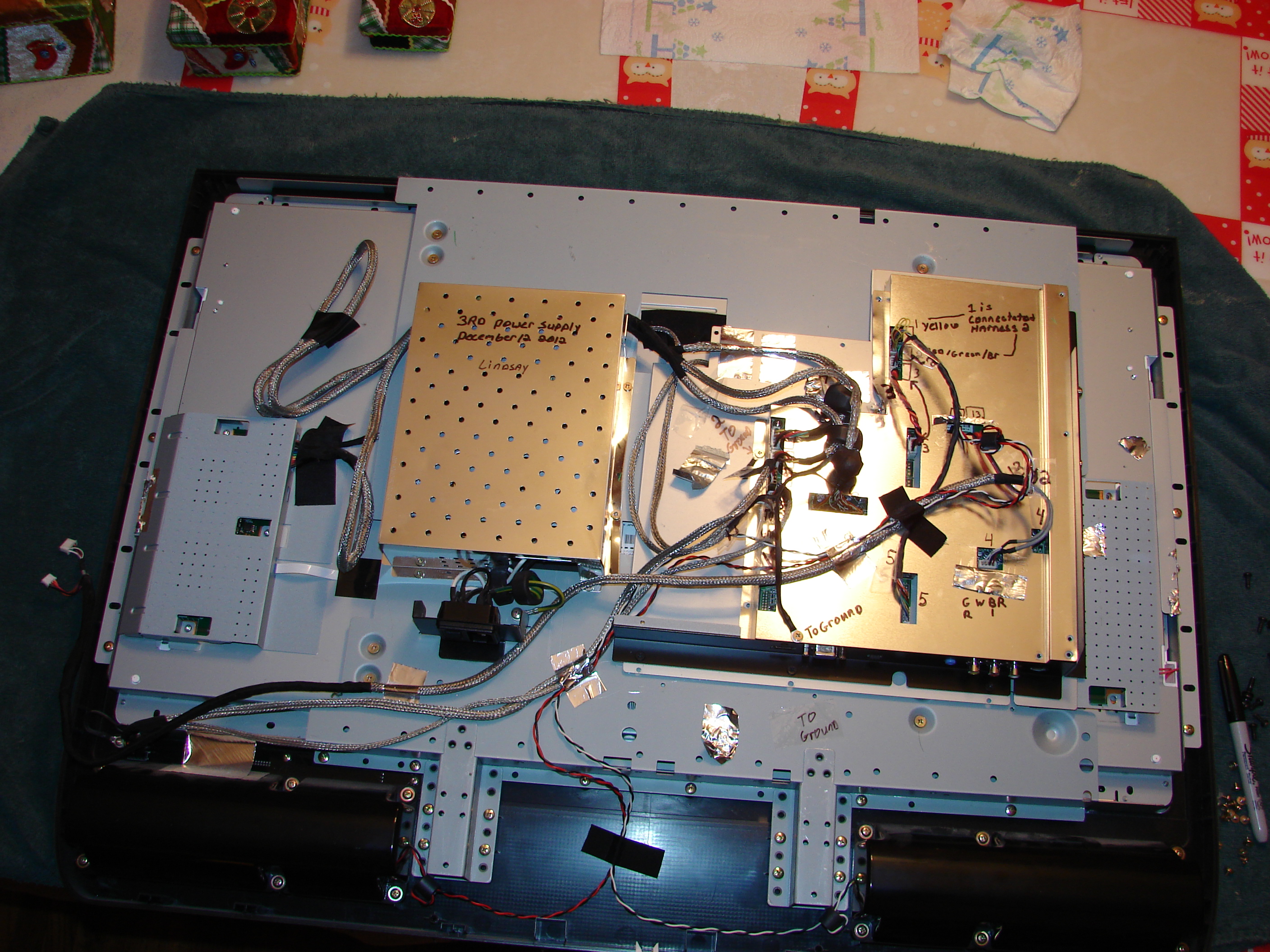

    I have replaced the power board after it would not turn on no leds
    Now it comes on , has sound ,the screen lights up for a few seconds then goes black .
    with a flashlight i can see the image
    whats the problem now.
    Thanks for your help

                  can you do as it says in post 2 and also post pictures of your boards
                  EDit
                  Sorry guess its not night yet over there!
                  Welcome to the forum-
                  We can help a lot more if you please post good clear pictures of the whole chassis, and then pictures of each board, front and back (in the same orientation) and close up of connectors, (max resolution 2000x2000 and 2MB) using the manage attachments button, which is found by clicking "go advanced" under quick reply.
                  Examples of what is needed
                  https://www.badcaps.net/forum/attachm...1&d=1290283049
                  https://www.badcaps.net/forum/attachm...7&d=1280167246
                  It will be useful if you can say a bit about yourself - skills tools etc.

                    Re: Spectroniq PLTV-3250
                    im home now
                    where are the inverter fuses located so far ive looked under both inverter covers could not find any fuses there
                    thanks
                      The inverter boards, one is close to the bottom left corner under the metal shield, the right one looks like is under the shield close to the bottom right corner (not 100% sure). I do not see the pictures of your inverter boards.
                      It looks like your chassis has Master/Slave inverter boards setup. Do they look like these?
                      http://www.shopjimmy.com/protron-hiu...ter-master.htm
                      http://www.shopjimmy.com/protron-hiu...ve-rebuild.htm

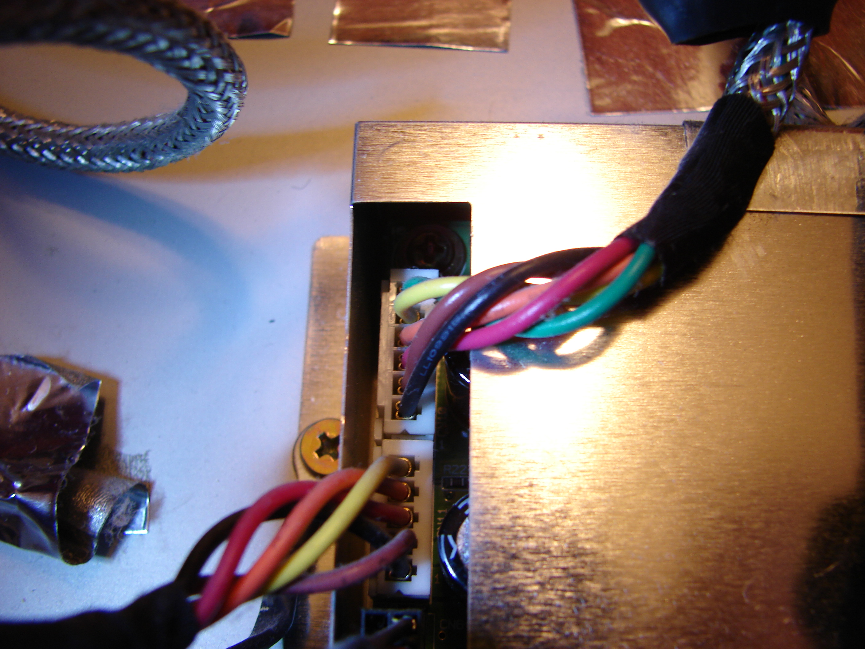

                          ive got it down to the metal plate covering the screen
                          still no fuses power board its the only fuse i see and its good
                          whats the volts the inverters should receive
                            It has fuses on them, F1, F201. Please post the pictures of the inverter boards.
                                getting pics now
                                  just checked fuses they show continuity
                                    OK, check and see if you have 24vdc (black probe on the chassis, red probe on the fuse) on those two fuses of the inverter board when it blacks out, the inverters run on 24vdc
                                        25 volts steady at either side of fuse i could not locate the other position
