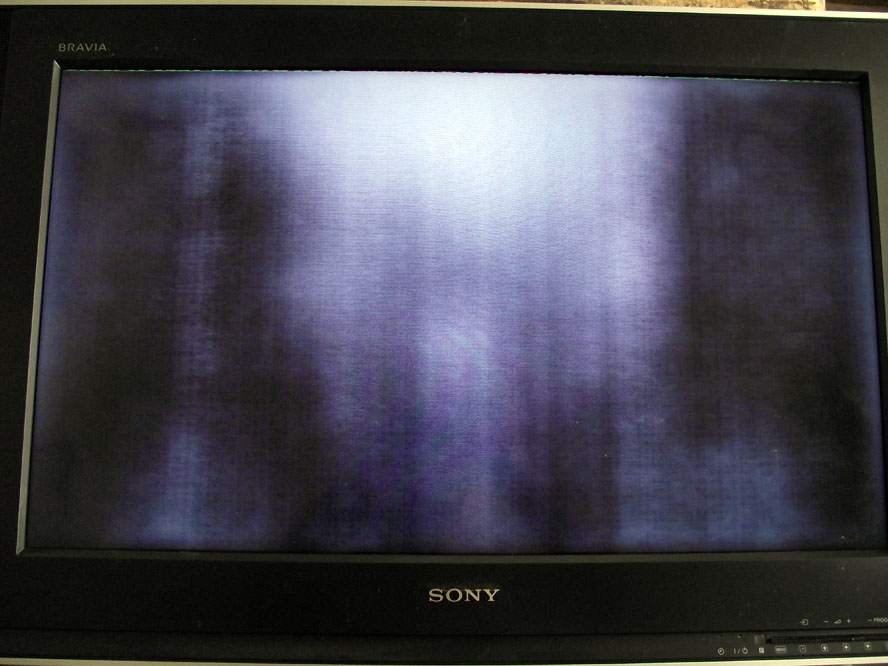

Sony Bravia KLV-26T400A
  • burntfingers
    • Jan 2011
    • 148

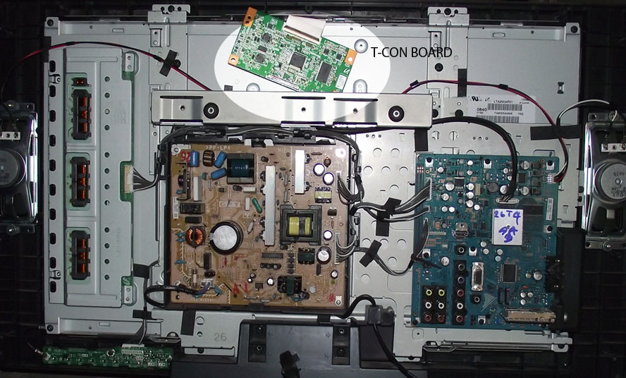

    No picture, sound OK.
    After a while picture appears with bad quality.
    Heating and/or cooling caps no result.
    Shaking plug to T-CON board helped a little, with better picture.
    I removed the flat ribbon, shortened it slightly to have better contacts, but no good results.
    Re: Sony Bravia KLV-26T400A
    Looks like a typical bad LCD panel to me. :/ May be tab bonds, so still fixable...
