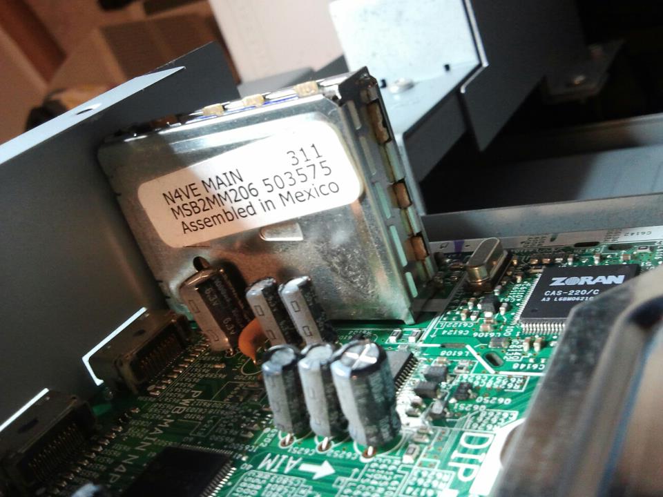

    I have opened case and inspected all boards for visible flaws. All "can style" electrolytic caps appear normal. Don't see any bulges or leaking. Have not inspected any surface mount caps.
    I believe I have done a good job to "prove" the power supply. +5V is ON all the time and is within .2 volts even when driving additional load of "type 1157 automotive stop light." (bulb is dim.) +12V and +24V switch ON and OFF to match "green power light" on front of set. +12V is within .2 volts even when driving a single automotive stop light. Hooked two stop lights in series to test +24V supply and it is within .3 volts also. The TV will stay "ON" all day, meaning correct PS voltages are present. No sound, and no picture all day too!

    • BigJim42
      • Dec 2012
      • 13
      Re: Sanyo DP42647, No Sound, No Picture, Can Switch ON/OFF by Remote or Keypad, USA,

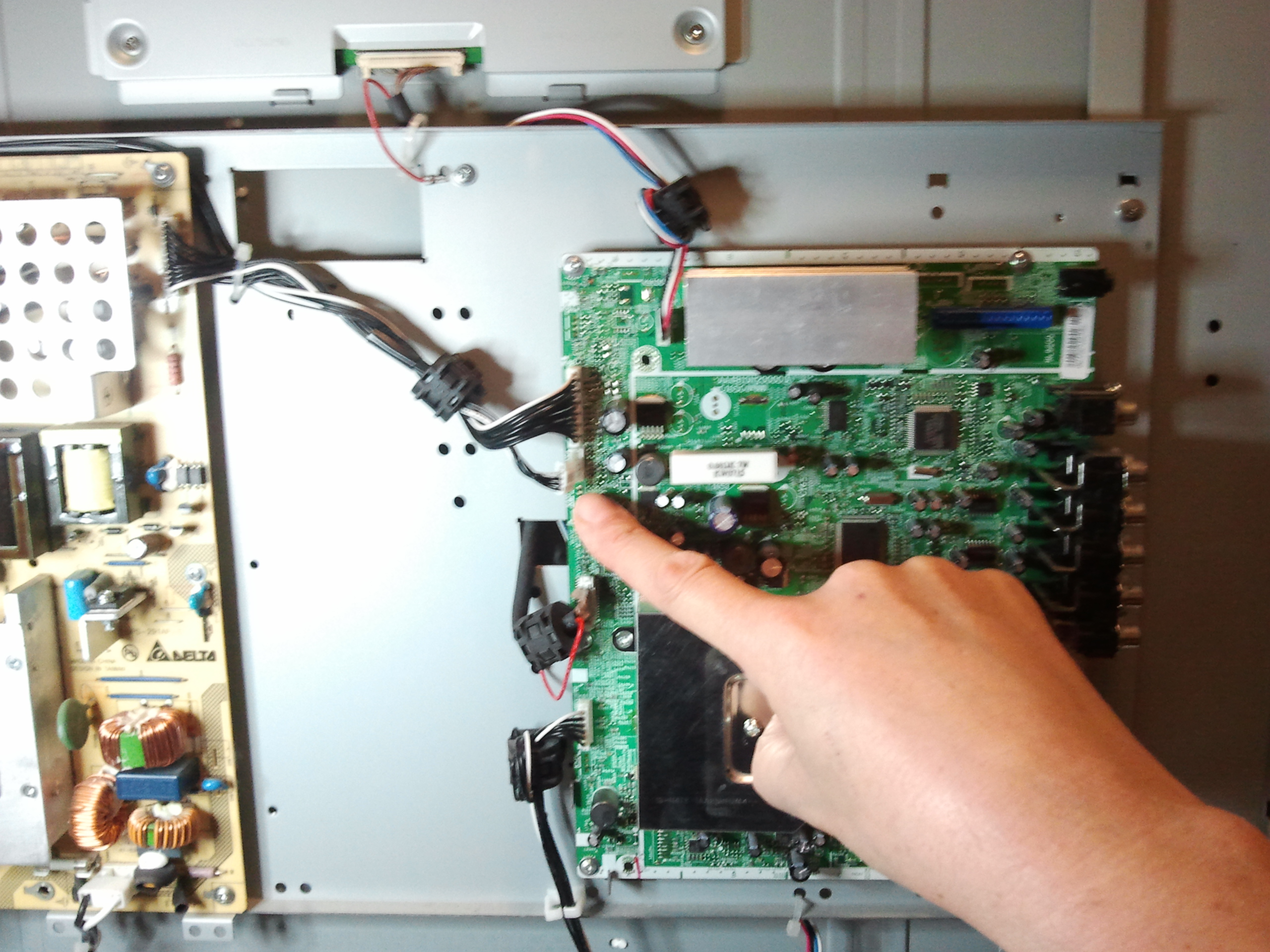

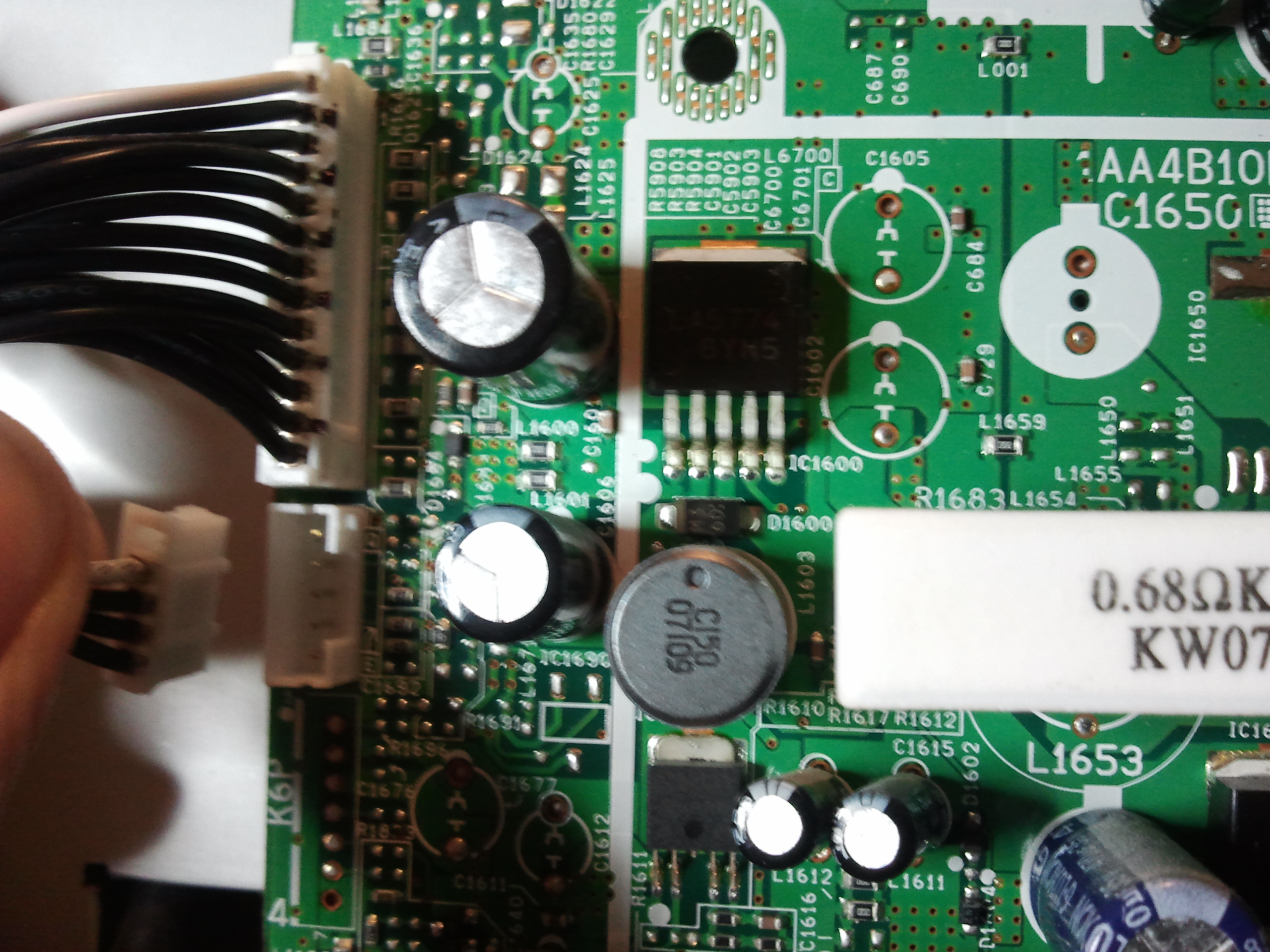

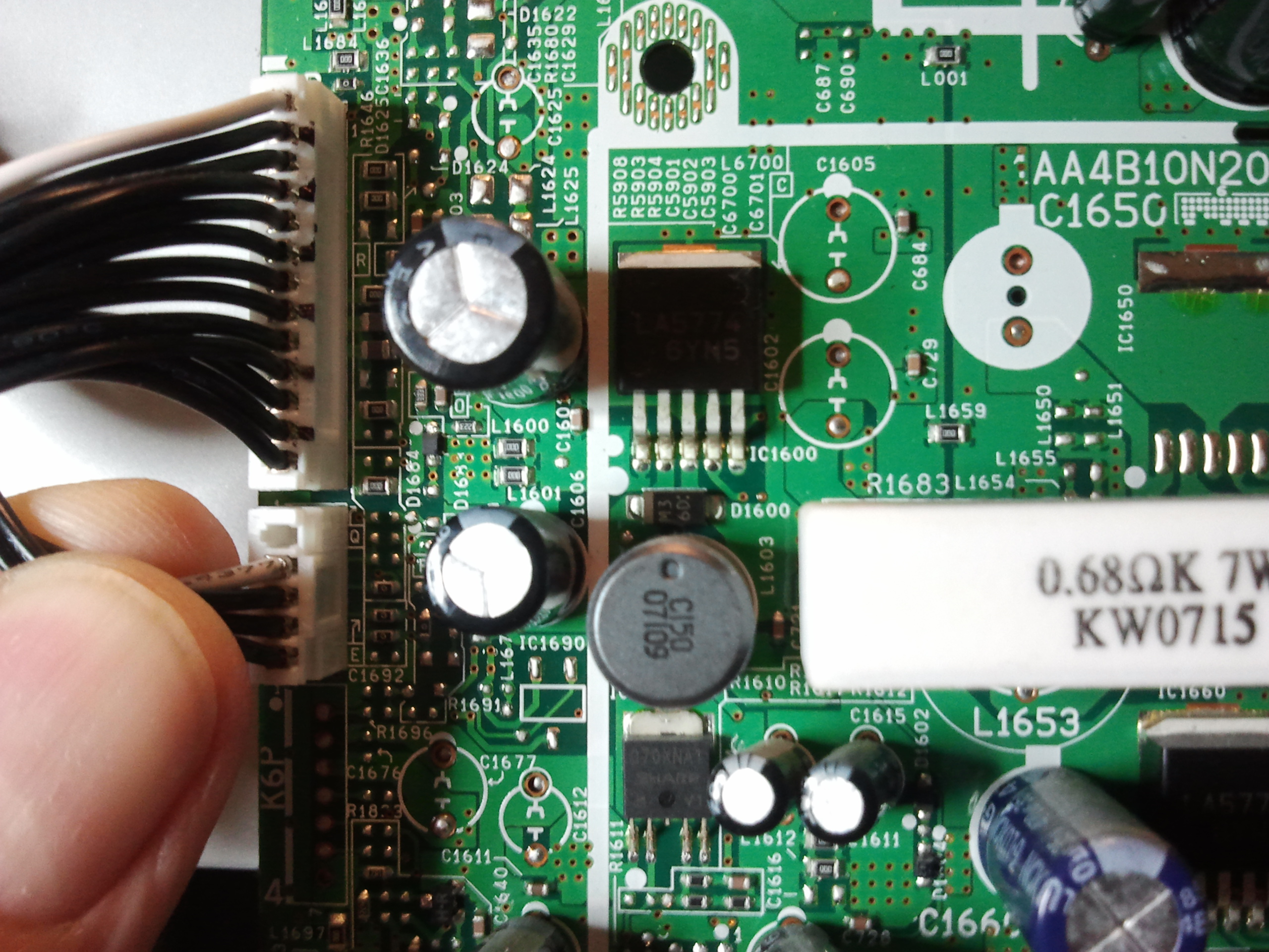

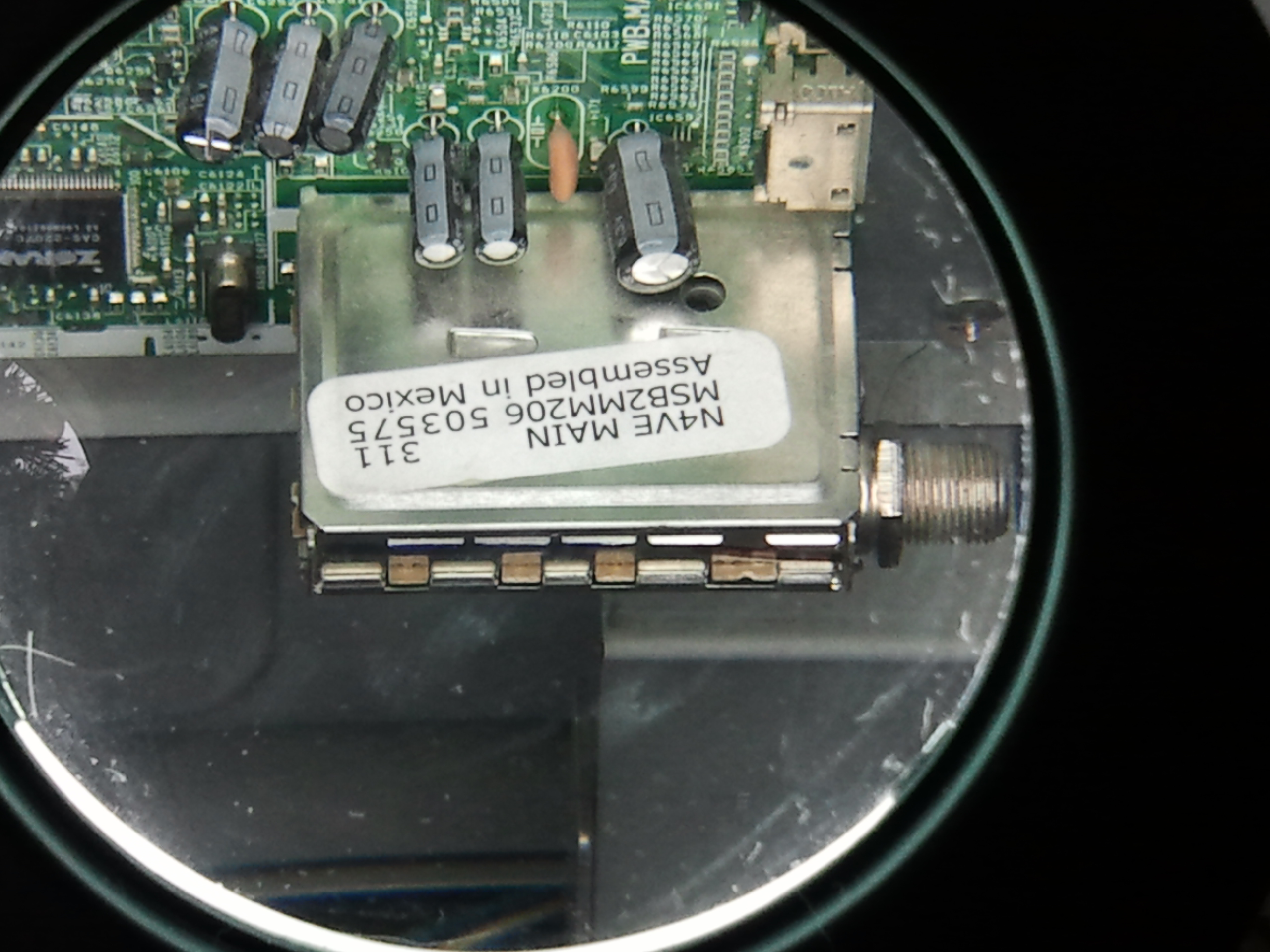

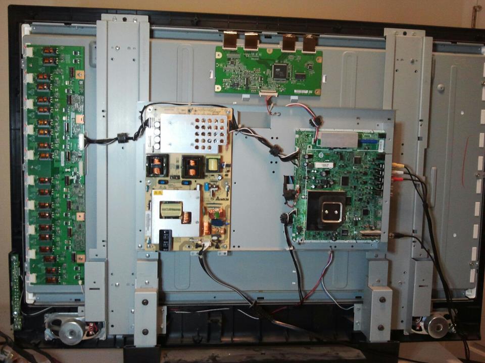

      First pictures. Sorry about poor lighting. Will remove boards and photograph outside if requested.

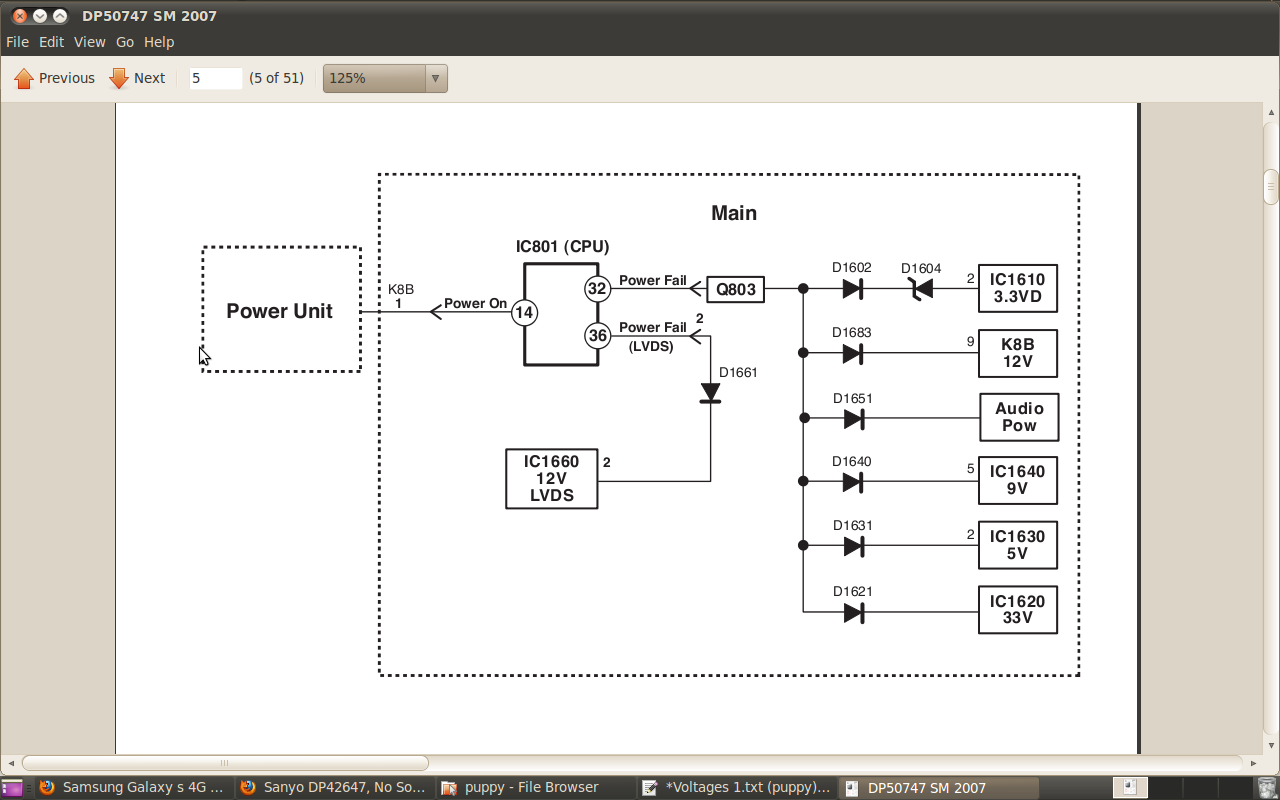

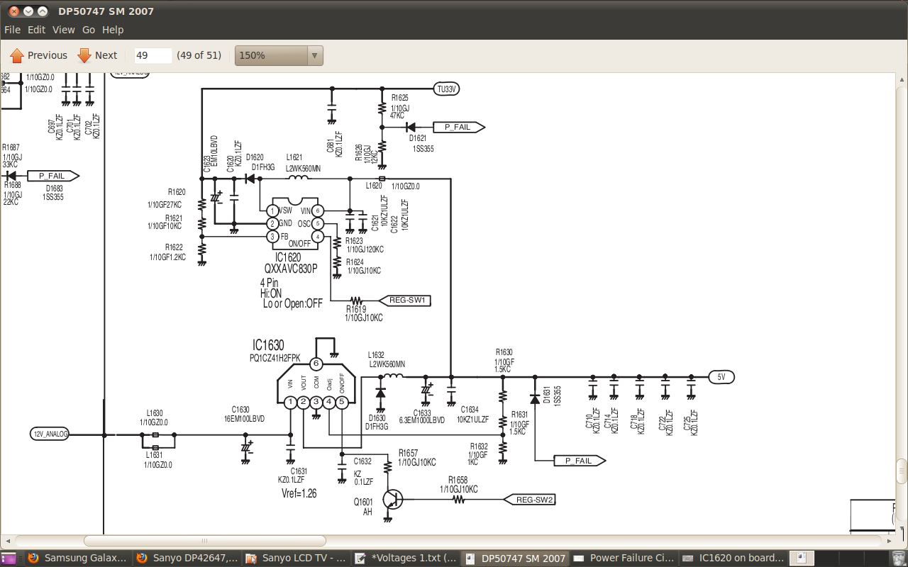

        1) From the service manual (page 30 and 31), it looks like you have some DC-DC converters.
        IC1600 is
        IC1620 is
        You can find IC1630 and IC1640 on your own.
        2) You might want to check to see if they are outputting the correct voltage.
        3) On page 27, there is a block diagram of the main board. There seems to be a lot of test points highlighted in black. Maybe check to see if those voltages are present and correct.
        PS. I suck at reading schematics.

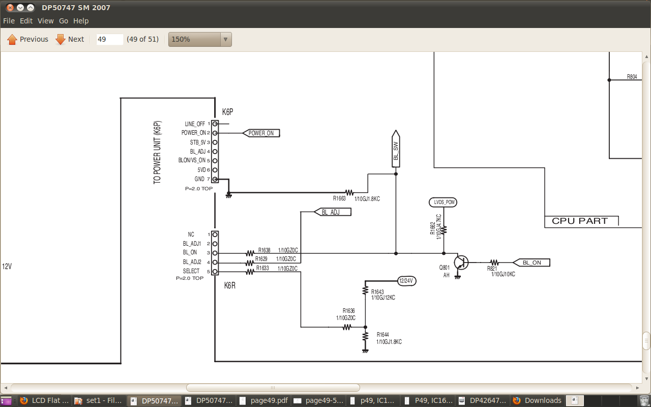

            See below the voltages I have measured when the TV is ON. "Part I" is the voltages associated with the "Power Failure Circuit" shown on page 5 of Service Manual. All voltages checked except "Audio Power," which I did not measure. Haven't figured out where to measure this. I guess I should come back to this since "NO AUDIO" was initial failure mode. On the other hand, I do believe I am getting "Power ON" signal of 4.55V measured at P1 of connector KB8 on main board. I heard hum from my fluorescent lamp come from at least one speaker when I was probing voltage at P1 of IC1640.
            "Part II" shows voltages at KB8 and K6R connectors at main board. Voltages at KB8 appear consistent for a powered on TV with fully functional power supply. I believe P2 voltage at K6R is the "back light on signal" according to schematic on page 5. (see attachment BackLight ON circuit"). It appears to be at logic level "LOW." Do you concure? How might I force this to logic "HIGH," so that I might see all the backlight bulbs turn on? Also P5 is labeled "SELECT" and is set by a resistor network at 3.15V. Does this seem high enough to be considered logic "HIGH"?
            You have already suggested I probe voltages on circuit board shown on p.27. That would be the voltages I've reported here, plus a few other test points. I'm still working on that step.
            Thanks in advance for any suggestions or observations you can make. I would really like to see the backlights turn on.

            . P2 153mV - 156mV varies
            . P3 38.7mV BL_ON signal, according to Schematic on p.49
            . P4 775mV
            . P5 3.15V
            • retiredcaps
              • Apr 2010
              • 9271
              As I alluded to in post #5, BL_ON usually has to be 3V or higher. You can force it on by disconnecting all the boards and using 2 AA batteries in series or one 3V CR2032 battery. Note you probably have to force on PS_ON (power supply on) as well to produce the voltages for the backlight/inverter to work.

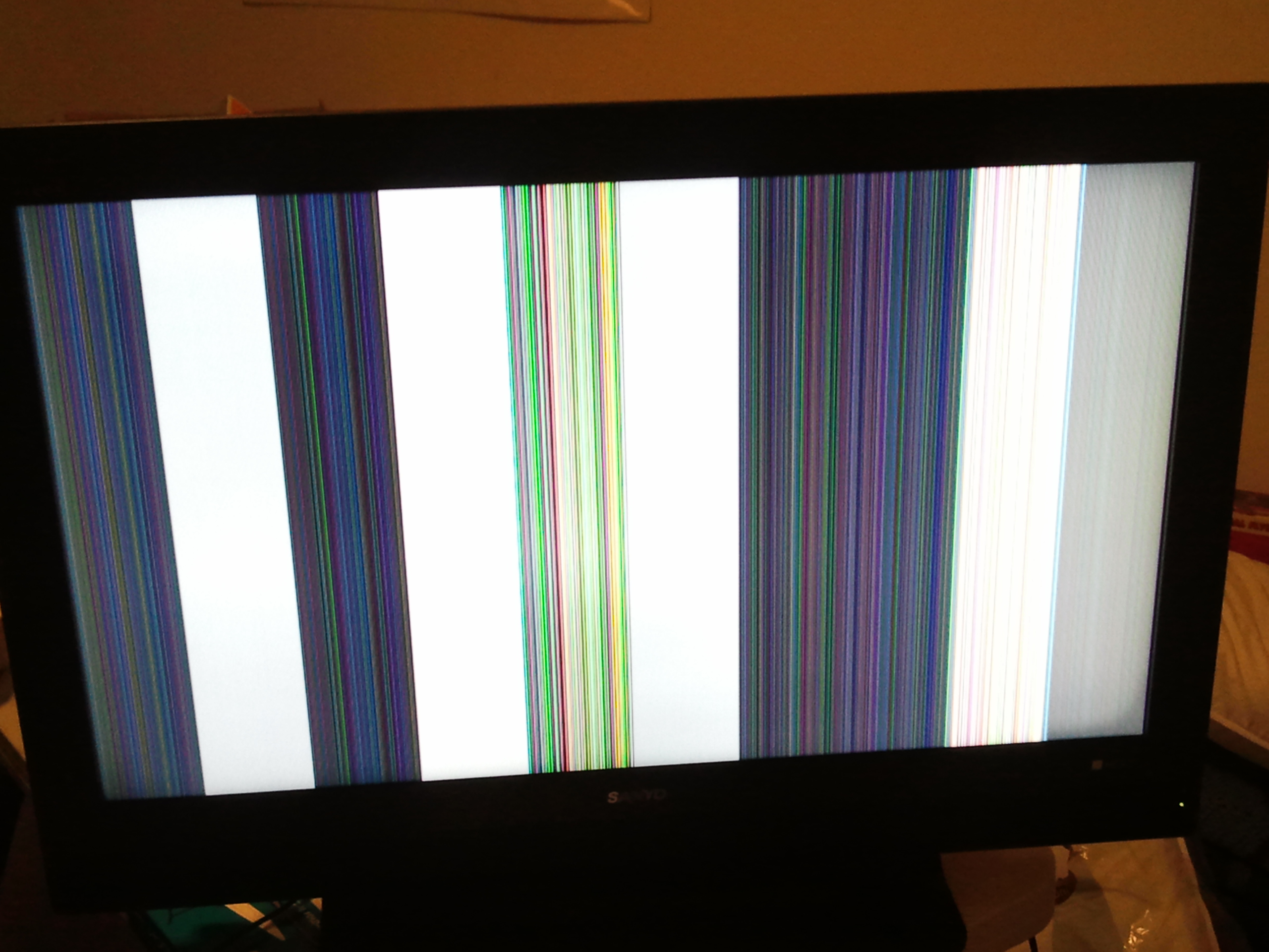

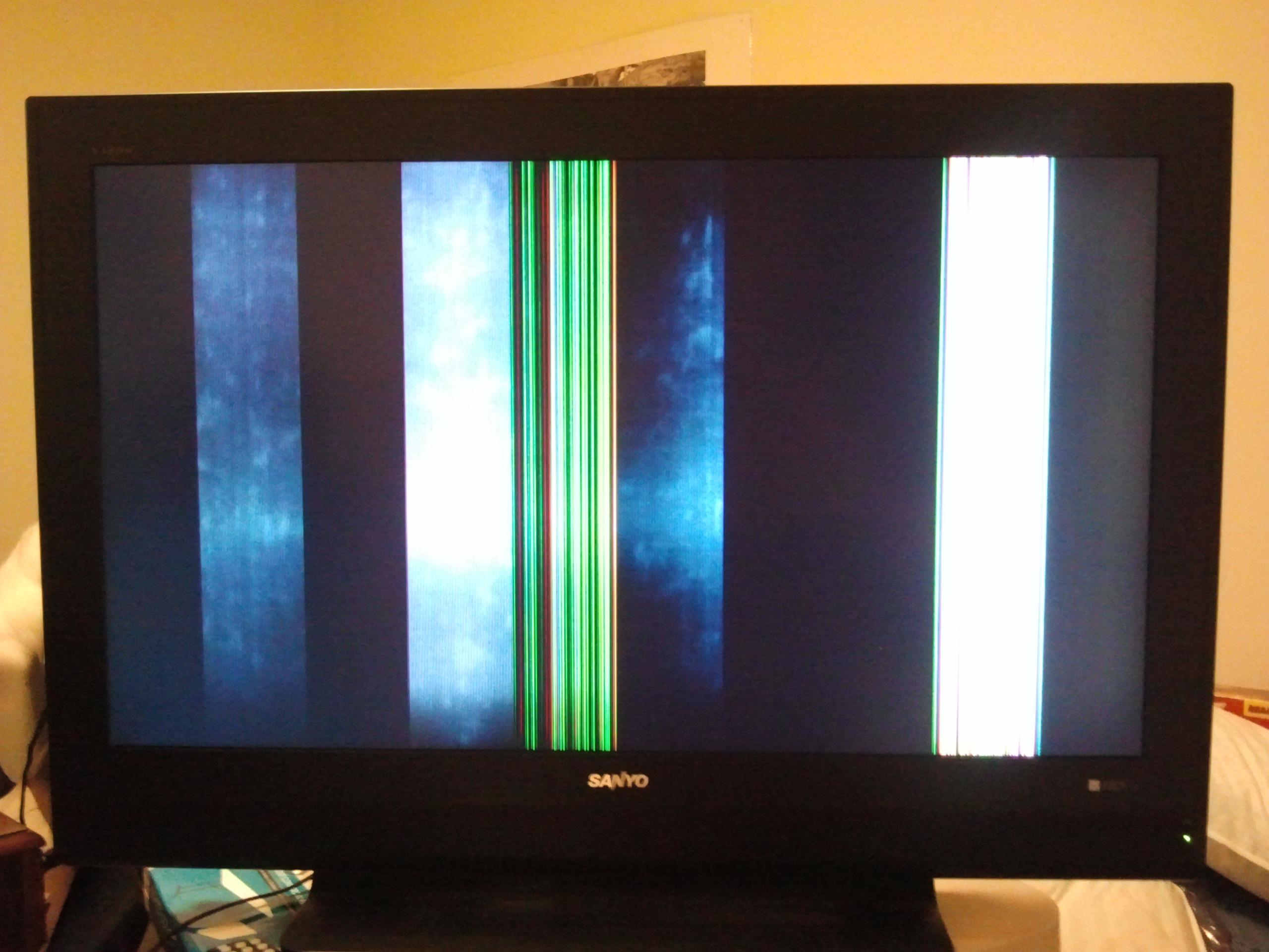

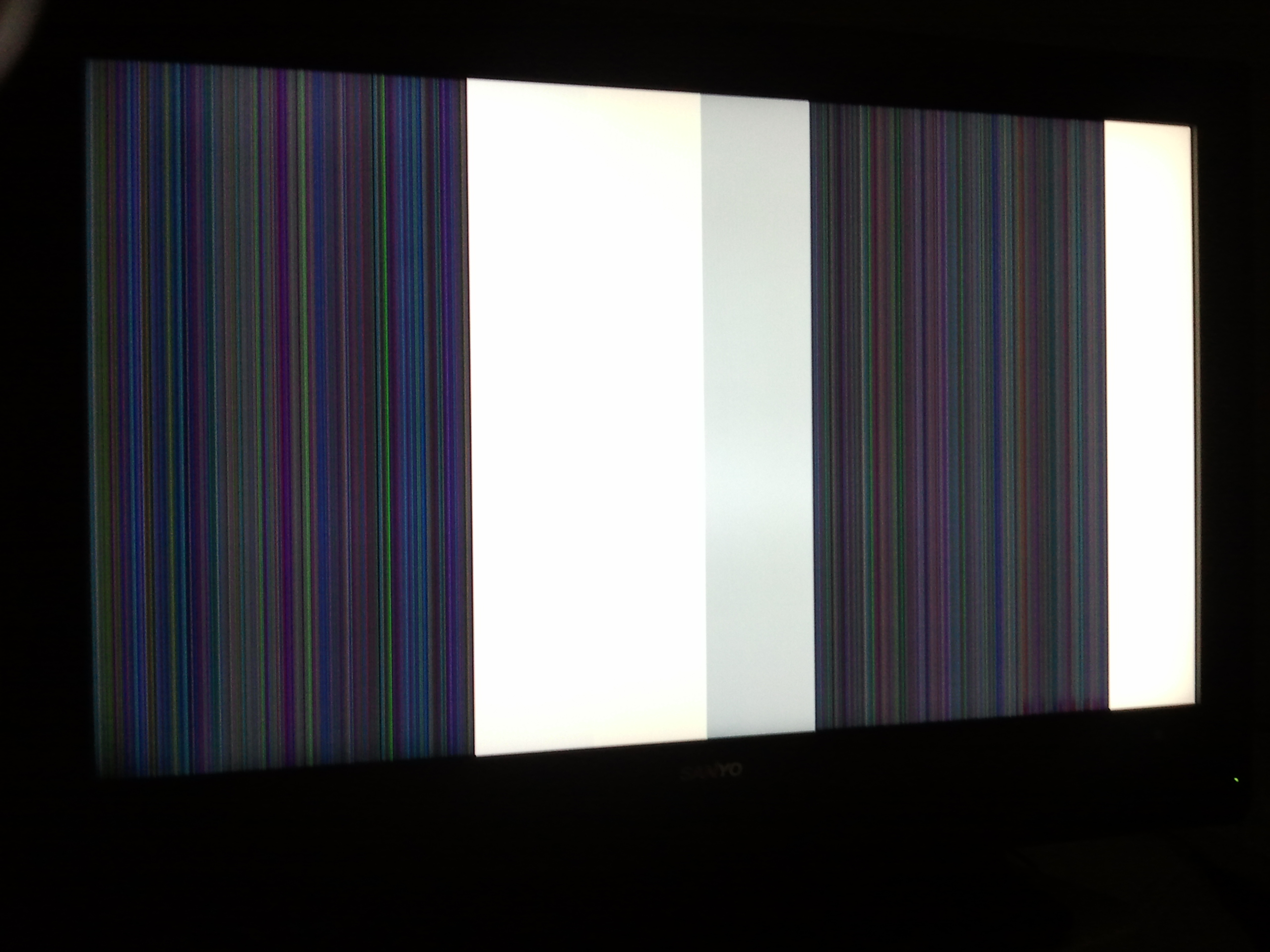

                  I haven't found the Audio Voltage yet, but I did manage to force the BACK LIGHT on. I attempted to apply a voltage to the BL_ON signal, but had no success with that.
                  I did get the back light tubes to turn on. I unplugged connector K6R and then turned on the set. The backlight comes on now, with K6R disconnected. I still have no audio, and only vertical lines on the screen. There seems to be ten "zones" across the screen from left to right. The pattern may change if the set is turned off and on.
                  Can someone please look at the attached pictures of the screen and let me know if it means the problem is on the main board? How long should it take for backlight to reach full intensity? I'd guess it takes at least one minute. Is that normal?
                  Thanks for all replies.
                  BigJim

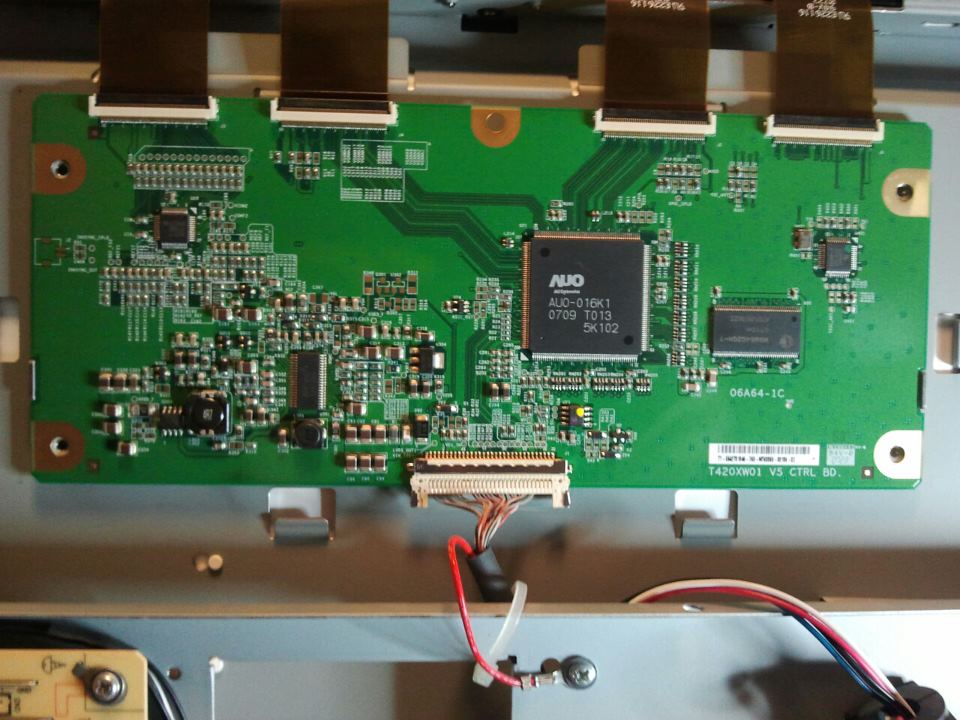

                    Have you checked the DC input to the T-con board? If that is low, you may see that effect.

                      I am having the same problems as you, with an identical set. I did not want to hijack your thread, so i started my own thread addressing the issue. Here's a link to the thread.
                      https://www.badcaps.net/forum/showthread.php?t=31167
                      BigJim
                      Incase you pick this repair project back up, let me save you a couple of bucks. Its not a problem with the main board. I purchased a new main board and it did not help... Here's a link to the board I purchased.
                      http://www.tristatemodule.com/p-2130...20xw01-v5.aspx
                      Hopefully we can figure this out!
