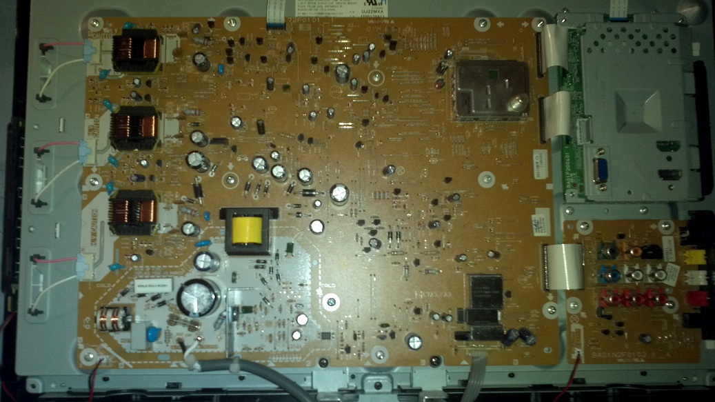

Philips 22PFL3505D/F7 no power
    Philips 22PFL3505D/F7 no power no nothing no light
    does anyone know what could be wrong if theres no power at all?

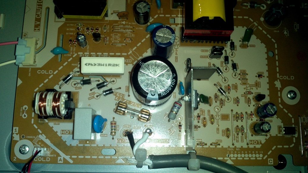

    Check if the mains fuse is intact.

      Tom- he is asking in another thread what the <PH>3W1R2K is - dont know why he didnt ask in here - Do you know -is it a 2k cement resistor?
        Re: Philips 22PFL3505D/F7 no power
        I found a site where it states that this is a 3 Watt 1.2 Ohm 10%Tolerance.

          Power usually travels through the fuse first and then through the rectifier. In this case, they are using four individual diodes as the rectifier. Check all 5 of these components first. When checking these in this case of no power, check for cracks in components, blown fuse, cracks in solder joints, traces...etc.
              it seems to be intact as far as i can tell tried swapping it with one i got from a ps2 psu no difference. and everything else looks fine as far as my eyes can see.
                i posted that before this one mainly wanted to know if it was a fuse as well.
                  they appear to be intact i am stumped as to whats wrong with it do you think it could be the caps? ive tried replaceing a few with no luck.
                        Its Dgtech you have to thank -he found it and I messed up the quote when just agreeing.
                        Edit
                        Good - see you spotted it.
