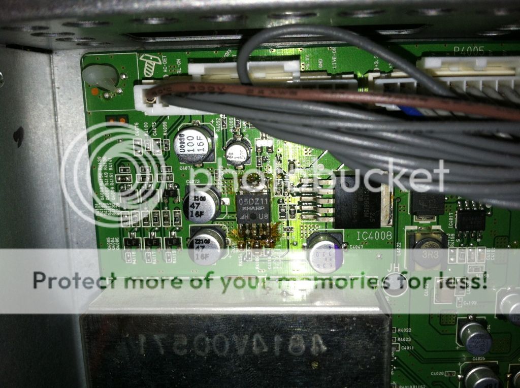

            Well, I got the scope and found a wave at the very first point. However, I also bought some reading glasses today and found this when I put them on. I'm not sure how I missed it before. Obviously, someone's been here before me.
            I probed the pins and found.
            Top leg
            5.0V
            Bottom 5 legs from left to right
            6.0V
            3.2V
            0.0V
            0.0V
            0.0V
            Would a bad main board produce a similar "no picture" fault?

              Re: First plasma, LG 42PC5D. Sound but no picture. Help me make sense of this.
              The top leg and middle bottom leg need to measure the same, check your probing.
              Could also be factory rework.
              Have you tried in a COMPLETELY dark room for the slightest glow... it may be very faint....

                    I rechecked the regulator on the main board. I either misprobed it or didn't remember it right because it has 5v at the center pin now.
                    I think it's gotta be the panel. I just unplugged the ysus and powered it on and there is absolutely no buzzing before the speakers come on. Did you watch the video I made? Coul you hear the buzzing?

                        The top pin of connector P800 labeled 3.4V_ON shows 4.75V when on and 0V when off. Does that mean anything to you? I will be parting this one out with the assumption that the panel is bad if I haven't figured anything out by this weekend.
                          #52
                          3.4V_ON just turns on the 3.4V output, so it's a logic signal around 0V off, 2~5V on.
