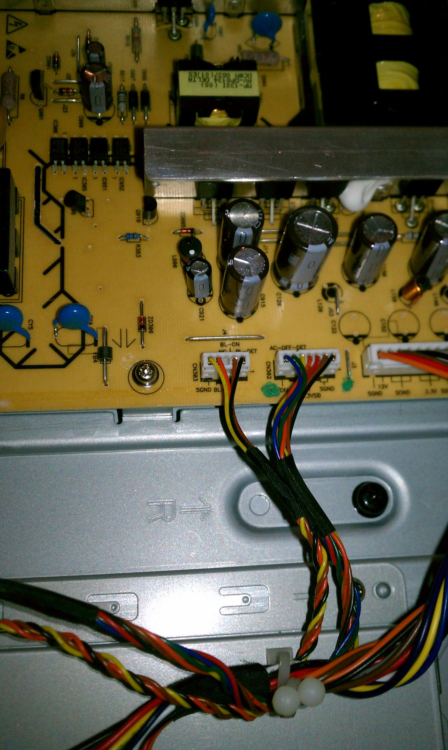

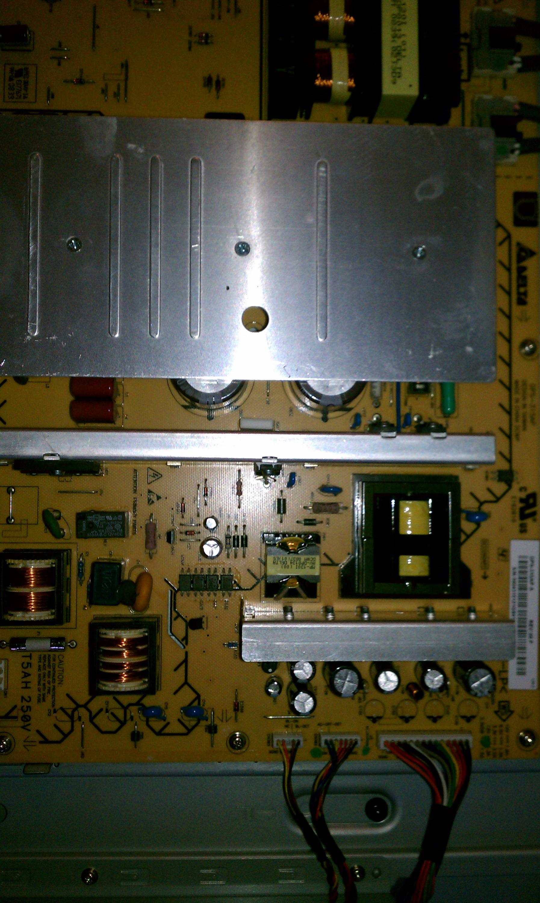

    I am looking at my brothers TV he has a Sony Bravia KDL-52S4100 it has no sound or picture. When the power button is depressed the light located under the panel turns green. I removed the back and immediately checked the power supply for bad caps. There were none. I then proceeded to check all of the output voltages on the power supply. They were not perfect, but very close to nominal.
    I then removed CON3 from the power supply which connects to the main board and the back light illuminated. I think there might be a problem with the main board. I have checked to just try to purchase a main board (48.71H01.31), there are none to be found. I assume this must be a huge problem for this model.
    If you have any ideas on where I should start troubleshooting on the main board I would like to hear them.

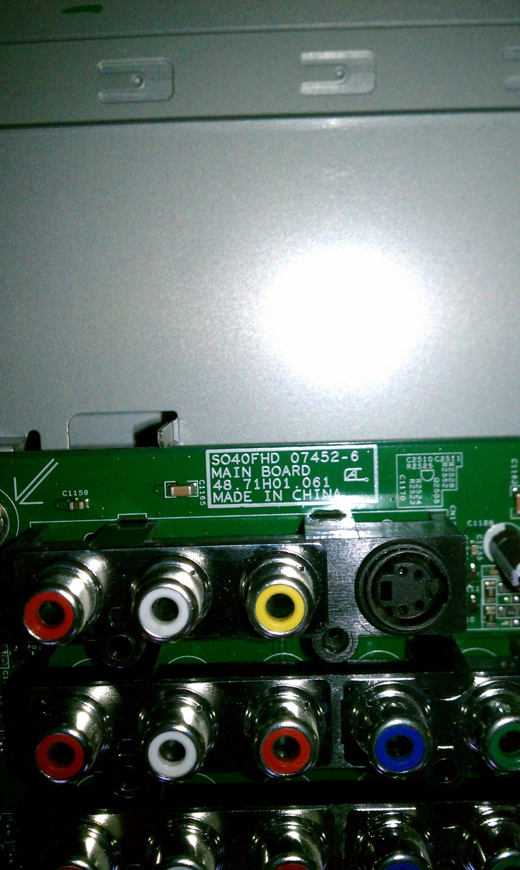

    I'm looking for my digital camera once I find it I will take better pictures of the boards that in question.

    Re: Sony Bravia KDL-52S4100 No picture or Sound
    The part number for the main board for this model is 185722711. I did find a few available but they are horribly expensive. (One site listed it for over $800.00 USD.) So the board replacement option is probably out.

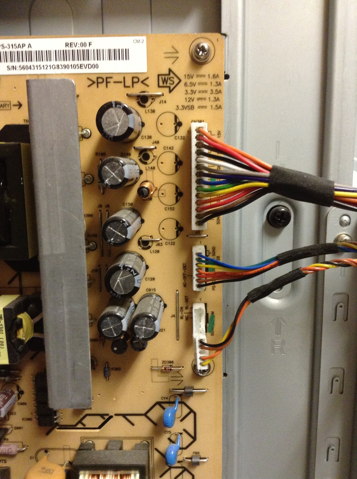

                      Old topic. But I now have the same TV with the same issue. I've disconnected the above cable with the same results. I've used a voltmeter to test the voltage. There's 5 volt on the b-on when cable is diconnected but loses it when cable is connected. I'd like to attempt to repair the main board instead of replacing it because it's a little pricey and hard to find in stock. If others can repair then I'm sure I could as well. besides replacing the board, has anyone figured out if an IC is causing this issue. Seems like it's grounding out or something.
                              with a steady green light , you can try a firmware update, if you can find the firmware, in some cases it fixes the problem, maybe check sony's site for it.
                                Firmware update is out of the question. Unfortunately I'm unable to see an image on the screen to attempt an update plus screen went out while watching TV. Can't be a firmware issue.
                                  thats the problem, everyones positive about everything, you dont need to see the screen with the kdl to do an update. bye now.
                                      As much as I don't want to admit I was wrong, that fixed the set. You sir are a god. I can't believe that's all it was. I would give you a great big hug if I could. I applaud you
