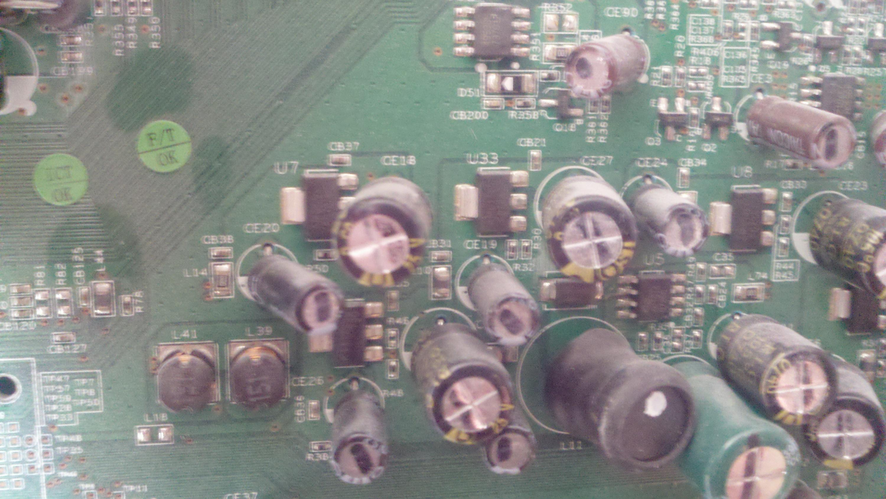

    So i just replaced a bad regulator on a Vizio i have. It powered on with backlight but no sound or no image whatsoever. Also it couldnt be turned off once turned on unless you unplug the power cable. Well I recieved and new regulator and replaced it and when i turned it on i had an image of (channel 37) and some vertical blue lines on the screen. It also turned off from the side inputs which was good but when i check the voltages on the new regulator the adjust pin reads .01 V. I know this is wrong and there is a few resistors that i dont think i touched but maybe its possible i unsoldered one because one of them reads 2.02 V and the other reads nothing. Not sure because i didnt test them before (stupid) Now its back to the old symptoms tho and i get no picture/wont turn off. My question is can i adjust the last pin back up around 1-2 V where it should be or did i blow this new regulator already? Any help would be appreciated thank you.

        u33 reads:
        Yes pin 1 reads 5.07 and pin 2 reads 2.02. Pin 3 is reading .01
        which would mean its bad right. I checked U7 too which is connected to U33(the one i replaced)
        u7 reads:
        pin 1- 2.01 pin 2 - .97 pin 3 - .02
        i will check the resistors tonight when i get off work. But appreciate anything you can add to help.

            My question is can you manually adjust the 3rd pin on U33? i know the voltage is wrong but i literally just got it in the mail today. If not im just goin to order 2 new regulators and replace both U33 and U7 and hope for the best.

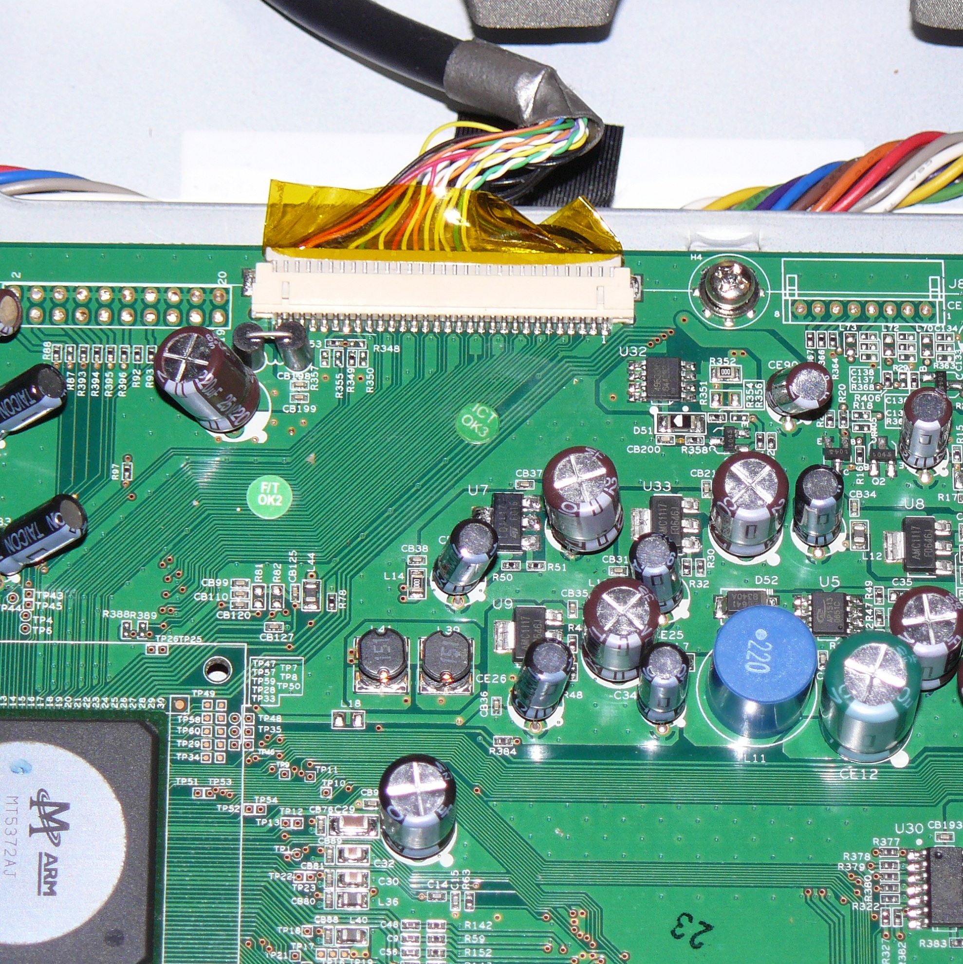

                    You may have damage the resistors or thy came off during de-soldering. Do you have good clear pictures of these two regulators.
                    I just upload the calculator for the LDO in post 8
                      Re: 32" Vizio Fixed Regulator. How do I/Can I adjust
                      I look at SHOPJIMMY and see that both regulators have two resistor close by. Do you know what the output voltage should be? I can try searching the forum for U7, U33 but that may take times.
                      If the resistors are still there, you can give me the value then I tell if they are correct or not using my calculator.
                          yeah i only have a pic of from before until tomorrow.
                          alright i set the multimeter to 2000 ohms and:
                          R30 read: 354
                          R32 read: 1 (thats what it reads when not even connected to anything, So looks like this is bad or damaged)
                          CB21 actually made the meter dim out and displayed nothing. Not sure what that means
                          I may be looking for a new board as it looks. I may have burned something when taking out the original. It doesnt look pretty

                              I search the forum and it looks like R30 is connected between the ADJ pin and Ground, the R32 is connected between the ADJ pin and the Output pin. So you must have solder bridge between ADJ and the output pin.

                                Alright i didnt realize there were 2 readings for them.
                                R30: Top of pin(in pic) 354
                                bottom 6
                                R32 top: 351
                                bottom: 1

                                      yes I dont know when i touch the top(in pic) or piece closest to regulators they read 354 ohms and 351 ohms. on the opposite side one doesnt read anything and one reads 6. (on 2000 ohms setting) its very possible that there may be a solder bridge tho. im not the most precise yet haha
