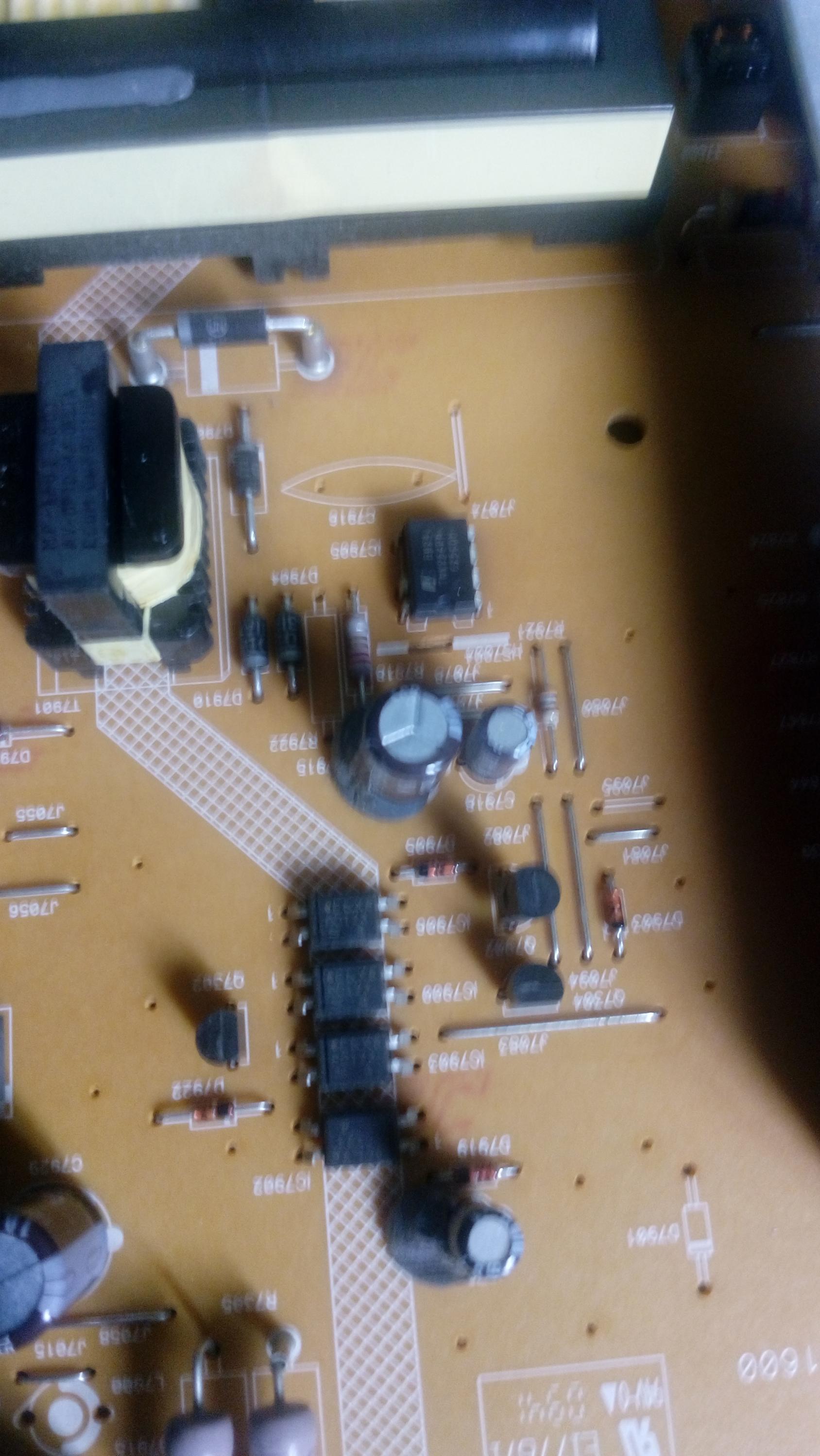

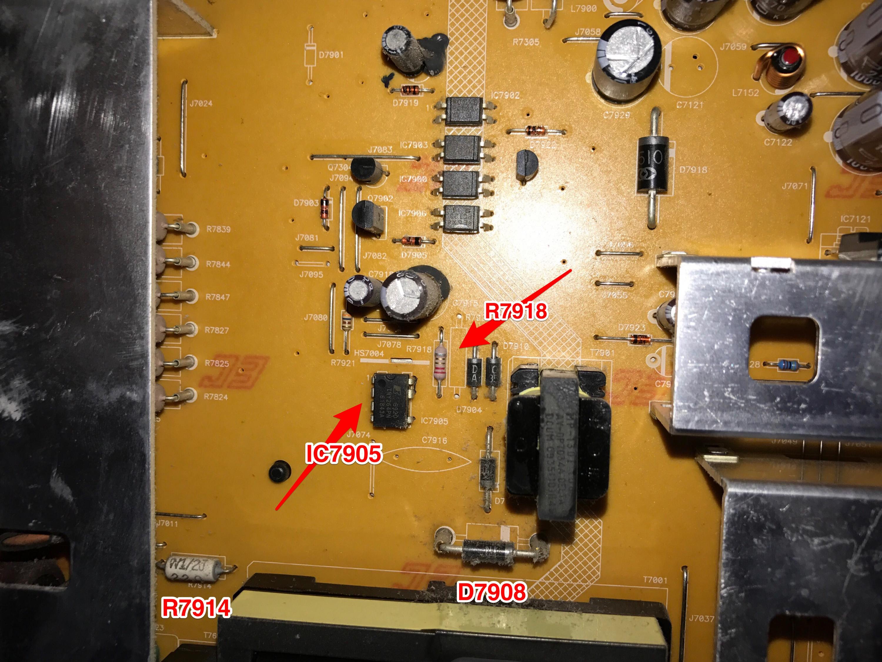

          Re: IC Number on DPS-286 AP/RDENCA336WJQZ Sharp power board
          I just wanted to say thanks for this thread, it got by DPS-286ap up and running again. I ended up replacing R7914 (failed open), R7918 (seemingly OK at 2.2ohm), IC7905, D7908, and D7905 (showing around 400ohm).

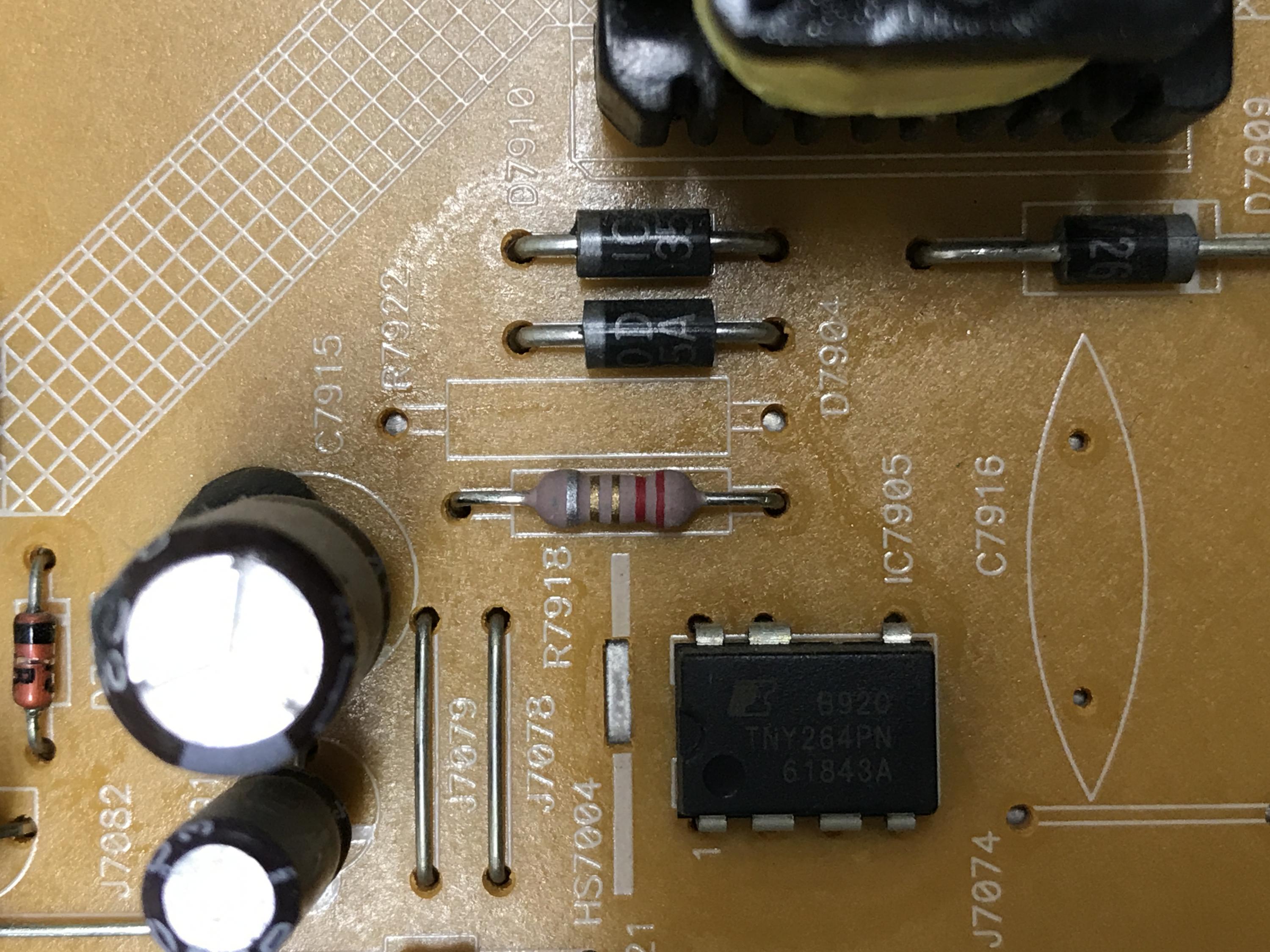

            #65
            Did you replace all the components or only the R7914? when i replace the R7914 always blows.

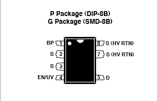

              #66
              It blew open circuit because you have shorted component on the output side of the R7914, check the resistance of the STBY SMPS IC7905 PIN 8 and Primary circuit GND for very low resistance.

                      #70
                      Correction, is your IC TNY264? If it is, then it will pin 6 and GND.

                          #72
                          Sorry, typo, it is pin 5 the Drain pin.

                              #74

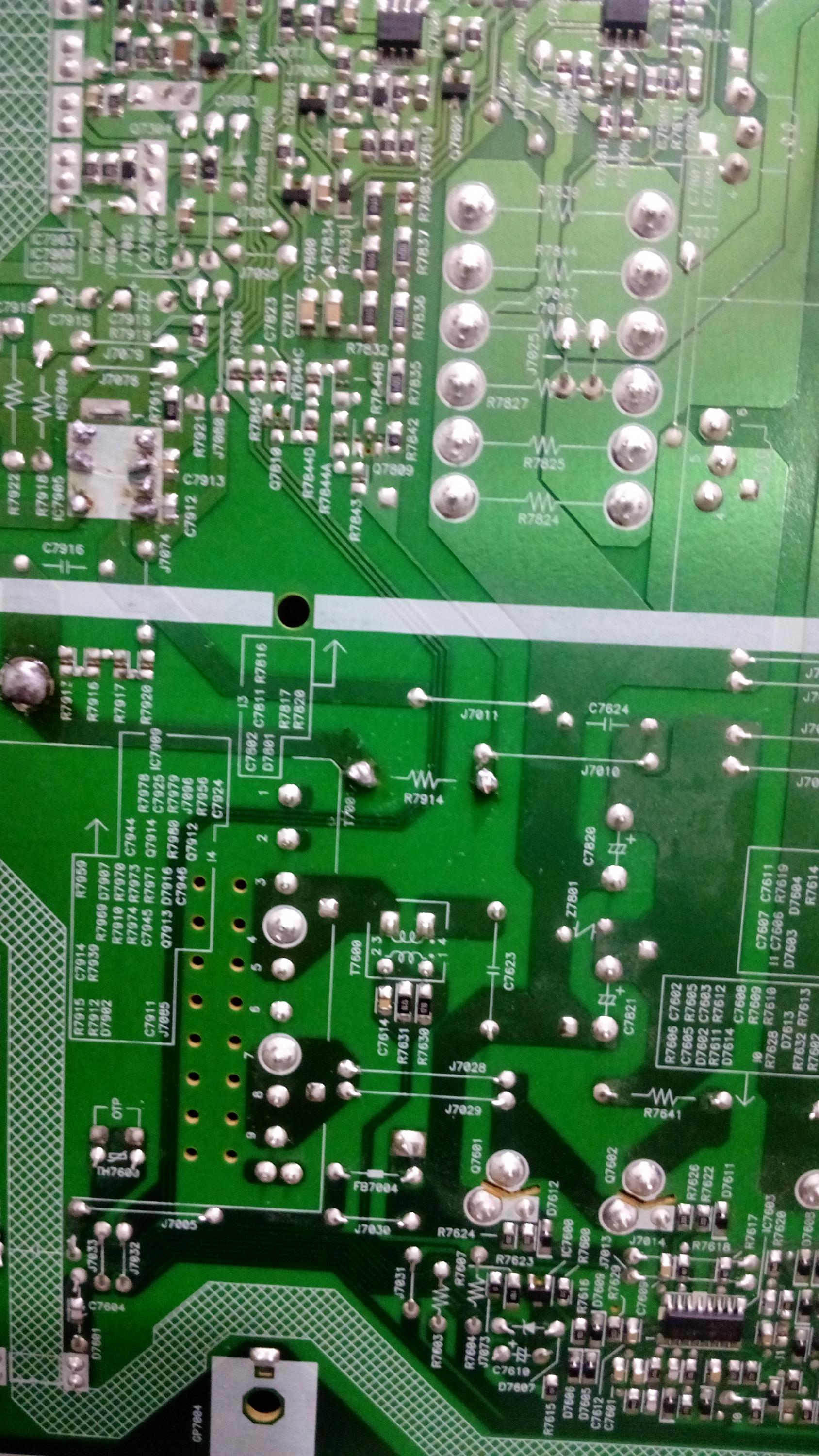

                              Hi Budm,
                              I have same issue, I find R7914 open ans I change it using resistor 2.2ohm 1W, when I on the power the new resistor directly blow,
                              Please advice
                                #75
                                Check pin 5 and GND pin of that SMPS IC as shown in post 71.

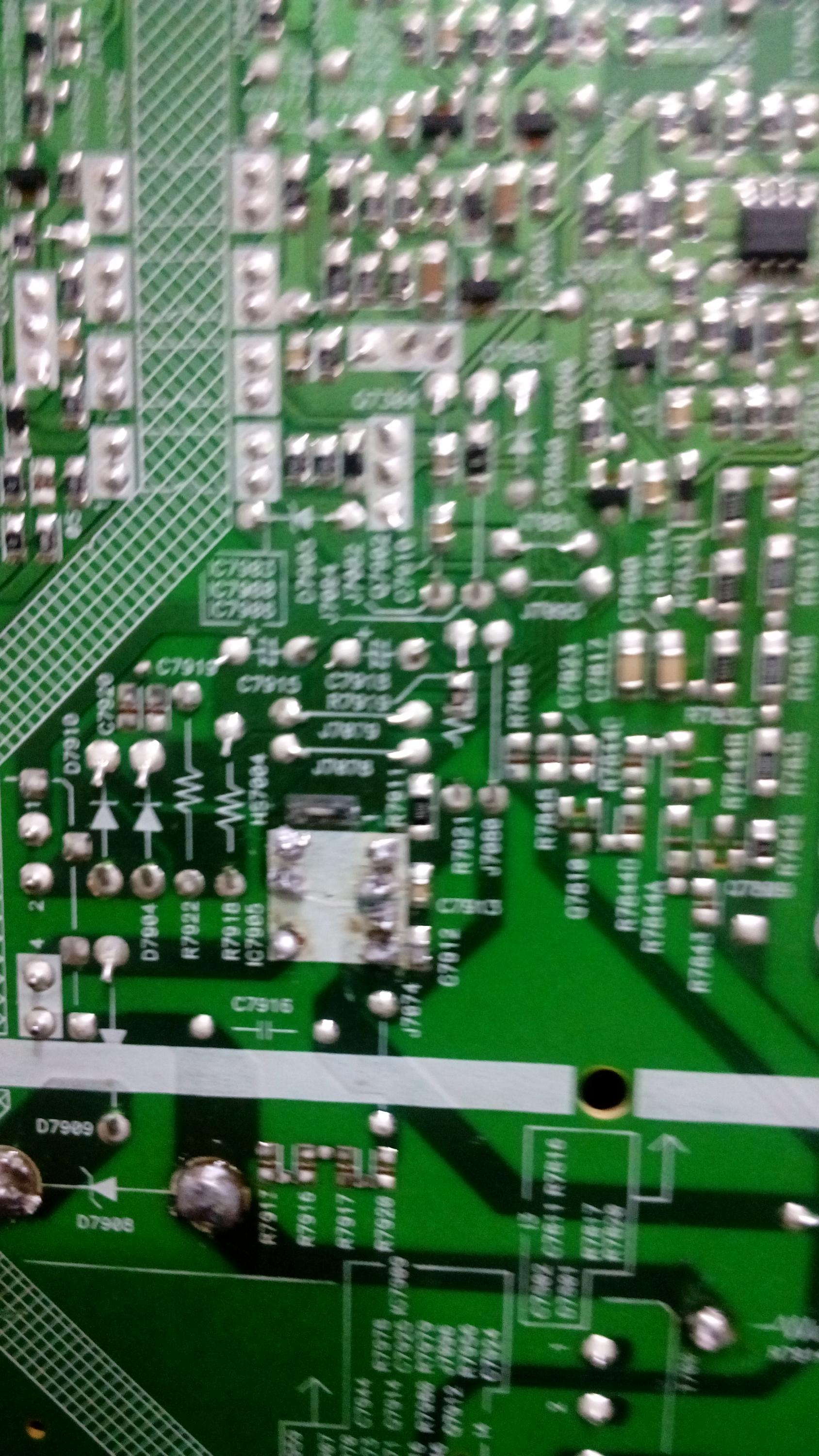

                                  #76
                                  Dear budm,
                                  Thank you so much for your reply and explanation,
                                  I follow your instructions and I find IC TNY264 is damaged.
                                  Will replace it with new one + R7914 and will update the results.
                                  I check the D & R at standby power supply and all are ok.
                                  Thank you budm.
                                  • RMCUNIVERSAL
                                    • Feb 2017
                                    • 16
                                    • Malaysia
                                    #77
                                    Dear budm and every one try to help.
                                    As promised,
                                    I do changed the IC TNY264 and R7914 and every thing worked perfect.
                                    Thanks every one

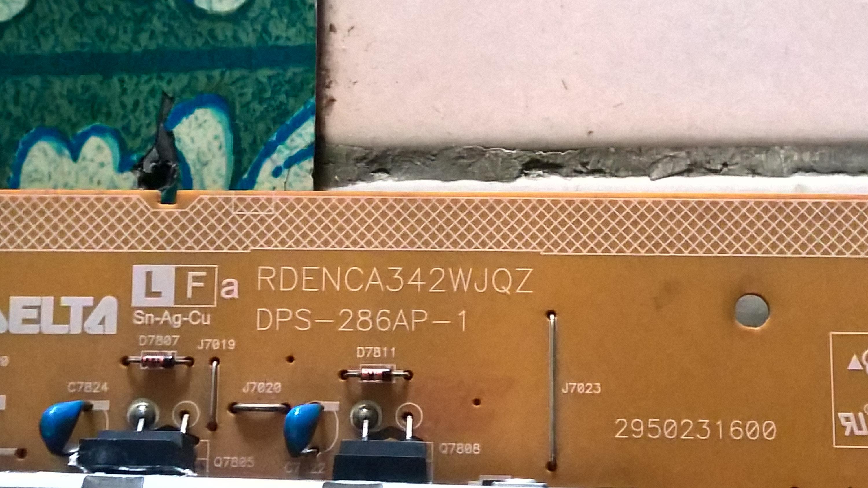

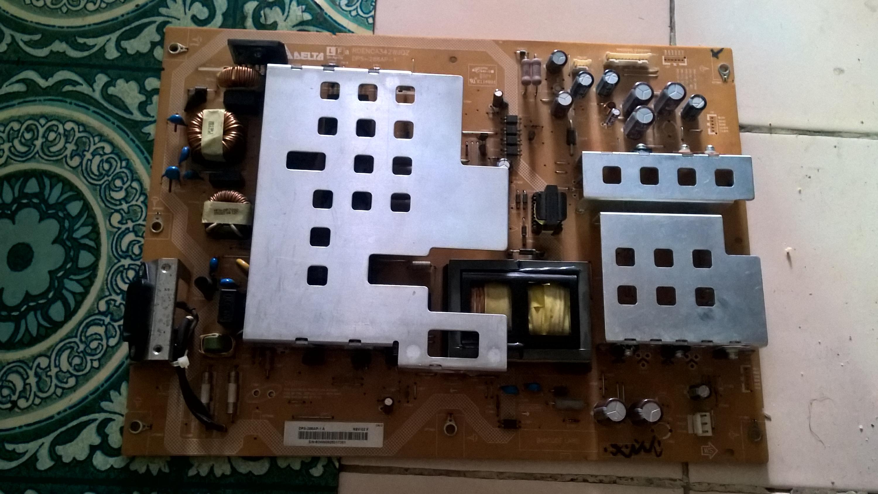

                                      #78
                                      Please Help me My TV LCD Sharp model LC-46A66M does not turn on. It
                                      Power & inverter DPS-226AP-1 RDENCA342WJQZ
                                      • matee
                                        • Mar 2017
                                        • 2
                                        • Thailand
                                        #79
                                        https://www.youtube.com/edit?o=U&video_id=jkJ5t00p90w
                                        I checked the voltage in the clips in the YouTube upload I see. Every power point is in the printed circuit board. I removed the circuit board to check. Any member Can you suggest me to check if MB is good or not? Can I make MB work on my own?
