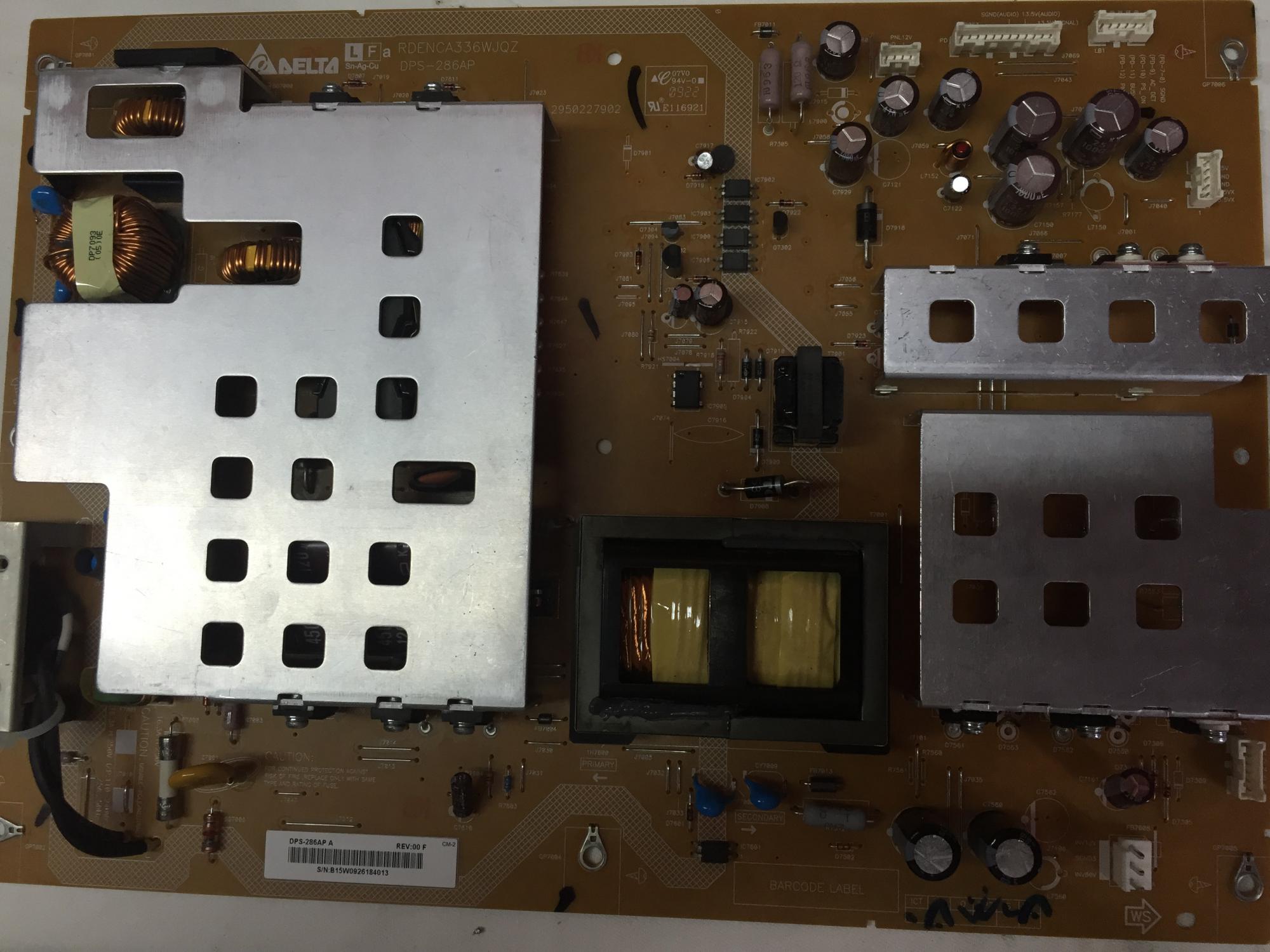

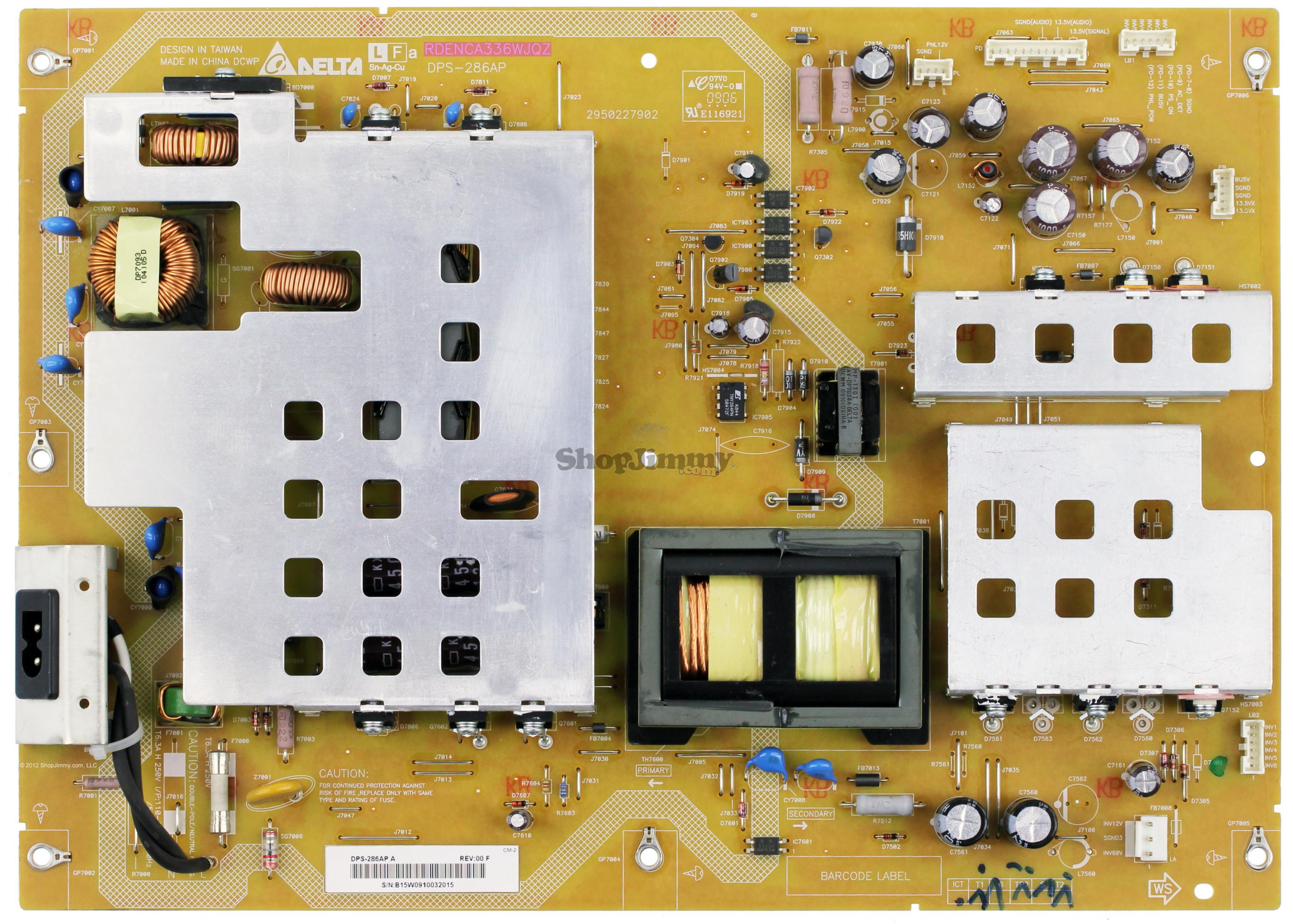

        Hi need help with my delta board power supply. Symptoms are no power no standby lights. I found IC blown apar R 7914 open and changed diodes. Still no power. I have 120vac in and some DC going out not sure where to look out. What watt Is the 2.2 ohm resistor suppose to be. Any help will be greatly appreciated.
          #44
          Re: IC Number on DPS-286 AP/RDENCA336WJQZ Sharp power board
          Any good clear pictures of the top and bottom side of YOUR board?
            #45
            Hope these are clear enough

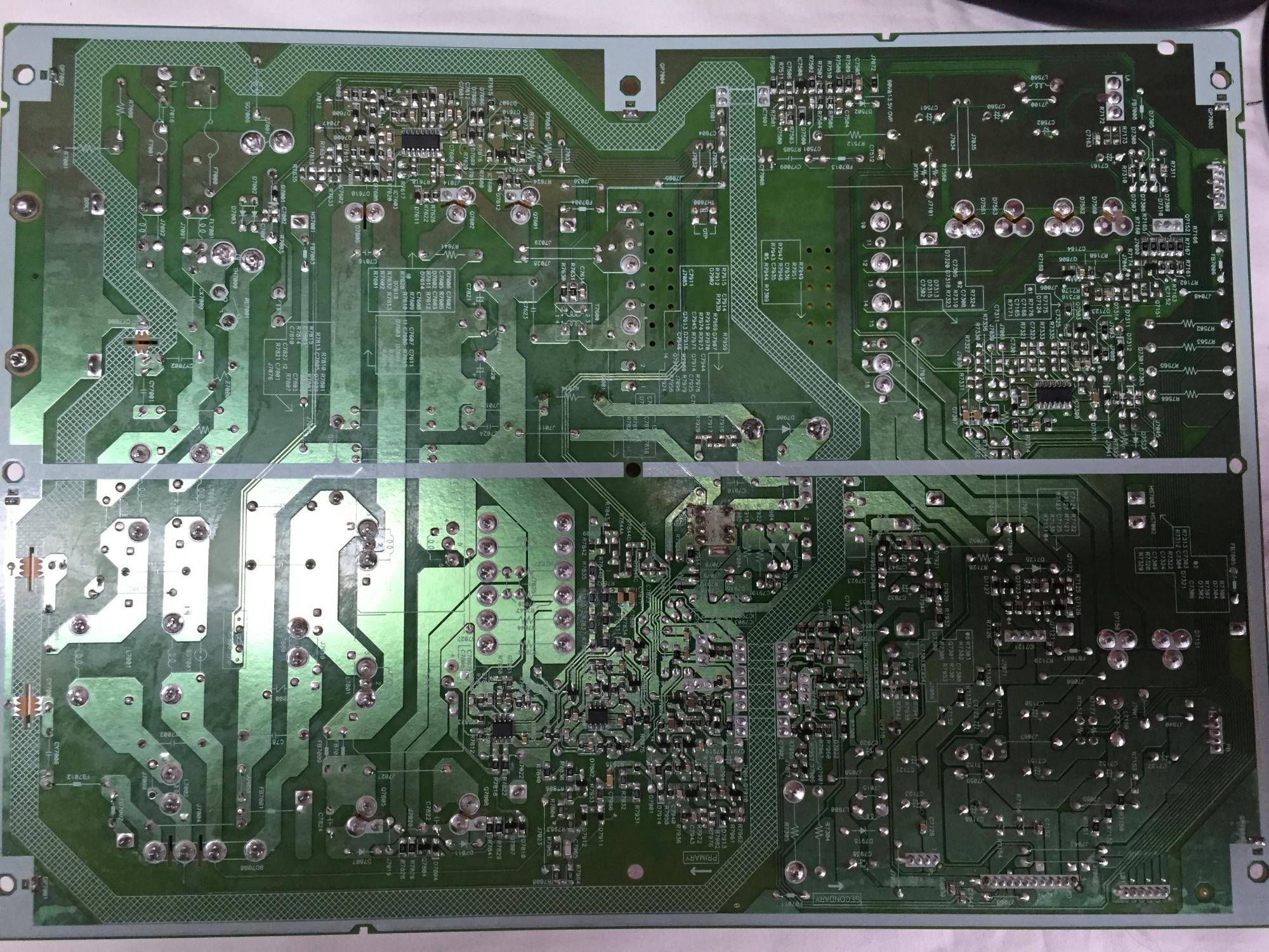

              #46
              Here's another
                #47
                Here's another
                Topside

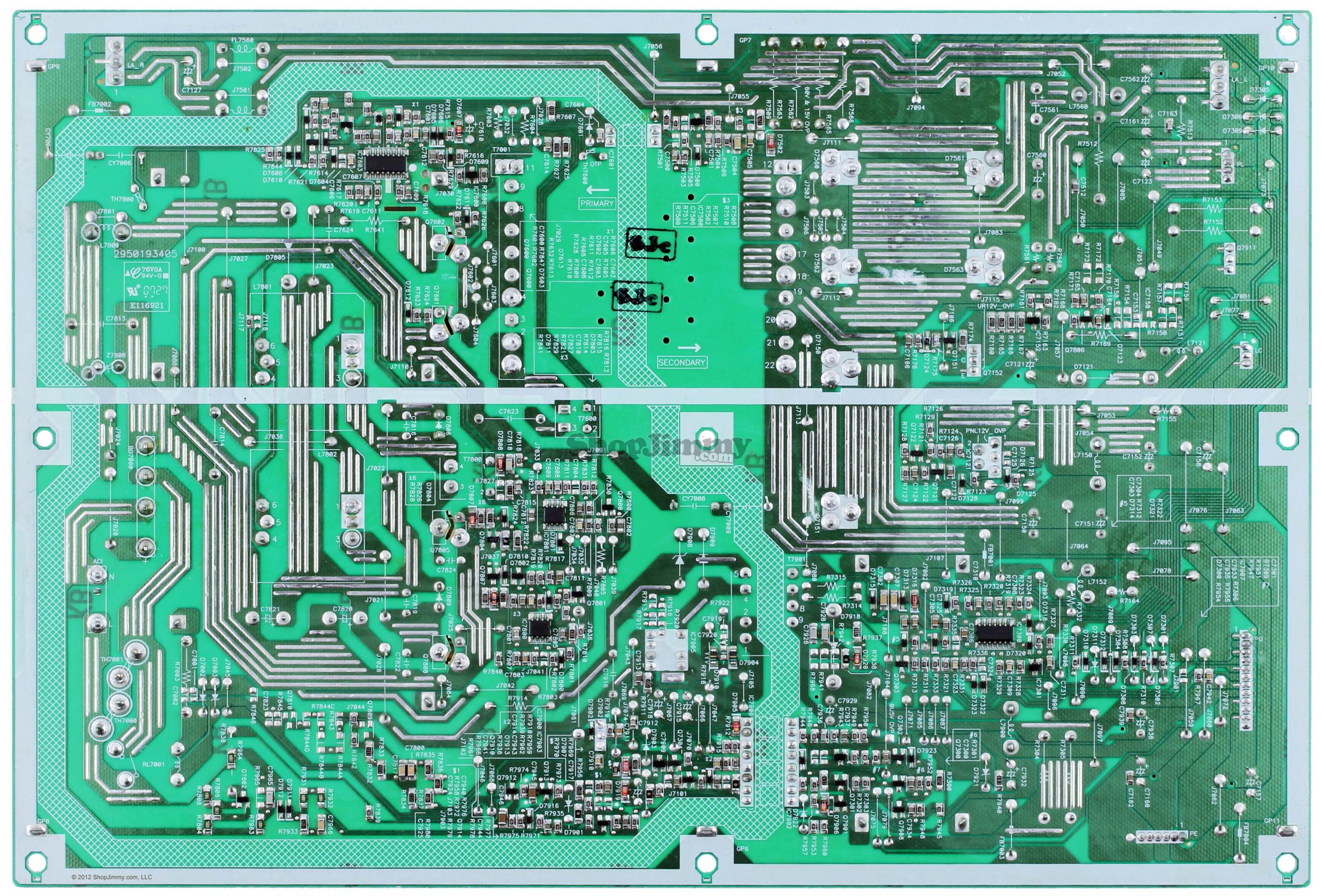

                  TNY264AP. The resistor R7918 2.20 Ohms is 1/2W MOX Flame proof, it is for supplying the Voltage from AUX winding of the STBY transformer for running the PFC IC and the SMPS IC of the 12V/24V power supply. The R7914 is the fusible resistor for supplying B+ to run the IC.
                  You also need to check the snubber network D7908, 7909.
                  So do you have about 165VDC between the negative leg of the main filter cap and either legs of R7914?
                  DCV between the two legs of the running cap C7915?
                  pictures provided by shopjimmy.

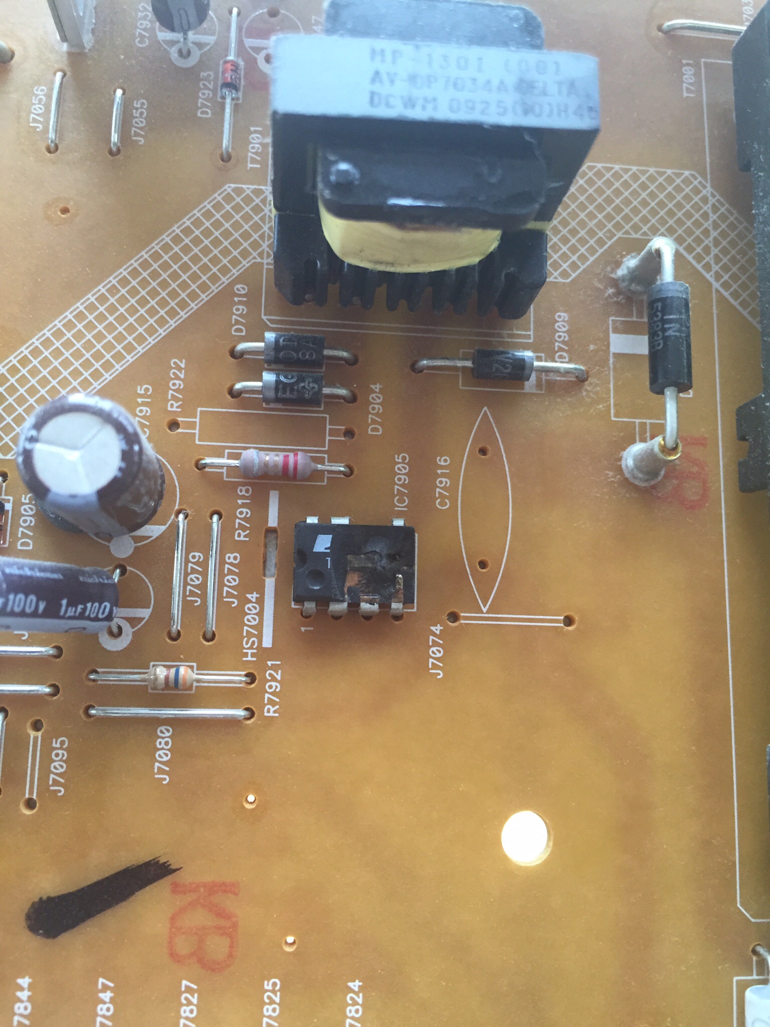

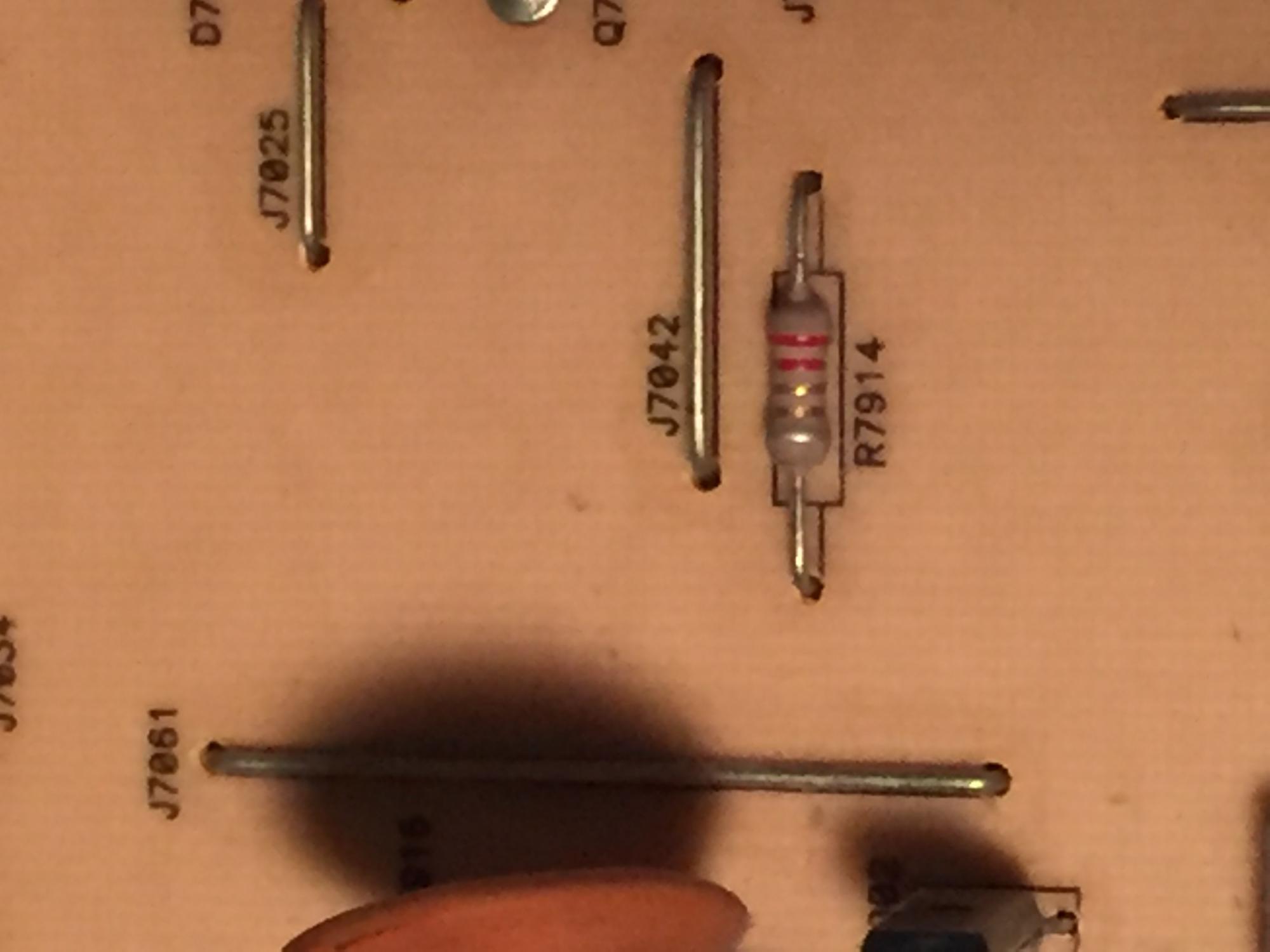

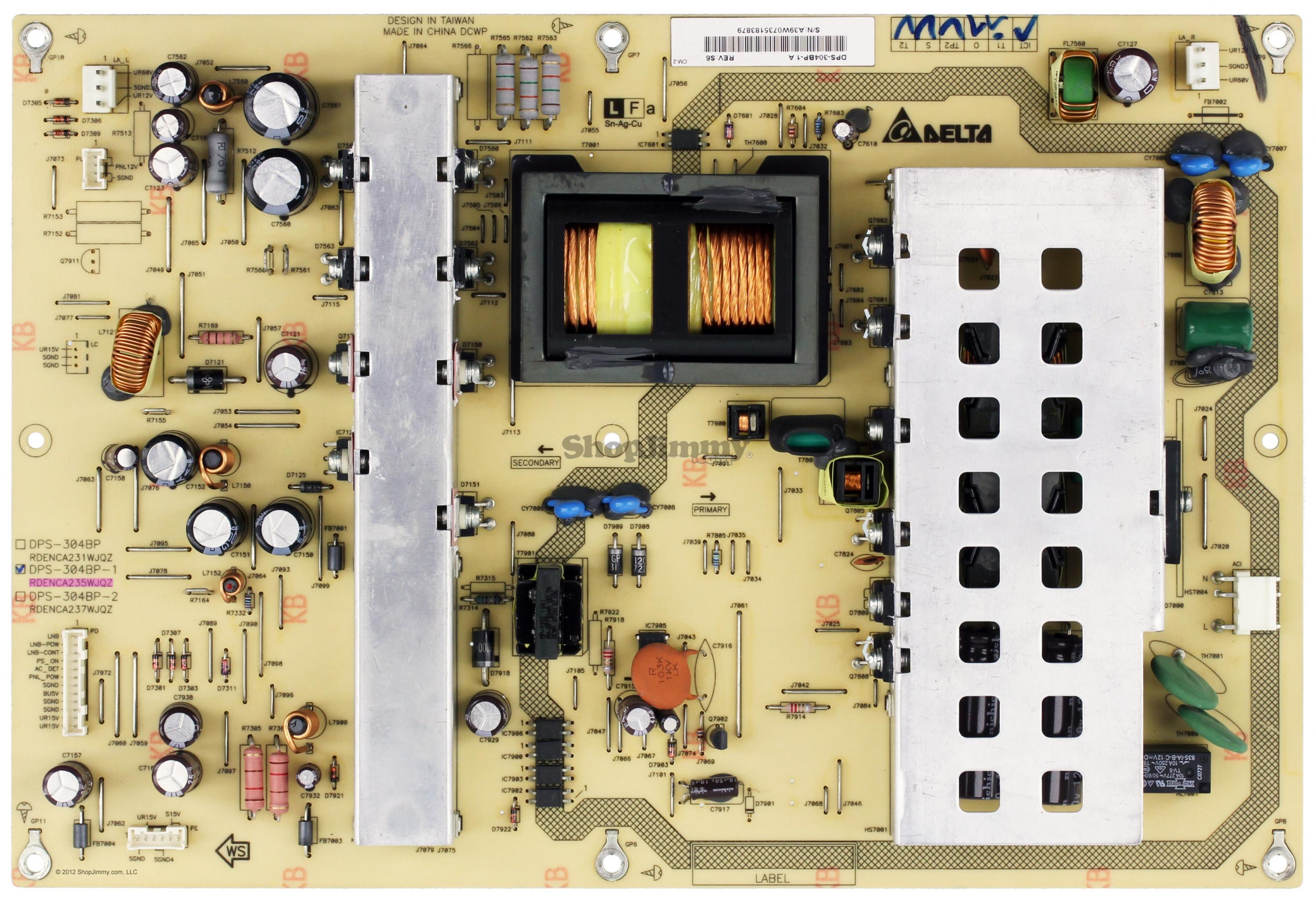

                                  I have a DPS-304BP-1 A power board from a Sharp LC-42D64U with a blown IC7905 and a bad R7914. I can't seem to find info on the resistor. This thread sounds exactly like mine. The resistor is a 2.2 ohm resistor, I'm just unsure of what kind it is and where to get one. Can someone help me find what type of resistor I can replace it with? Thanks.
                                    #57
                                    I forgot to add pictures.
                                      #58
                                      R7914 is the 2.2 OHMS FUSIBLE resistor 1/4W (or 1/2W, you have to measure the dimension) for supplying B+ to run the STBY power supply section, (you can use 2.2 Ohms MOX type which is Flame proof )that will blow open when that SMPS IC for the STBY power supply shorted out. R7918 is still OK?

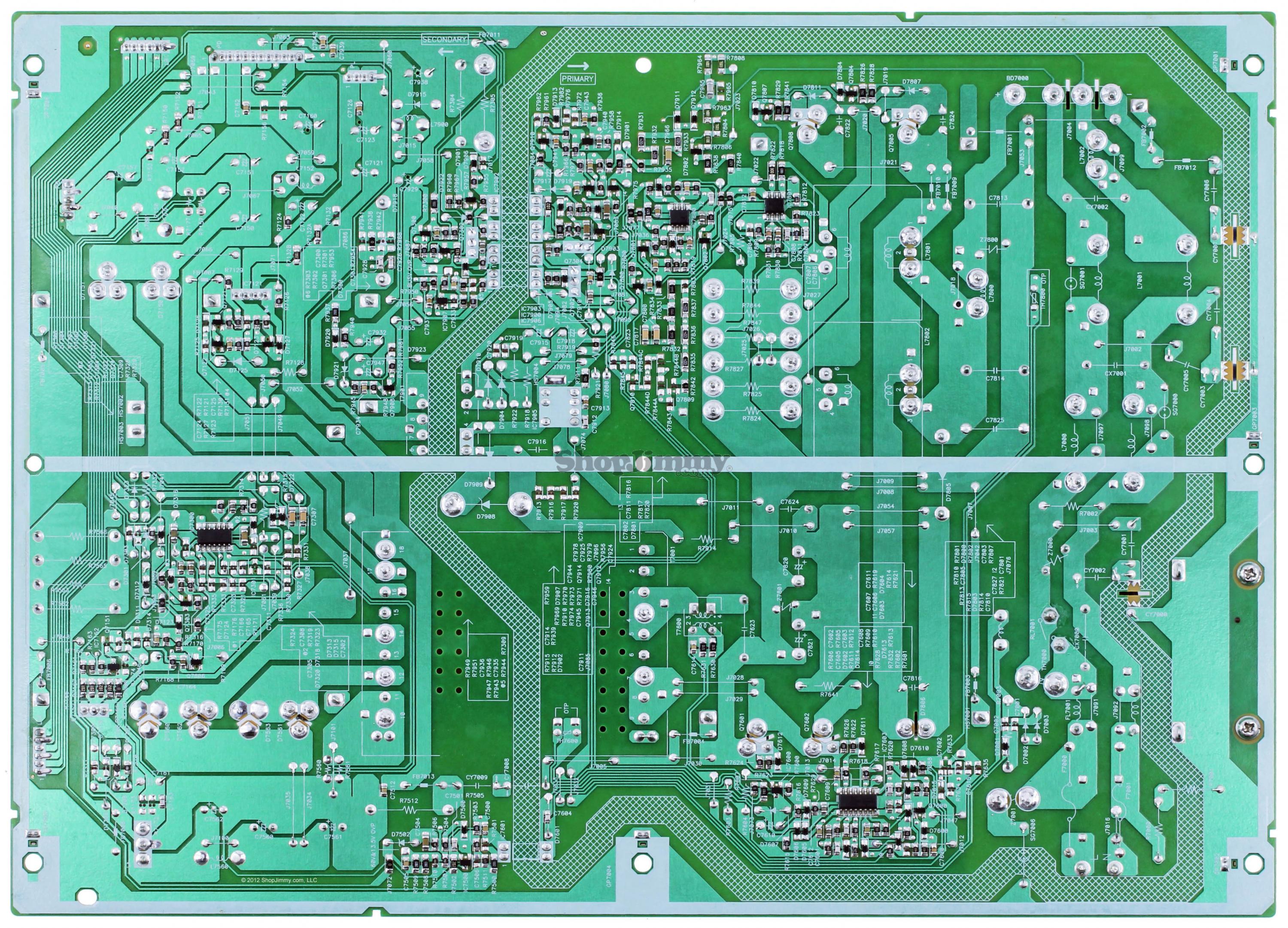

                                      Sharp RDENCA235WJQZ (DPS-304BP-1) Power Supply Unit
                                      http://www.shopjimmy.com/sharp-rdenc...pply-unit.htm#
                                        #59
                                        R7918 still test good along with D7908 and D7909. How do I determine if it is a 1/4W or a 1/2W? Looking on Digi-Key they are the same physical size. It looks like they have the 1/2W in stock, and can order them individually, but I would have to buy 5,000 of the 1/4W to order them.
