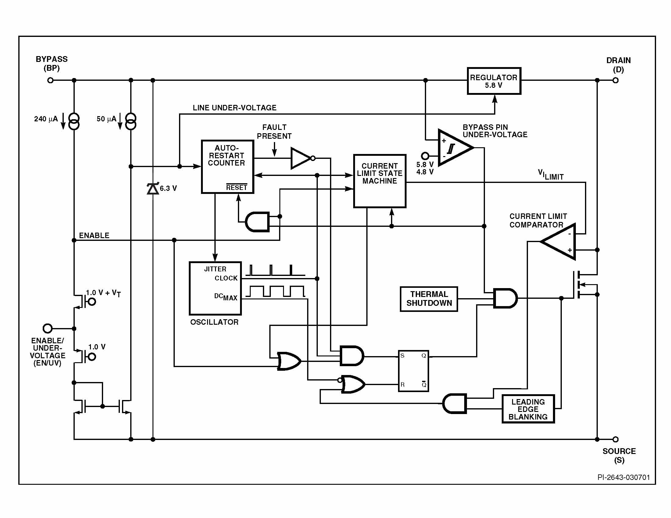

    S (Source) pins are connected to the primary circuit ground which is the Ground ref point.
    BD 5.8V: This is normal.
    ENUV (pin 4) .5V: There is problem here at this pin, minimum is 1V for the IC to be enable.
    " I heard a sound and was slighlty startled. The screen came on when i put the meter between D and ENUV" That because the meter connections cause pin 4 to go high enough for the IC to get out off shutdown mode.
    Please check the resistance between the ENUV pin 4 and S pin to see if it shows low resistance.

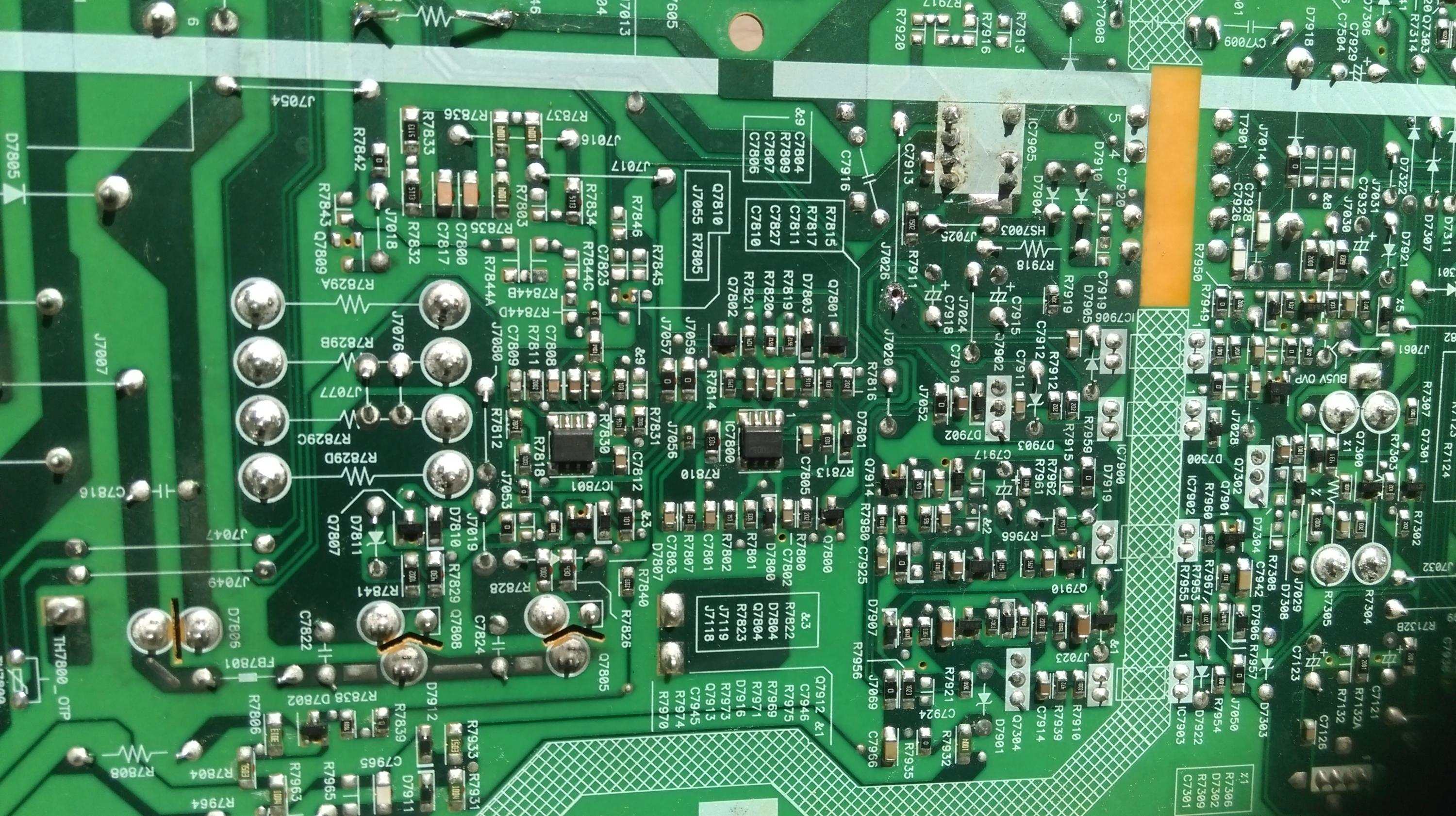

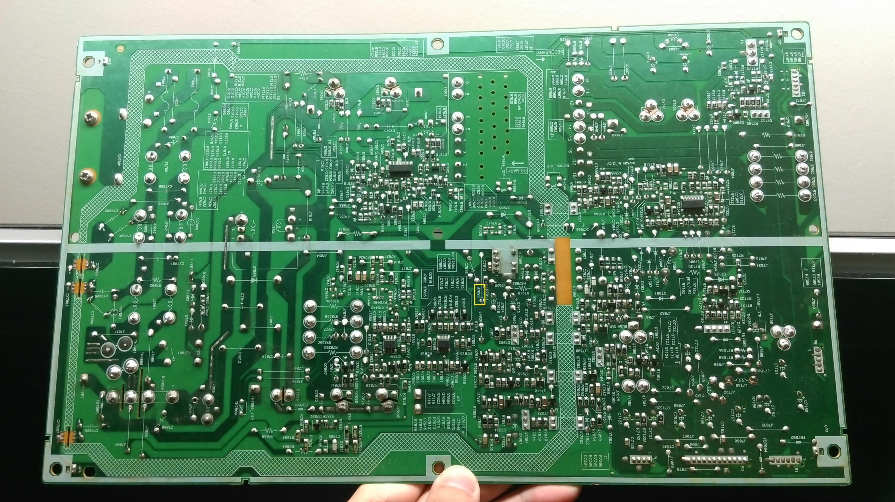

              Re: IC Number on DPS-286 AP/RDENCA336WJQZ Sharp power board
              OK, that is not the same DPS-286 as shown by the OP, I use this picture from shopjimmy:
              http://www.shopjimmy.com/sharp-rdenc...upply-unit.htm
              http://www.shopjimmy.com/media/catal...jqz-bottom.jpg
              Which board do you have?
              OK, you have the 226 not 286.

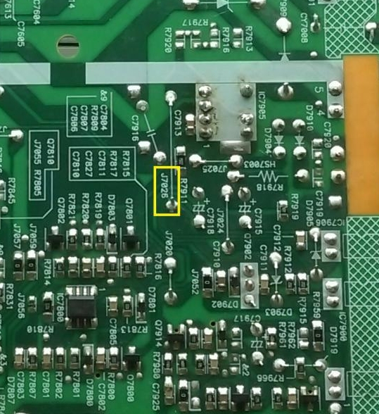

                BTW: I dont see a J7080, Closest to pin 4 is J7026? They are the same? yes, per you board, lift one end off the board.
                  Yea, its a variation board i think.. mine is DPS-226AP-1 RDENCA340WJQZ
                  From what i see in the other board picture? I assume you are just trying to isolate pin4? I will just go ahead with J7026.
                    2.6 M ohms

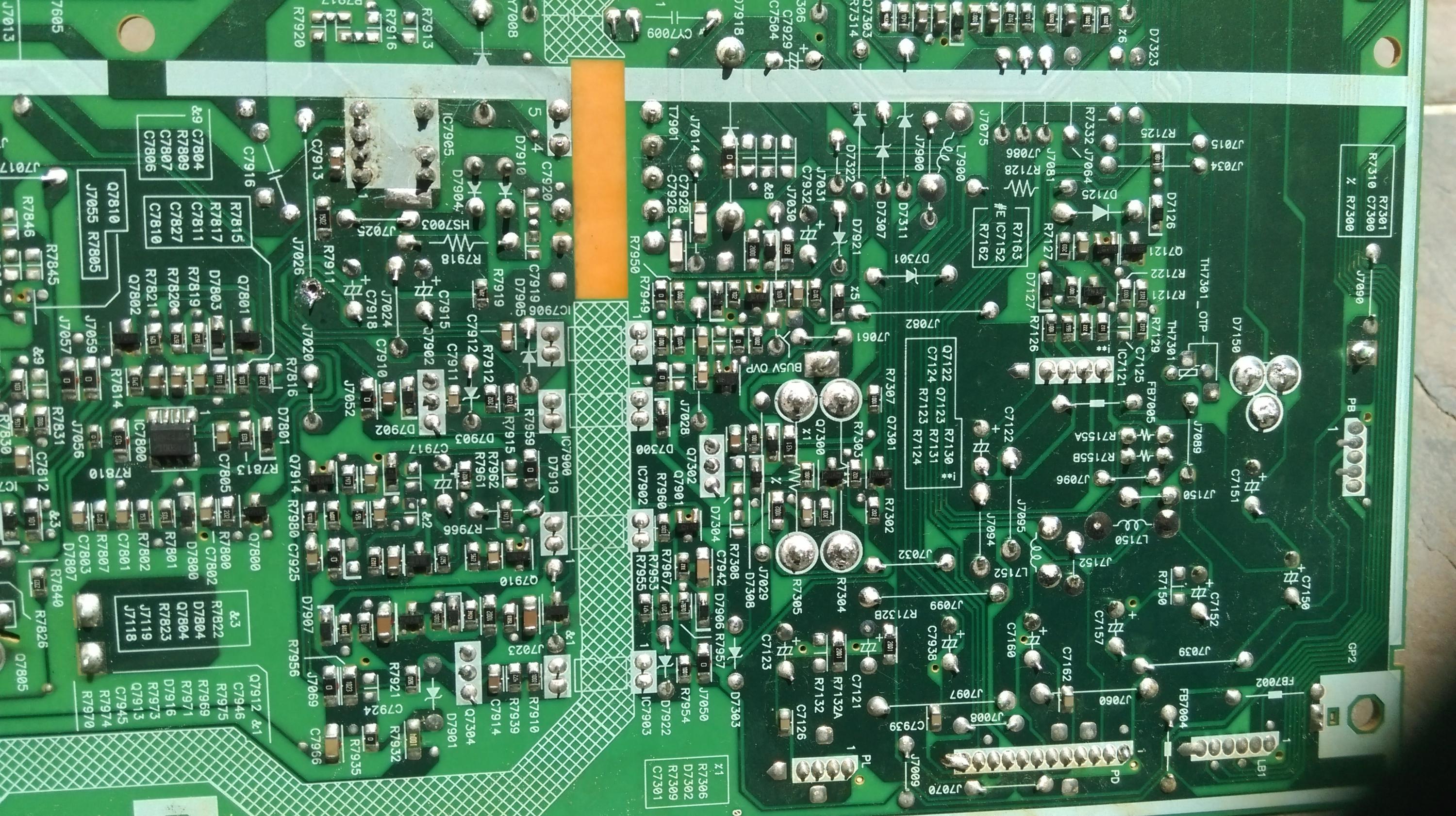

                      OK, we need to trace where the other end of that jumper is connected to. I need better pictures of the STBY section so I can easily see the traces, I believe it is connected to the Cathode of Zener diode D7905? and the opto-isolator (IC7905?). I believe either the Zener or the Opto is damaged when the IC went out. You can put the jumper back in place and lift one leg of the D7905 to see if the resistance will go up.
                        #31
                        Here you are. Yes D7905, i think it connects to IC7906 though.

                                    So when you removed the jumper, pin 4 shows high resistance, so the low resistance is on another end of the jumper which is connected to the opto, zener,amd I cannot see what else, you need to find out.
                                    How abut those resistors that are connected to pin 4? They are not installed from the factory?
                                    As you can see the intenal of the IC, pin 4 EN/UV is connected to MOSFETs inside which should not have 2K reading.
