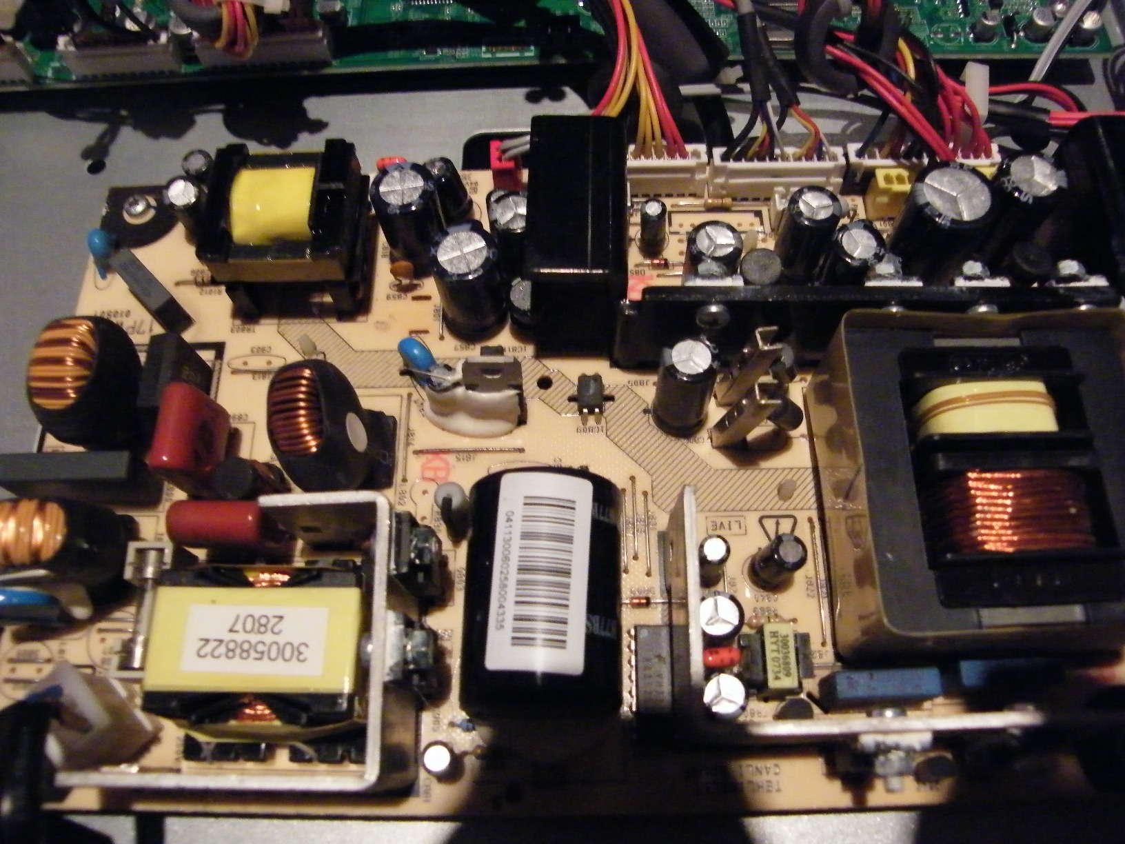

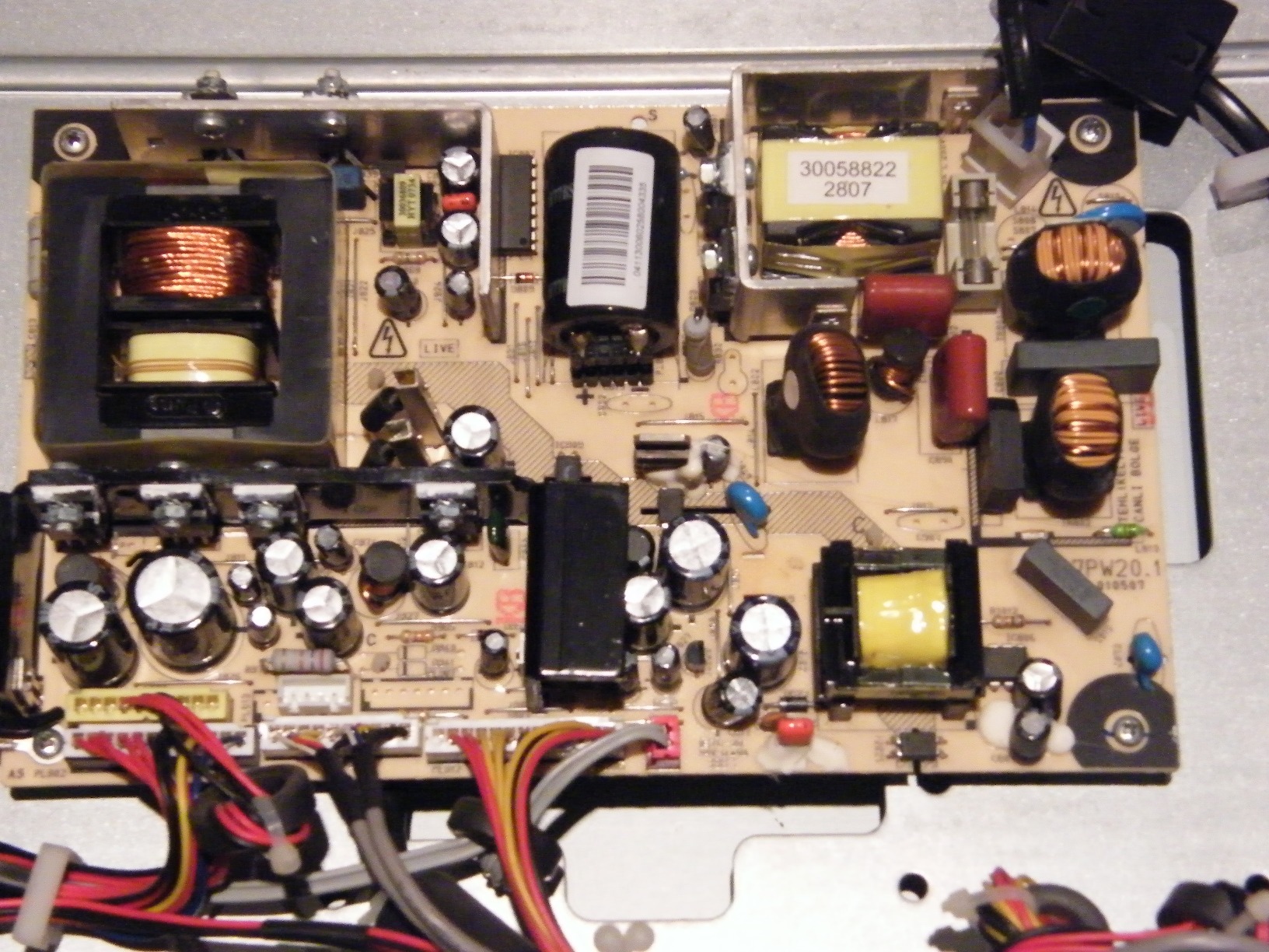

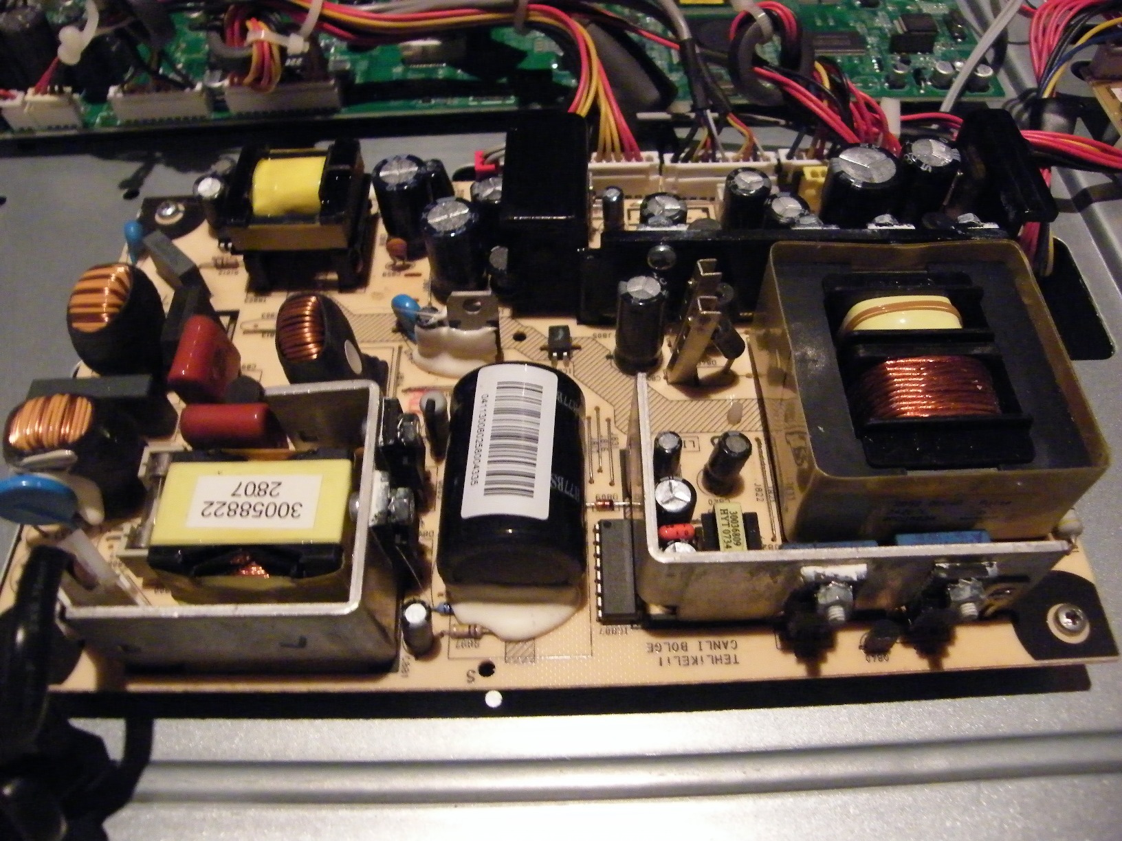

          I've posted 2 pictures in a vain attempt to make up for the bad light and shadows (it's dark here).
          [Edit: added 3rd picture which may be clearer)

            Re: Goodmans LD3265D (Vestel 17PW20.1) - sound but no picture at startup
            It's those two long rectangular blue ones on the bottom right.
              I saw previous posts referring to the same points on the board (C877/C878) but hadn't actually located them until Tom pointed it out - in my ignorance I was looking for cylindrical caps...
              I don't have these caps to hand but will order some and will return to this thread in a few days to update my progress.
