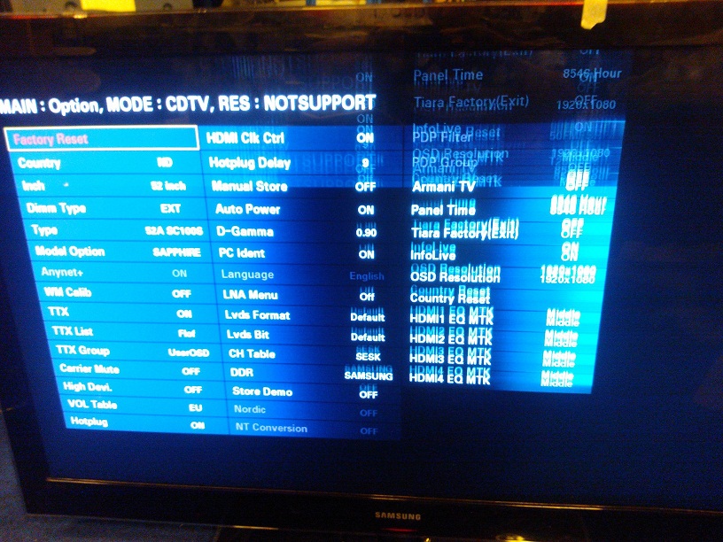

    Hello all,
    May someone tell me if this is a panel or T-con failure.
    Please see attached picture.
    Upper 6 inches and half right side of the picture is jumpy..

    Probably a bad panel. I have a sony kdl with the same symptoms. I checked the tab bonds and it didn't help.

      Re: Samsung LE52A866S
      Yes , looks like bad screen. I had same problem with Mitsubishi LCD tv I had to replace LCD panel (actually there was recall on those LCD series so paid only for labor).
      You can try to loose screws on LCD chassis and check it will help. I found that some panels assembled in China had a problem with chassis that was tighten too much and caused ribbon wire to brake when screen heats up.
        Problem doesn't change when set reach operating temp.
