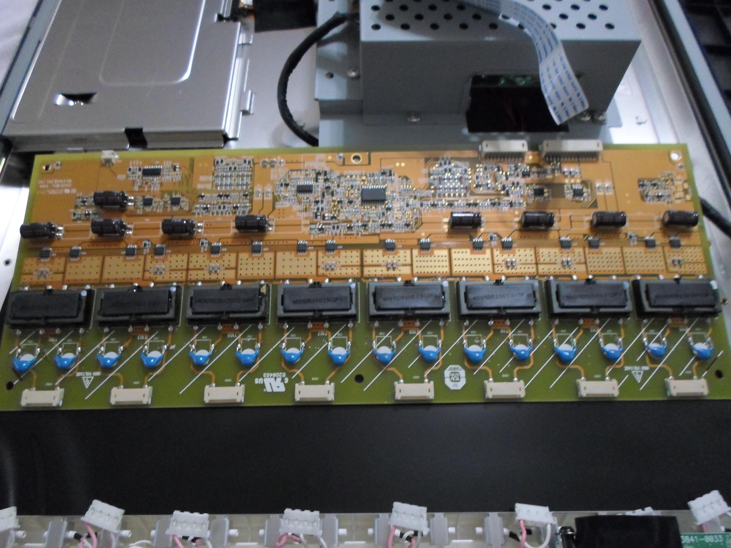

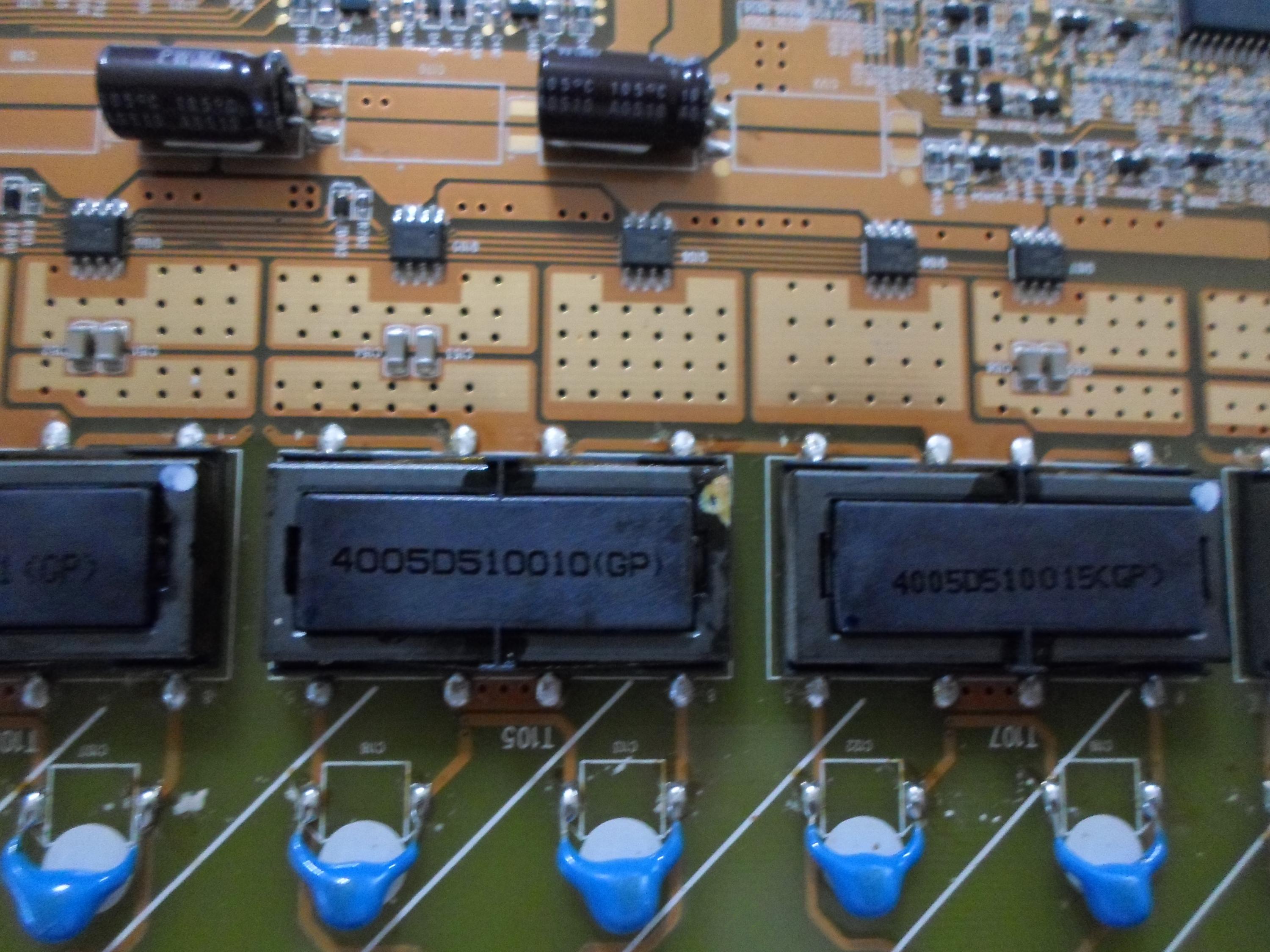

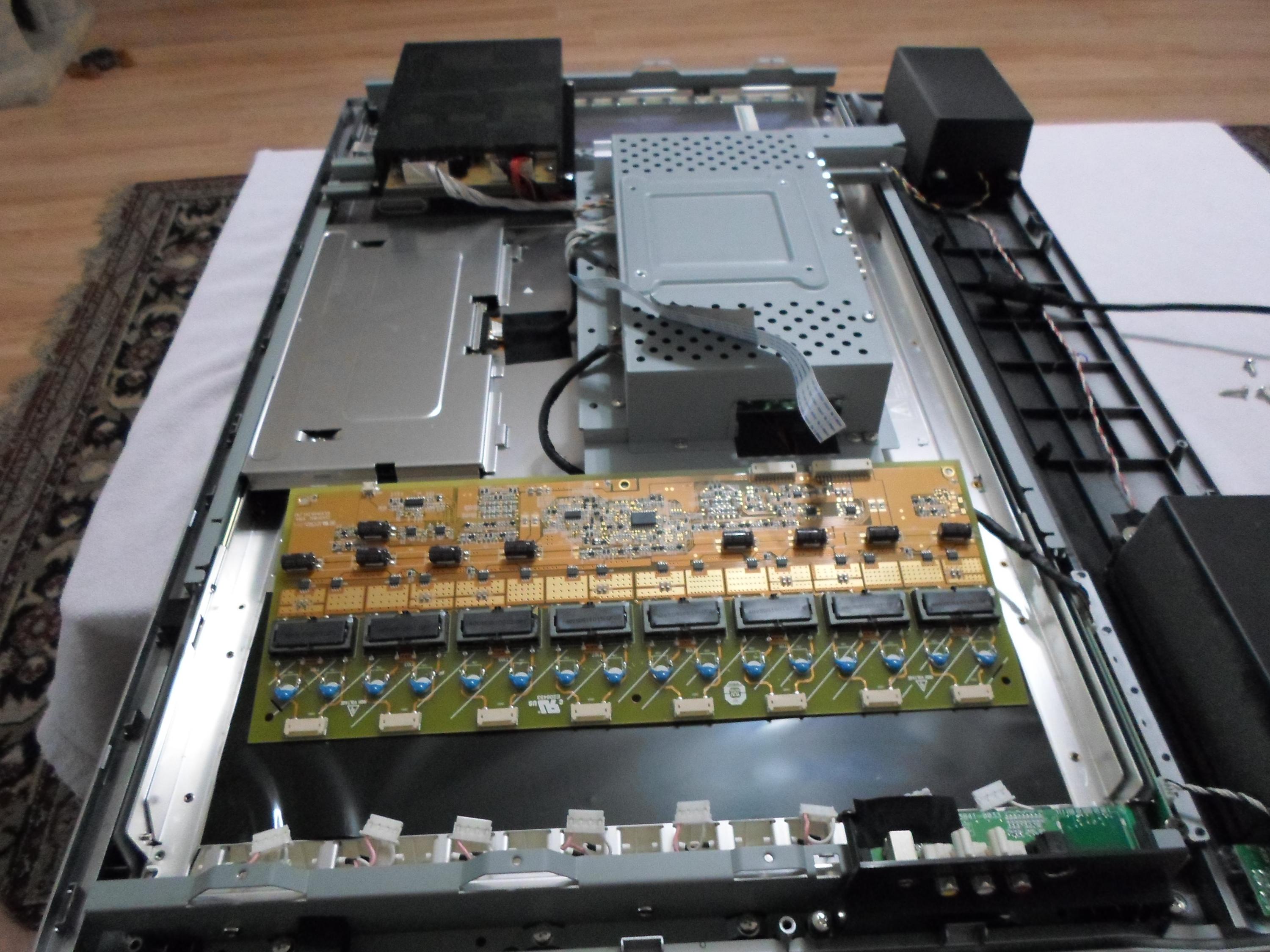

    TV has normal standby and powers on, backlight flashes for a second then goes out. Can see video shining a flashlight on screen.
    Get approx 5v to BLON then goes down.
    Getting 24v to inverter VDD pins.
    F101-105 test good.

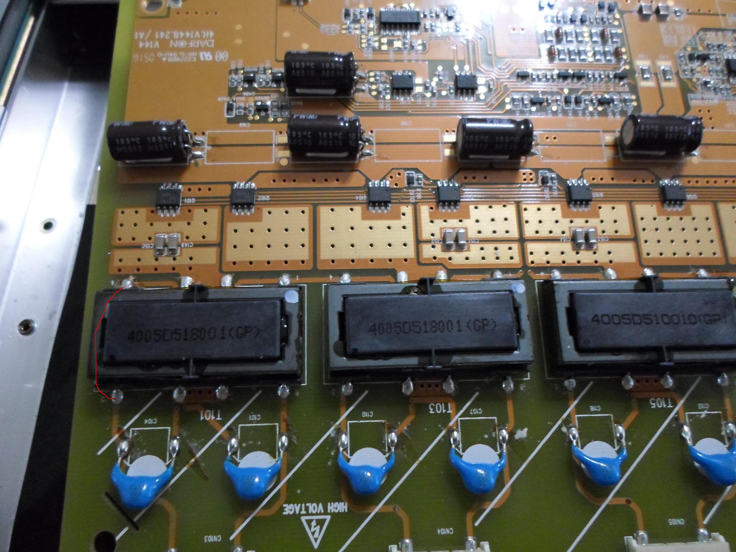

    T105 has a little residue by pin 1 where all others have a white dot.

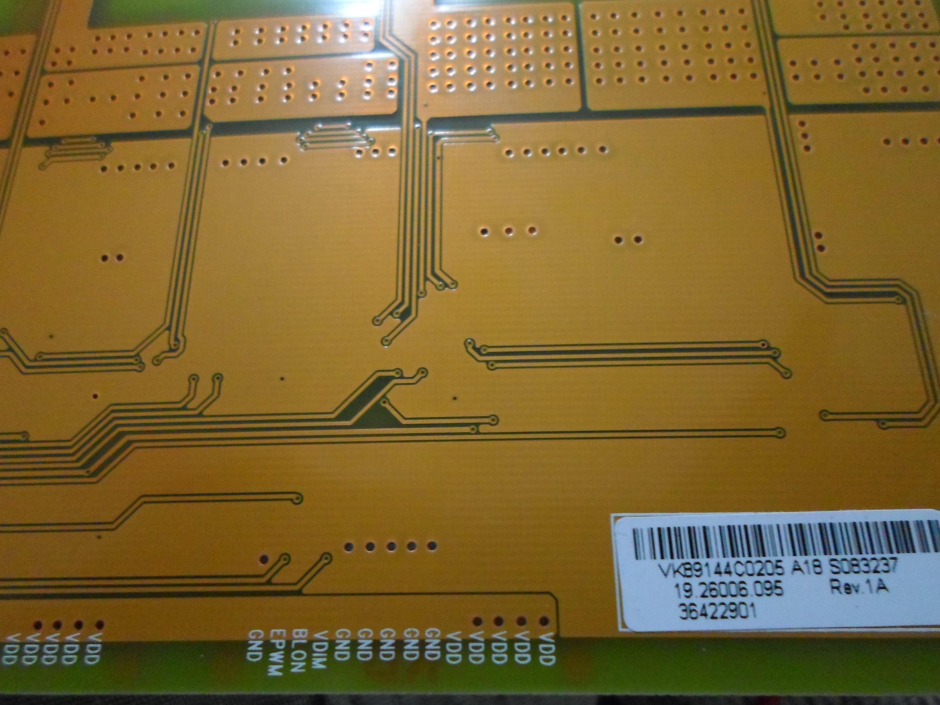

    Inverter board part # is AUO 19.26006.095
    The specs for the 4005DXXXXXX(MS307T) transformers say:
    The secondary resistance is about 0.8 K between S1 and S2 (or S3 and S4). The primary resistance is about 0.5 ohm between P1 and P2 (P3 and P4).
    So I started checking with meter at 2k, not sure if I had the right pins for secondary but it's the only pins that gave me close to the specs:
    T101 - .892 .888
    T103- .896 .893
    T105- .886 .886
    T107- .889 .886
    T109- .855 .885
    T111- .879 .875
    T113- .909 .909
    T115- .873 .871
    If I did that correct I see some deviations in T109 and T113.
    Does it seem like an inverter board problem? I do not really have any way to test the lamps..

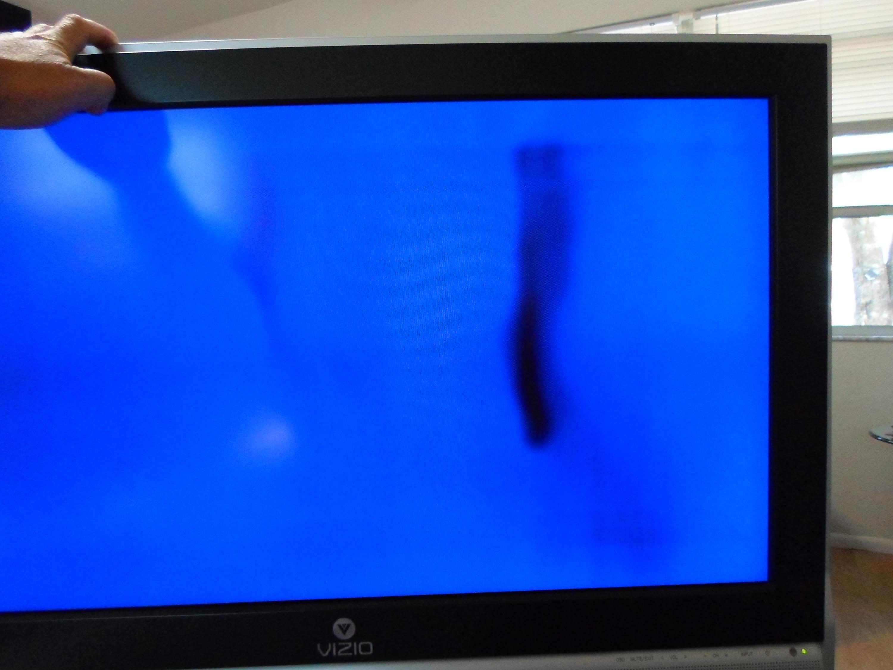

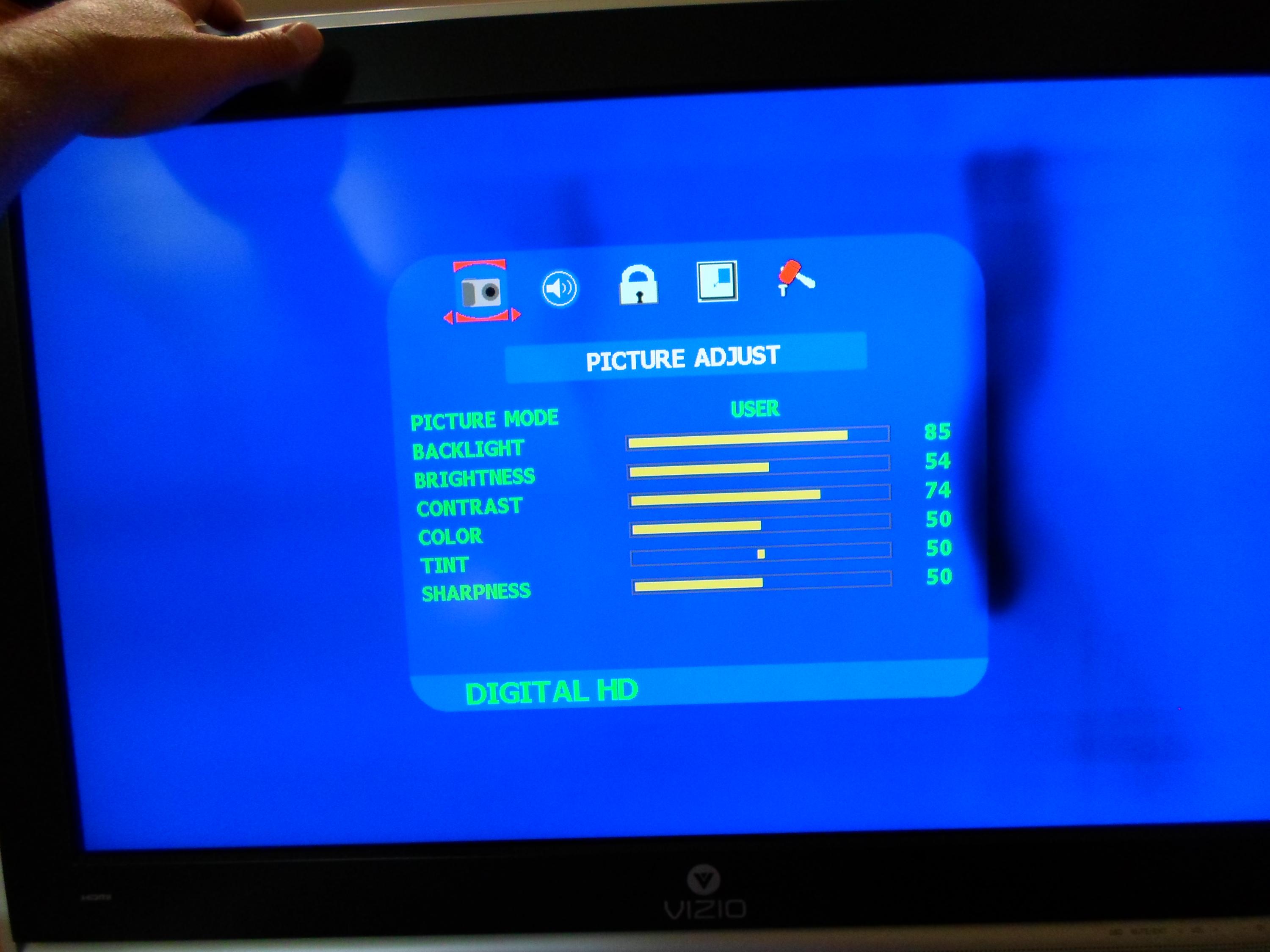

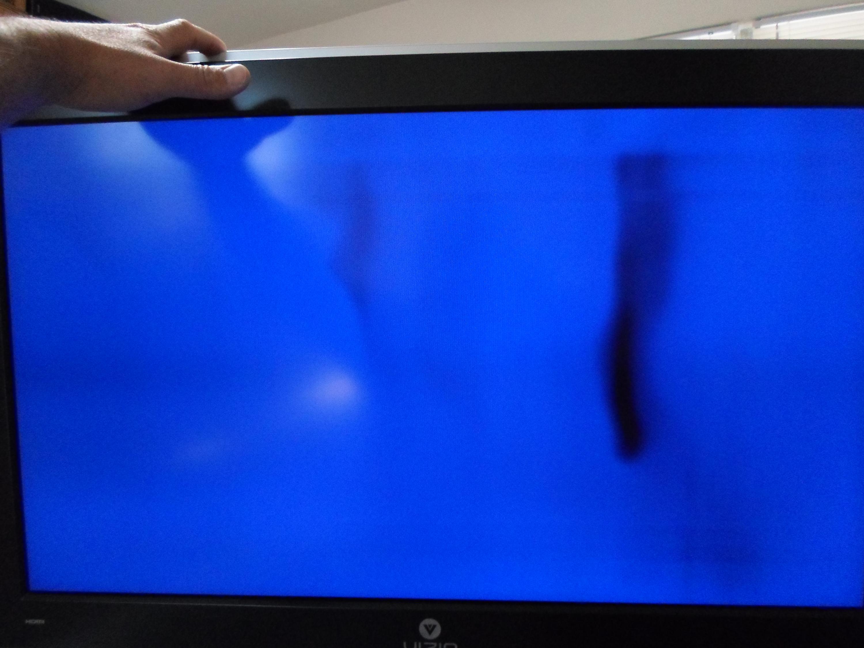

    I was able to get the backlight to come on by bypassing the protection just to see what screen looks like. As you can see the OSD is fine but there is the black marks/shadows going down the screen. What is that??!
    Also as a side note, all of a sudden I noticed the power LED light went to green when plugging in, and unresponsive, instead of the normal yellow standby when plugging in. I figured something happened to the main board. Found an open 2A fuse on the main board on the 3.3v line, I musta hit something by mistake. Replaced it and back to where I was before..

      T109 does not look right with 855 Ohms reading.

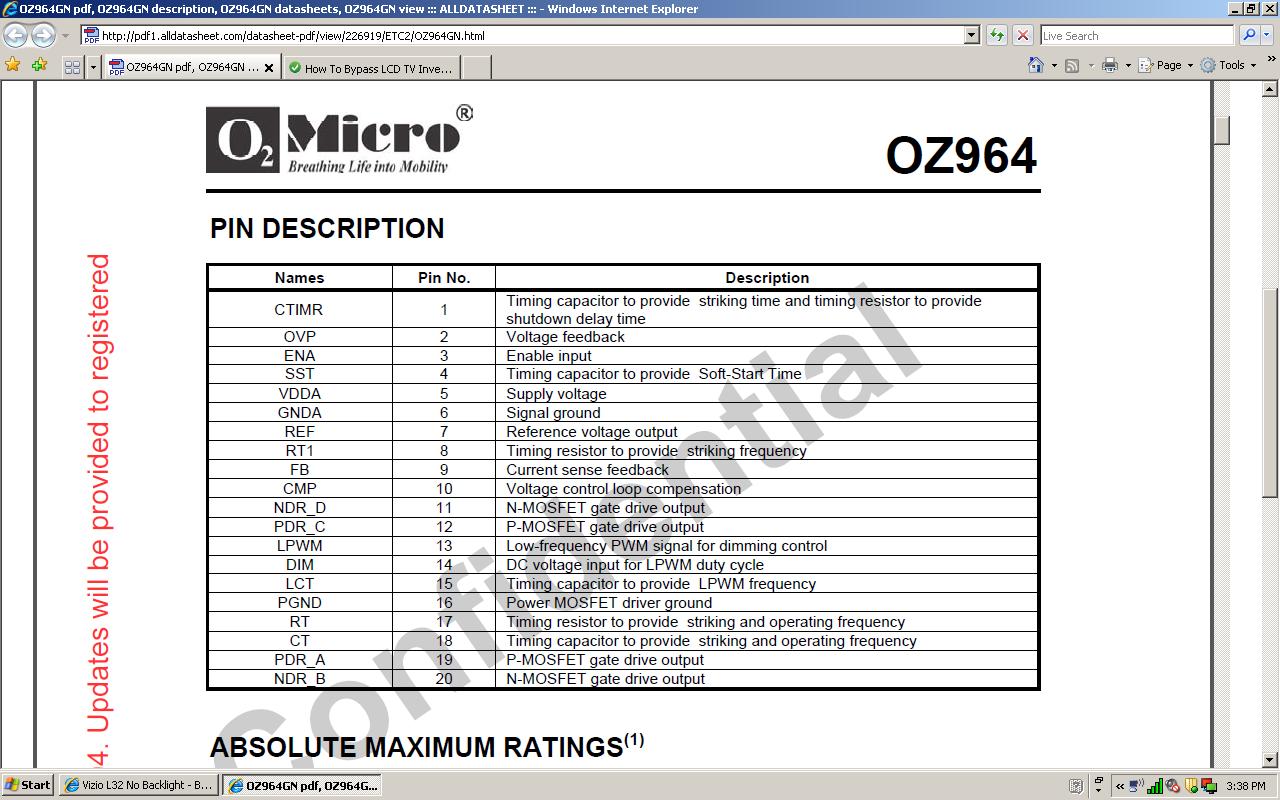

        I had run across this article on another TV:
        http://www.bestelectronicarticles.co...ht-system.html
        I looked up my inverter IC datasheet and was similar, just had to ground pin 1.
        I figured it was worth a try to see what the backlights looked like or if screen was cracked..
        That black smear though I'm not sure what's going on with that..?
          Re: Vizio L32 No Backlight
          OK, I have done that one before, was not sure if your board uses the OZXXXX IC or not.
          Thanks. That smear on the screen, was it there before? It is either contamination or some pressure was put on the screen to cause what you are seeing, not 100% sure.

            Well that's the thing I never saw the screen on before so not sure. I wasn't sure if that is a bulb issue or the panel. Wouldn't a bad bulb be a dark bar across the screen? Could whatever that is be causing the shutdown of the inverter? Those transformers are like $11 each on ebay, the whole board is around $50 which I don't want to do for this TV..

                  That is mura. Unrepairable usually. Maybe if a bulb has split and burnt, it has burnt the inside of the panel??
