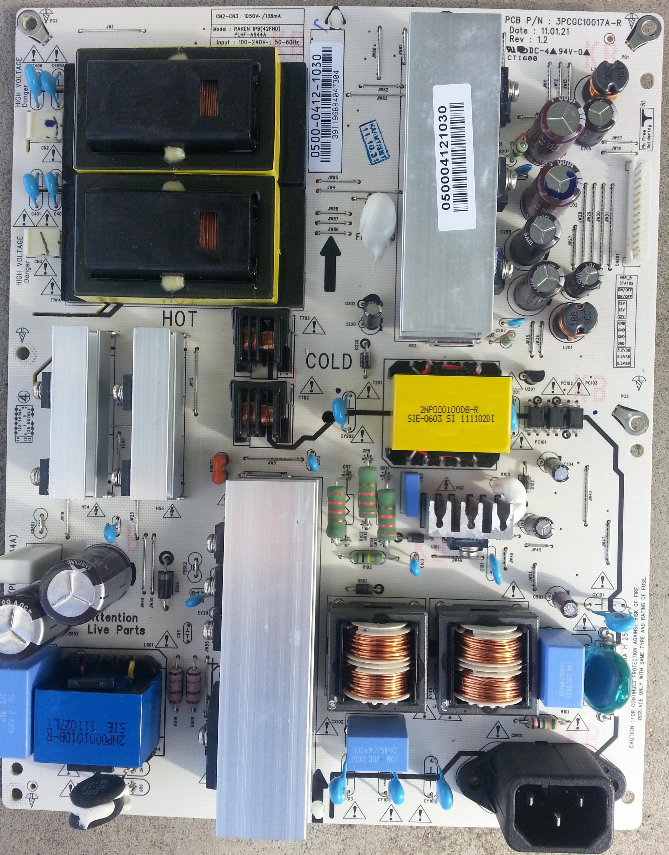

    When I checked the micro fuses I got 0.0. ohms reading, the same as touching the probes together.
      Re: e421vo orange light only
      I get 0.0 ohms.

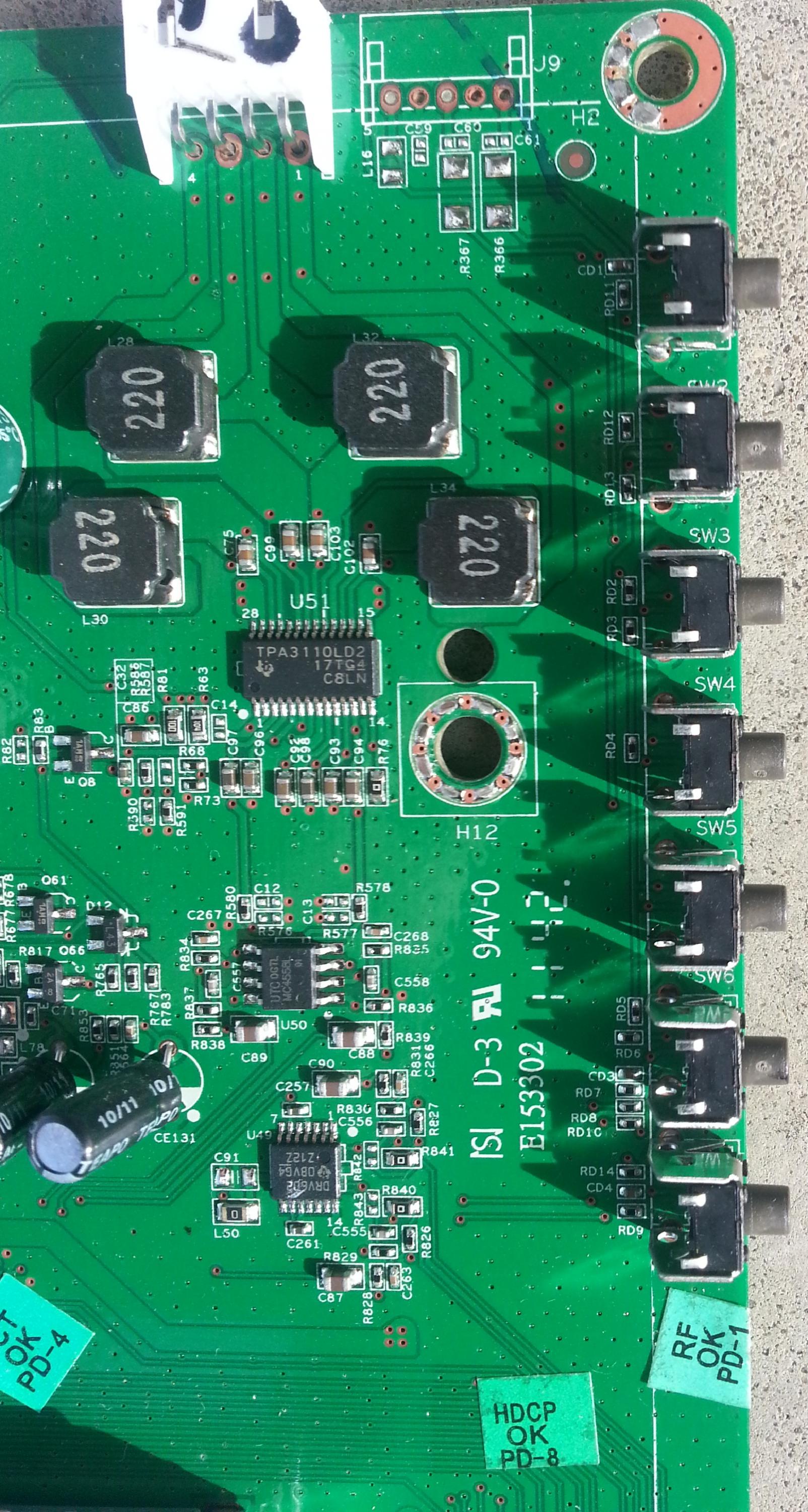

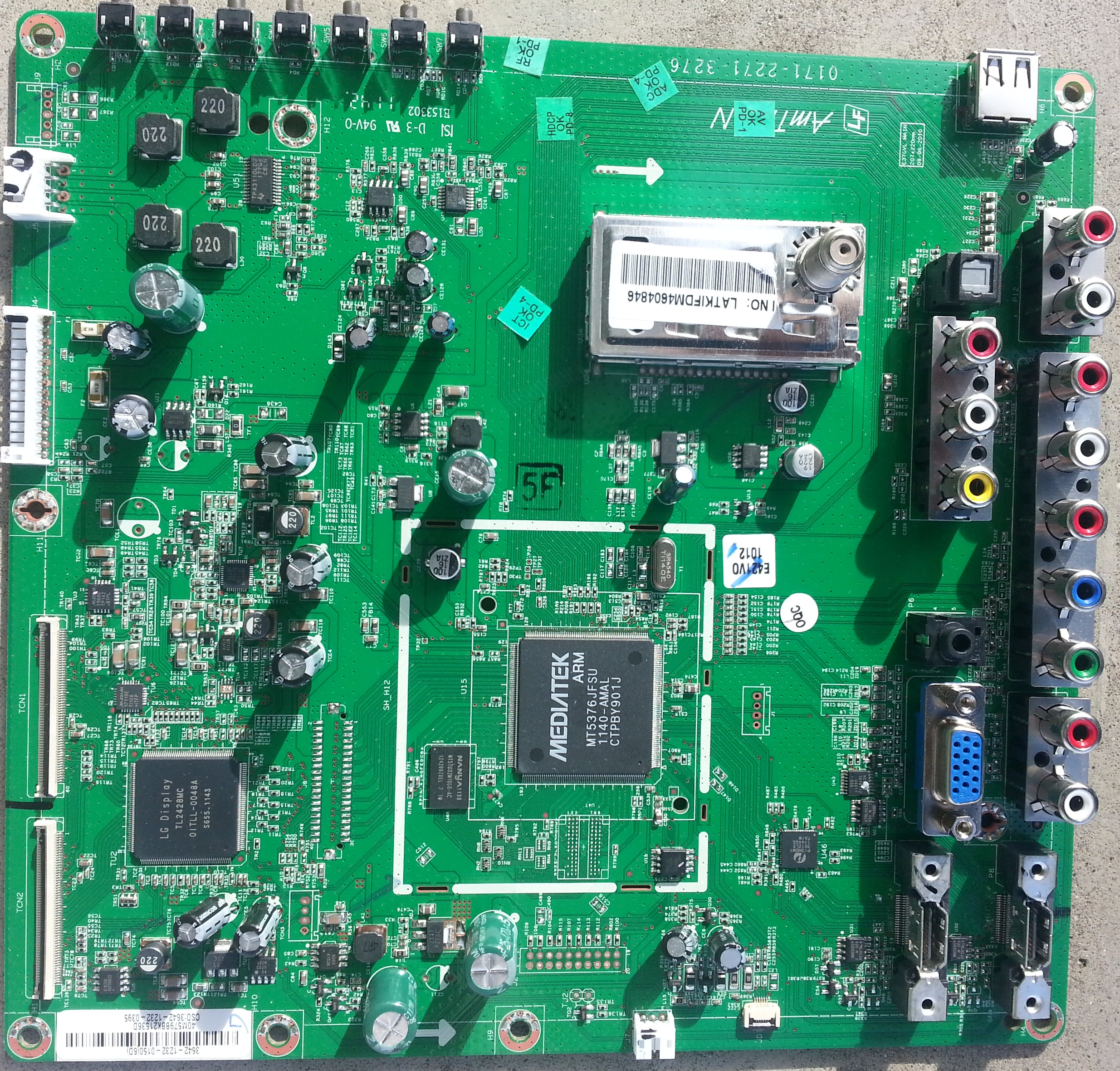

        Good - we really need better pictures.
          Hope these are better pictures

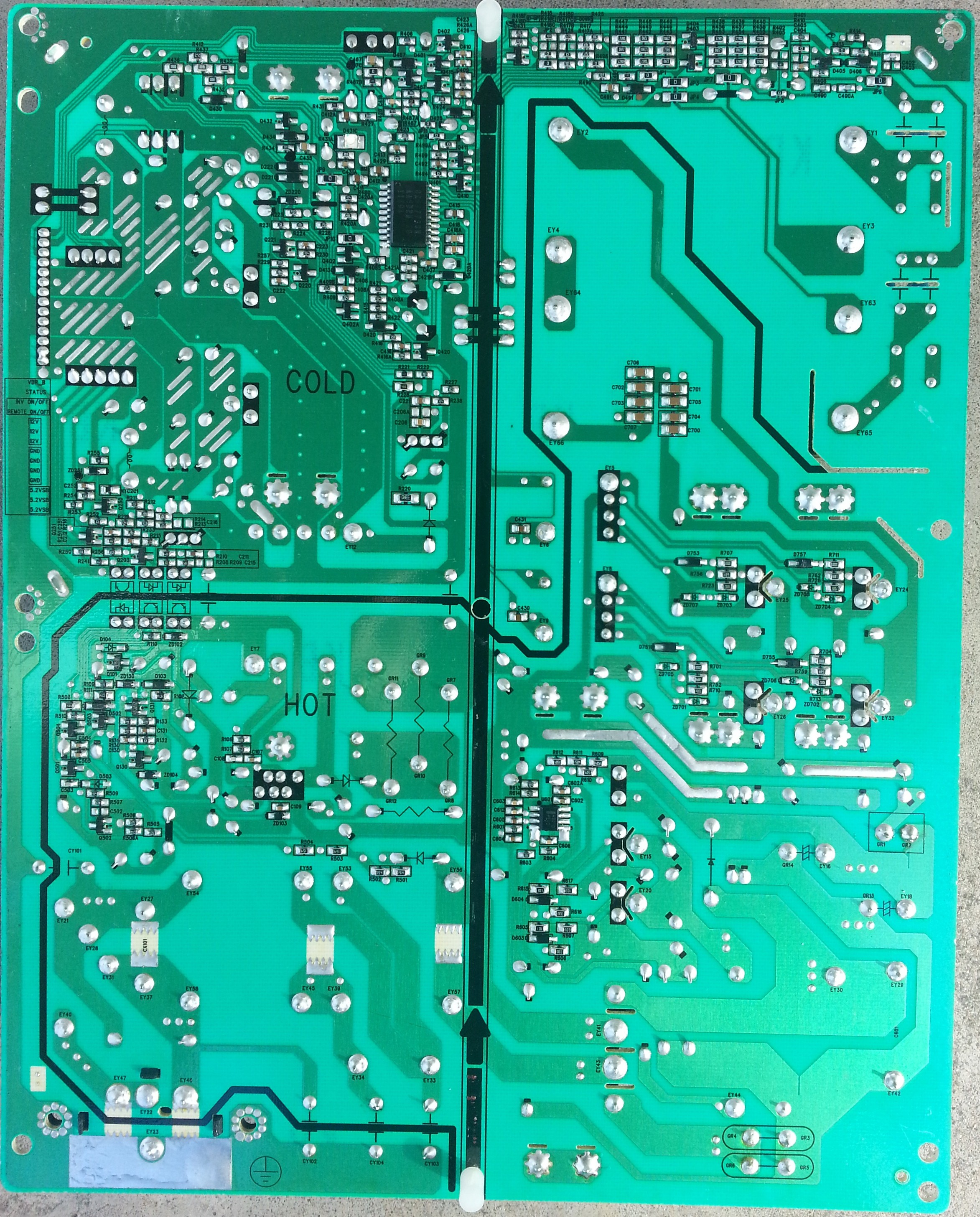

            Main board is excellent can you do similar for the power board
              Okay, here they are.

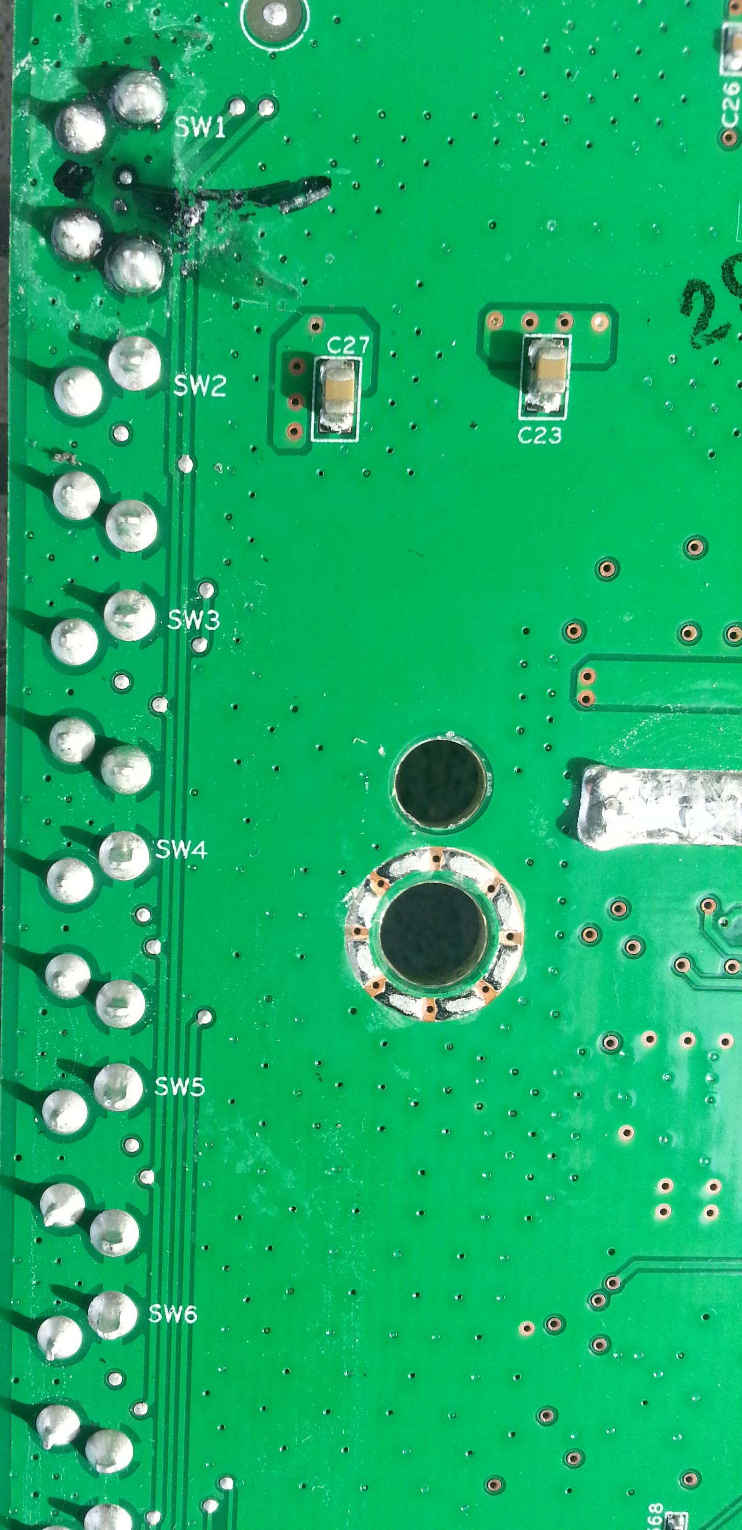

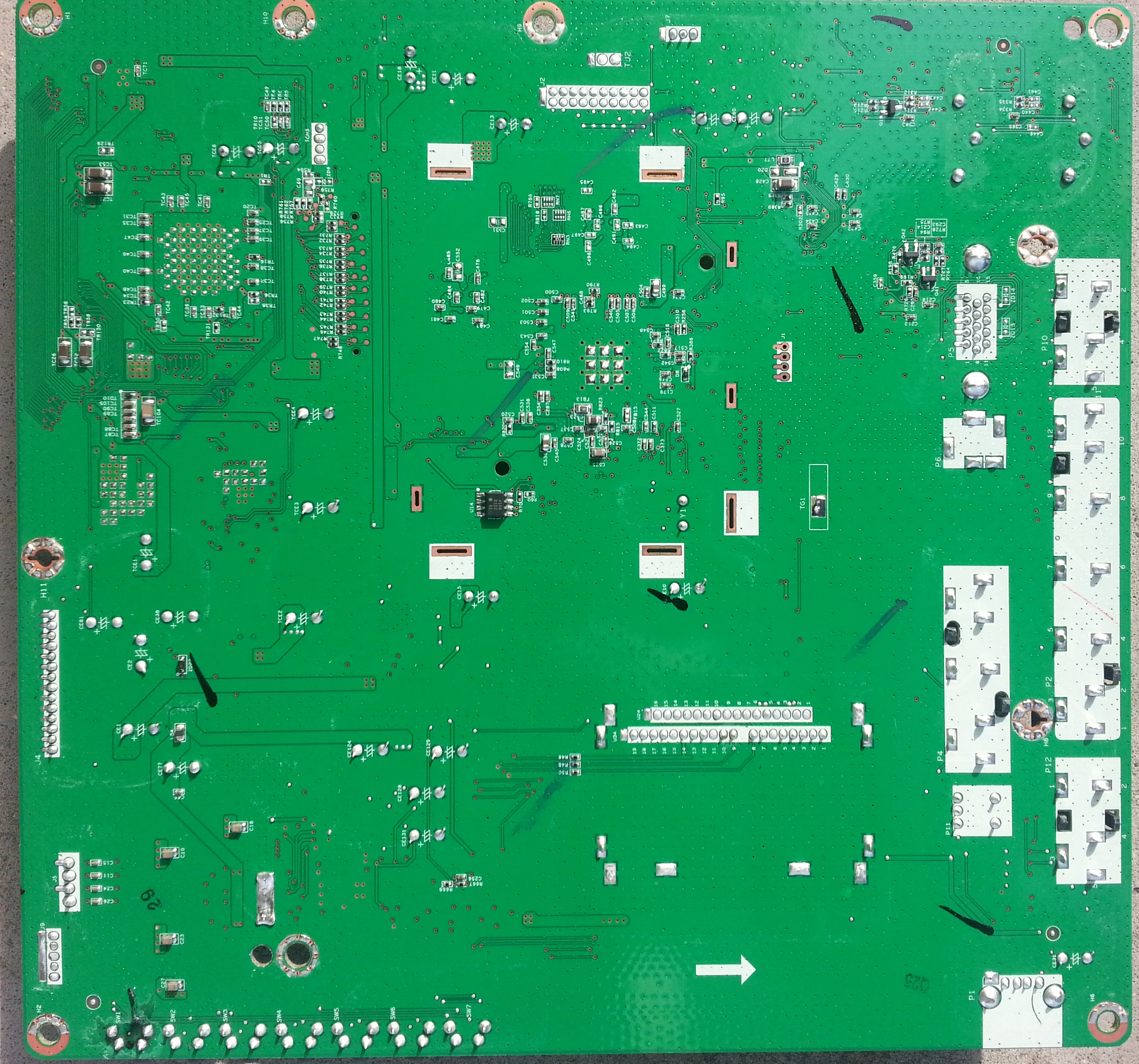

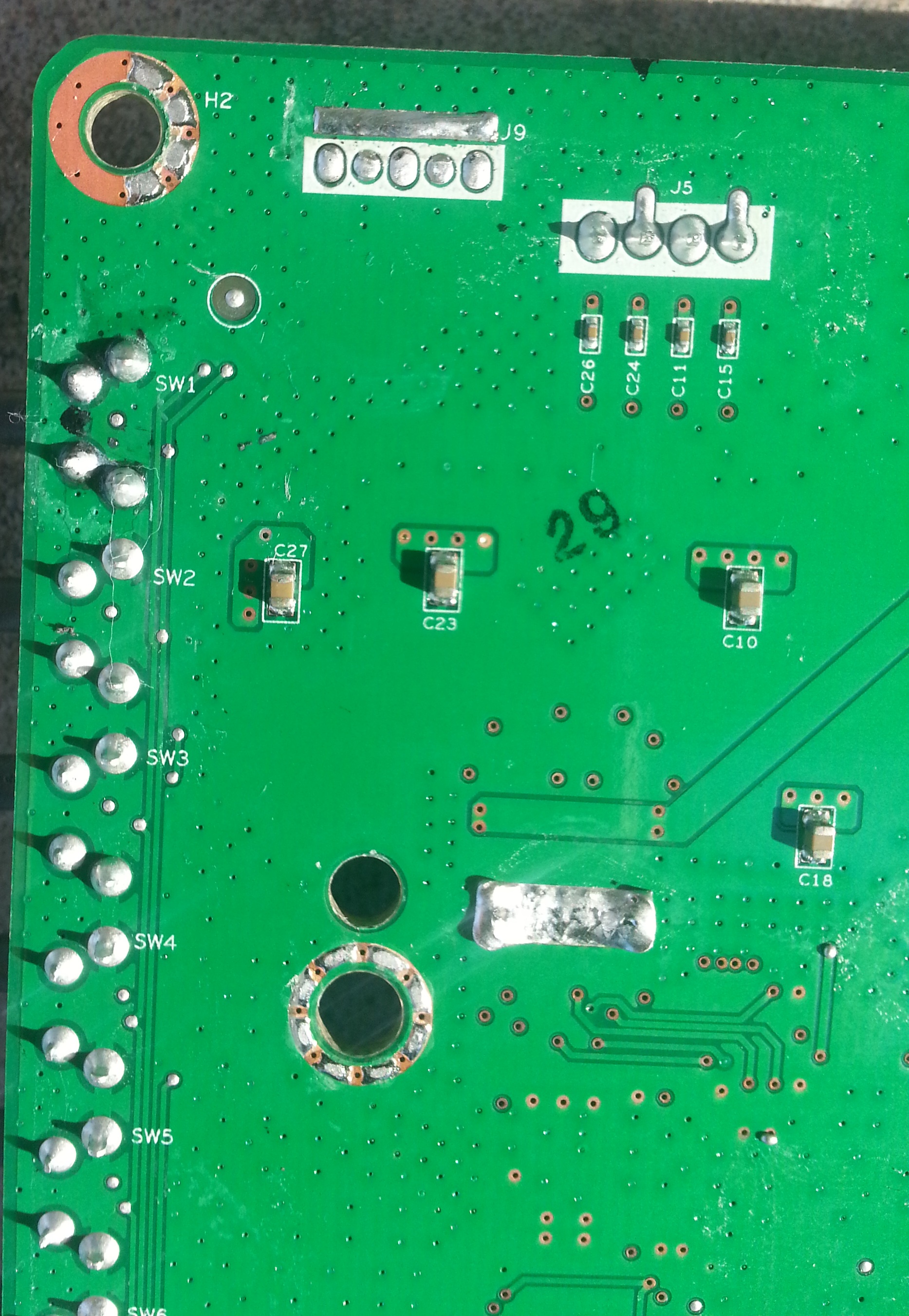

                Just been looking at the previous pics in pic 4 what has happened at SW1.
                You will need to clean it up (very carefully) so we can see if any of the traces have been destroyed
                  I have not mess with that at all, it came like that from the mfg.
                  how do I clean it, or what do I use to clean it?
                    #29
                    Isopropyl alcohol seems to shift a lot of debris. The bit that concerns me is the apparent blob of solder between the traces you will ahve to be very gentle - soft toothbrush or similar.
                    Is this a Brand new board ? Where did you get it - perhaps it should go back?
                    Also id still like to see the old boards so we can compare and make sure you have the correct replacements

                            OK - got it now so had any luck cleaning up the boards near switch 1. What does it say that switch does?
                              #34
                              I took out the stain but everything looks normal.
                                #35
                                It's the power on switch
                                  #36
                                  Likely factory rework... not really going to be a problem. Could be the EEPROM issue a lot of Vizios have. Maybe the other main boards had it too.
