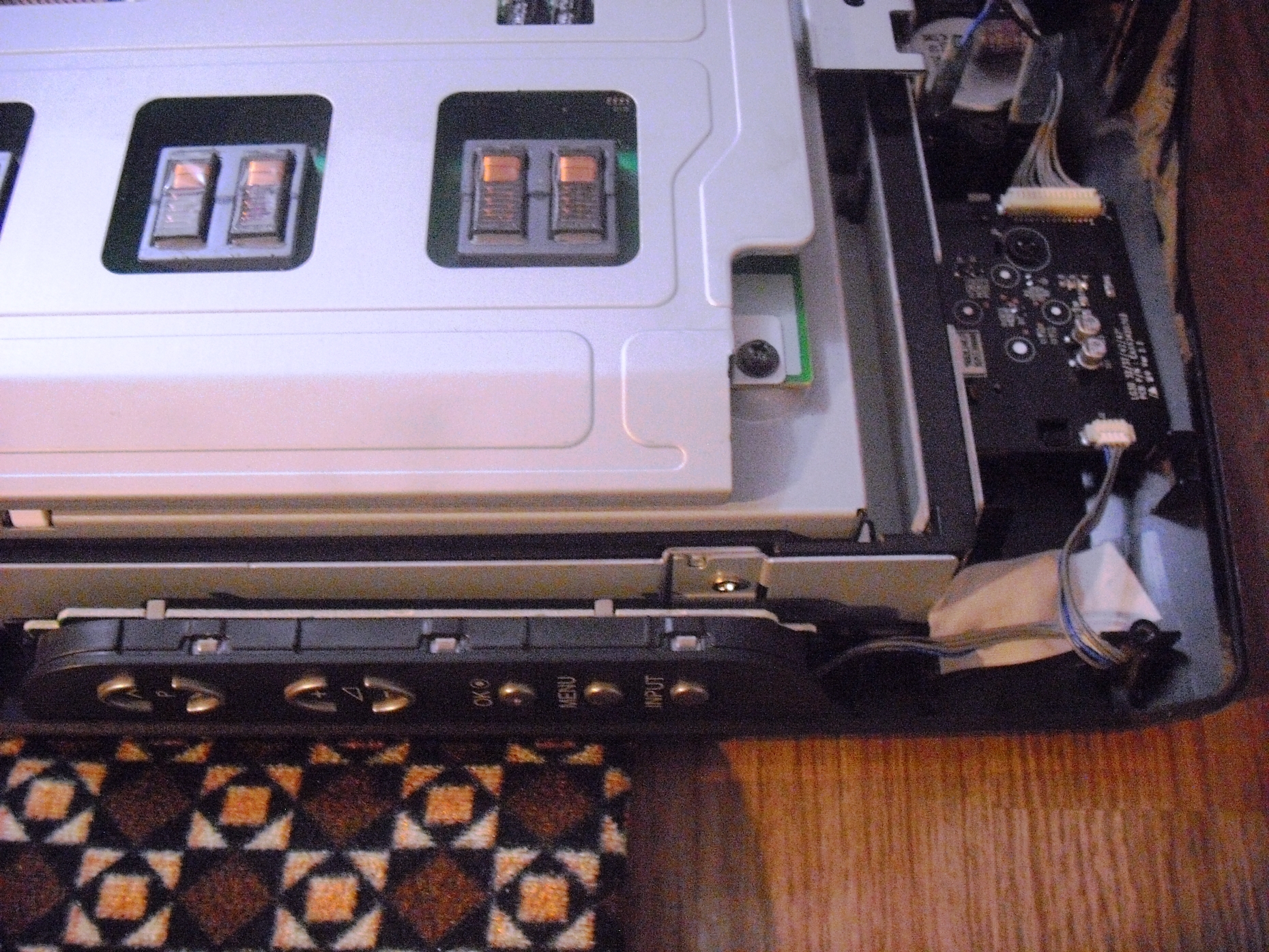

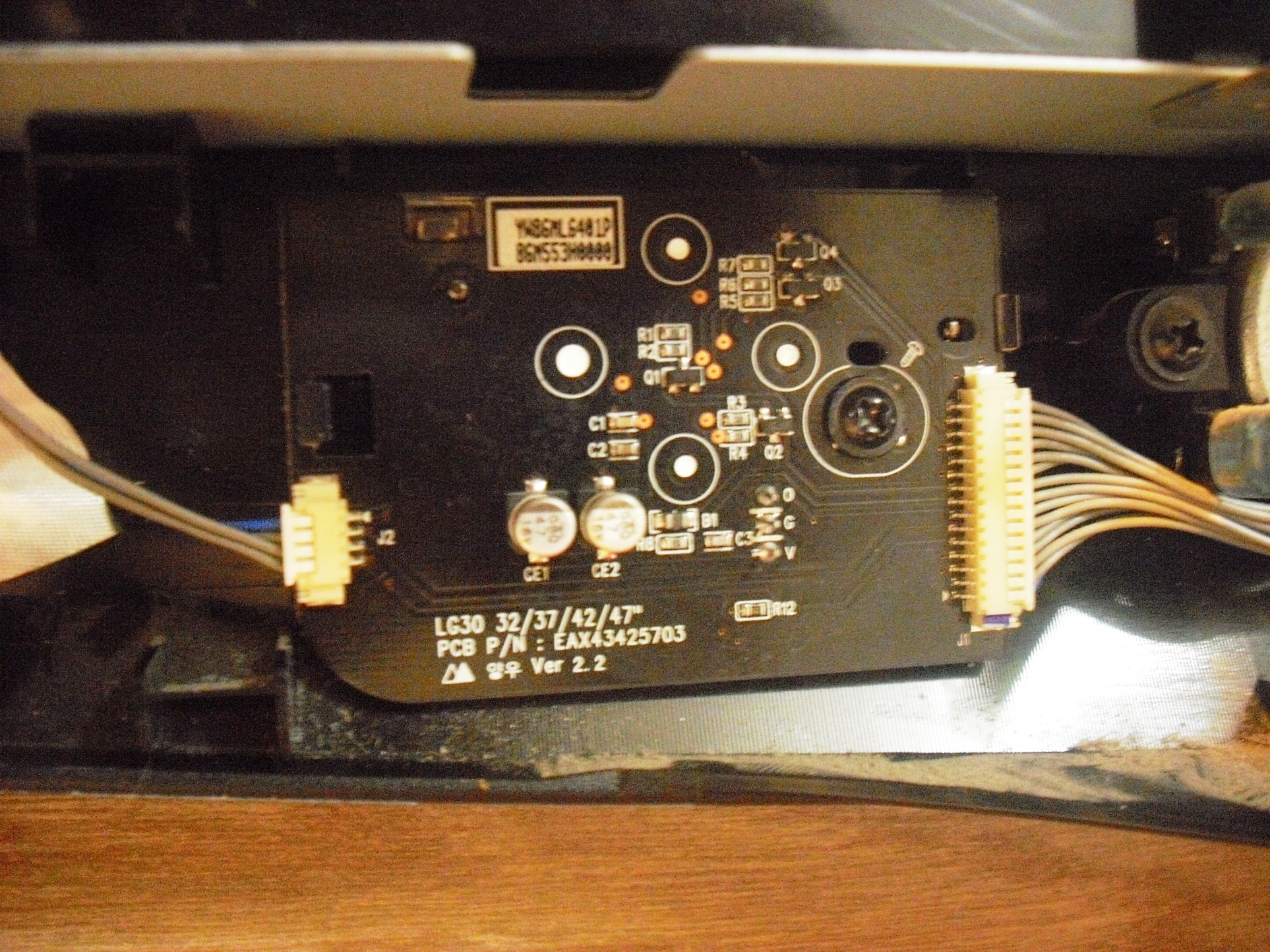

    LG 32lg3000 not responding to comands
    I have a strange problem with this TV.
    It seems that it do not want to respond to the commands given by pressing the buttons from the side or using the remote control.
    When in stand-by it is possible cu turn it on via the remote control.
    The problem is intermittent. One time I managed, with the remote, to enter in the menu and select the language but the communication stopped.
    It is like a short-circuit because sometimes the menus chance by their self.
    From the side keys the volume keys (+ & -) work almost all the time I press them.
    I measured the voltage of the pull-up resistors and it seems to be fine (4.85V).
    Any hint?

    Re: LG 32lg3000 not responding to comands
    Solved
    Power button defective
    R=~1.5k
    Thank you
