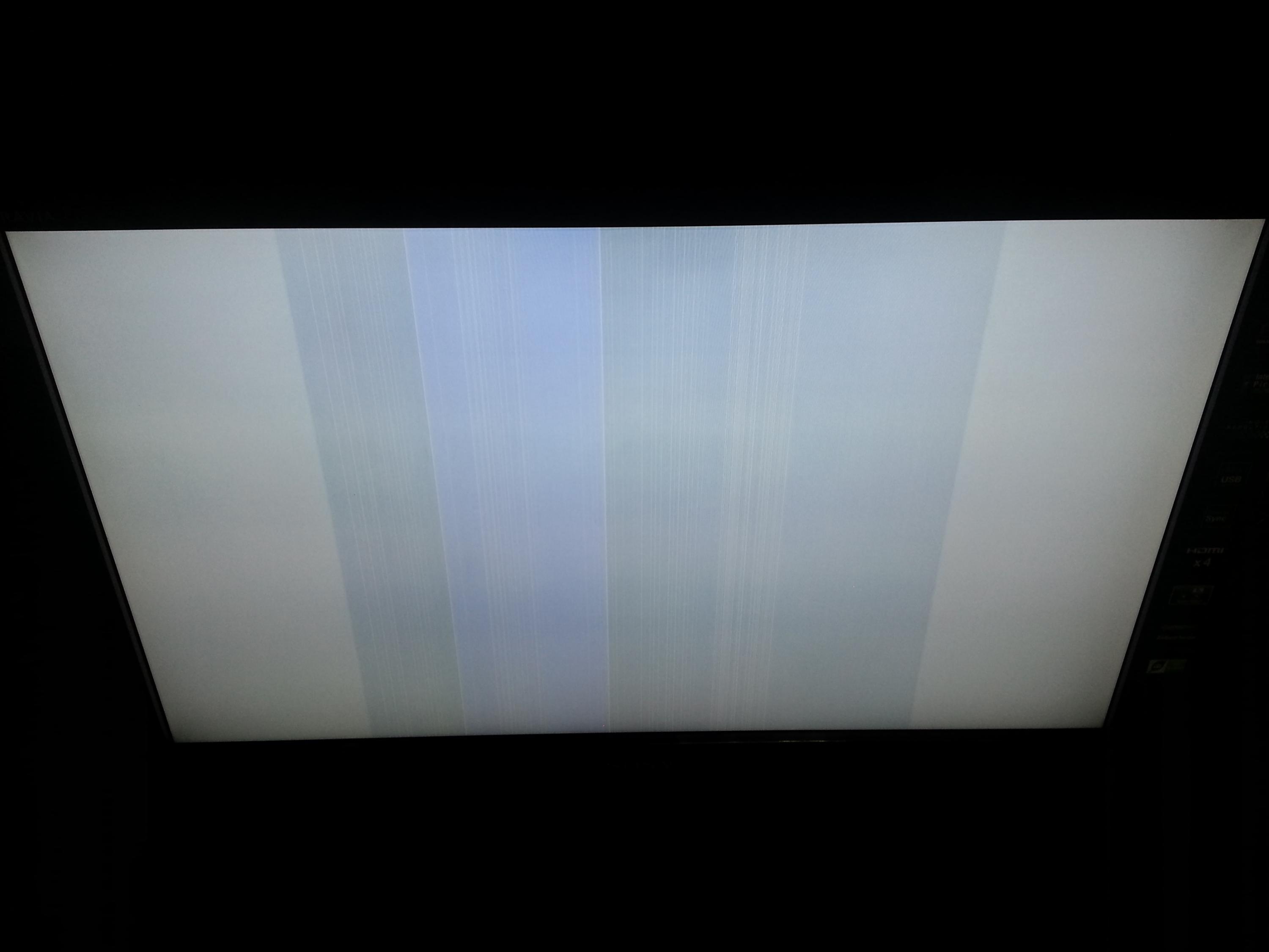

Replaced T-con board and now getting vertical lines

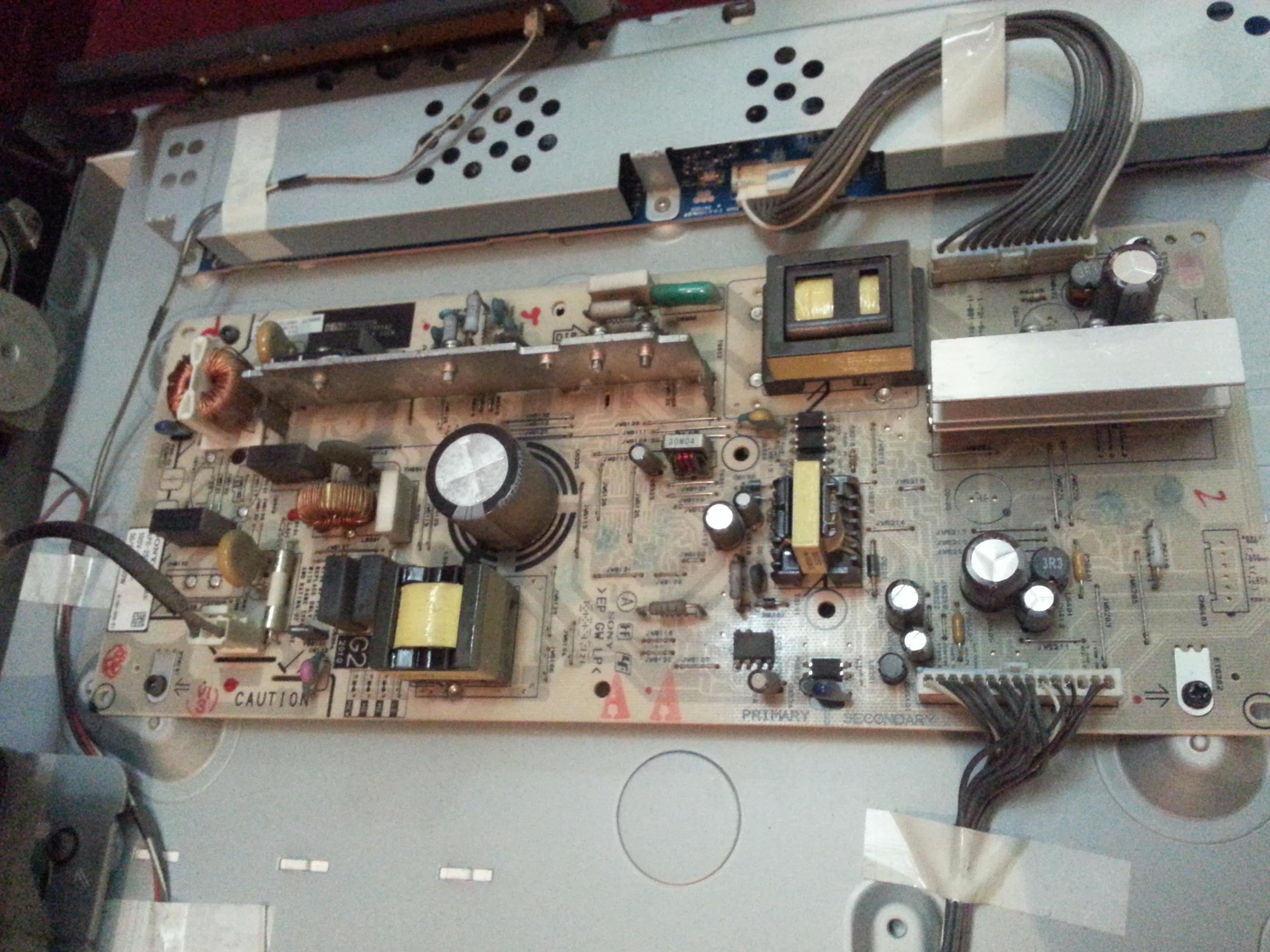

    all the pics! please some one help out!

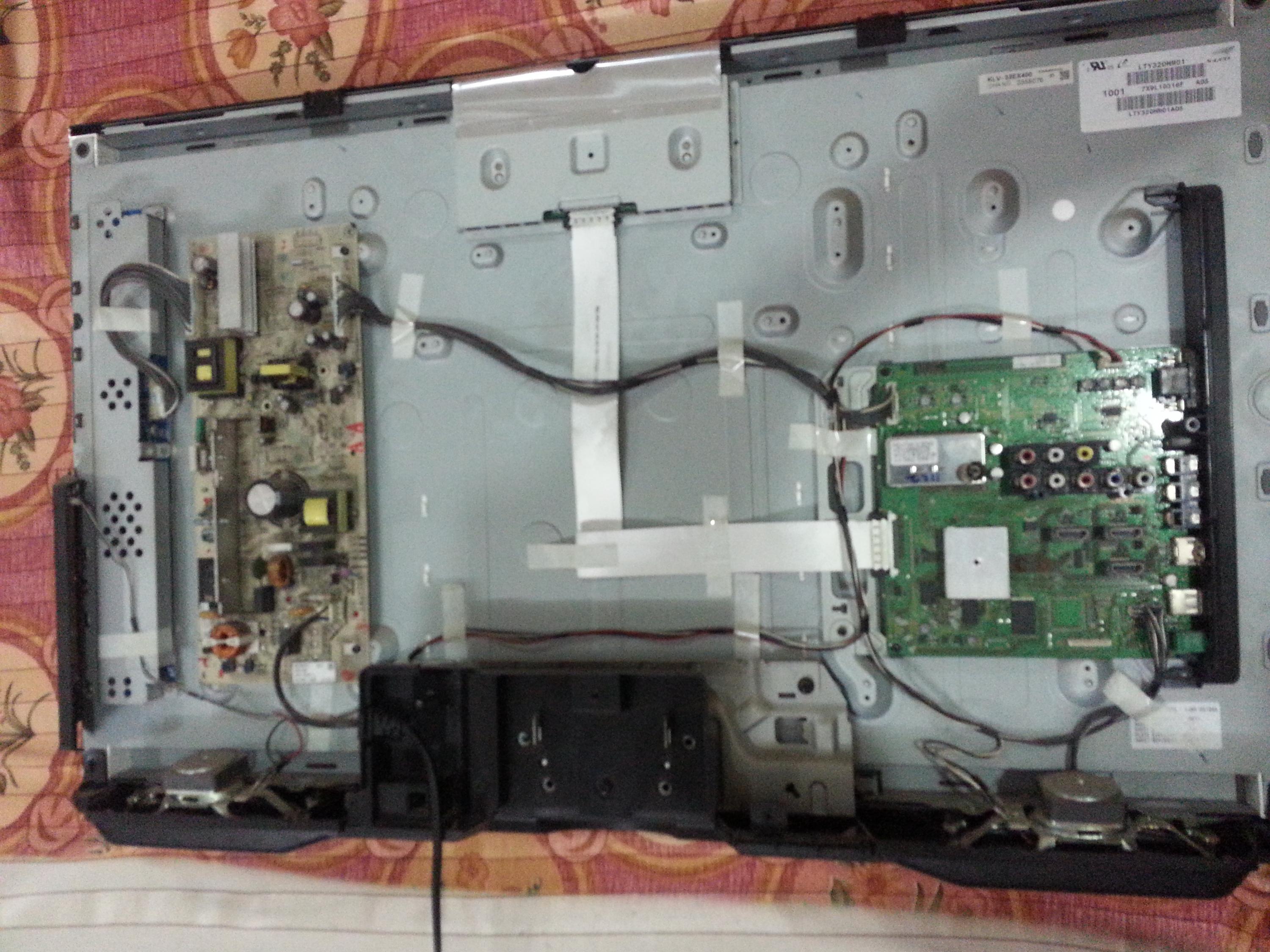

      Any one of the whole chassis?
        Re: Replaced T-con board and now getting vertical lines
        any one of the whole chassis?
        sure!

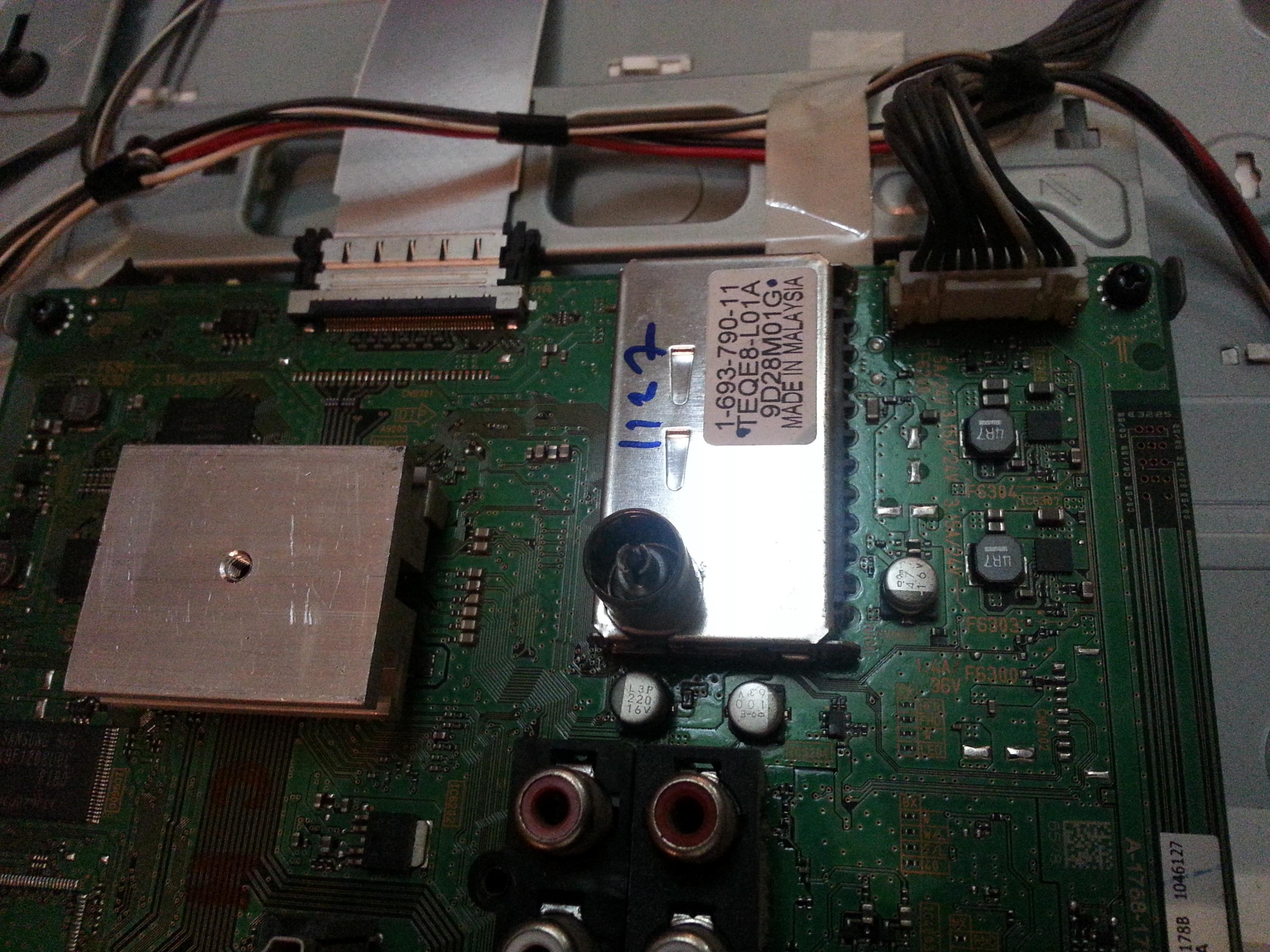

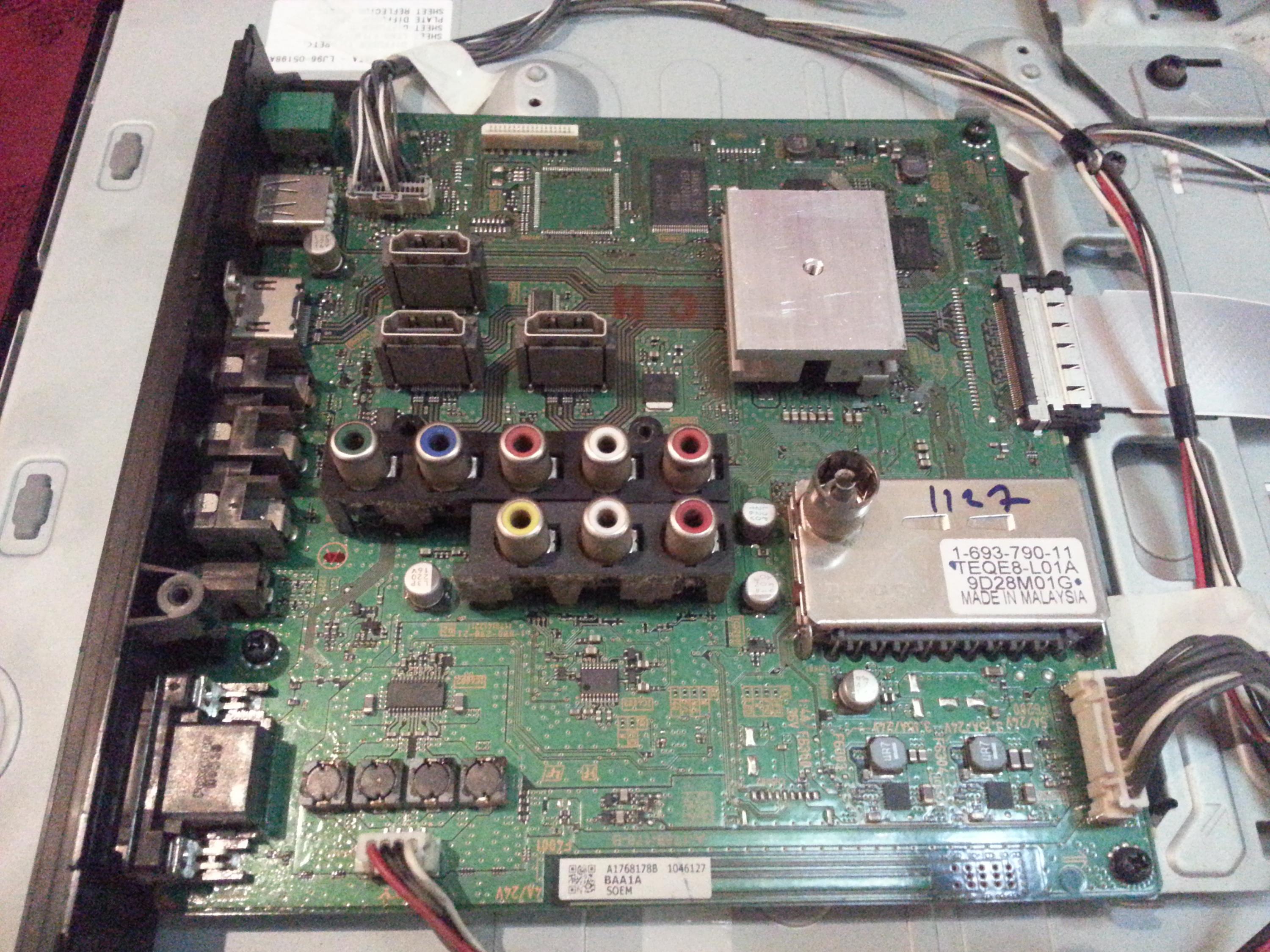

              fourth pic of main board polymers caps look like they are starting to bulge 100uf 6.3v & 47uf 16v
                sir can u mark it out in the pic and attach the pic ?
                but i think the main board is working fine, coz there is sound and the buttons and remote is functioning well..
                need your suggestions ?
                ok i located, how can it be checked?
                i have a multi meter, i checked , they have continuity with out power!
                  I put red circles around caps

                      You would need a ESR meter that is capable of testing on board or take them out to test.

                        but they are not bulged, though it may seem in the pic!

                            Even thou it may look like it's bulged in the picture and it's not
                            capacitors don't have to bulge to be bad I test all my caps to find a problem

                                        This is purely unscientific, but Sony LCD TVs are notorious for panel and main board issues. If you've tried a known working main board, you probably have a bad panel. Do the vertical lines on the screen in your pic show up like that when it's first turned on, or do they gradually appear?

                                          they are very less at starting and grow more.. then fill up.. then very light when the cfl is on full brightness.. u can see the full video.. in my earlier post
