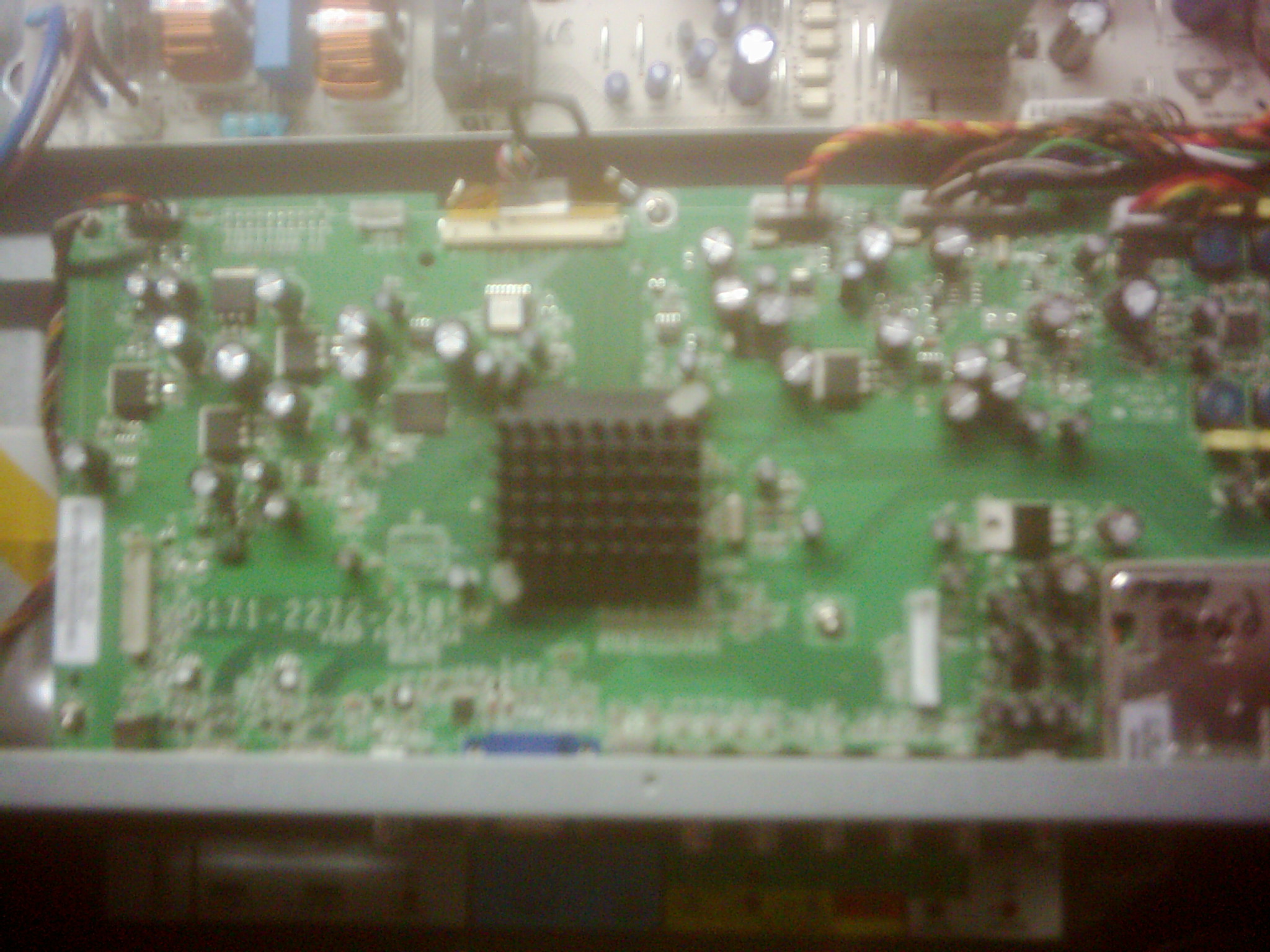

            Re: Vizio vp422hdtv10a no audio,no video.
            This is a different main board. U33 isn't a regulator on this one.
            Can you test all the others?

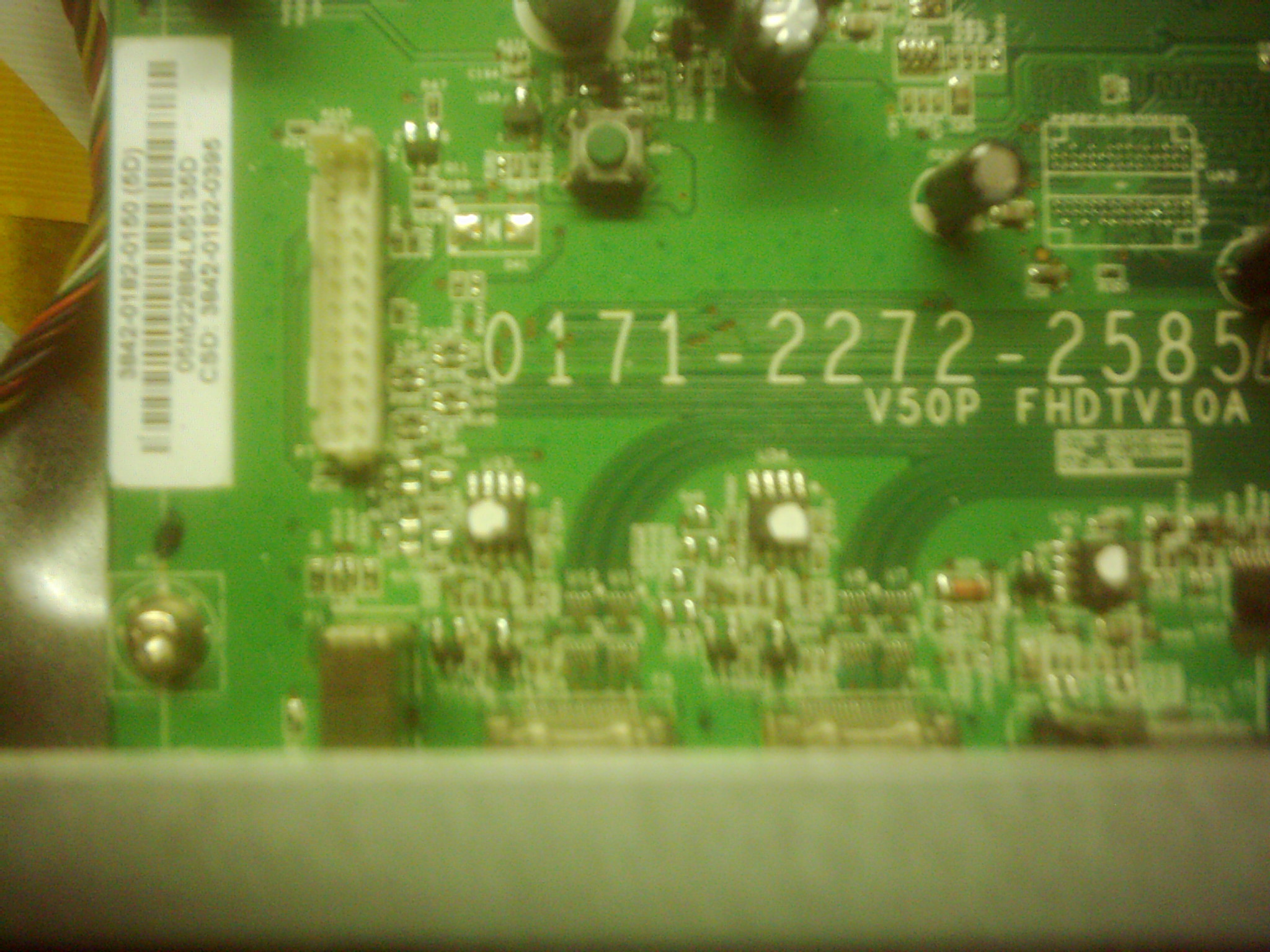

              Main board P/N# 0171-2272-2585
              V50P FHDTV10a

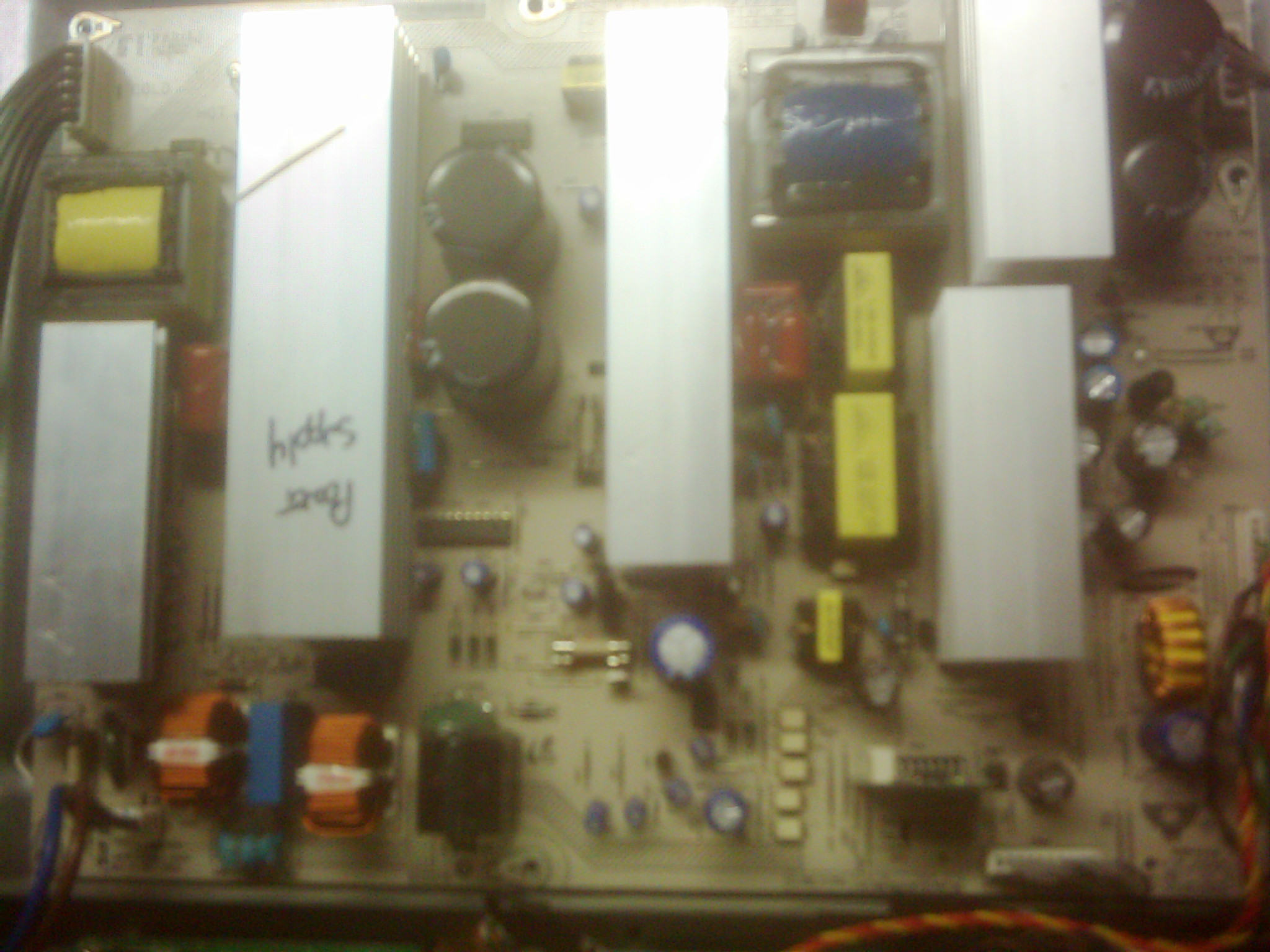

                              • selldoor
                                Slow Learner
                                • Dec 2010
                                • 7870
                                I still dont follow this I dont know how Tom saw the fuses on the board this is the worst set of pictures I have seen for some time.
                                Where is the 4th fuse if it is labelled F3 where is the one labelled F4.
                                We should have pictures where we can see the board labels next to the component
                                like in these
                                https://www.badcaps.net/forum/attach...1&d=1290283049
                                https://www.badcaps.net/forum/attach...7&d=1280167246

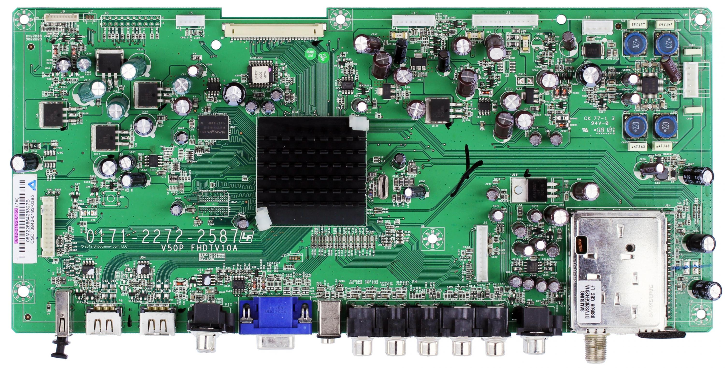

                                    i have enclosed a picture off the web of ALMOST the same @ shop jimmy,cant get a good picture of mine.(mine m/b also has a reset button,which is not pictured)....ok fuses,
                                    with a/c cord plugged in,ground to chassis F1-.736VDC both sides,
                                    F2-0.0VDC,both sides, F3-0.0VDC,both sides,F4-5.16VDC,both sides.
                                    Also, ckecked both sides sides,of fuses with a/c cord unplugged,meter
                                    set @ omhs with tone all ckeck ok.
