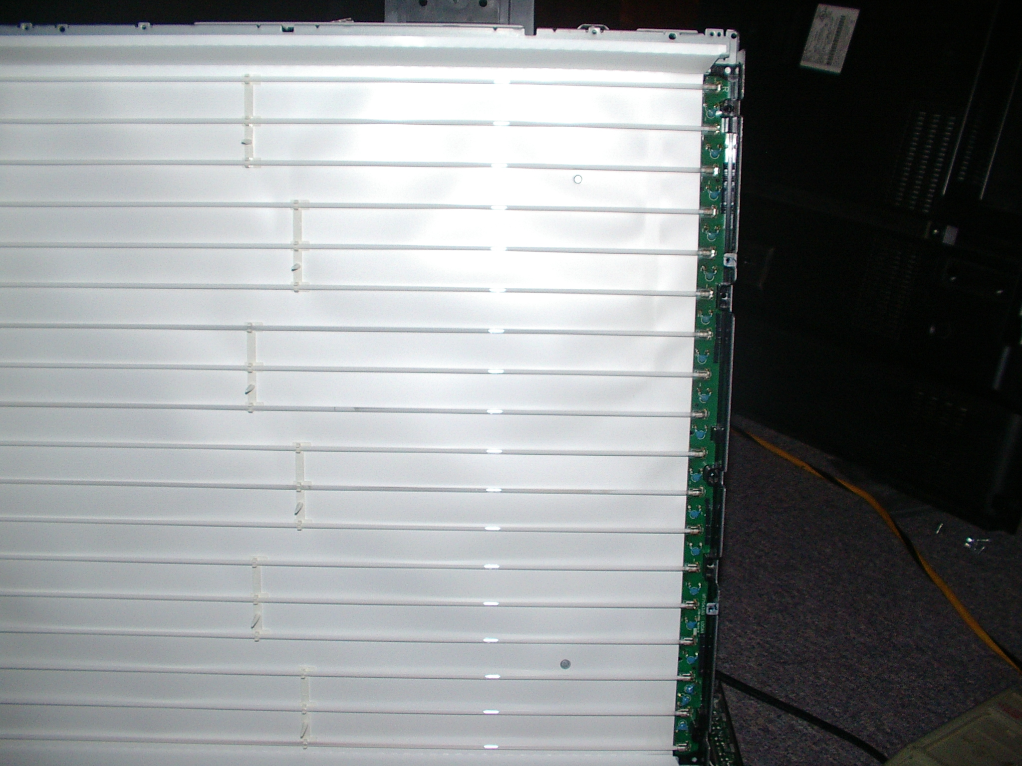

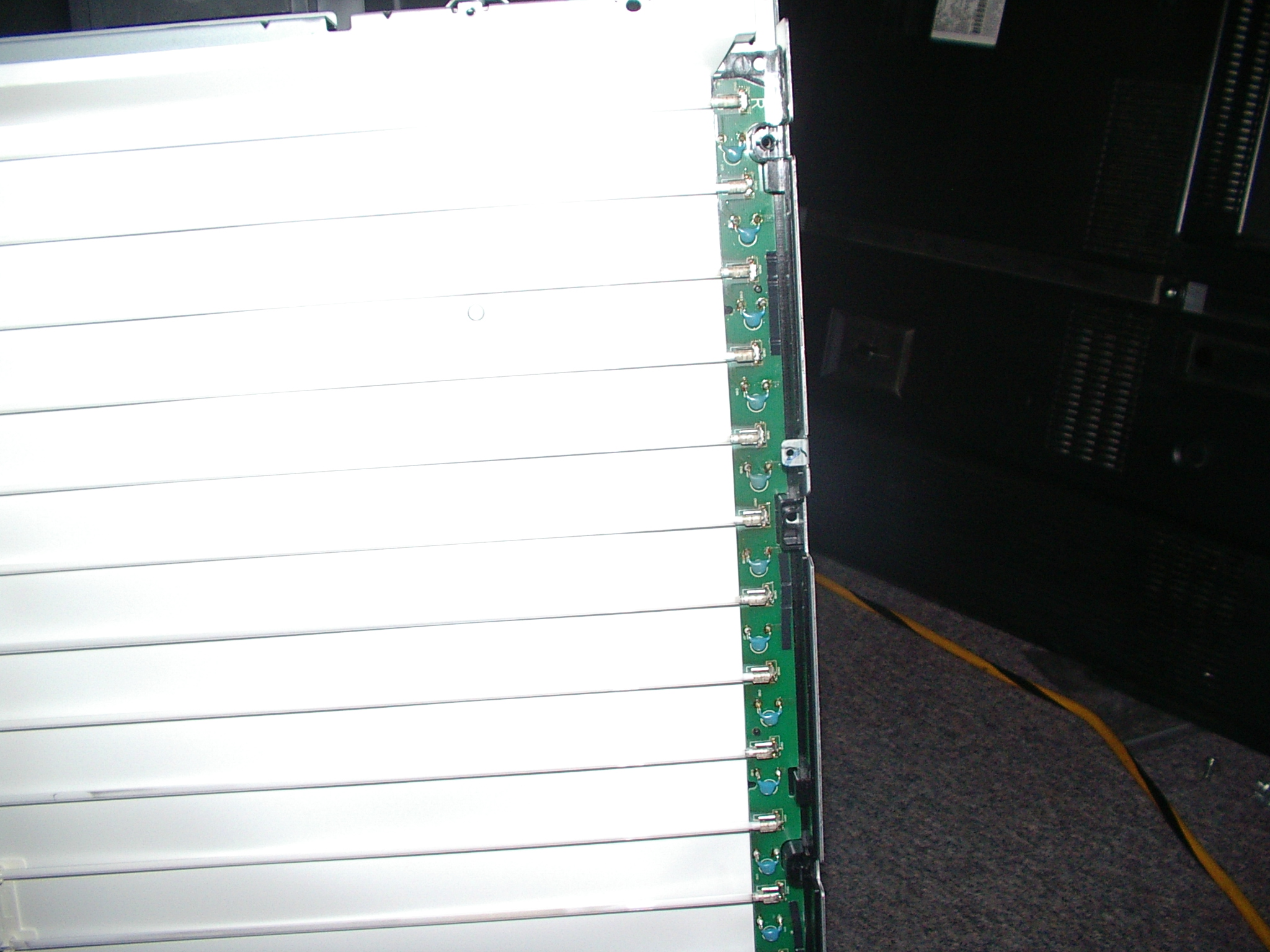

                  it s tore down to the bulds there is 1 bulb 4 sure blown ,,,,if the bulb was taken out would it work ?? as in staying lit up instead of just lighting up for a split second

                        a bulb in middle of screen

                          Re: Another Sanyo DP42848 Good Sound/No Picture
                          the end /side
                            You need to fire up the screen to find the faulty bulb.
                              #54

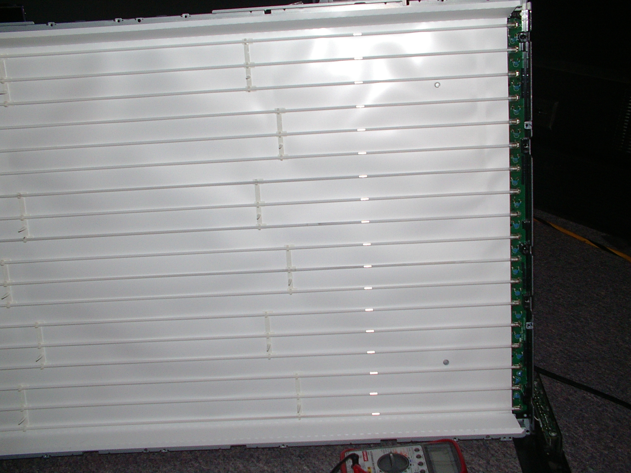

                              yes i fired the screen up there is two bulbs that are bad. the screen shuts down right after it starts up. if i remove the two bulbs will the screen fire up? or do the bulbs have to be in ?
                                #55
                                It'll detect any faulty or missing bulb, you'll need to replace them.
                                    well there looked to be 2 bulds not working,,, and there was another that had the burnt look to it so i took it out also!! i did break 1 of those plastic taps that hold the bulb in place,,then i figured out how to take them out,,,,lol !! also i stoped at raido shack,,they have these (mini wire clips) the bulb will fit in it pretty good ! i did find bulbs at a place called rescue parts. i guess now its a waiting game for the parts to come in! i hope this is the fix for the tv!!
