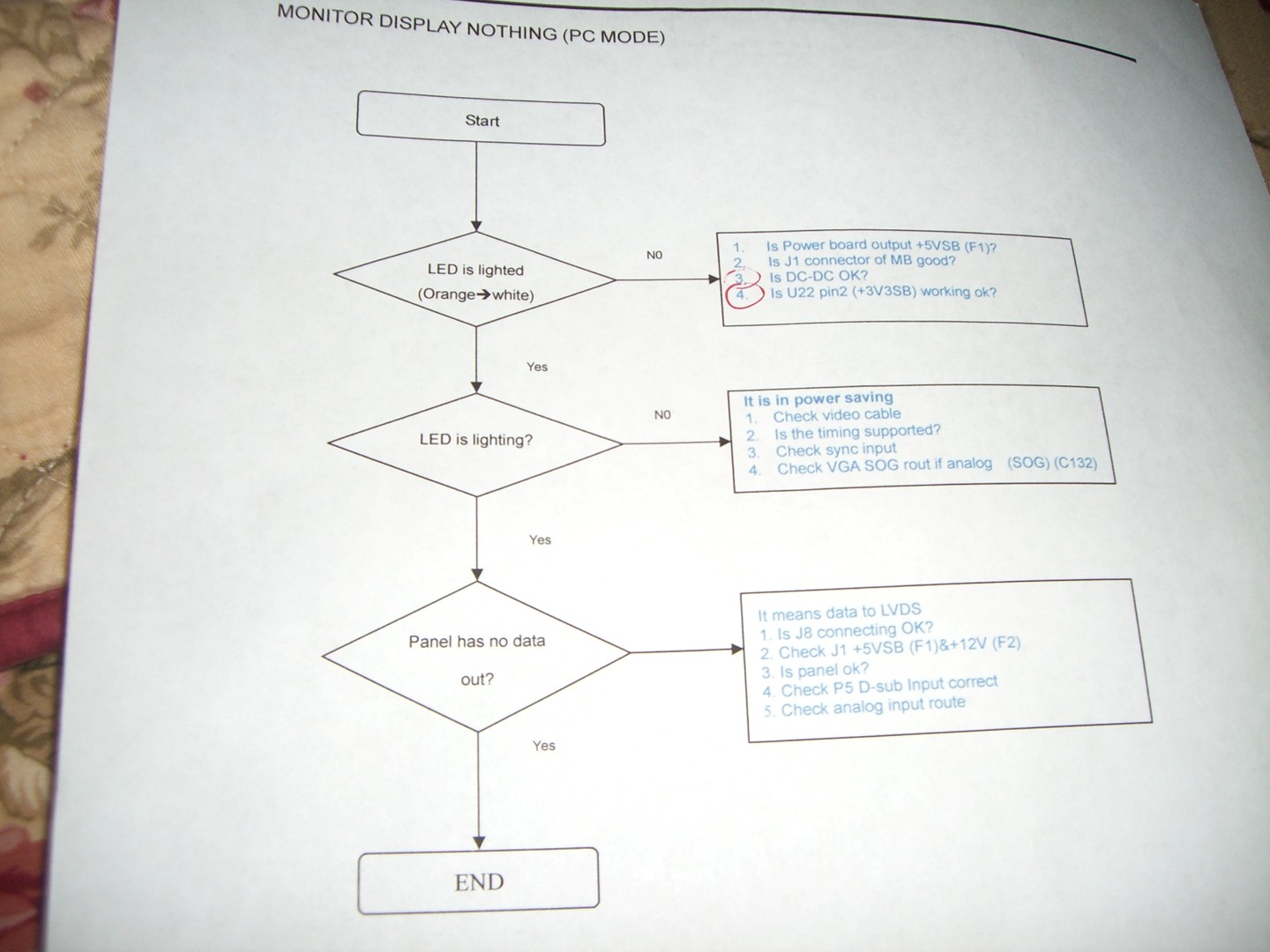

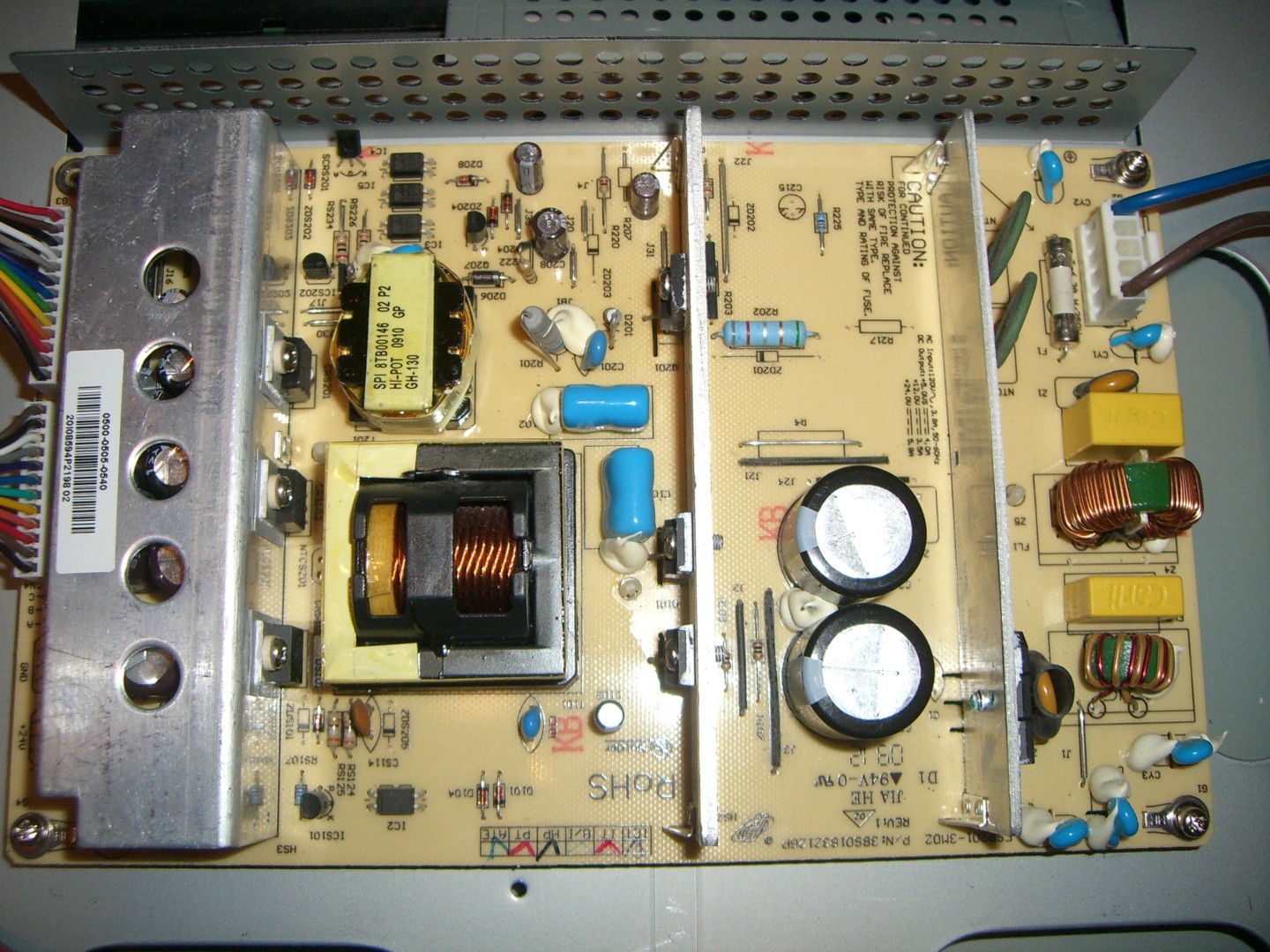

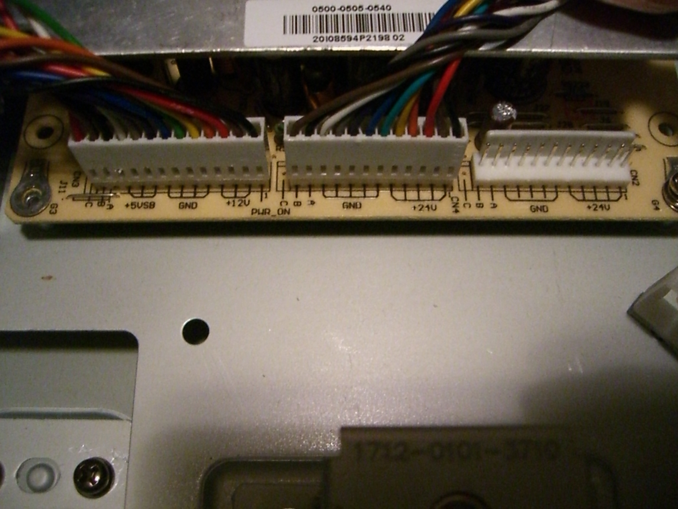

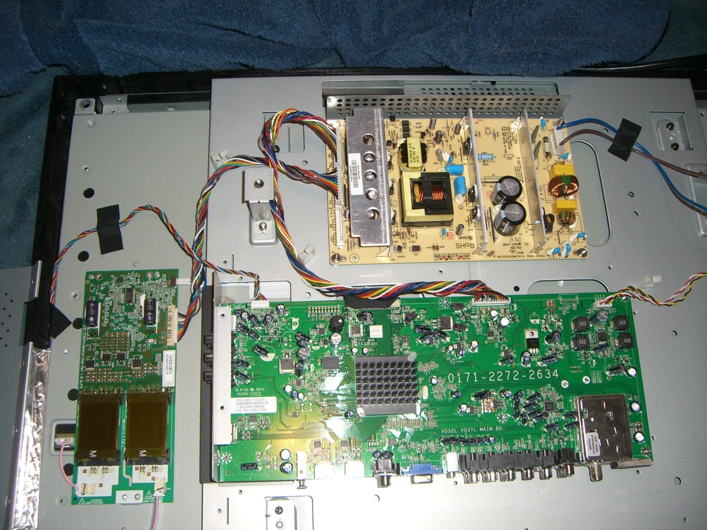

    Vizio amber light is on when plugged in. Does not turn to white with power button. no backlight. Looked for leaking caps..did not see any obvious ones.

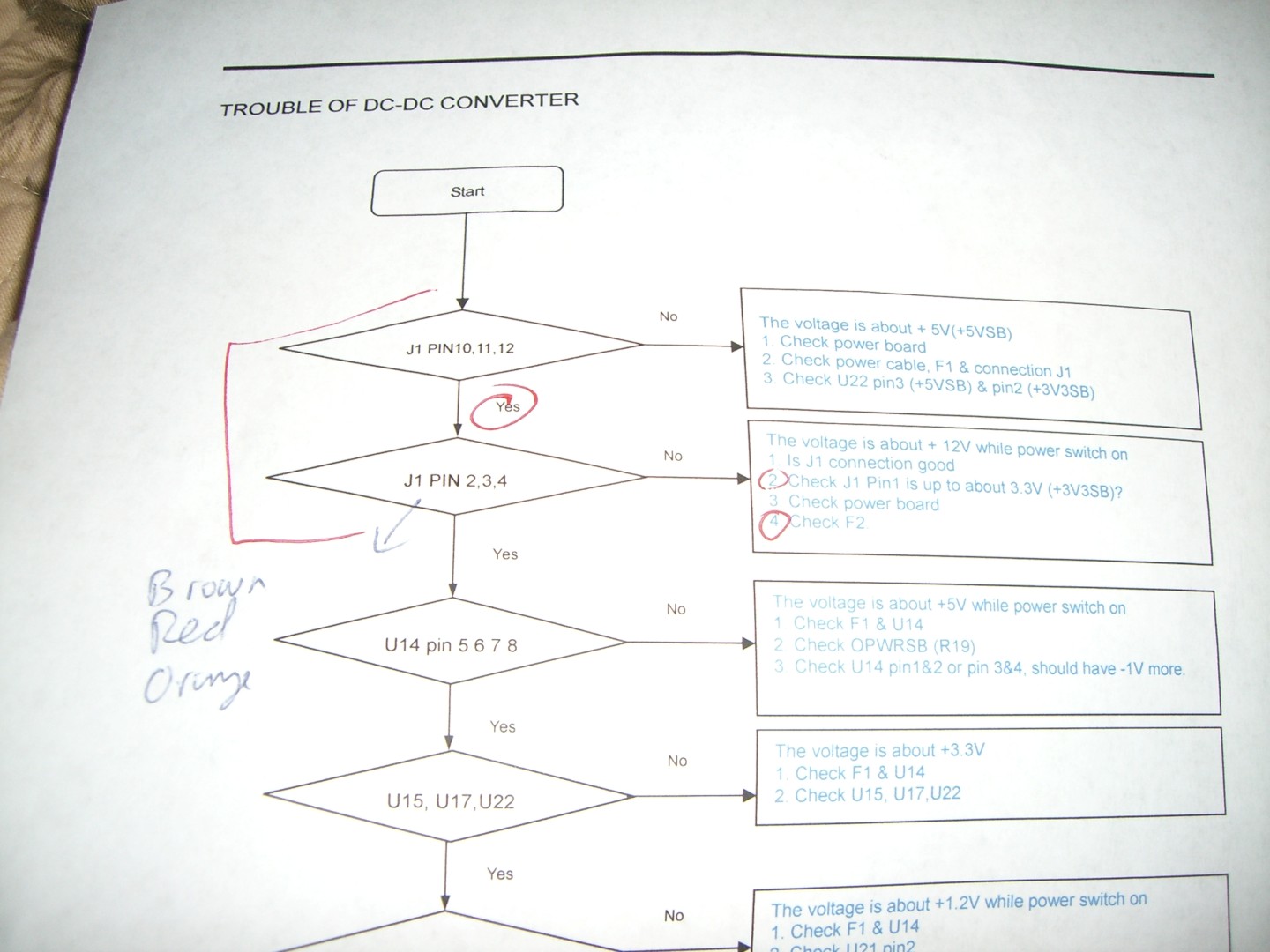

    Downloaded the manual, and read through the forum. made the measurements below:
    Power supply board:
    +5.16V present, 12V pins=0, 24V pins=0
    PSON voltage on J1 pin 1 = 0 (45 mV)
    Main board:
    U22: pin 2 =3.321V; pin 3=5.17V (working?)
    Both ends of F1=5.17V, both ends of F2=0V
    power off: F1 and F2 are both 0 ohms.
    so does this mean the 3.3V needed on J1 pin 1 is getting dropped somewhere between U22 and F2? what should I check next?
  • Ldempke
    • Oct 2012
    • 12
    Re: Vizio VOJ320F1A orange light on only
    oops. I guess the photos got left off. I'll try to post them here...

      Vizio -> means check voltage regulators. See my sig file below on how to test and report results in the preferred format.

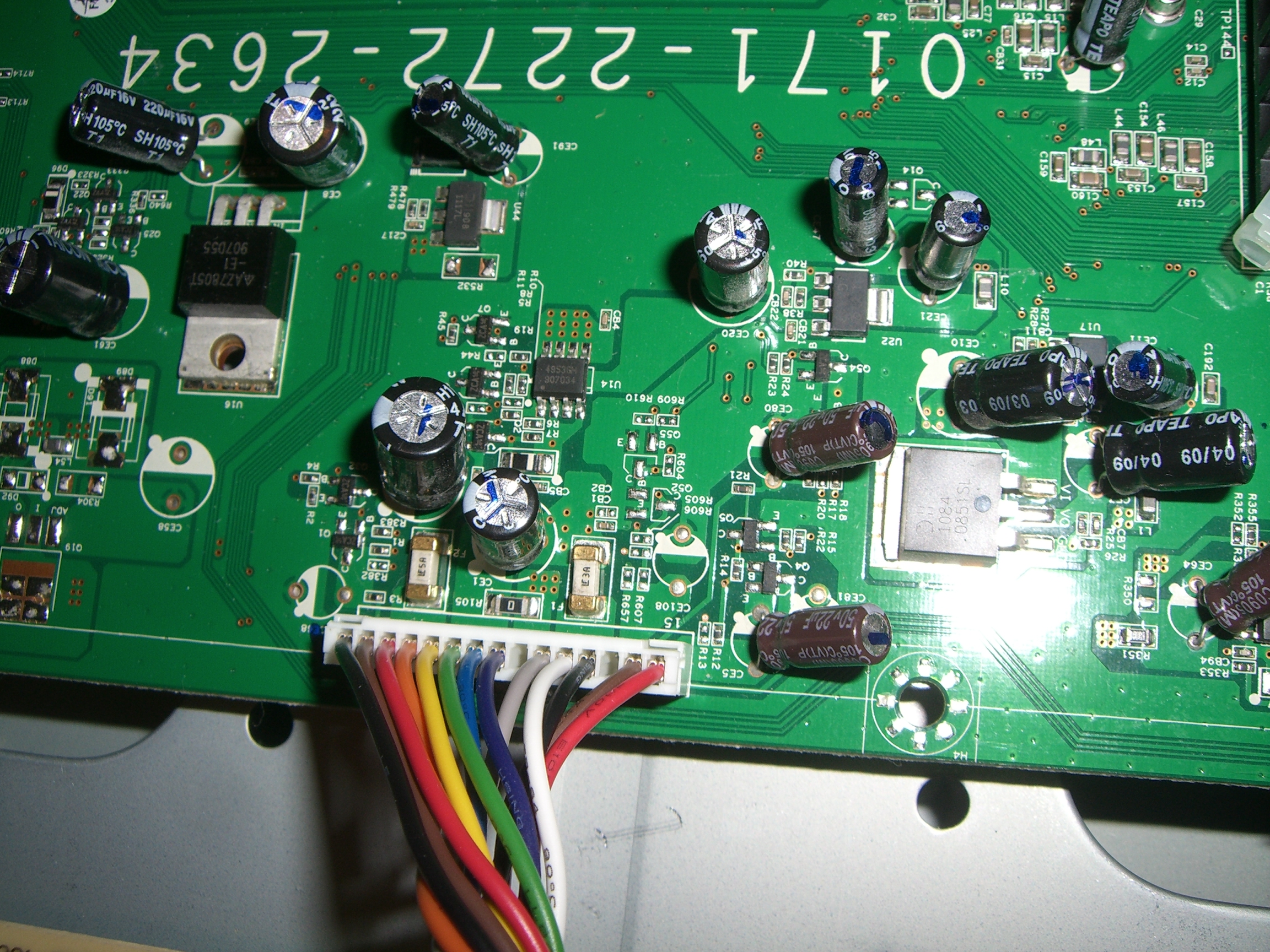

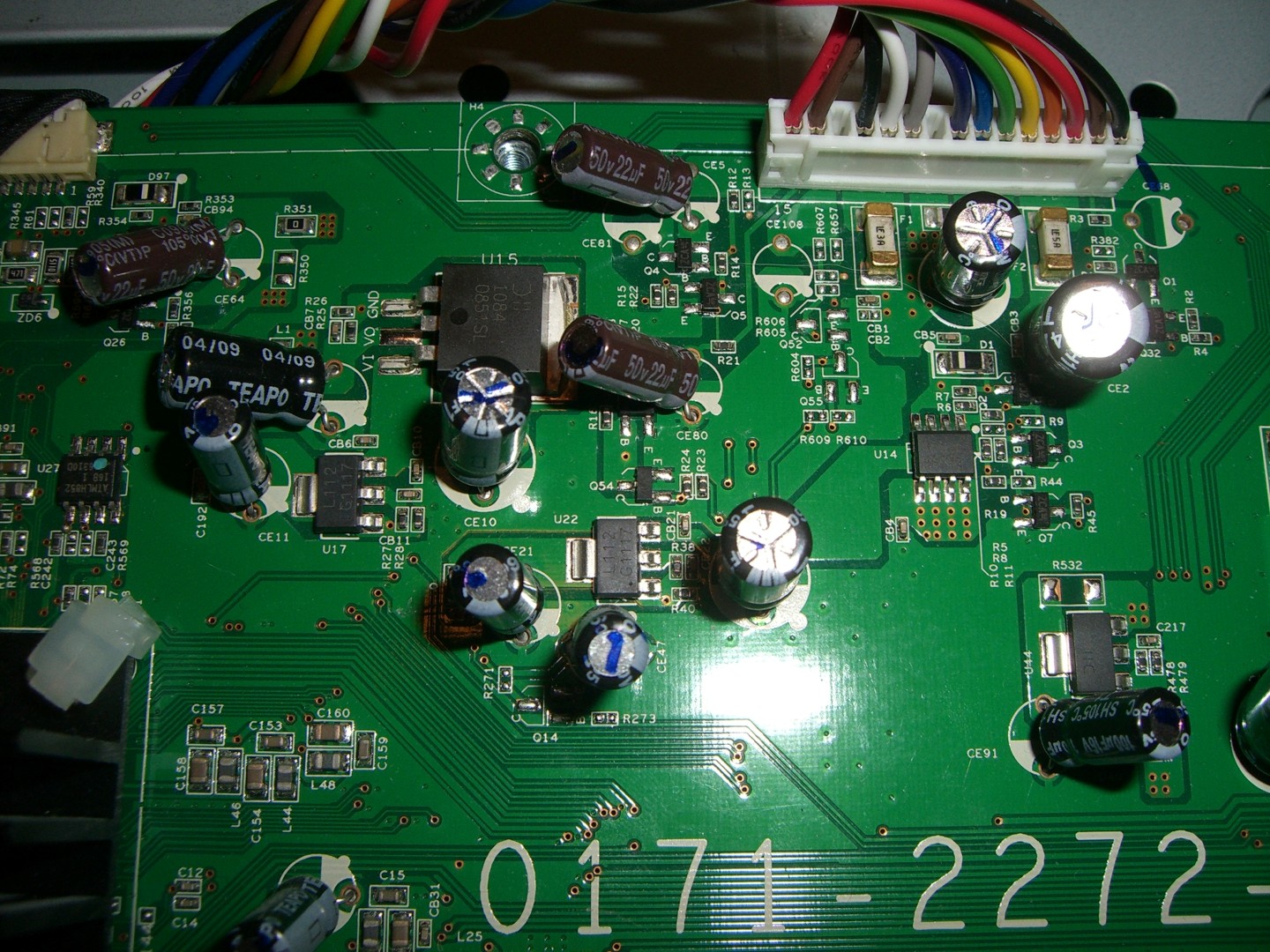

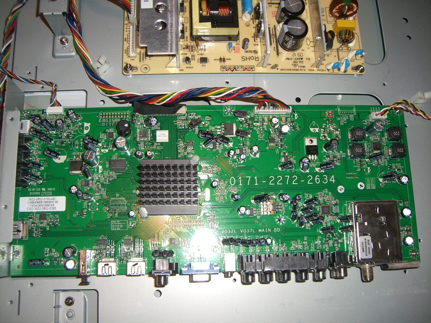

        Here is the info on these:
        U22 -> pcb designation
        L112 -> line 1 of the IC
        G1117 -> line 2 of the IC
        pin 1 = 2.074
        pin 2 = 3.321
        pin 3 = 5.16
        XXXXXXXXXXXXXXXXXXXXXXX
        U19> pcb designation
        pin 1 = 0.000
        pin 2 = 0.000
        pin 3 = .0045
        XXXXXXXXXXXXXXXXXXXXXXXXXX
        U21-> pcb designation
        pin 1 = 0.000
        pin 2 = .0004
        pin 3 = 0.000
        xxxxxxXXXXXXXXXXXXXXXXXXXX
        U17 -> pcb designation
        pin 1 = 0.000
        pin 2 = 0.000
        pin 3 = 0.0046
        XXXXXXXXXXXXXXXXXXXXXXXXXXX
        U15 -> pcb designation
        1084 -> line 1 of the IC
        0851SL -> line 2 of the IC
        pin 1 = 163mV
        pin 2 = 262mV
        pin 3 = 4.6mV
        xxxxxxxxxxxxxxxxxxxxxx
        U20> pcb designation
        pin 1 = 255mV
        pin 2 = 0.000
        pin 3 = 261mV

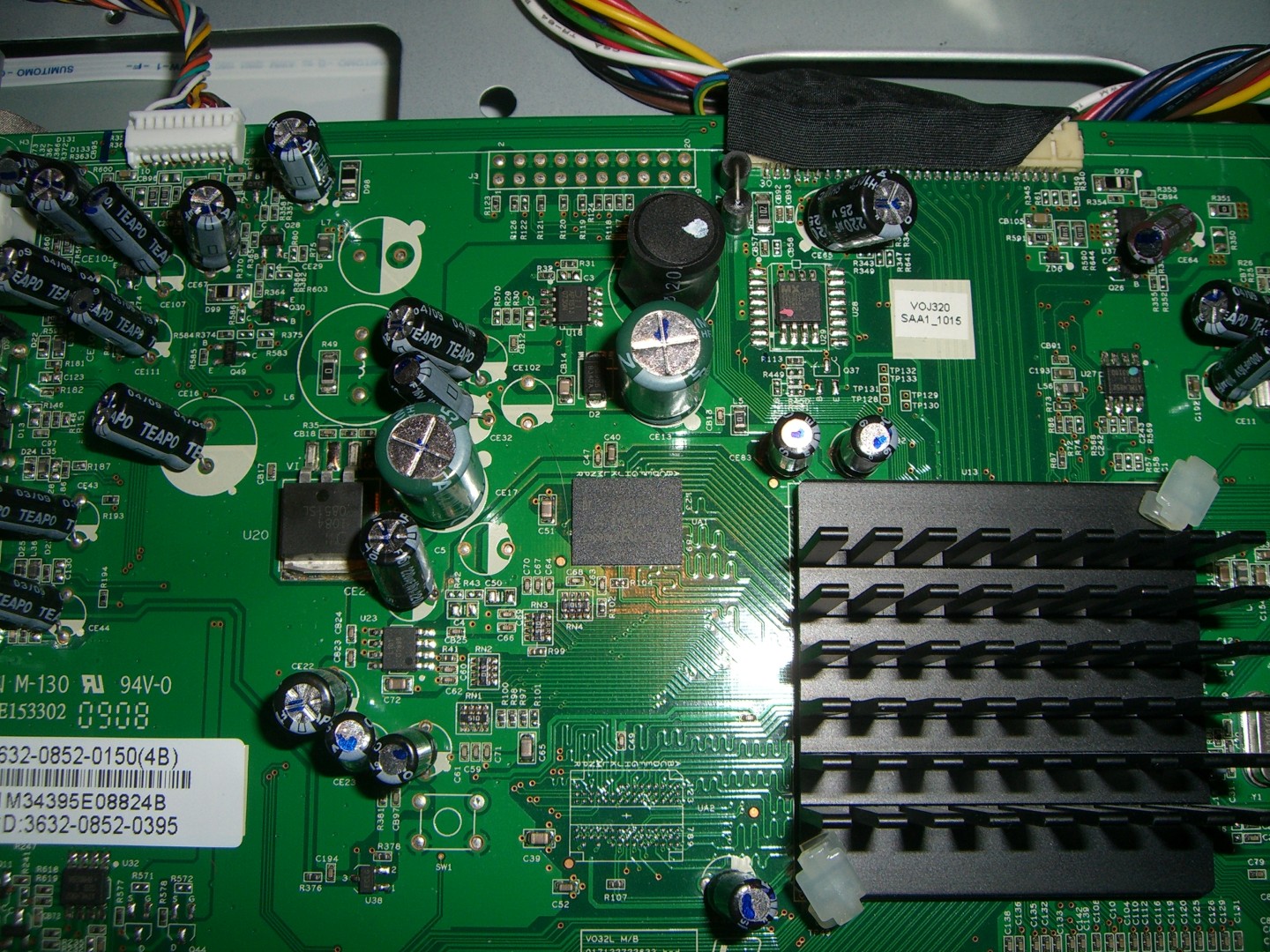

          All regulators appear fine. Can we get a closer picture of this area -- it has a buck (DC-DC) converter on it for powering the CPU.
          Right now it looks like a software problem. I am aware that Vizio are sending out a box to customers to fix their TV if you call them up and talk to the support people. The box plugs in to the VGA port and is supposed to reprogram something that gets corrupted.

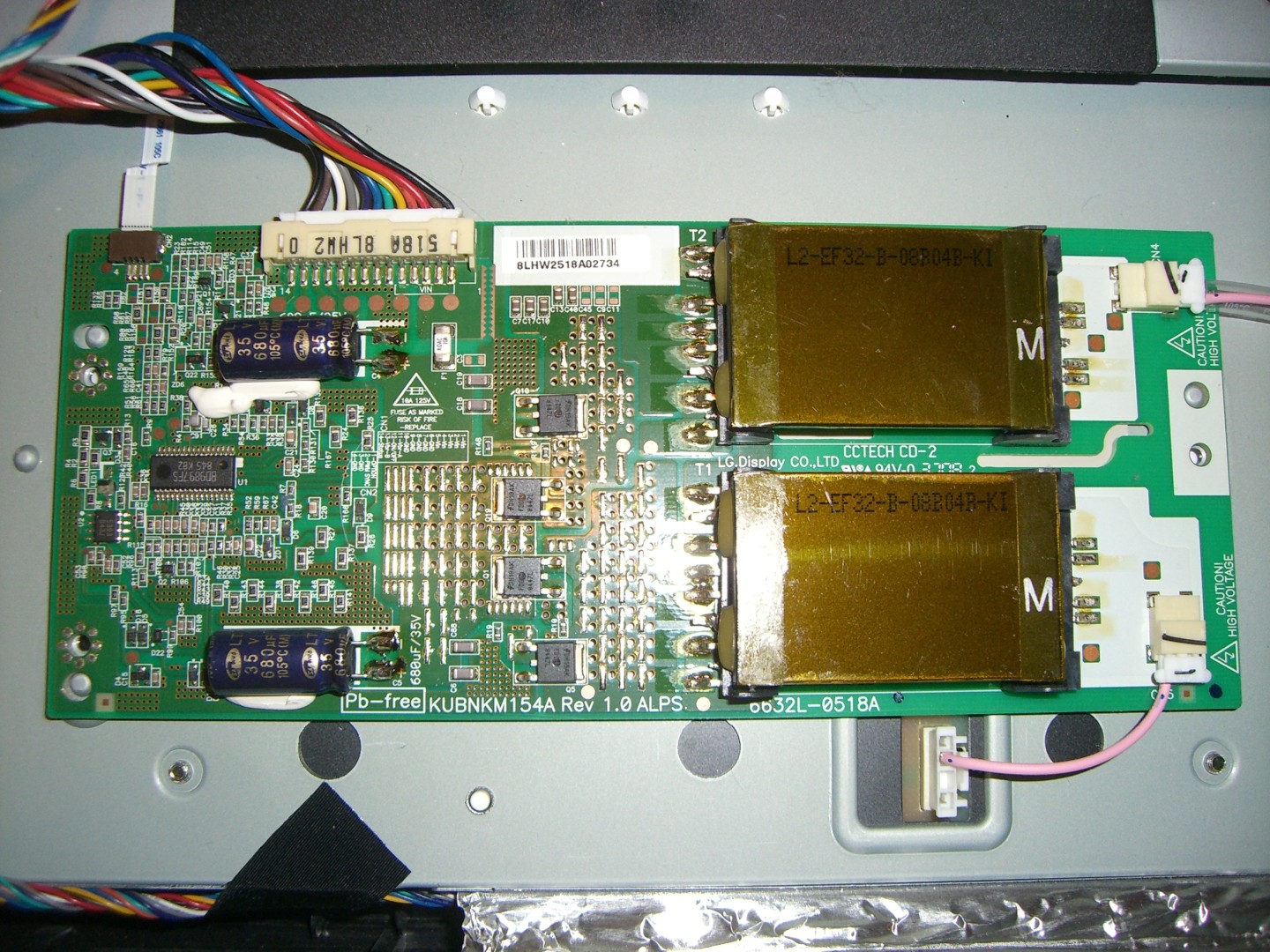

            In your pictures above, I only see one inverter board (Master). This is the board on the left hand side of the picture showing three boards. There should be another inverter board (slave) on the right. To check these, refer to my post from a couple of years ago here:
            https://www.badcaps.net/forum/showpo...4&postcount=29
            Those small fets fail as well. The caps on those inverters sometimes go bad too. Overall, Vizio failures are common.
              Tom66: attached is the close photo.
              Dgtech: I hadn't noticed the Slave board. it must be buried. I will look now and get those resistance measurements.

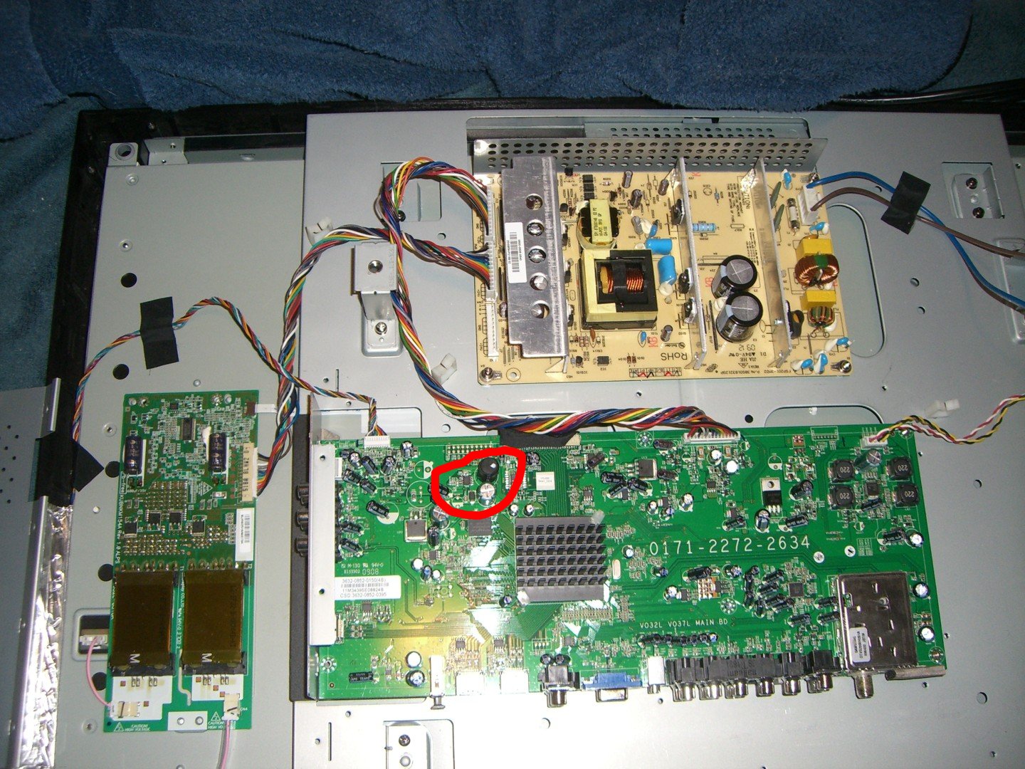

                OK, you can test here (at either position) for the core supply voltage. Black probe should be on frame, red on test point.

                  more info: This is my friend's TV. There was a pop sound when it died. I called Vizio tech support who, since it is out of warrantee, referred me to their contracted repair center. Their suggestion was to send out a repair tech. He would have all the boards with him, and they would replace them until it worked. for $180. she didn't want to spend $180 on an older model 32", so, since I tend towards being techy...and have some electronics experience from old Air Force days, so I volunteered to take a look. After opening, I didn't see any obvious leaky or swollen caps, so began to dig in deeper, but didn't have any equipment. came back 2 weeks later with old, cheap multimeter...and found it was inconsistent. meanwhile, she bought a new tv (non-vizio). but I would still like to repair it for her, for her second bedroom...and for the fun of it. so I am here at her house until 6 or 7pm Pacific time tonight (Monday 12 Nov) I will be checking the thread often and try to reply promptly. also attached are 2 of the troubleshooting pages I found in the service repair manual. that is why I thought I wouldn't find the 3.3V on U22 when I got here last night with meter. so I posted for help. I replied to RetiredCaps post with voltages from similar fets to U22, but I'm afraid the spec sheets might be over my head. are there more Voltage regulators on that baord I should checking?
                    CB13: bounces and settles down to .3mV
                    L5: bounces to .5mV
                      The CPU is not getting power then. It might be because the converter is off or because the converter is faulty. But this could be because it's in standby.

                          the 4 Mosfet's on the inverter board are part numbers FDD8447L. I measured Gate/Source resistance for each one at around 8.5k ohms. while the part was on the board. TV unplugged from mains.

                            Can you get a part # for U18 near where you tested? It's the 8 pin chip.

                                    OK pin #1 is marked with a small dot. Pin 2 is adjacent to it. It should be LOW (<1V), if the output is also low.

                                      yes, it is low. Pin 2 is 4.4mV
                                        So it is working properly, most likely some condition on the main board is not getting met, it may have corrupted EEPROM. How old is the set? Consider calling Vizio as they may offer a fix (magic VGA/USB box.)
