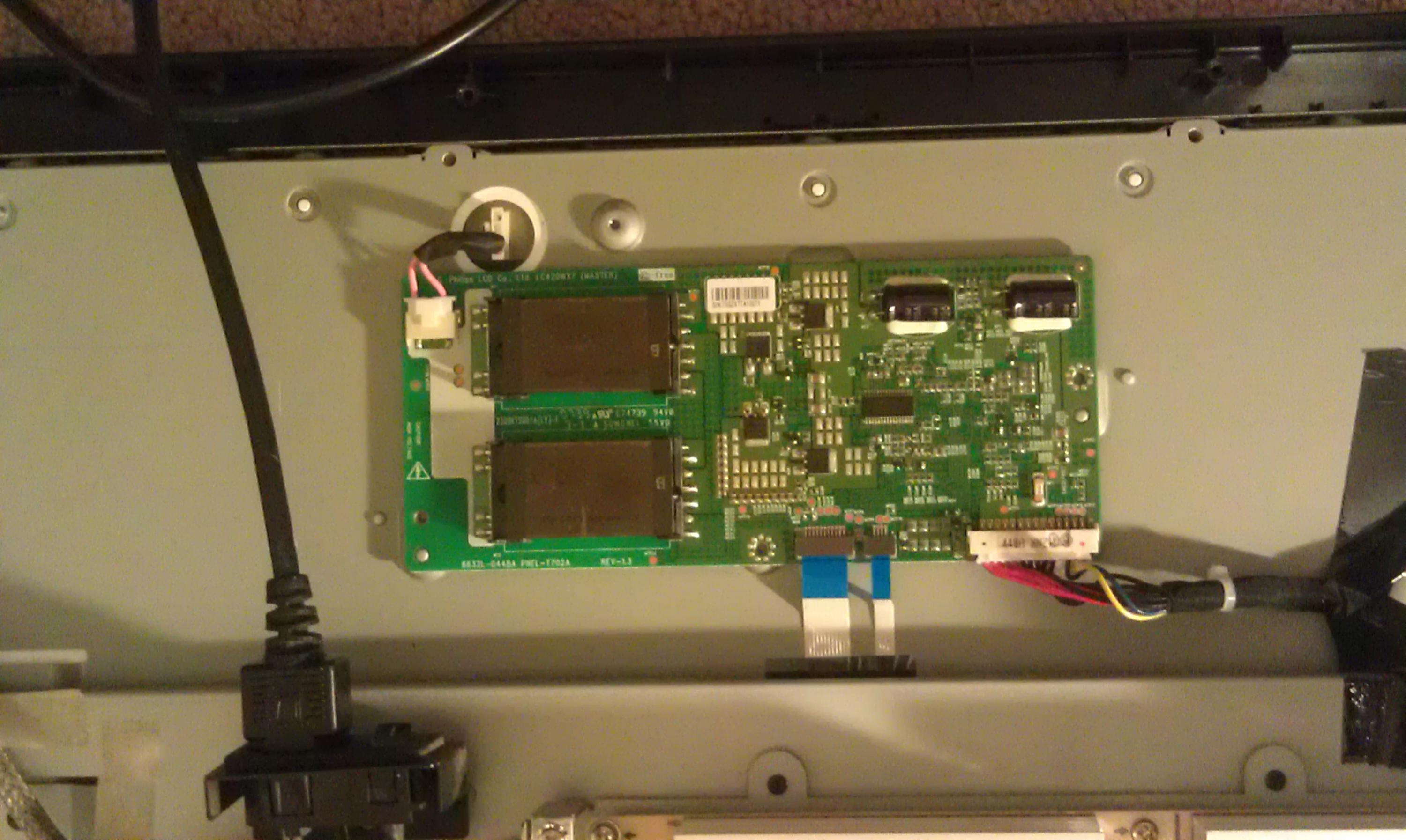

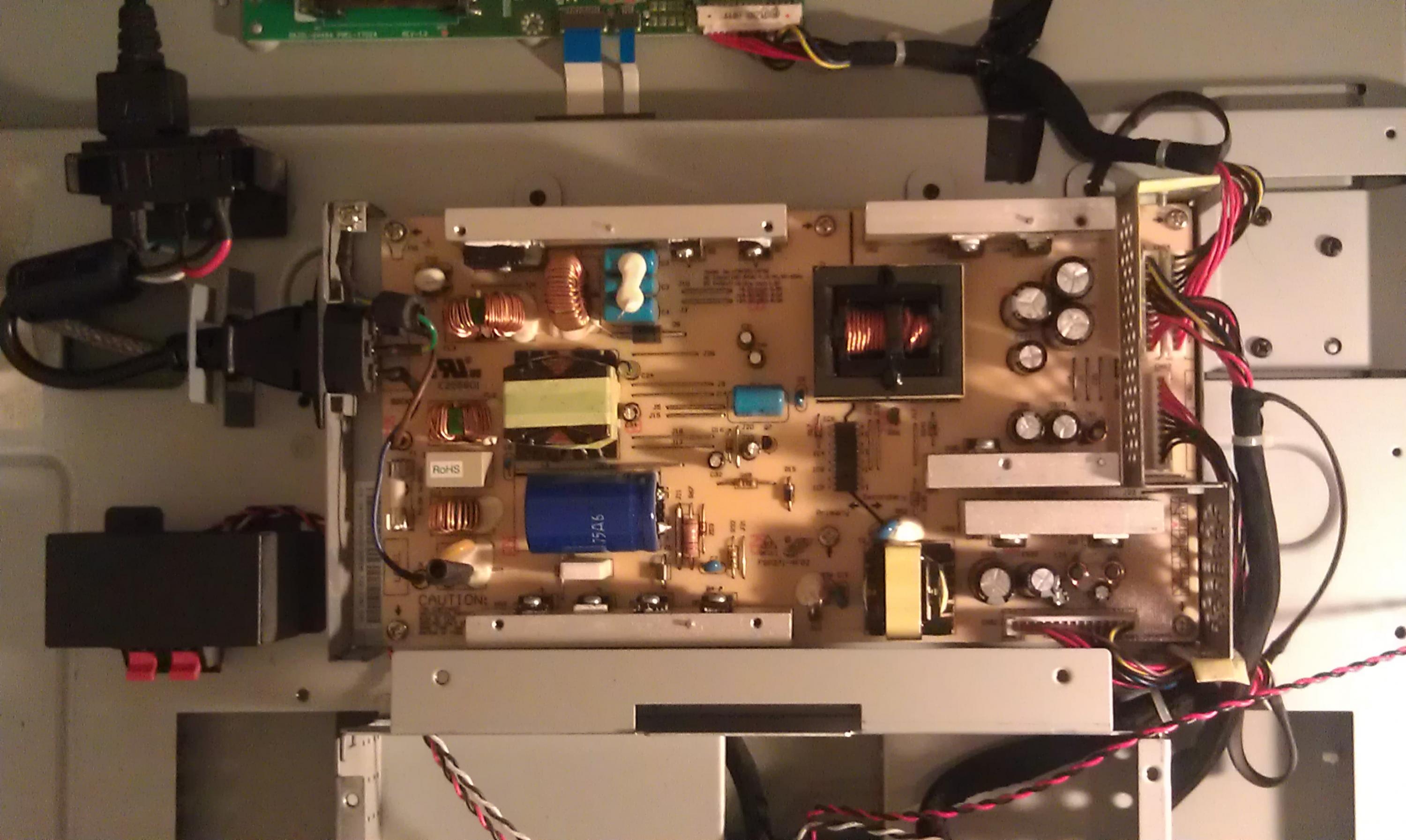

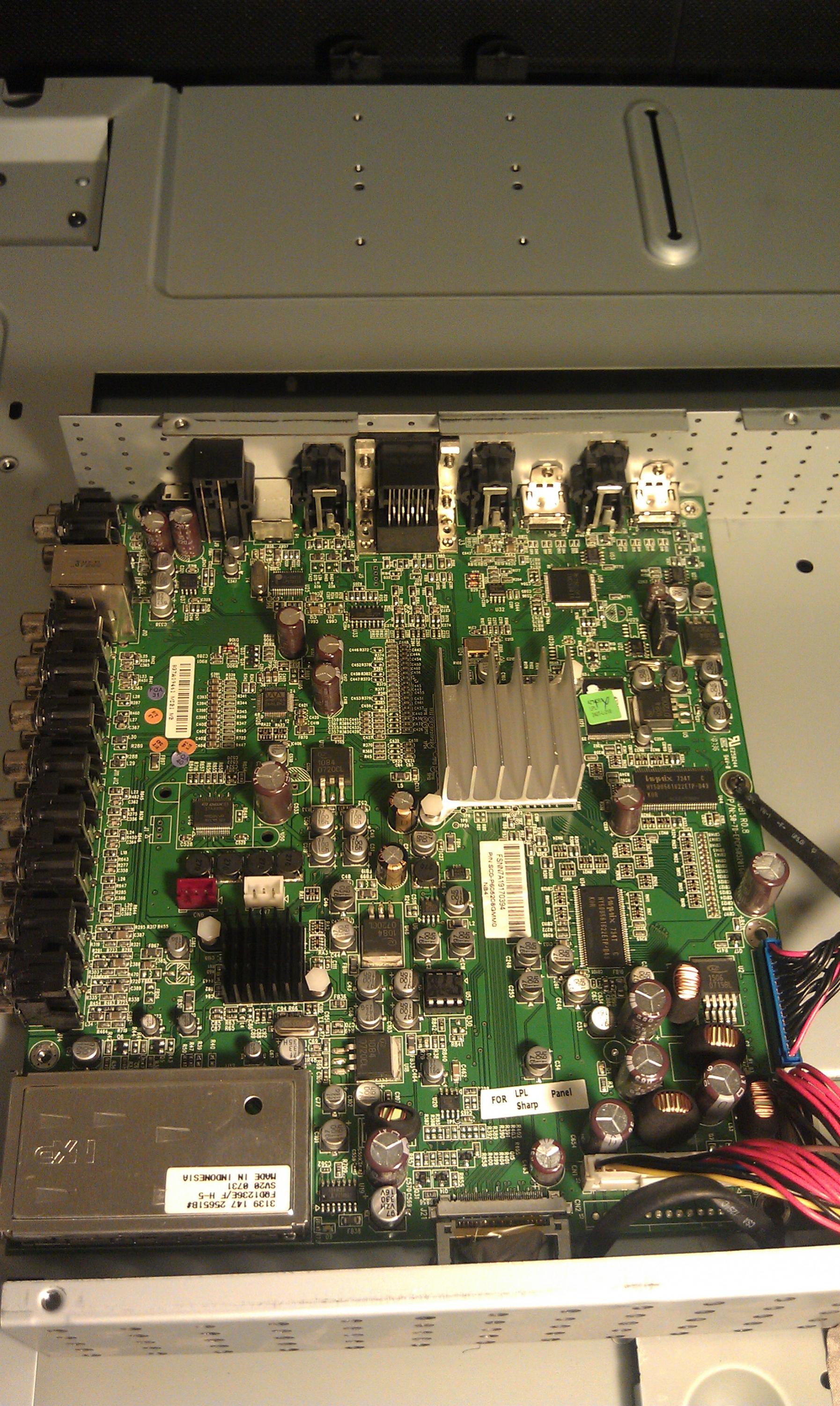

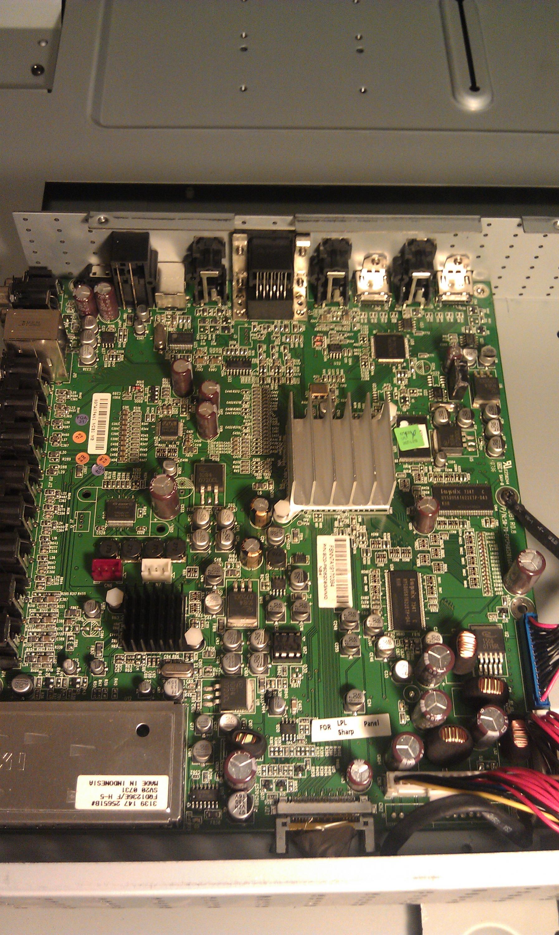

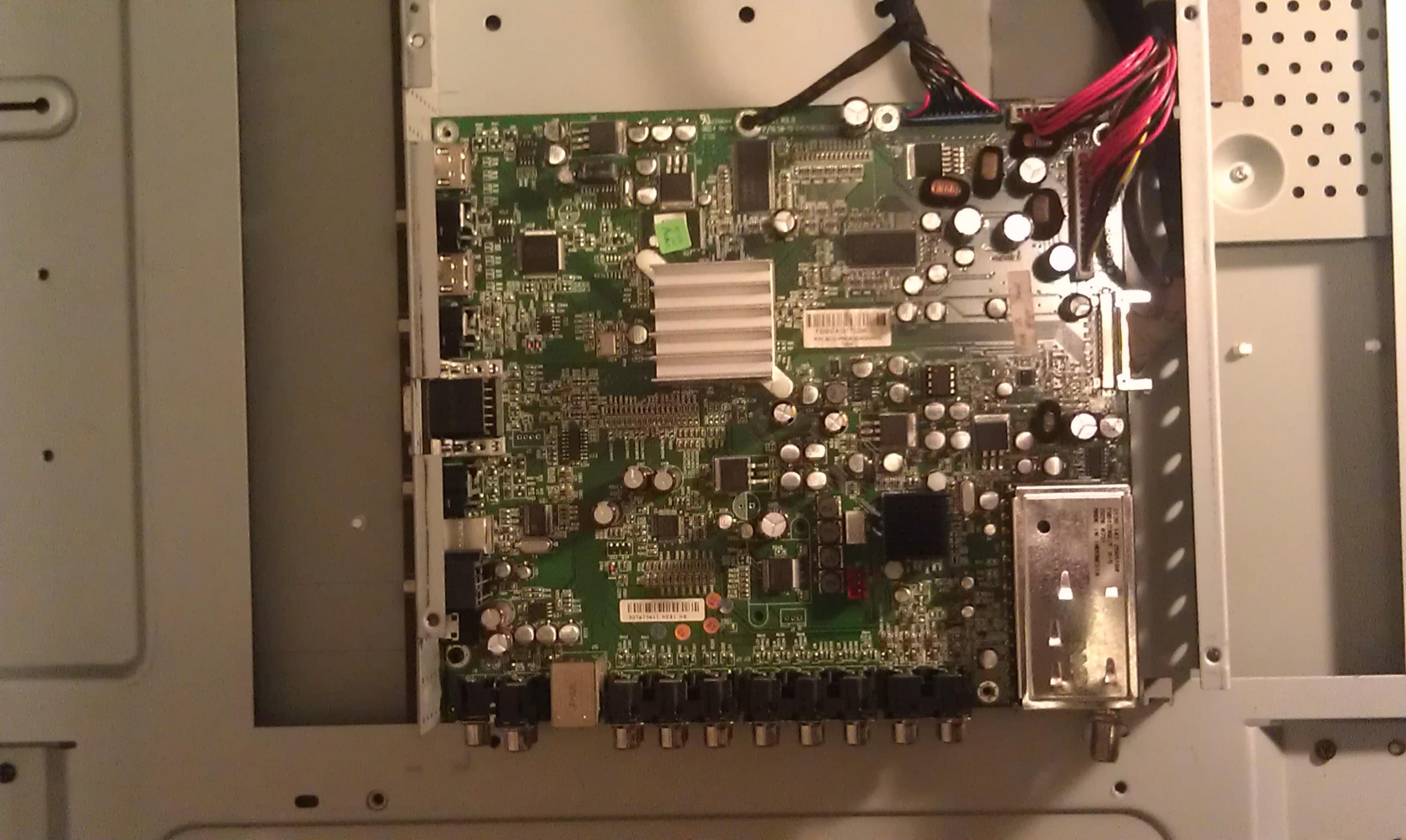

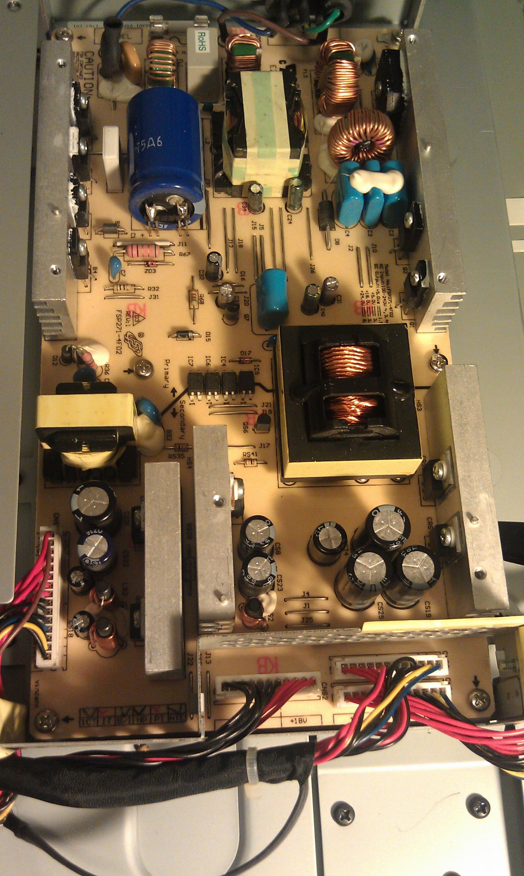

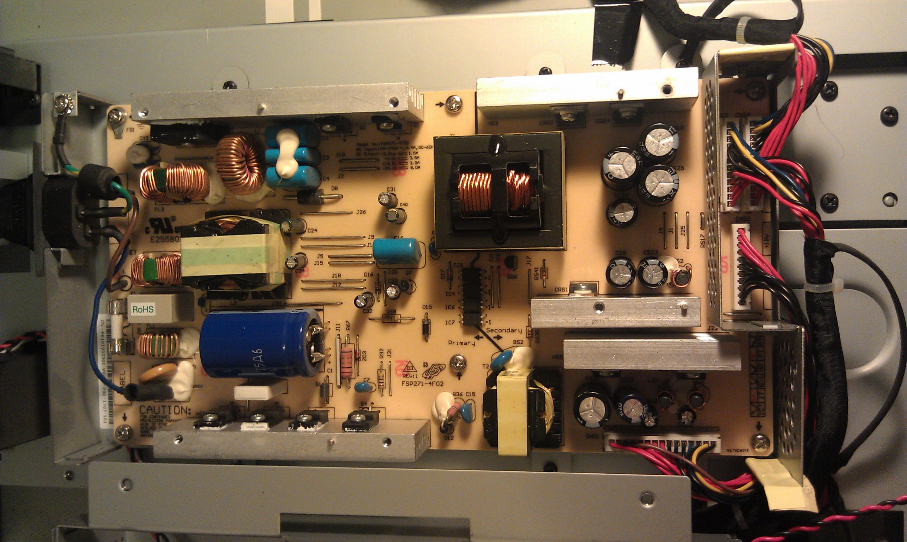

    Pics of the power supply and the main board?
    • Chuda33
      • Nov 2012
      • 24
      Re: Olevia 242-T11 No Picture no Sound No back lights
      Sorry, I am New, but here are some pictures of the main board and the power supply.

        So the psu is fully powered up for you to measure all the voltages? but nothing turns on?
        • Chuda33
          • Nov 2012
          • 24
          All the voltages, except the voltage at the brown, yellow and blue wires, which correspond to the B On, On/OFF and the BRI outputs of the power supply

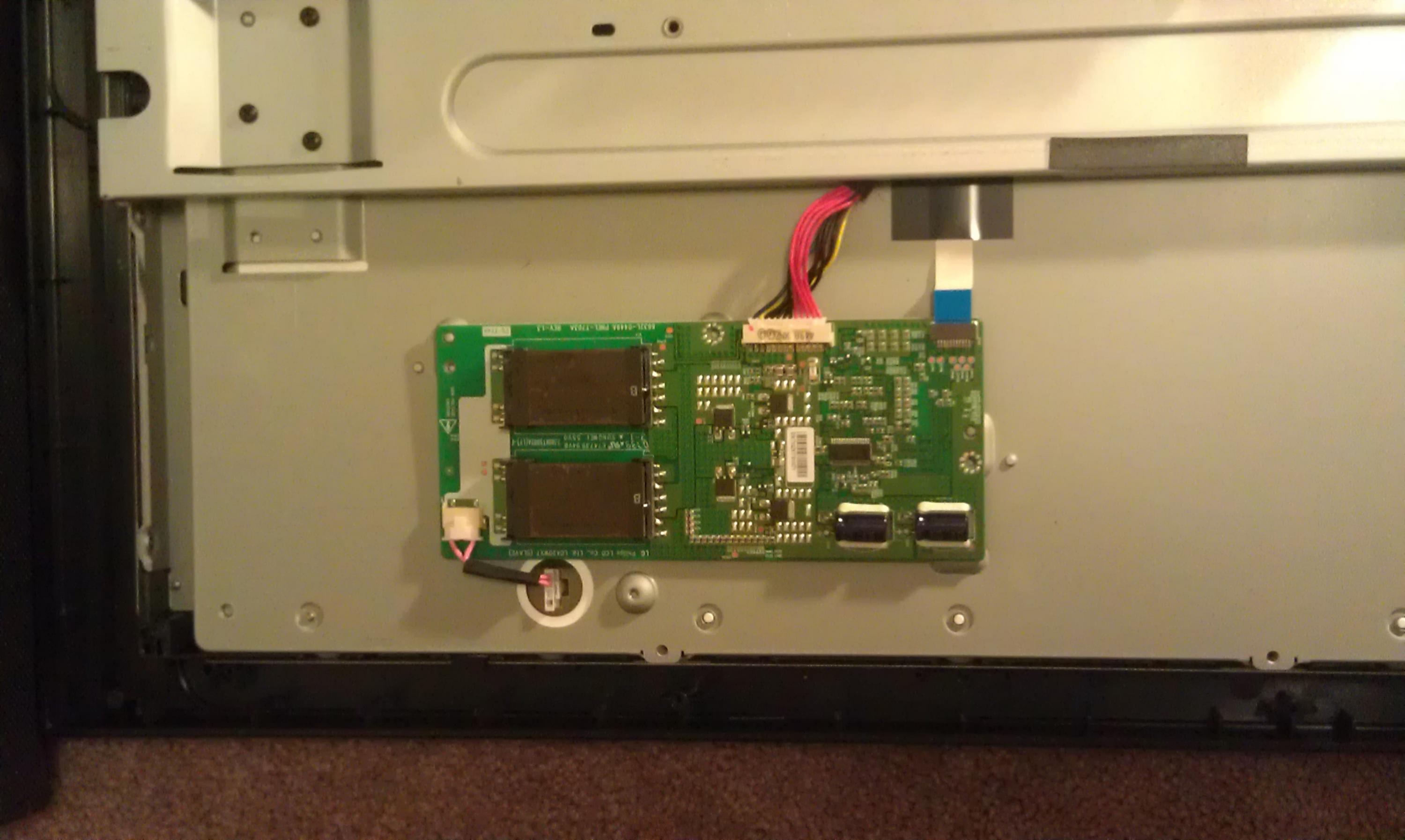

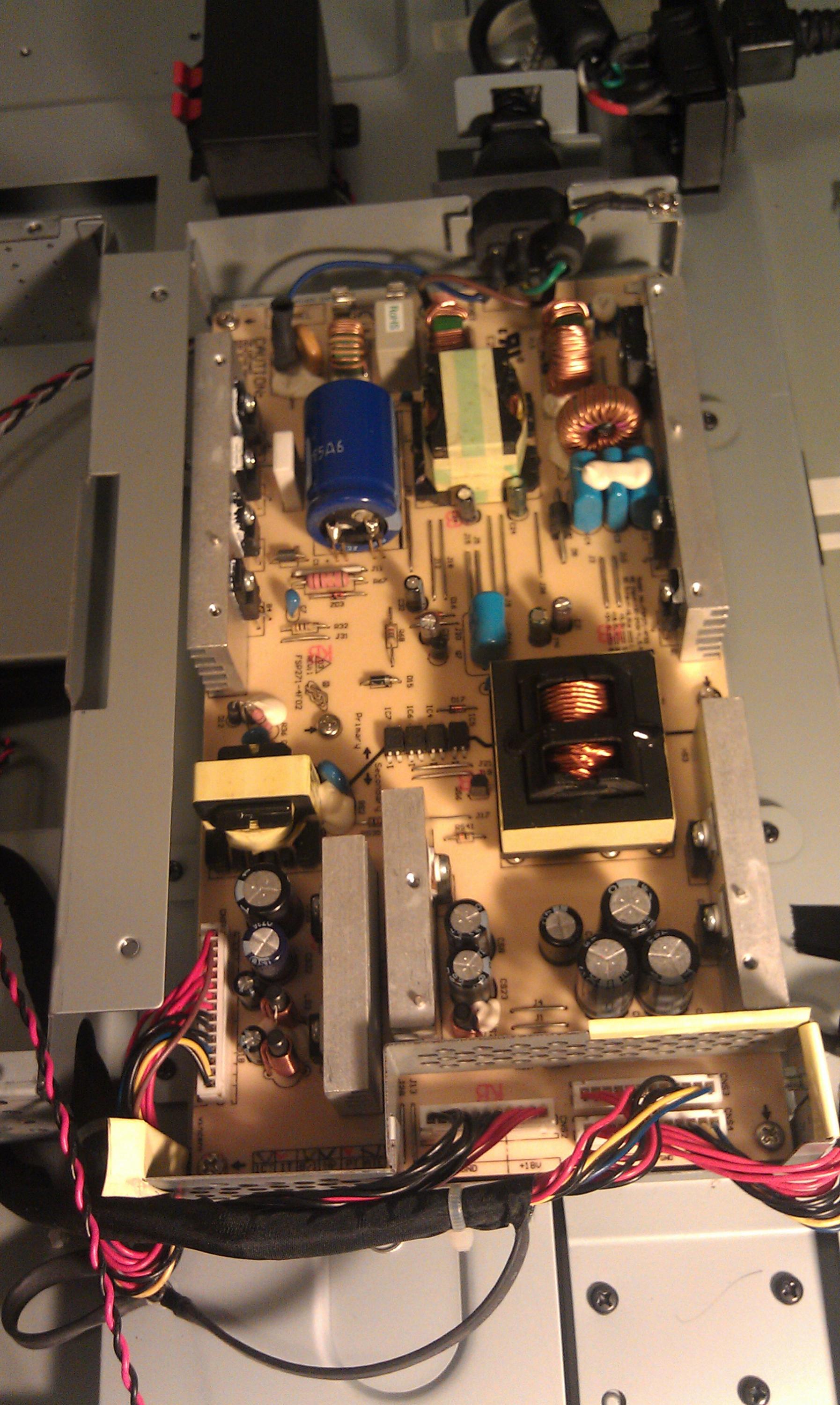

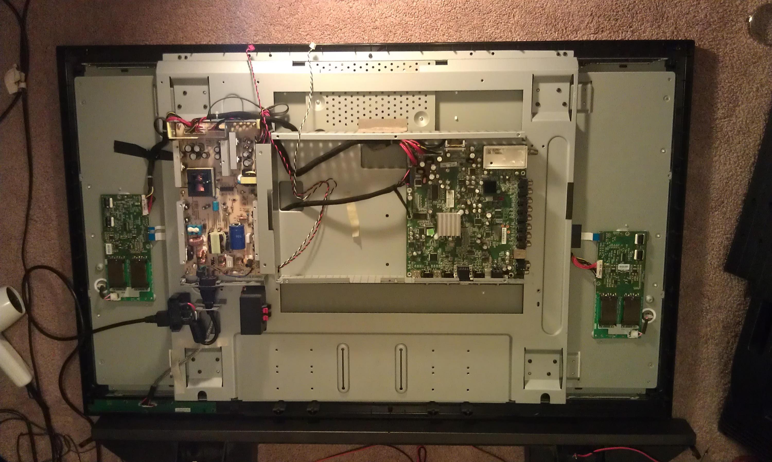

            can I see a full pic of the back of the tv and all the boards?
            • Chuda33
              • Nov 2012
              • 24
              Sure here they are.
              The question I want to ask is what is feeding the voltage for to the blue, yellow and brown wires? I read in another thread that the voltage out of the blue wore should be about 5 volts, and that the voltage at the yellow wire should be about 3.3 volts. Is this correct? And what about the voltage at the brown wire. I also want to mention that once the TV is turned on, it cannot be turned OFF unless it gets unplugged.

                to me it sounds like a main board problem, But wait for one of the more experience guys check out the thread. while you wait, Did you check all connections?
