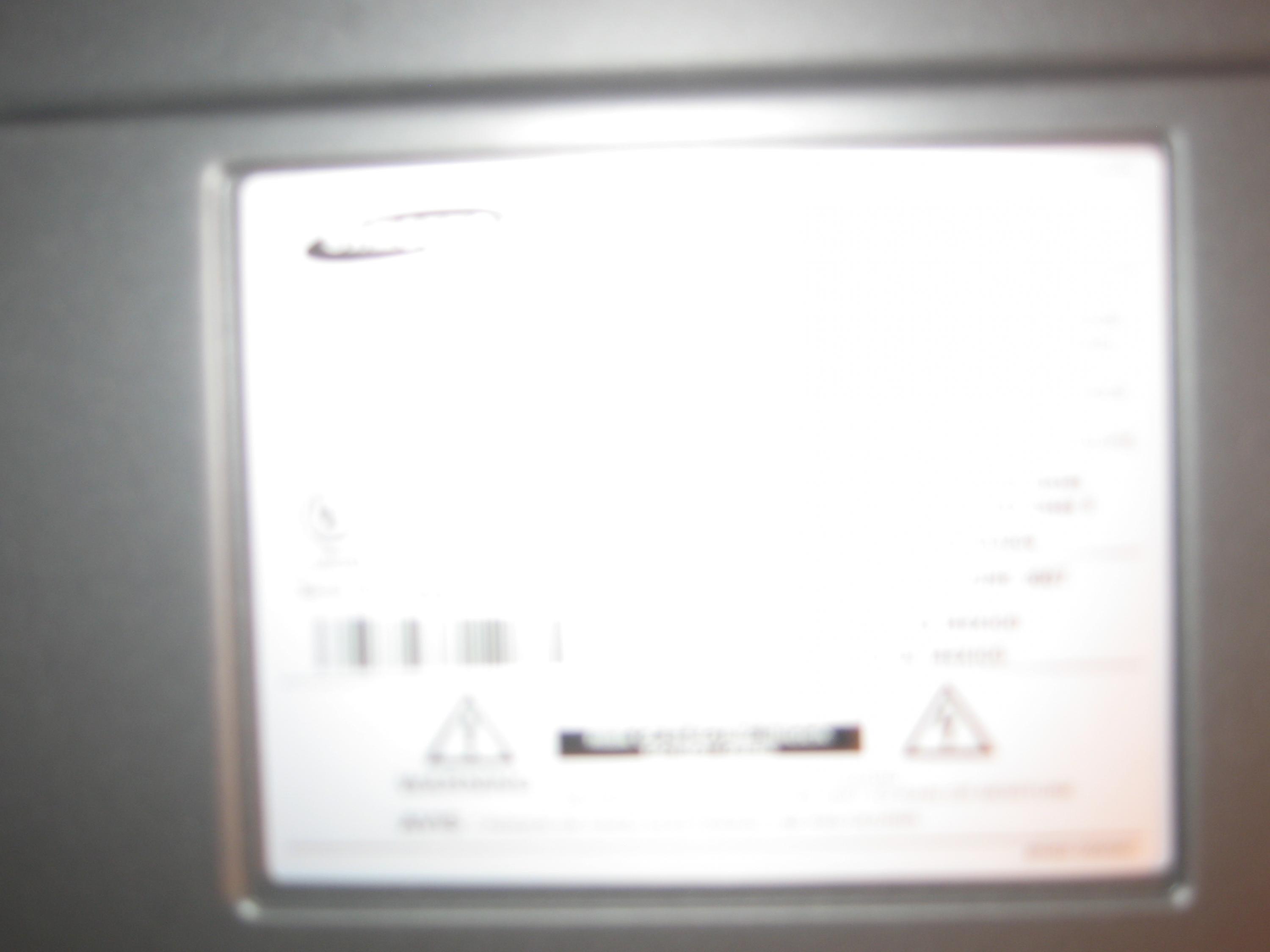

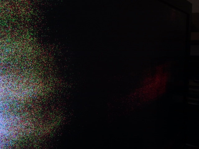

    Hi Everyone.
    Need you opinion with my Samsung Plasma 42" problem.
    I have a very white mark on the Left Side of my tv (X-Board Sustain Board Side) and once I get Video there are a lot red dots running on top,bottom and Right Side on my and the white mark still remain)
    The Second Pic is when I turn off the tv.

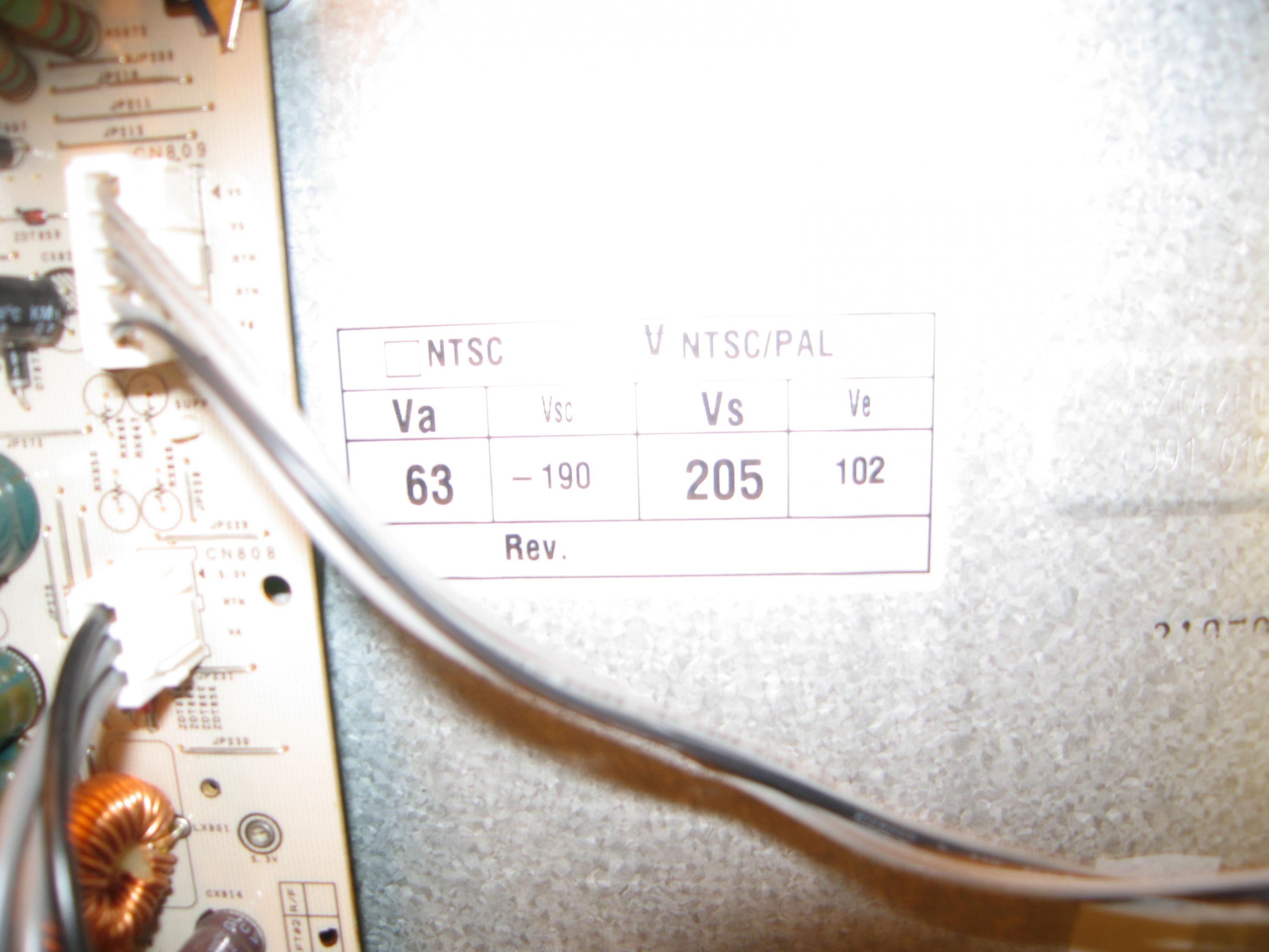

    Re: Samsung HP-T4254 Problem
    When the TV is off, you still see the screen lit up??
    Likely, your problem is with the Vset or Vrst voltage, can you post a picture of the panel sticker (white sticker, "NTSC/PAL SAMSUNG SDI" on plasma panel.)
    • crdz66
      • Nov 2012
      • 242
      Just for 2 Secs. if bottom buffer is connected.

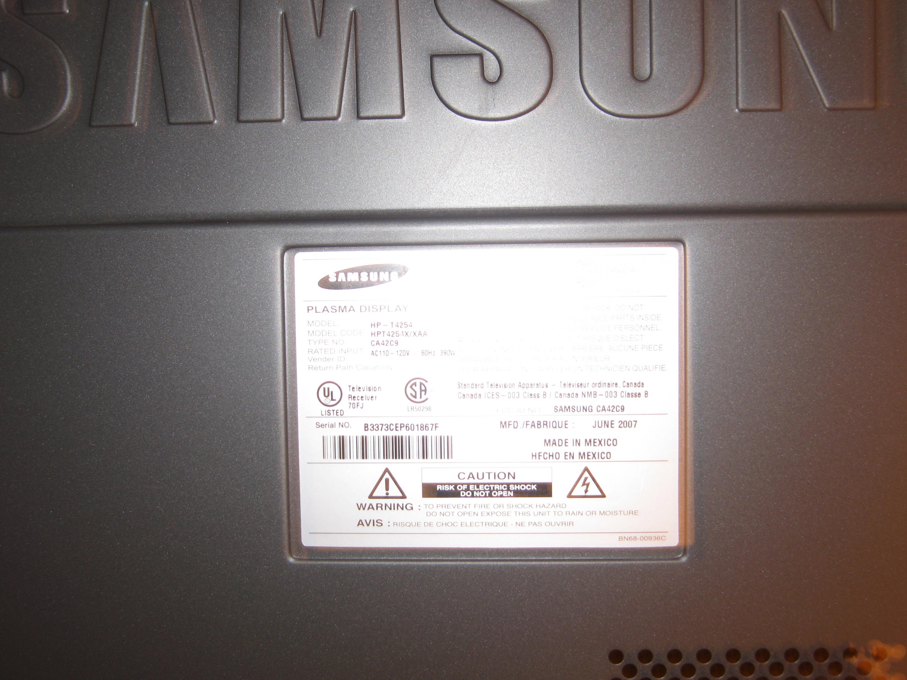

        pics
          OK, that may be normal shut down procedure but there is noise on picture.
          Panel sticker is on inside of TV.
            Sometimes x-board buffer make noise.
            pics attached

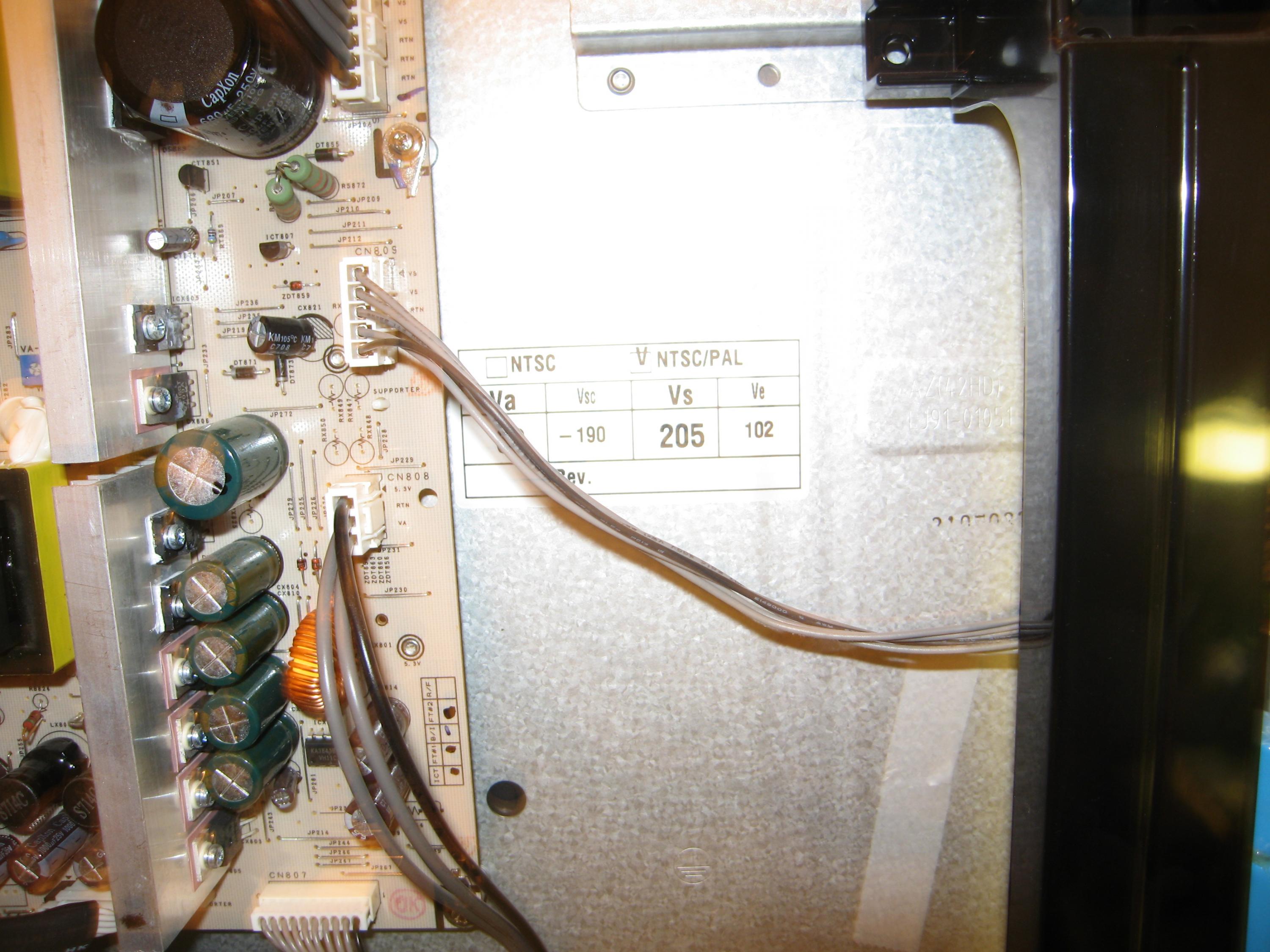

              Along the power connector going to the Y-main, do you see pins marked Vs and Va? Check the voltages on them.
              It is normal for the sustain boards to make noise due to the very high currents flowing.
              • crdz66
                • Nov 2012
                • 242
                205 volts going to y-board and x-board.
                  What does Va measure?
                  • crdz66
                    • Nov 2012
                    • 242
                    63.4volts
                      So both those are good we need to find Ve and Vsc. Can you post pictures of your Y-main and X-main. It is best to use daylight and not flash as flash creates glare.
