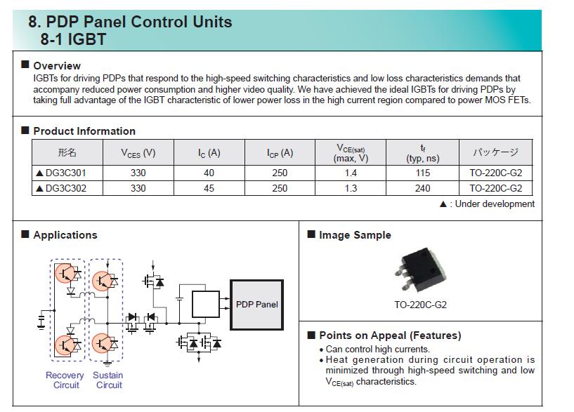

                Re: Can you help me find replacement Panasonic tansistors?
                Some Data for DG3C301 (DG3C3010CL) marking DG301. DG3C302 (DG3C3020CL) marking DG302

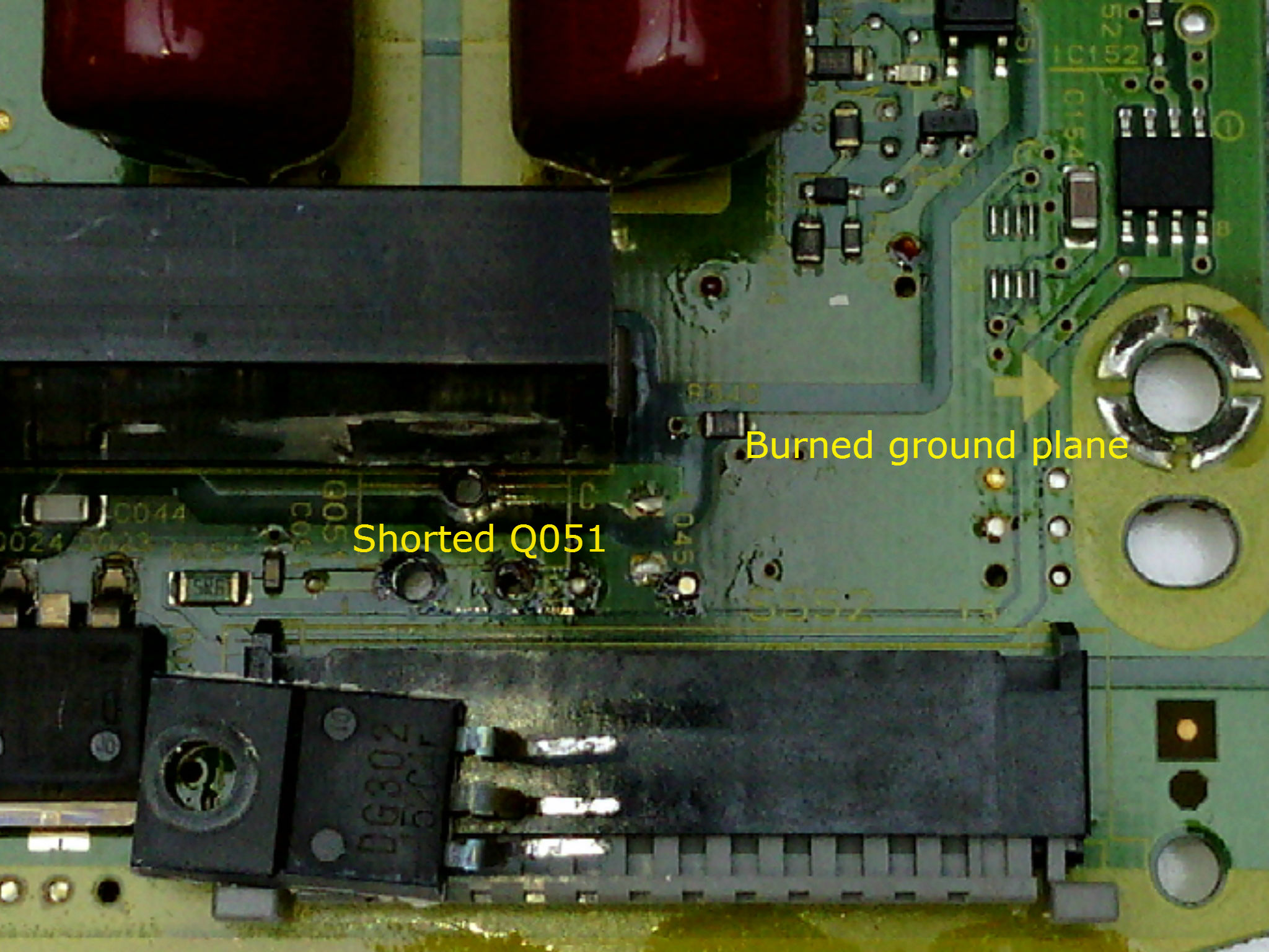

                      • Bilbo44uk
                        • Jun 2014
                        • 11
                        I am in the UK I am also after this Transistor in a 220 standard Transistor package not the SMD one, i have looked all over the place to no avail, it seems this is a comon fault on Panasonic Plasma sets, it is caused in the main by a loose screw on the ground, this floats the ground which seems to take out that Transistor, If anyone can point me to a supply in the UK that would be helpful, Otherwise I too will have to import the spares, Tim Hoad.

                              I got a kit from ShopJimmy that had it and a few other parts. It worked fine. Then with the part # from kit I ordered more spares from China for cheap.
                                    DG302 is a 250A Ip 360V 36W device....
                                    30F131 is 200A Ip 360V 130W part and probably wont last.....
                                    There's also the other factors such as speed to consider....
                                      Originally posted by selldoor
                                      I wondered about a DG502 presumably 50v as against 30v - anyone know if that would work?
                                      I think actually 530V / 330V and both are 45A
                                      I have used a 502 for a 501 no issue.
                                      Can't say for sure whether you'd have an issue but I'd be confident both the current and voltage rating will be enough.
                                      I'd give it a go if that's all i had. someone has to try it if we want to learn something.
                                        One thing which I have no understanding of is
                                        VCE(sat) max (V) on the 502 could be higher.
