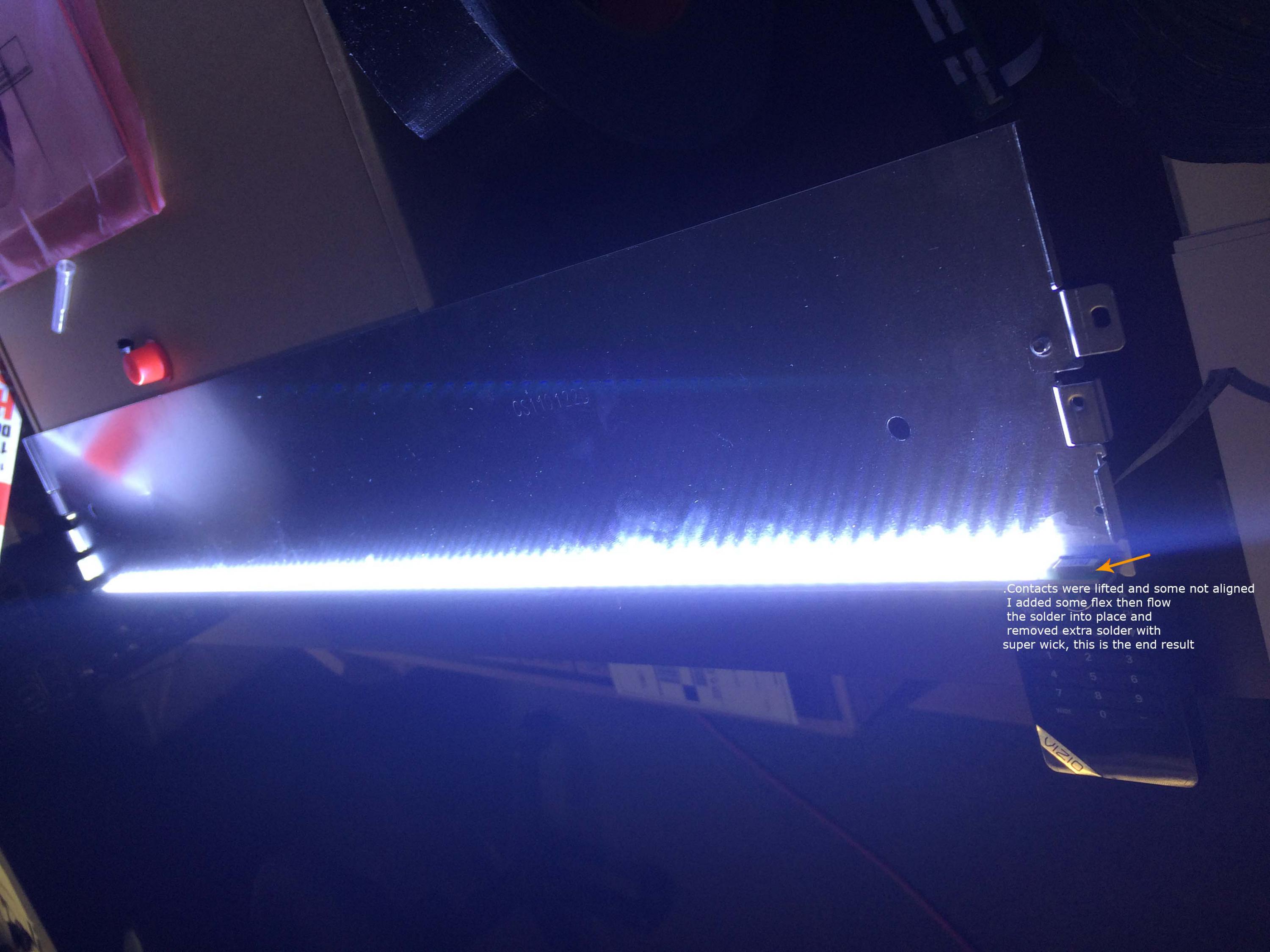

            i have seen many of these units having backlight issues and in my experience a lot of them have been bad soldering on the connector right on the board with the led's on it...in order to repair u need to dismantle entire set down to getting led strip out...with it still taped to metal and resolder the actual connector pins back to the board( sometimes u can see that the connector is actually shifted off to one side) hope this helps

                            Have you got your answers
                            Yes, the post about the bad soldering on the led strips seems to be the culprit. I just check 3 of mine and they all had the bad connection. Wow, I never thought to check that. Thank you for your post popzoo42!

                              Thank you very much! > This fixed my issue I had with a M261VP.
                              When the TV is first plugged into an electrical outlet, then power button is pressed, the Power LED will blink 30 some times then power off.
                              When you press the power again, the Power LED will stay solid and you can hear static sound for few seconds with black screen.
                              "resolder the actual connector pins back to the board( sometimes u can see that the connector is actually shifted off to one side)"
