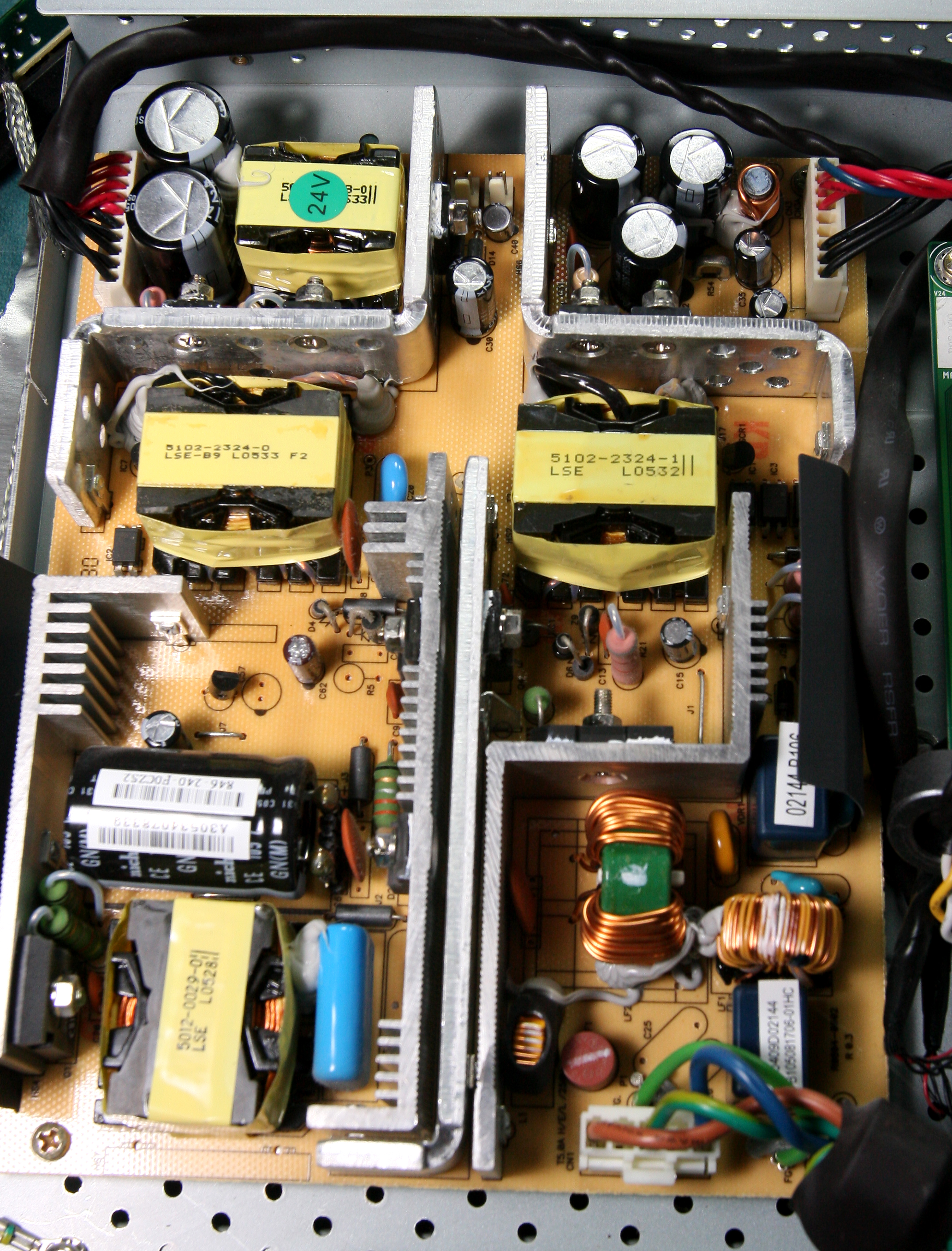

Even though I don't have the time or the space, my wife volunteered me to repair a Proview 3200 LCD TV.
After disassembling it (wow, what a pain) it looks to be fairly good quality.
I was hoping for a few bloated Samxon GFs, but no such luck.
Very few markings on the connectors, though the rear of the inverter board has markings for the connectors.
I have 5v at BL-On 7.6v at VBL. Tracing the connections back, all the VBL red wires go to the 24v out on the power supply. Unplugging the inverter board gives 24v at the power supply connector, and it stays at 24v when powering 2 1157 bulbs in series. So the power supply seems capable.
So, something shorted on the inverter board? Fuses are all good, so it's not drawing much current, and none of the components feel warm to the touch.
Measured 7.6v on one side, 0v on the other of all the obvious bypass caps, so not one of those.
It's a very busy board with lots of small surface mount components. Could be fun finding it...
