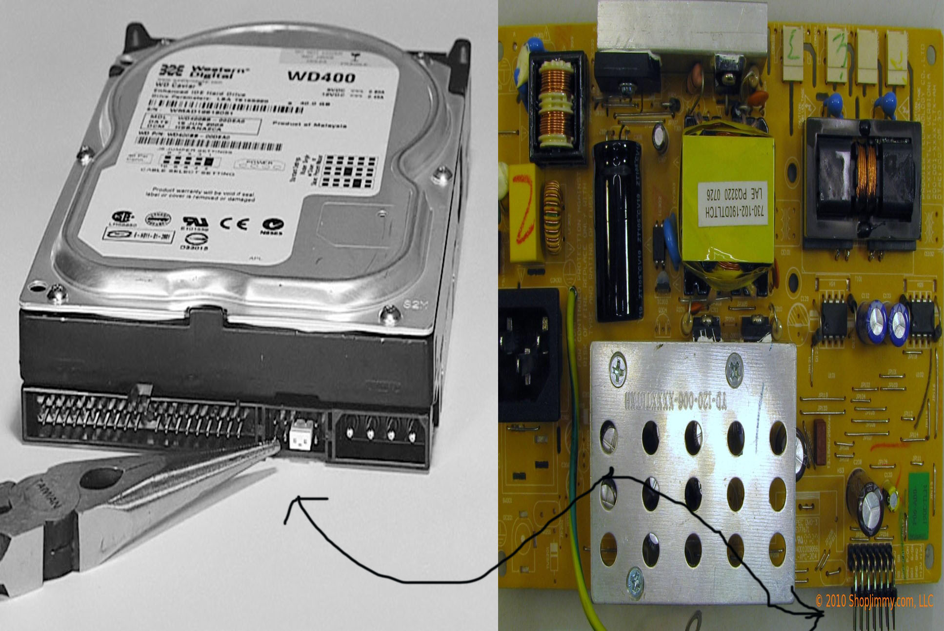

    No I used a jumper from a pc hard drive on the bl-on and p-on pins.And it seem to work fine but I just wonder is it safe ? Here a picture of what I done
      Re: So i thought it was no good
      But that connector is connected to the logic board, how did you do it? Did you lift the pin? The signal is just low current HI/LO for controlling.
        What I should have said was that I used a thin piece of wire to connect both pin and I seen that it worked. So I tried a pc jumper pin instead of wire and it fit but I failed to mention I still would have had to cut that black plastic to get the jumper in there. But I know it would work if the wire worked. But I just might try to solder both pin's together I should get the same result's.
