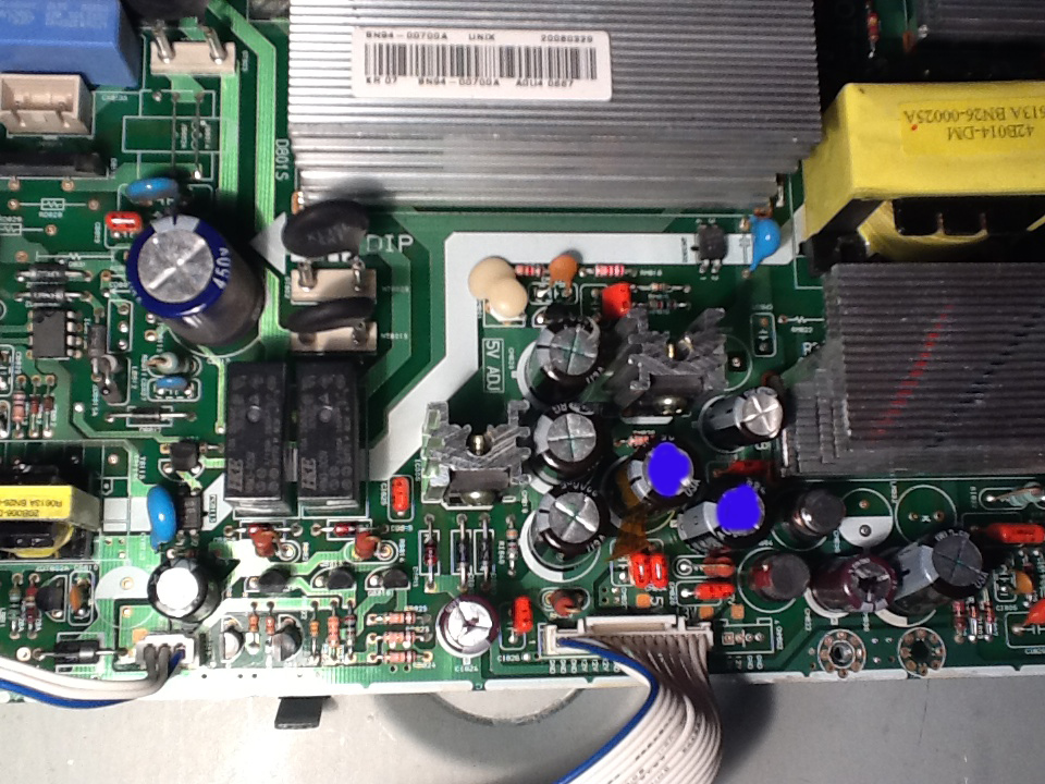

    Hi
    Im new to this forum and it seems like a placering for me.
    Om looking for schema to a powerboard BN94-00700A located on a Samsung LE46M. I have located 2 bad caps and replaced them but it seem to be something more, i dont get all the different voltage in place.
    Tanks in advance
    Gustaf

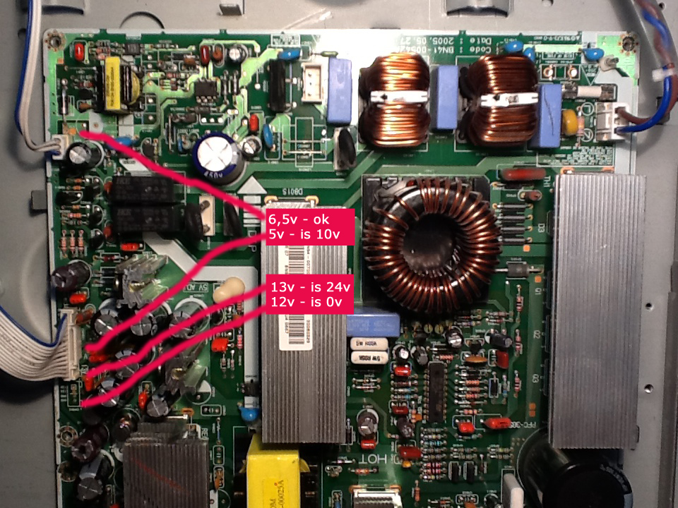

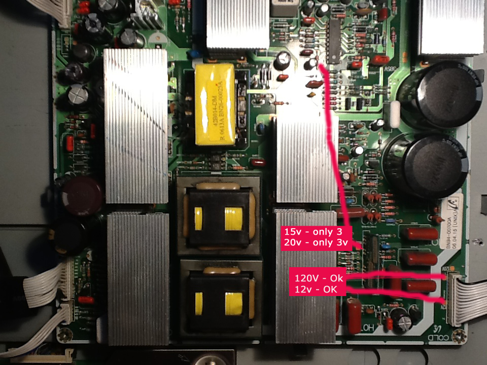

            Re: Schema for BN94-00700A (Samsung LE46M)
            ok, thanks. Here are some pictures. I wrote down the volt written on the board and the ones i got at the moment. The blue marked caps are the one i replaced.
            Any ideas?
              Hmm, I would expect something to be damaged if 13V was actually 24V; are you certain you're probing the right point? Does the TV standby indicator come on, can you turn the TV on and off, do you get a backlight? Budm had one of these with no picture - was a blown fuse on the T-con, nice easy fix.
                Yes its the right point. The tv turns on, the start up melody sounds and the backlight turns on. Where is the t-con located?
                  https://www.badcaps.net/forum/showthread.php?t=20871
                  Fuse marked "CP" on the board.
