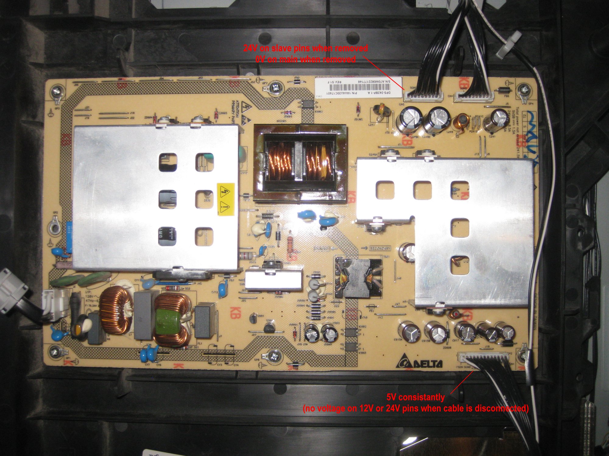

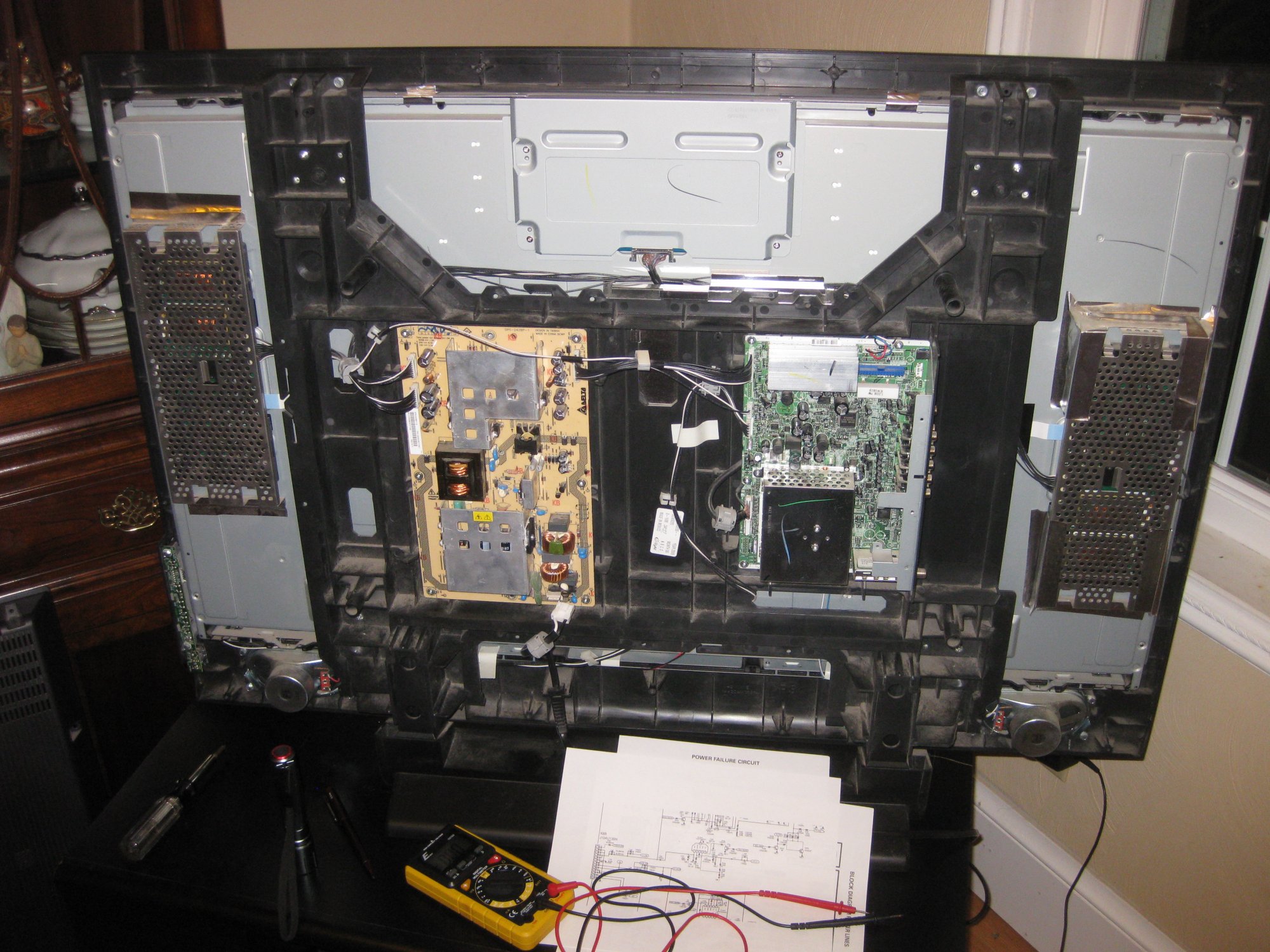

    Yesterday, out of the blue, our 42" Sanyo DP42848 LCD stopped working. No lighting strikes or anything, it just stopped working properly. It's out of warranty.
    When turned on, we see a black screen with the blue "HDMI1" input notification in the corner: the screen appears to be uniformly lit, so it sure looks like the LCD and backlighting are all working properly. A few seconds later, at the point where it would normally start showing video, the backlights turn off and sound comes on. If I shine a light in, it looks like the LCD is showing video, but it has no lighting. Sometimes, it just simply turns itself off, which might have been my troubleshooting triggering some other safety.
    I did a bunch of googling, followed troubleshooting steps posted by others in this forum and in the service manual one of you posted (thanks!!). I'll try to summarize here, but I'm kinda stumped at this point.
    No obvious burnt components on the PSU, mainboard or inverter boards, and no capacitors are bulging or leaking. The HV side of the inverter transformers looks ugly, but it's hard to tell if it's burnt or just resin.
    Power Supply: with cables unplugged, I measured 24V to one of the inverter boards and 5V to ground on CN2. I'm unable to measure 24V to the other inverter board or 12 or 24V on CN2, but I suspect it's because power is intentionally turned off when they're unplugged. I was able to measure 12V and 24V to ground on mainboard on solder points near K8B, so I'm pretty sure at this point the power supply is OK.

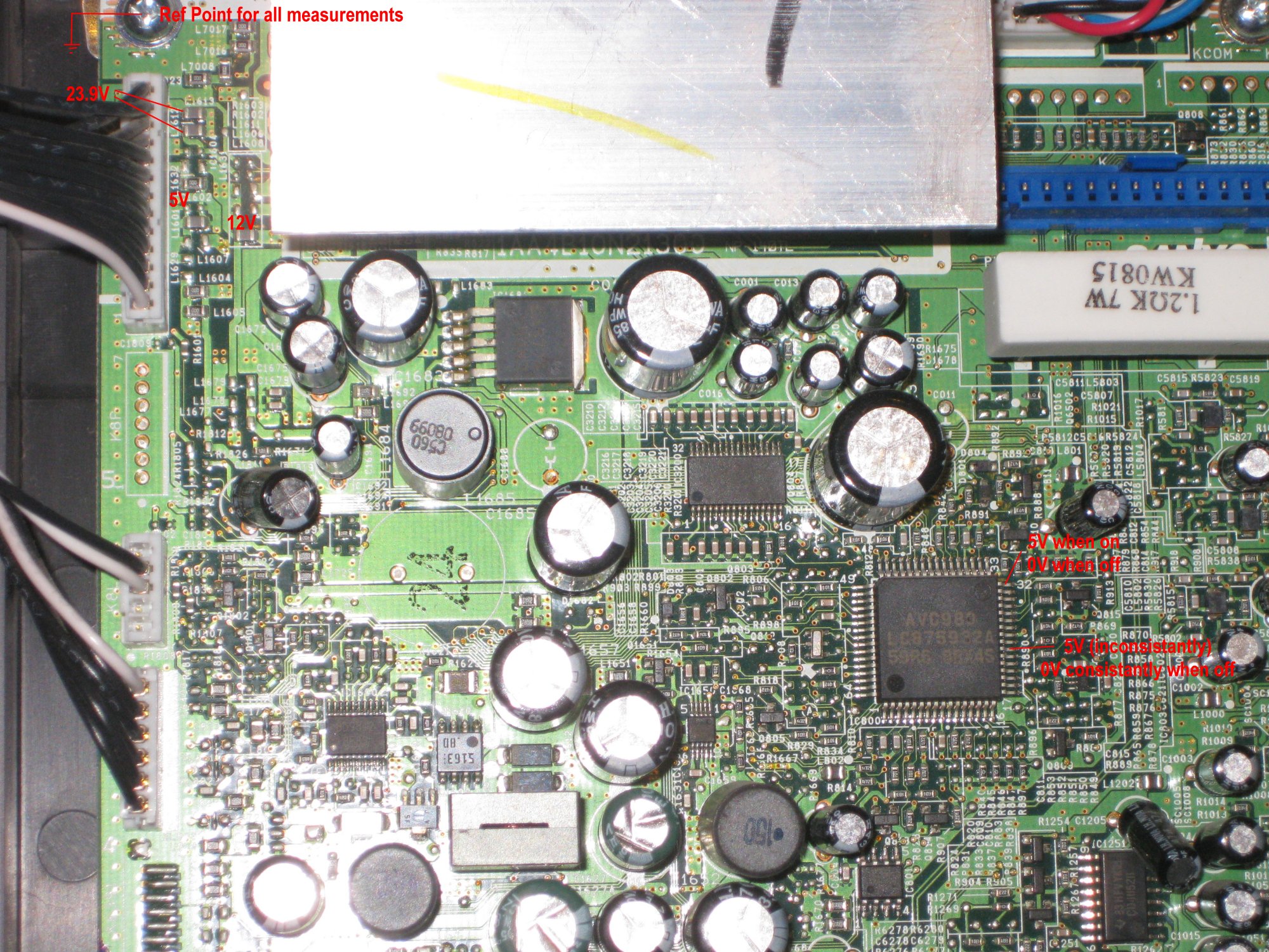

    Main board: While the TV is running (sound, etc.) I'm getting 5V on IC800 pin 32 consistantly. I've had difficulty measuring it on pin 23, at some times measuring 0V, 3.5V, and 5V, but finally was consistently measuring 5V when sound was on. Might have been my error reading a wrong pin, or might have been while the TV was in standby or some sort of limp mode.

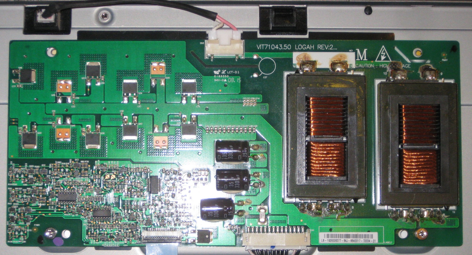

    Inverter boards: only thing I've found so far is that the HV side of the transformer nearest the edge of the board has no continuity between terminals on either board. The inboard transformer on both sides does have continuity. I measured 0.2Ohms on the LV side of each transformer between 3-4, & 4-5, but open circuits between 2-3 and 6-7. All were consistently like this. Is this my the problem or is it a red herring? I've not yet tested voltages on the inverter boards with the TV turned on due to all the shielding in the way.
    What's my next step?

    Update: just reinstalled the 2nd inverter board without the cage to try to measure the output to the backlighting. And the damned TV just started working again! Crossing my fingers and hoping it was just a loose connector and the troubleshooting process corrected it. Also hoping I didn't fry my meter, as there was quite a bit of sparking and wierd things on the display...
    Odd, though, that the symptoms persisted through playing with the PSU, mainboard and 1st inverter. And started working when I reinstalled the 2nd inverter, all the connections of which were firm and I didn't mess with the pins at all like I did the one cable on the PSU. I'll keep an eye on it and see if it continues working & post back with an update.

                What is BL_ON? I'm getting 5V on IC800 pin18, and 5V on connector K8B pin 1, both of which indicate the inverters should be on.
                  Re: Sanyo DP42848 42" LCD TV: sound, but no picture
                  BL_ON is the backlights on signal generated by the main board to turn on the backlights. I do not know what IC800 is or where it is at.
                  For the backlights to be on, the inverter board needs 24VDC for power and the BL_ON signal (>3VDC) to turn on the PWM IC which drives the Gates of the MOSFETs which will drive the inverter transformers which will produce high voltage to drive the CCFL's.

                    Ah, that should have been obvious. IC800 is on the mainboard and was the first troubleshooting step in the service manual, btw.
                    I'm getting 24VDC on several pins on the invetrer boards, and 2.2-3.2VDC on several other pins, and 0V on the rest. Unfortunately, I have no way of knowing which pin is BL_ON.

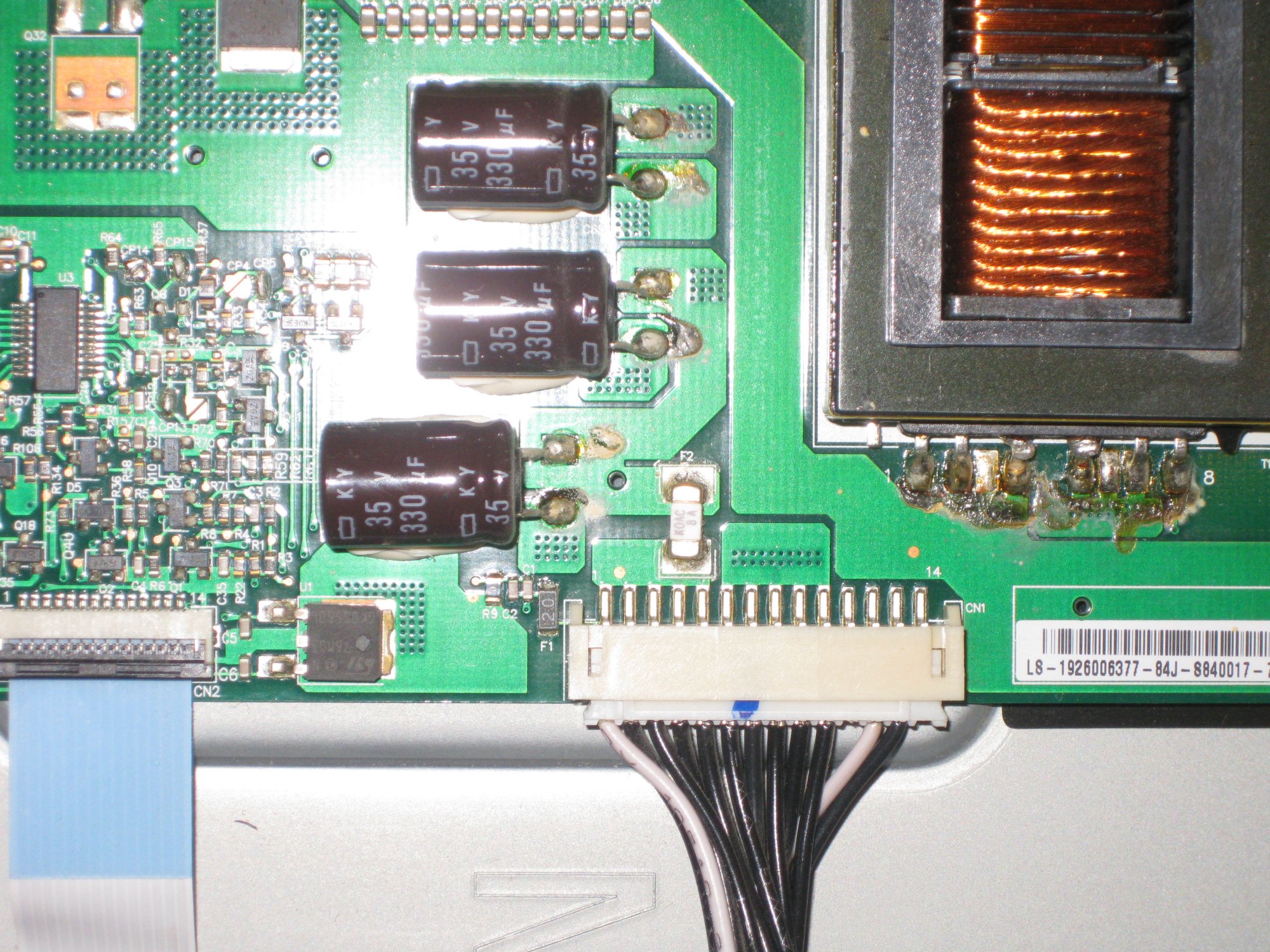

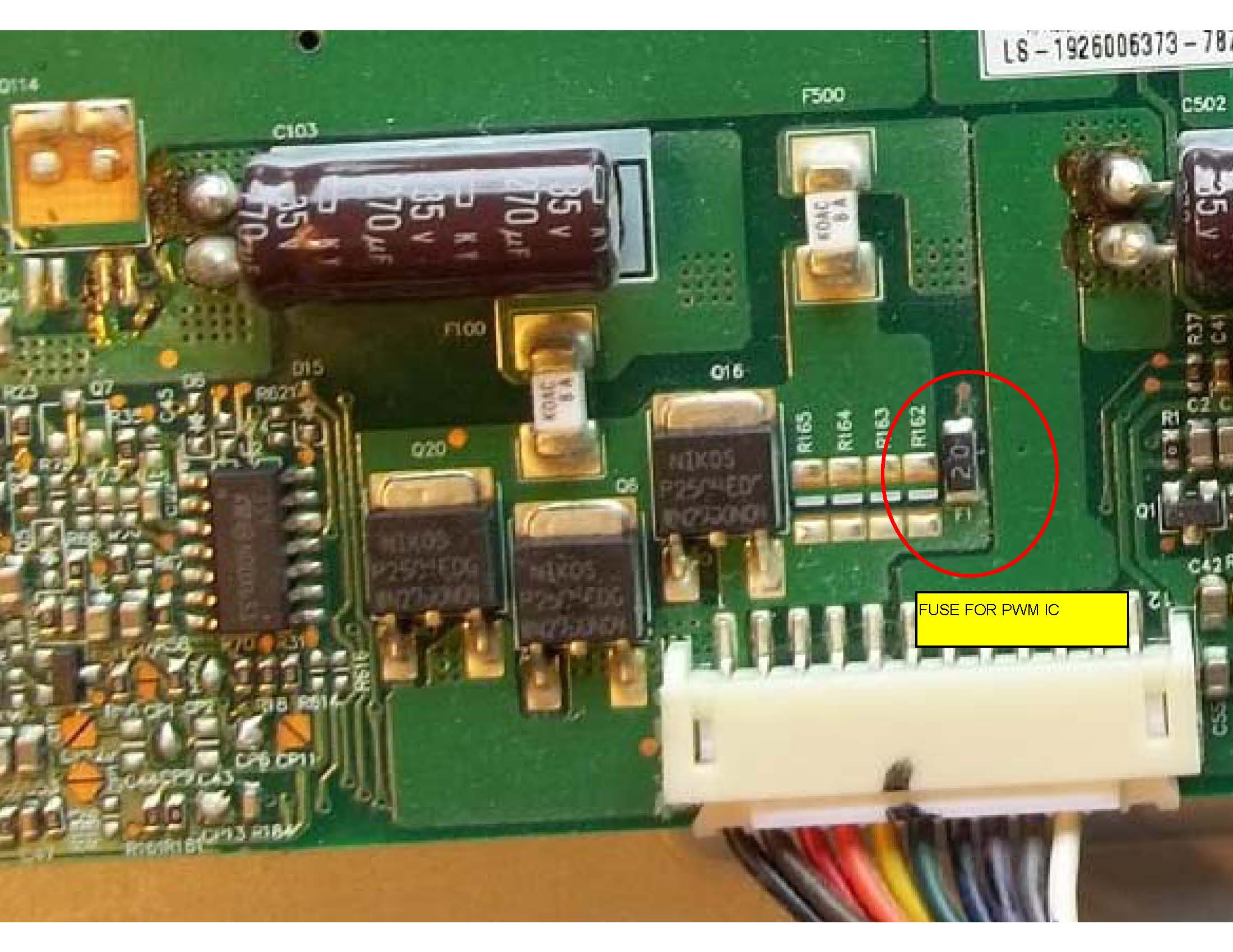

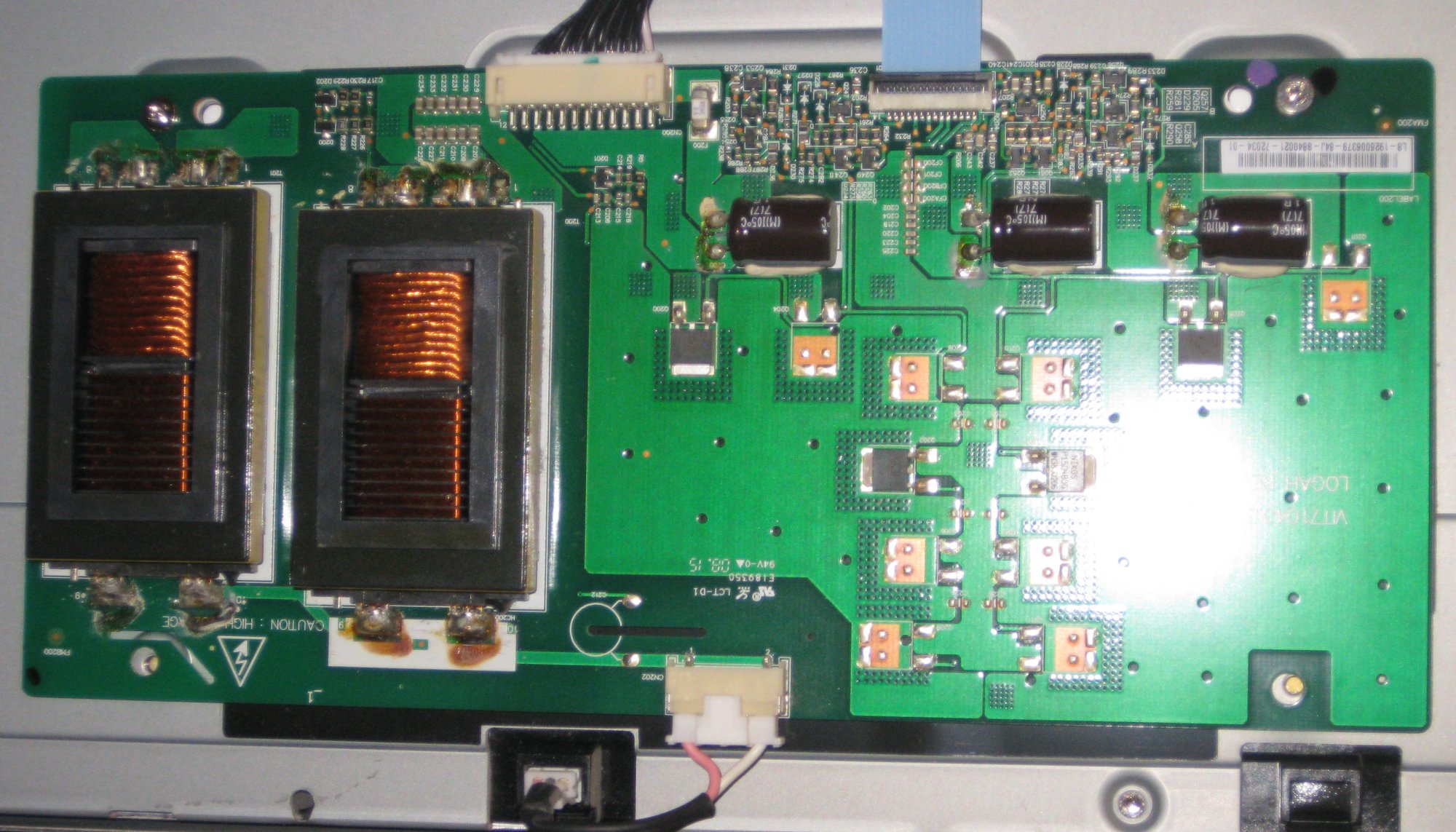

                      Can I see good clear pictures of the master and the slave inverter board around the connector?
                      Check that black surface mounted fuse close to the connector that looks like a SMD resistor to see if it shows open. Check all fuses of both boards.
                        The fuses near the connector on both inverter boards look good. I was able to identify and test two likely pins: BL_SW=3.3V and BL_ADJ=3.3V.

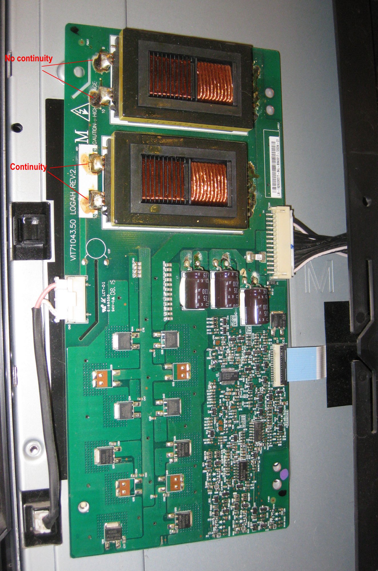

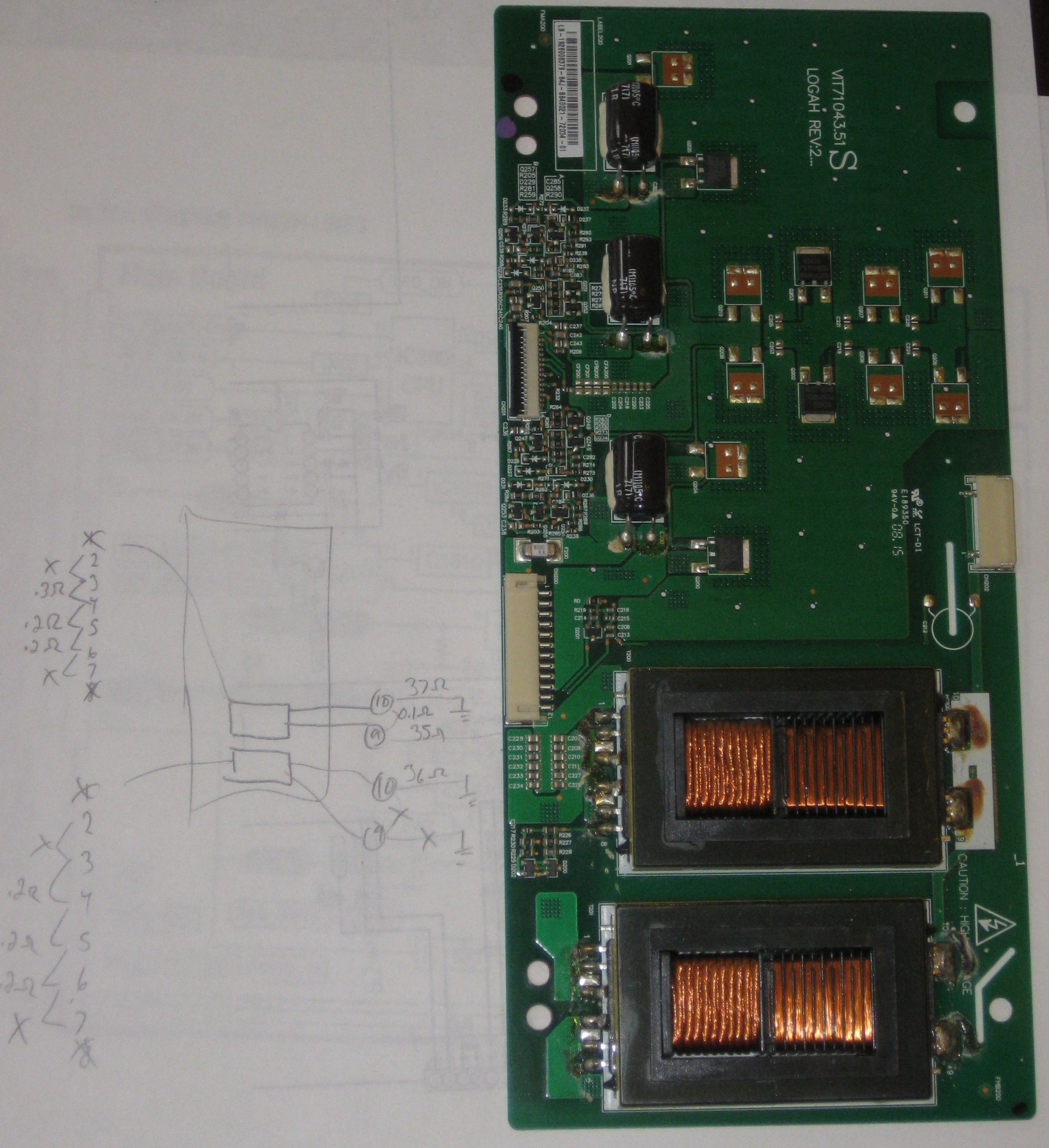

                                  You should be getting a reading on the secondary side and not open circuit. If you have a manual range multimeter, you might have to set it to 20K ohms as some secondaries will reading > 2K ohms.
                                      Thanks, retiredcaps! That 2-seconds to black page is great, too. Didn't think to check the FAQs on the computer display forum.
                                      I double-checked the transformer secondaries. Found the same thing on both inverter boards: the transformer closest to the center of the board is reading 0.2 Ohms across the secondary, and the other transformer reads open on both 200Ohm and 2kOhm scales. I filed down into good solder to ensure resin wasn't fouling the measurements; the solder joints appear good.
                                      All 4 inverter transformers have identical part#s, written in two rows:
                                      T51.0165.211 e5
                                      0815 709 S
                                      Ring a bell for manufacturer/source? No obvious manufacturerer information on it.
                                        As I mentioned in post #17, use the 20K (twenty thousand) scale and retest. 2K (two thousand) may be too low.
