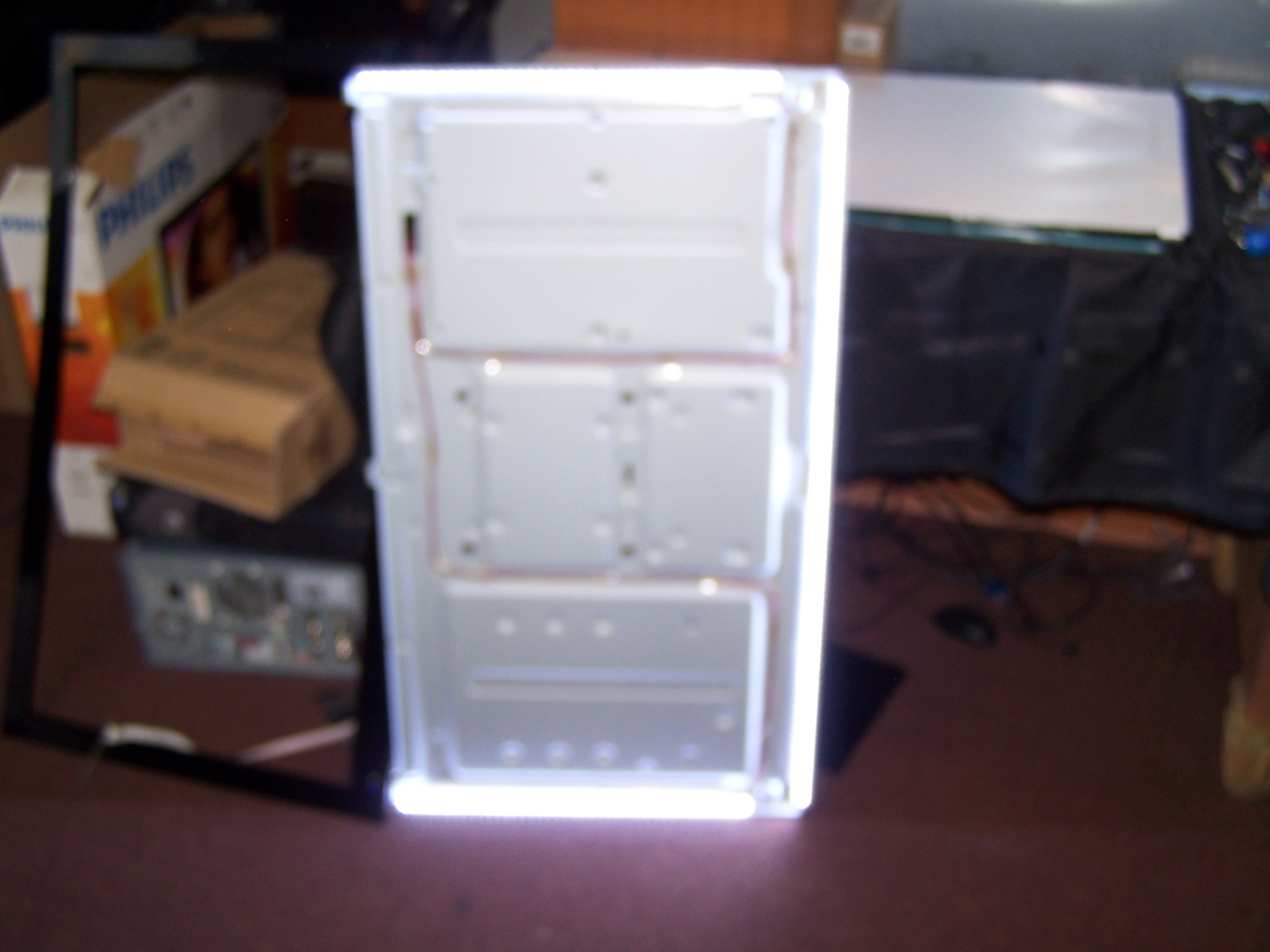

    You have 4 connectors for the 4 LED strings, so right now one of the connector show low resistance to the chassis compared to the other 3? I will wait to see the pictures, most TV with LED will have the LED assemblies on the bottom edge of the screen for the edge-lit TV.
    By the way, I see you are working on two TV's.
    actually working on three tv's it has one sting on each side and 2 strings on bottom...none on top.....each string has its own connector. I will see what i can do for pictures, thanks for helping me out.

      okay after i took the panel apart the short to chassis seems to disappear and it will power all led again i am certain each string is independent of each other, there are 4 total , one on each side and 2 on bottom, i think its grounding out thru either the coating on wire somewhere, what can i use to wrap them wires and not take too much space since it is very tight tolerances. Thanks in advance...
        #43
        Re: Seiki se421tt
        They are separate strings. Yes the wires for the assembly are very fine and it may got cought on a sharp corner somewhere and the insulation got damaged. The problem may come back if you cannot locate the short that went away. At least we are getting some where.

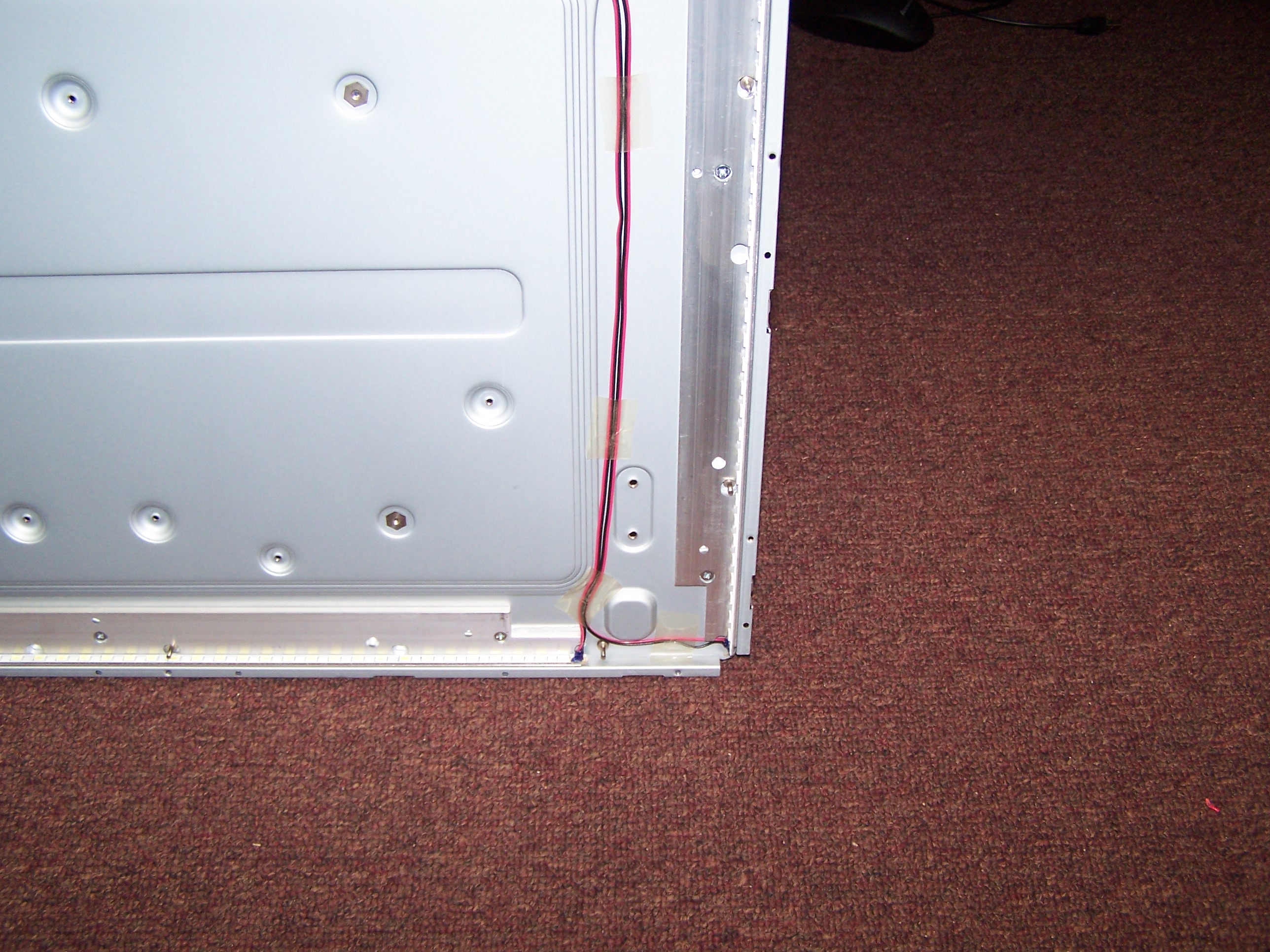

          can't see any sharp corners, the wire pass threw has a rubber boot, so only thing i can think of is to use packing tape under the wires where it makes contact with the sheet metal since there is zero insulation under those wires. what is your thought? i can't see any other area thus far....BTW thanks for working with me
            #45
            Re: Seiki se421tt
            May be put the meter in the beeper mode and move the wire or flex the screen a little to see if you can make the meter beep.

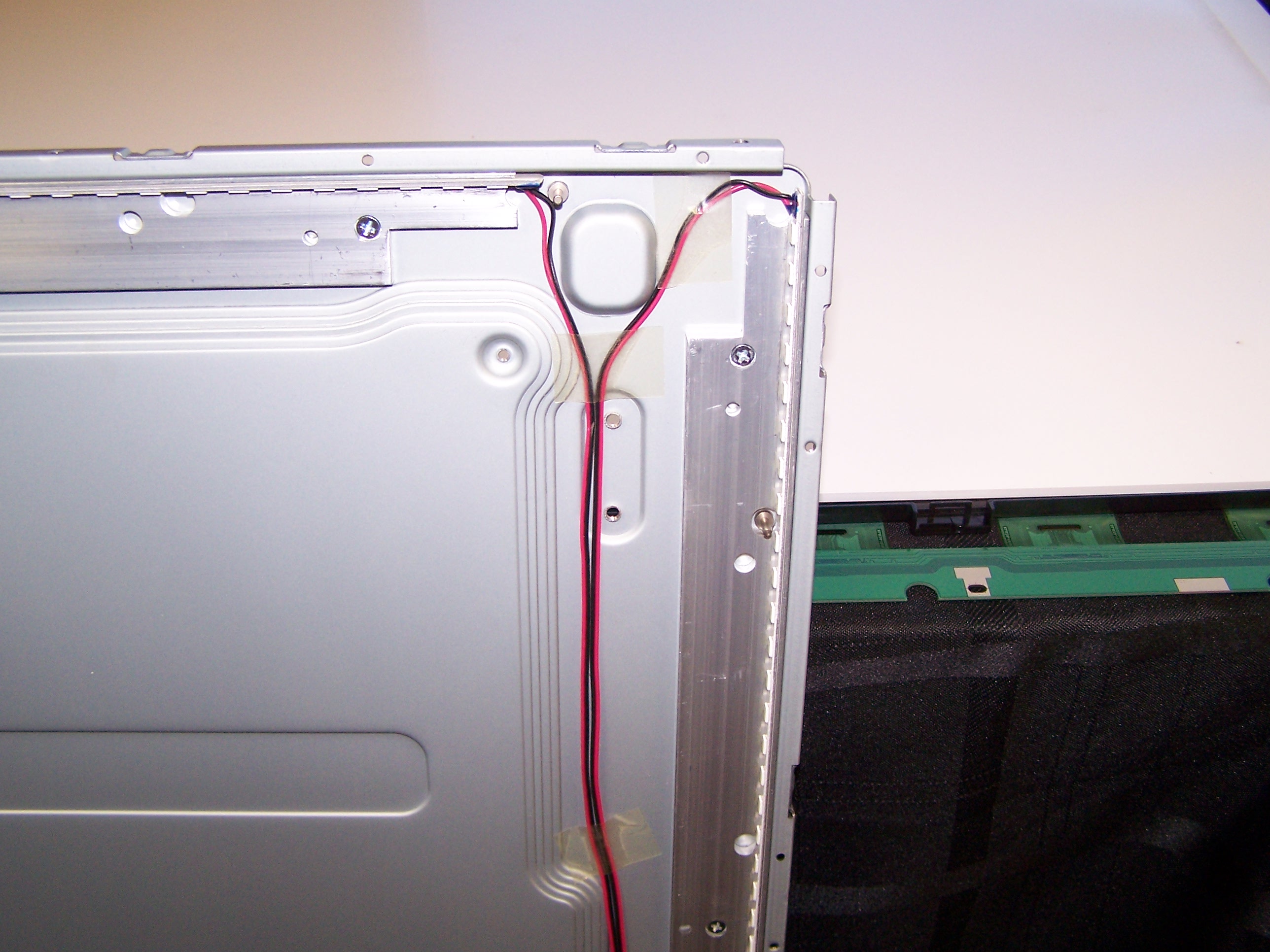

              ok spotted the shorts, there were 2 shorts one red wire and one black wire and its located right were it goes into led strings and the aluminum bars that hold those leds in place has fairly a sharp edge and low behold i found bare copper in the wires, i will wrap them up and probably use a file on those sharp edges.

                    Good, I am glad you located the shorts that way you do not have to take it apart again, you may as well look at the other 3 to see if the same thing can happen on the other 3set of wires, just for prevention. I am sure there are other TV with this sample with the same problem. You can use KAPTON tape.

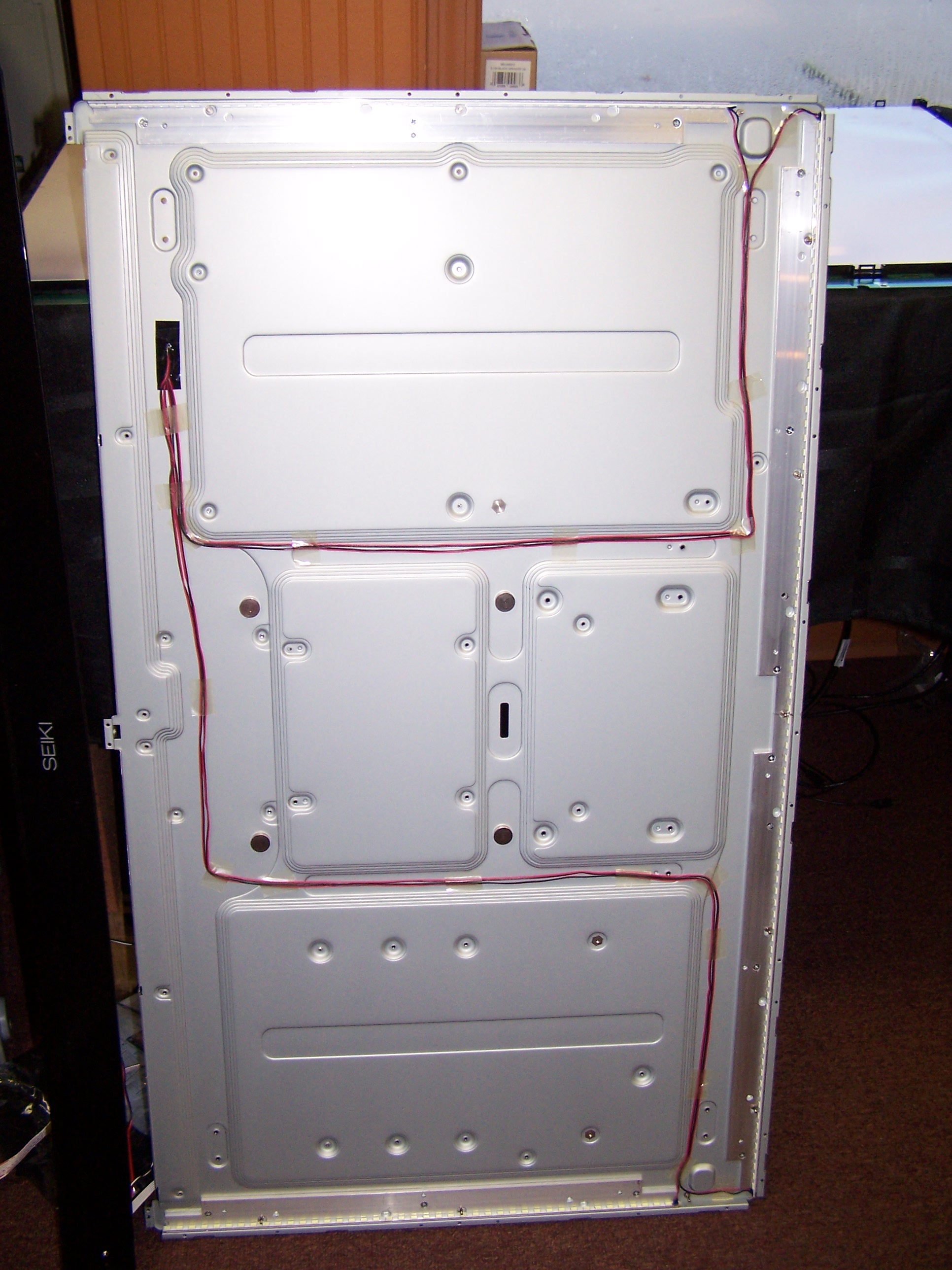

                          already thought of that, its a nightmare to take apart and put back together, so i did preventative measures and insulated under those wire the whole way to the though hole...

                            well it still shuts off and transformer is hot, this this is a big P.O.S....will recheck for shorts...
