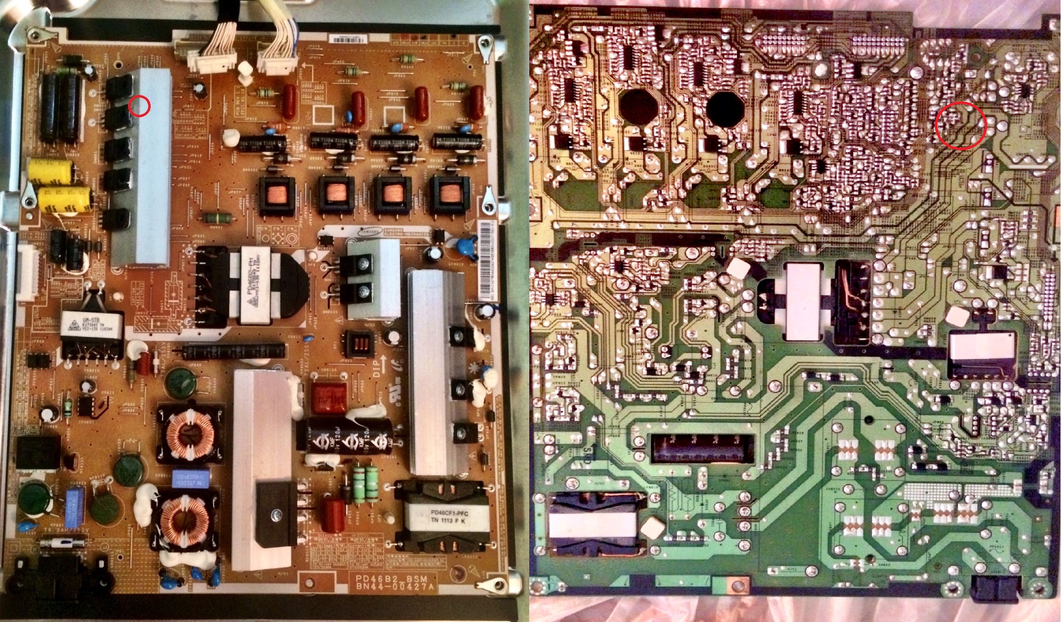

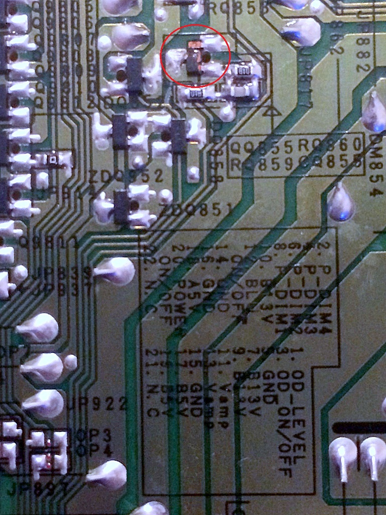

            I also have a similar issue with my Samsung UN46D7000 with PSU BN44-00427A which I have located the problem on the board itself visually. I am pretty knowledgeable with electronics but have only worked on PC's(troubleshooting, hardware/software issues, PSU's, motherboards, etc) but this is new territory for me with this TV. I simply need advice to be pointed in right direction from here as to what parts I should order to try repairing myself. I specifically need help identifying the burned out parts that I should order.
            These pictures identify the burned out transistor on my board and where it's located. I believe the transistor is QQ855 in that block where you notice the copper showing. I have not checked any voltages, currents, etc yet. If there is something you notice from this problem that I should check, I am all ears. Thanks.
