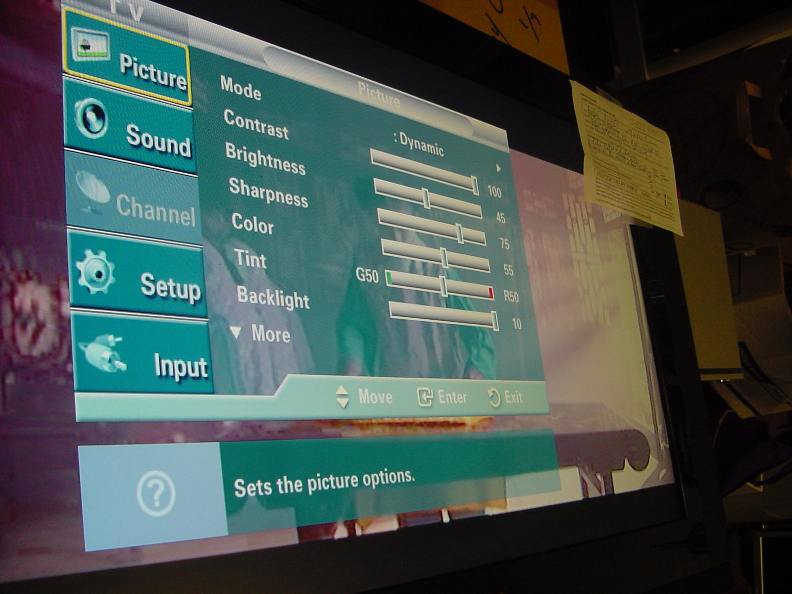

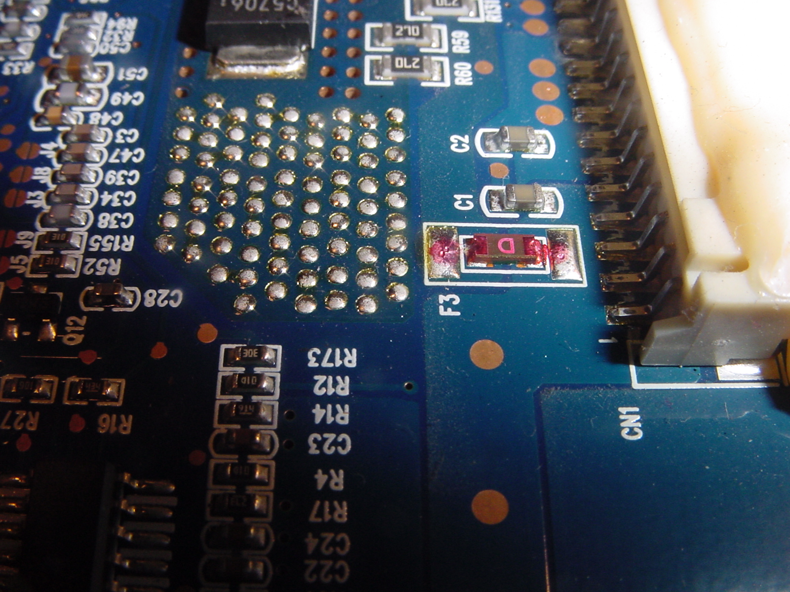

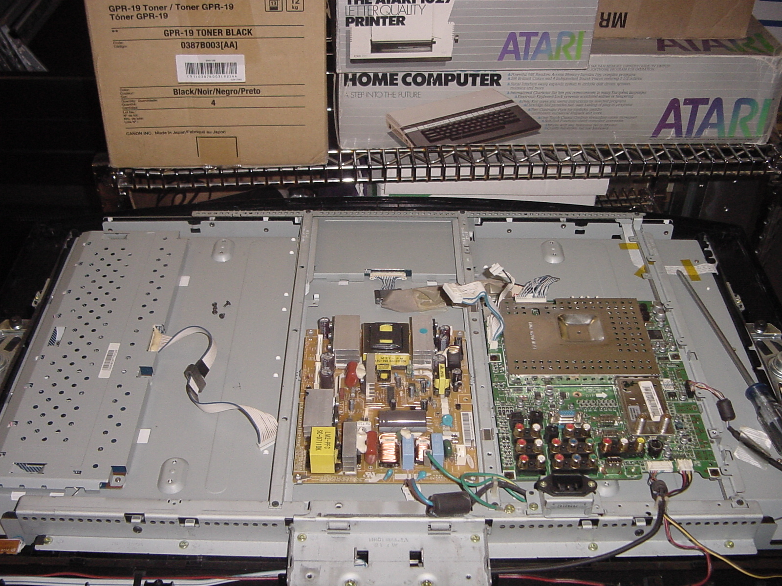

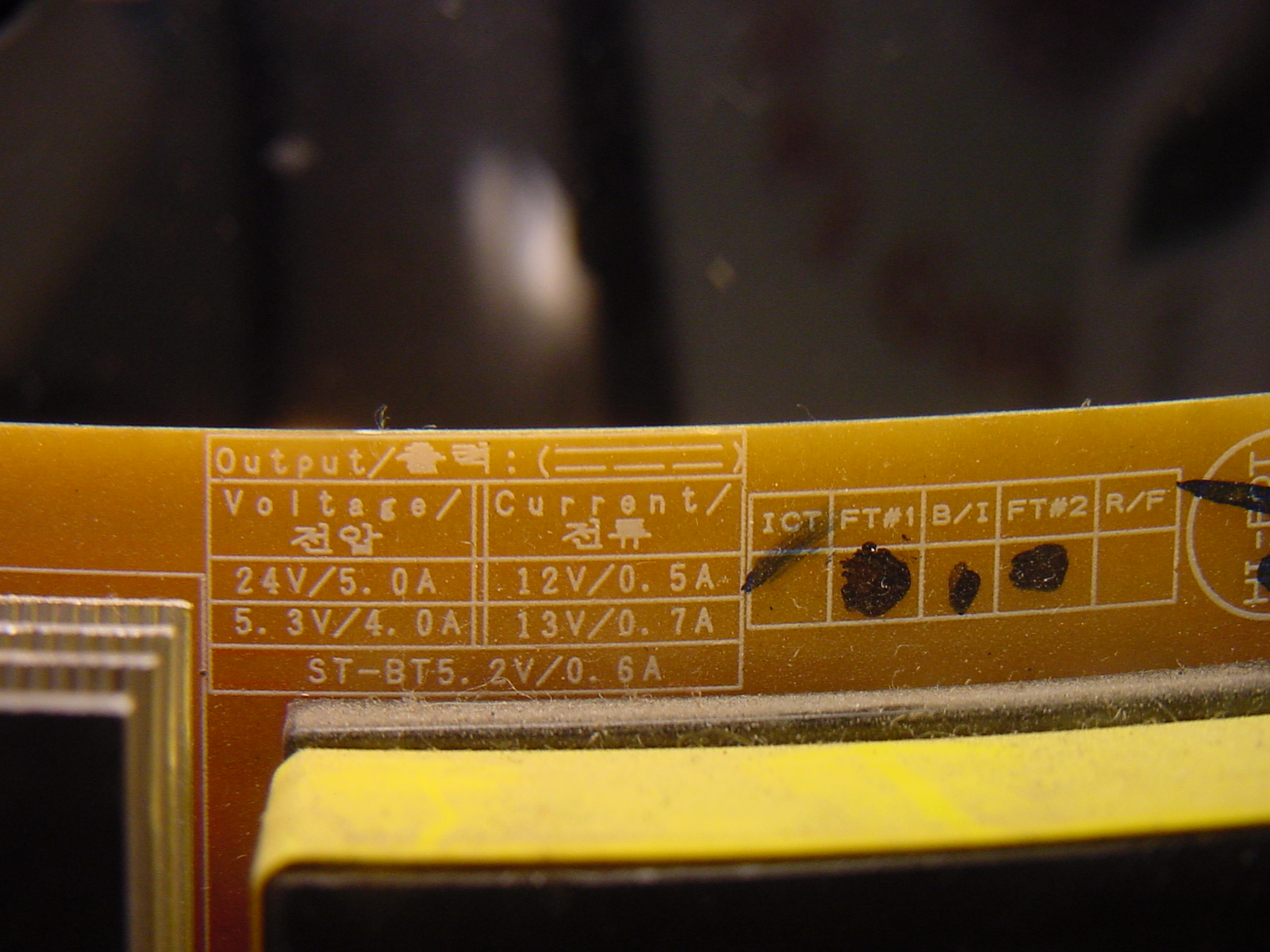

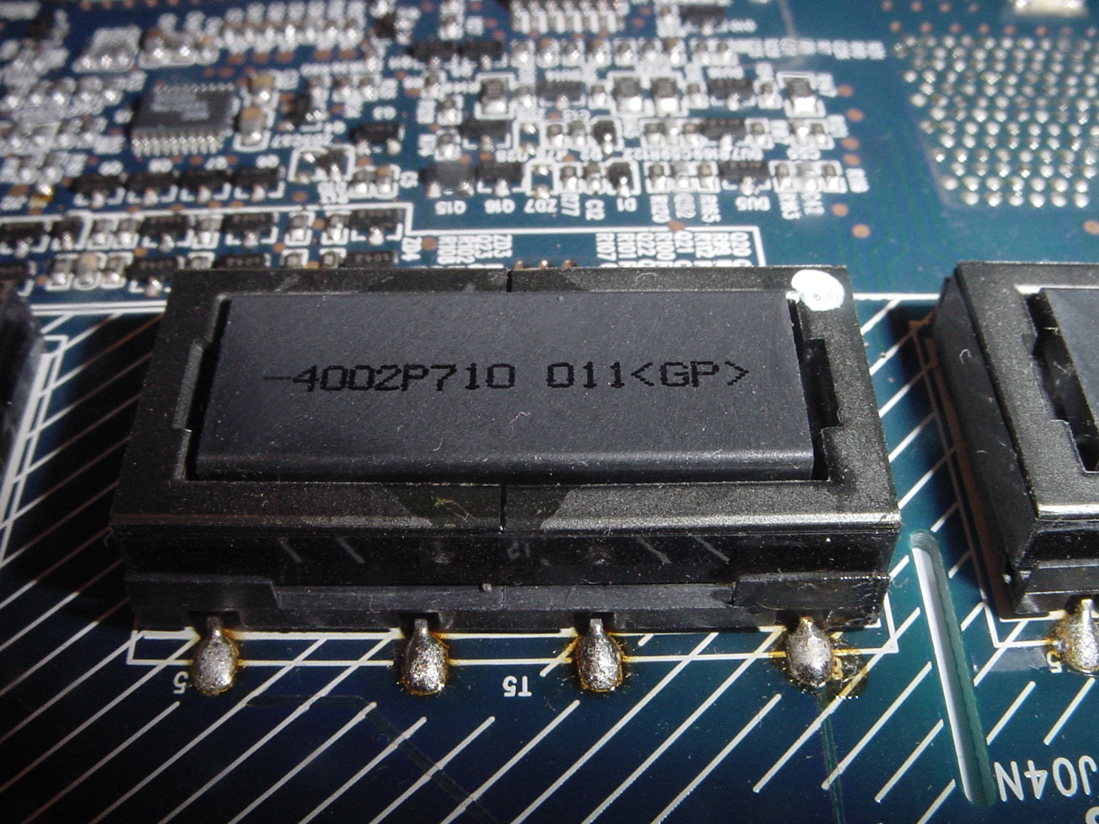

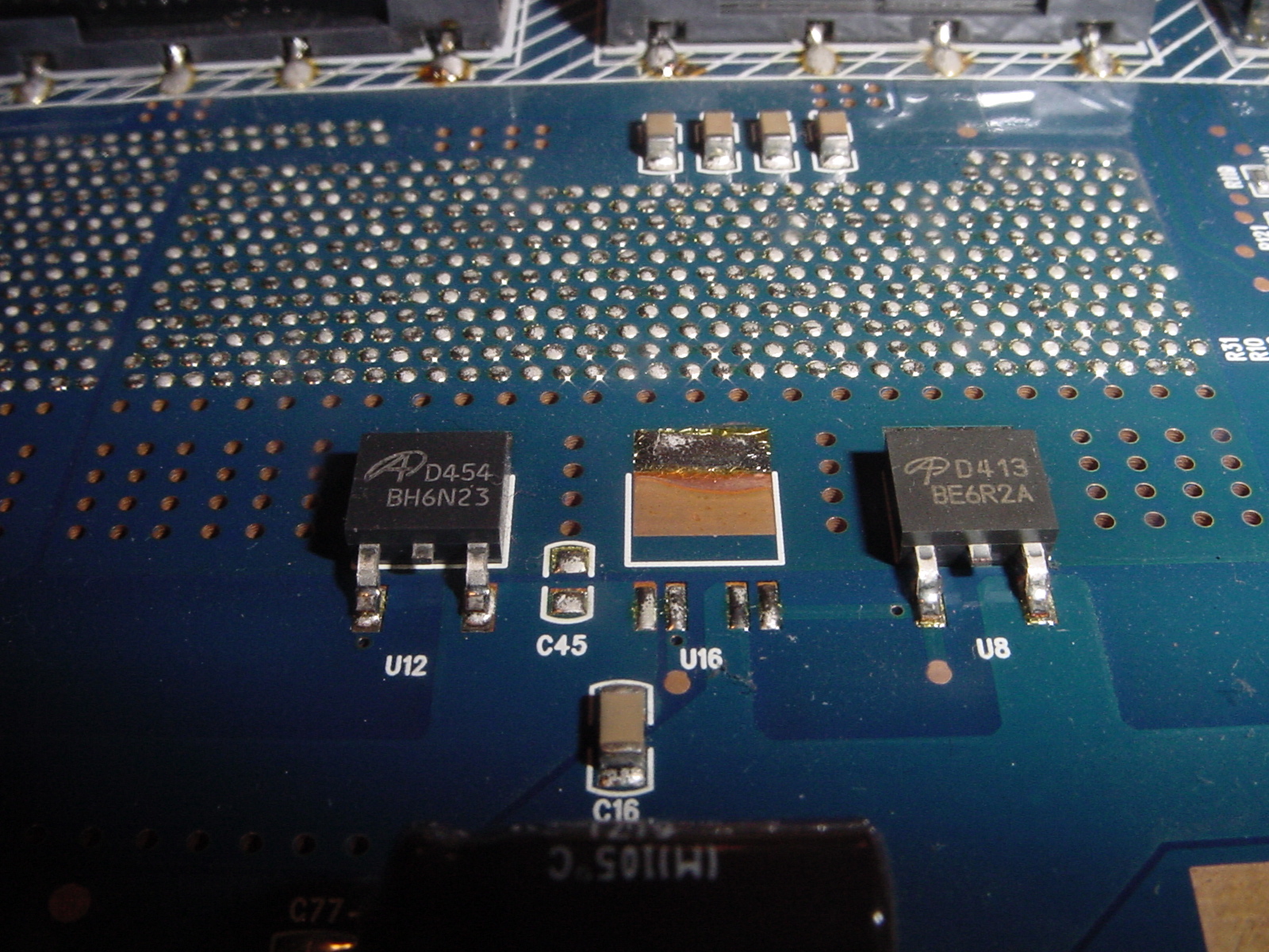

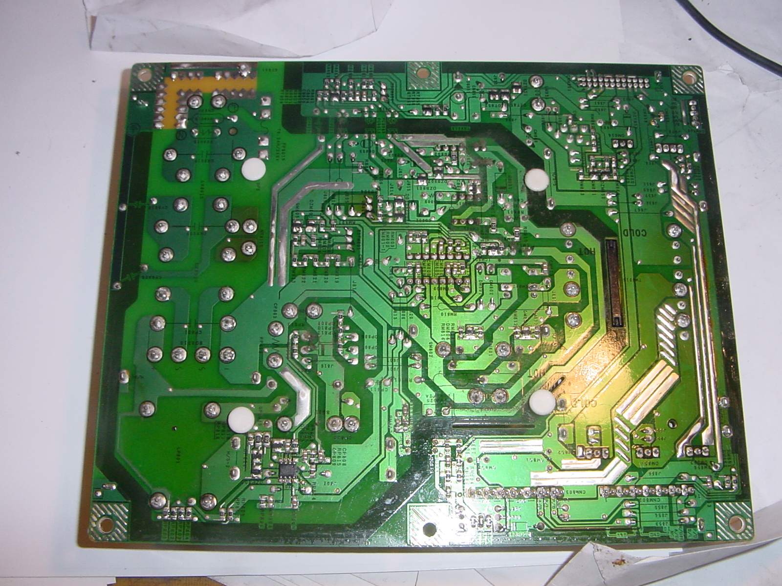

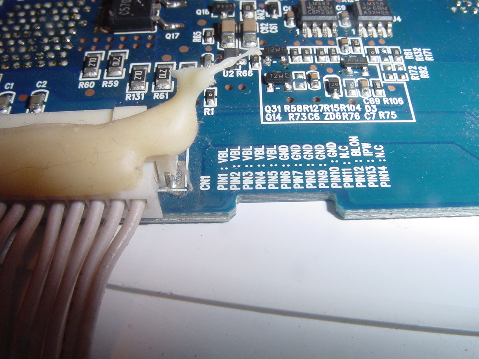

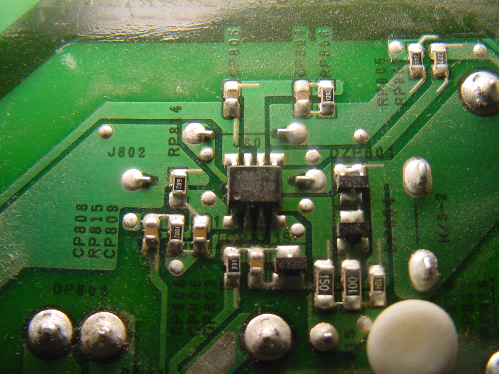

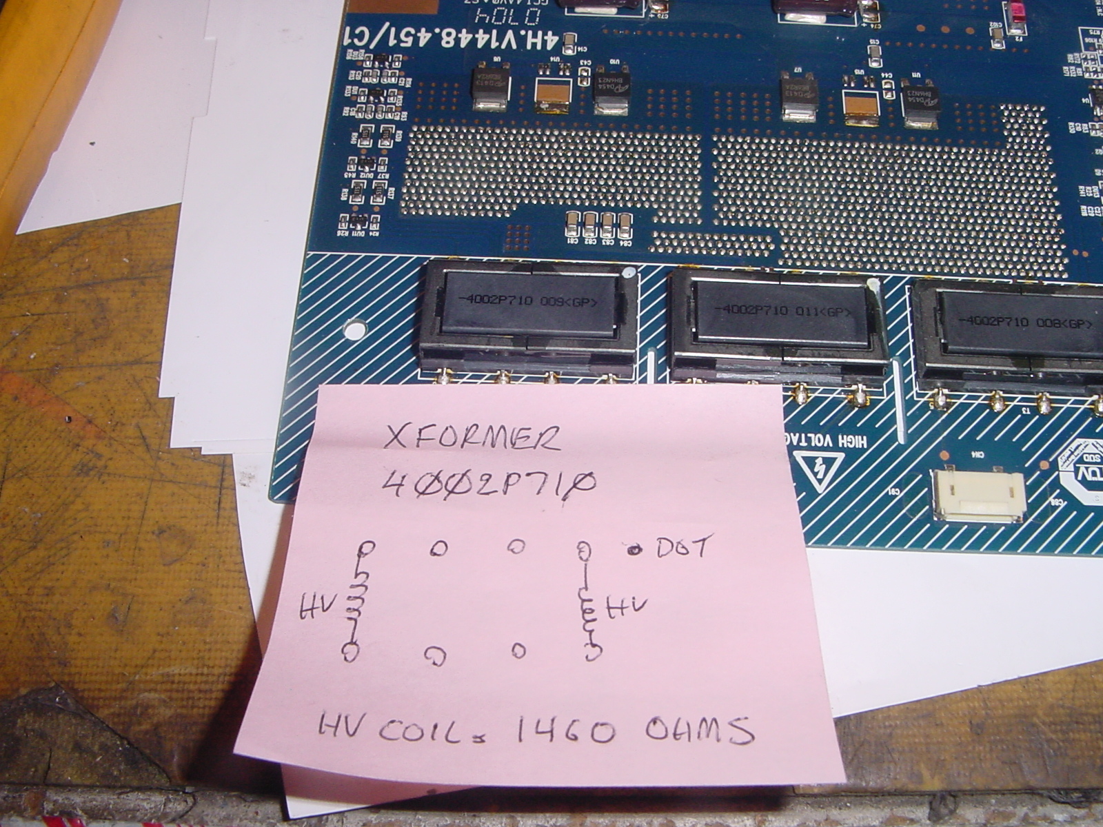

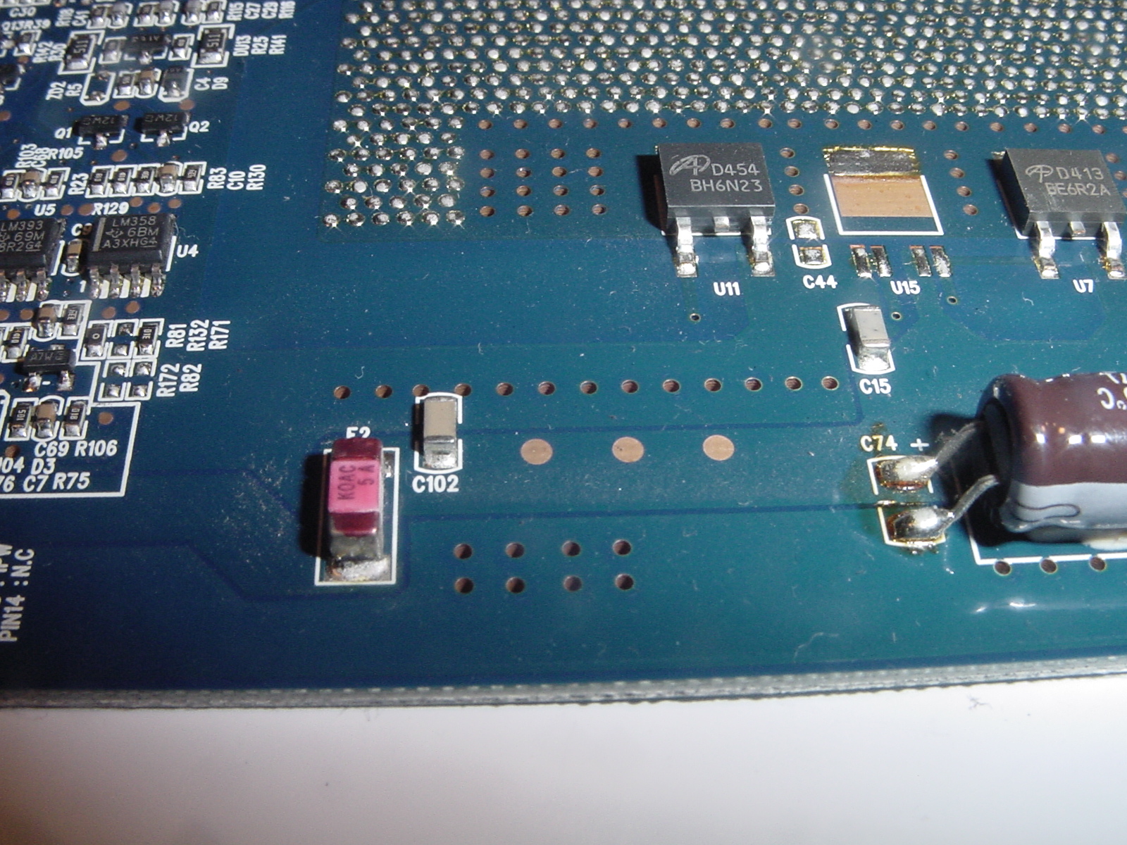

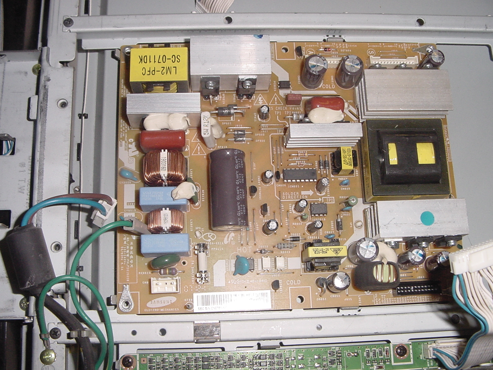

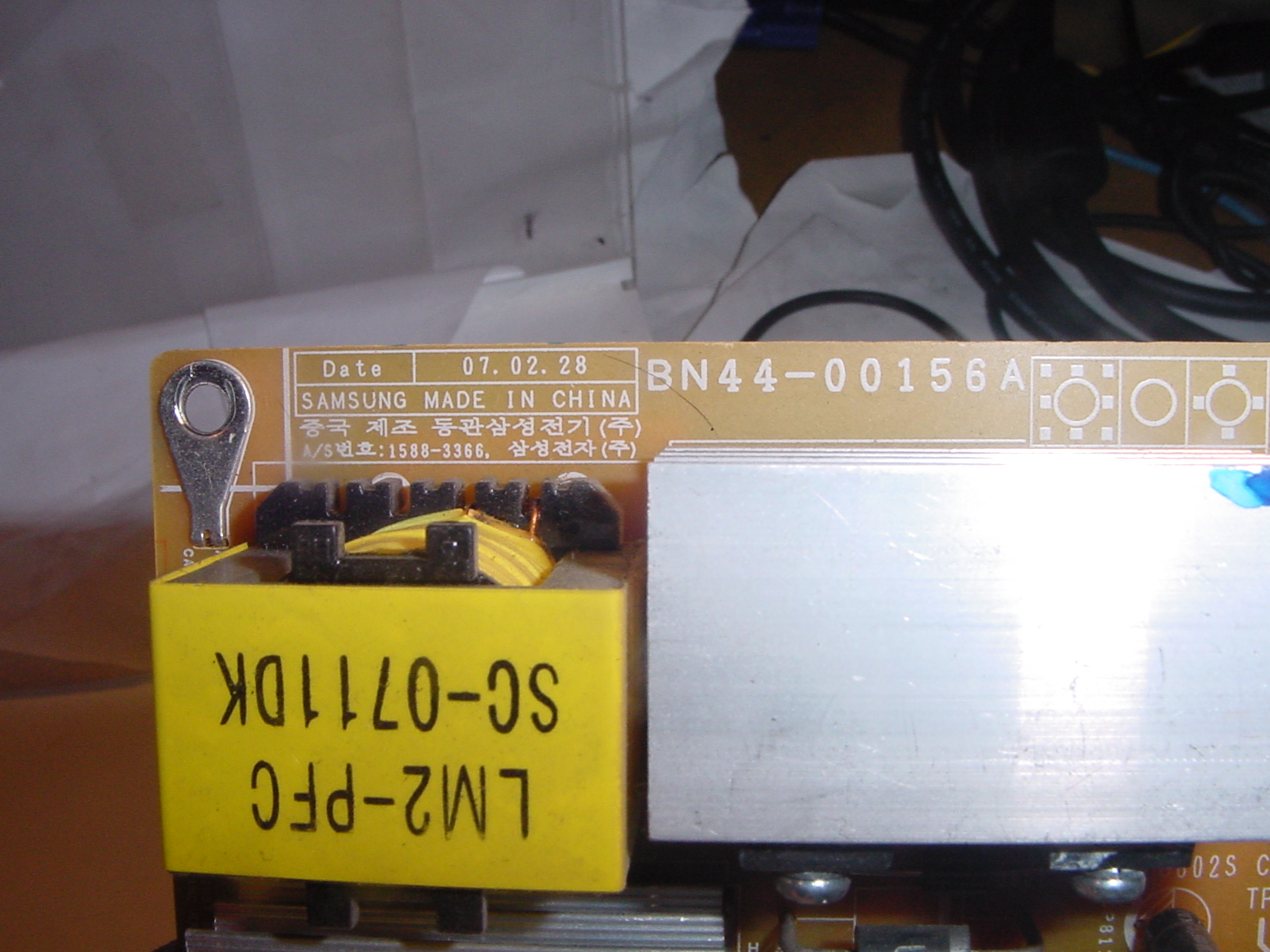

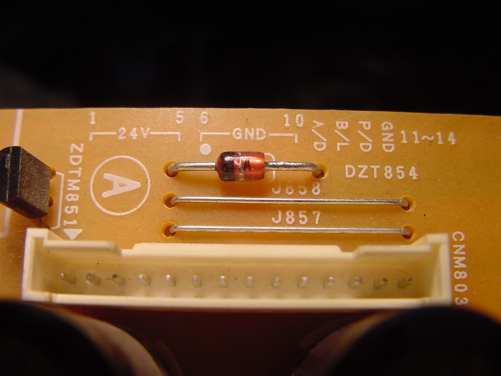

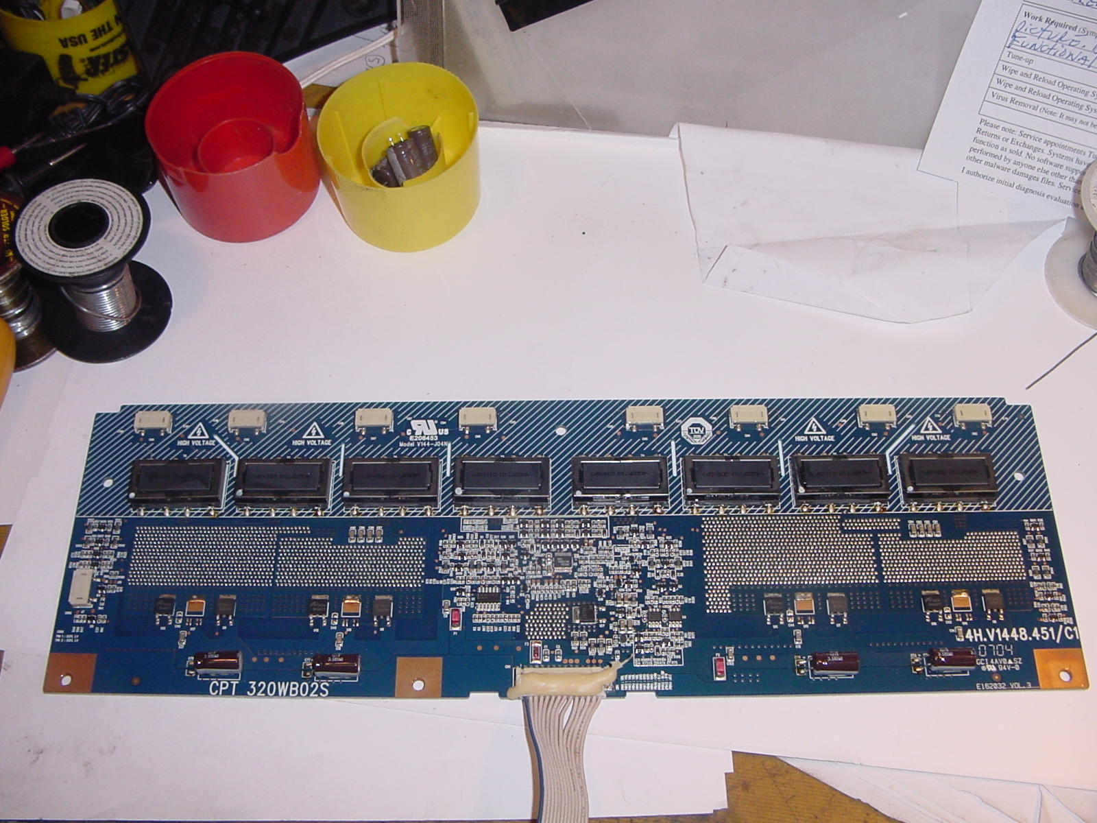

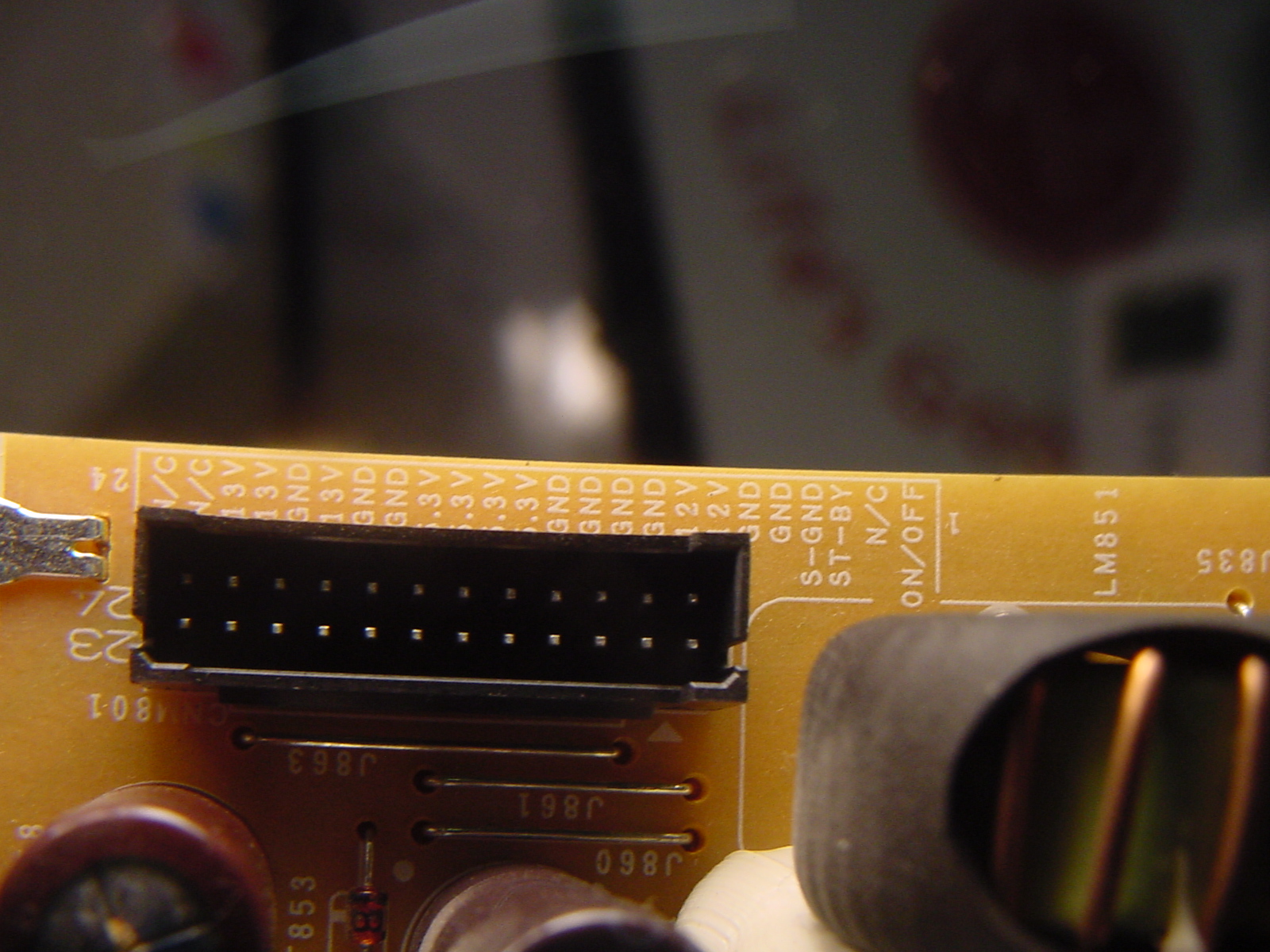

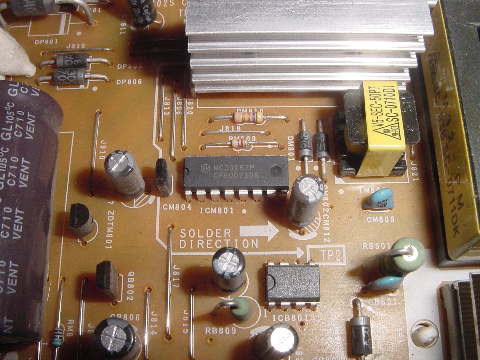

    Just got one in for repair today: it has no backlights, sound is OK.

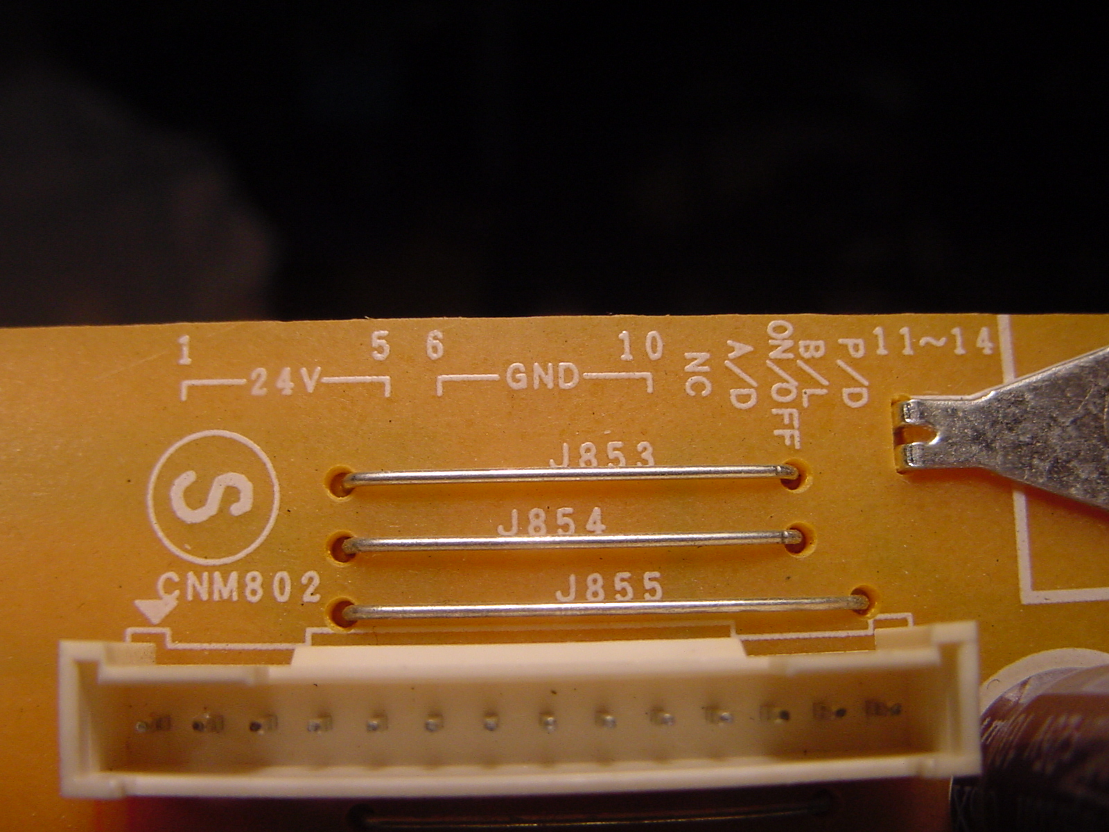

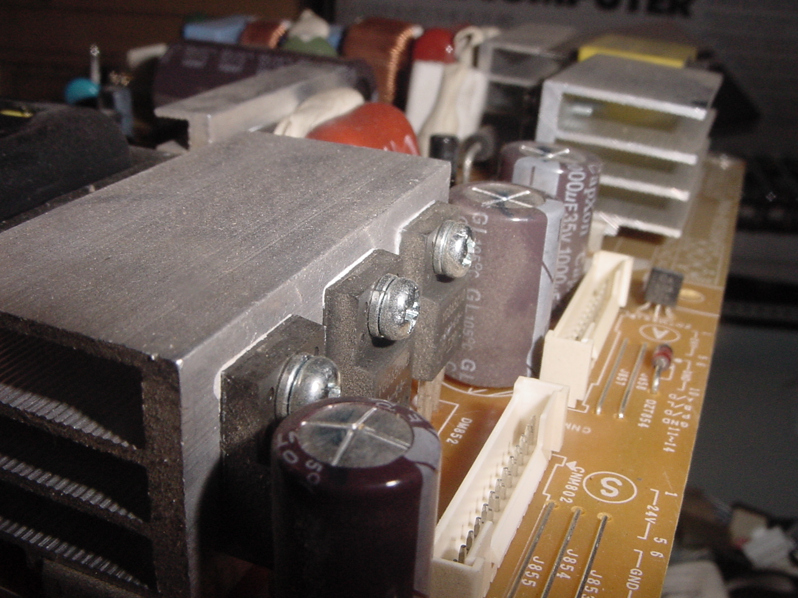

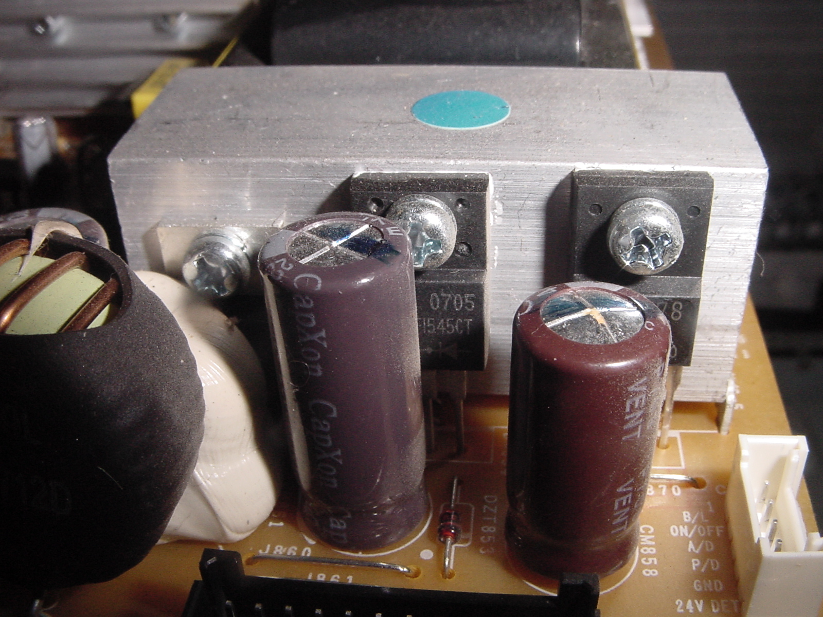

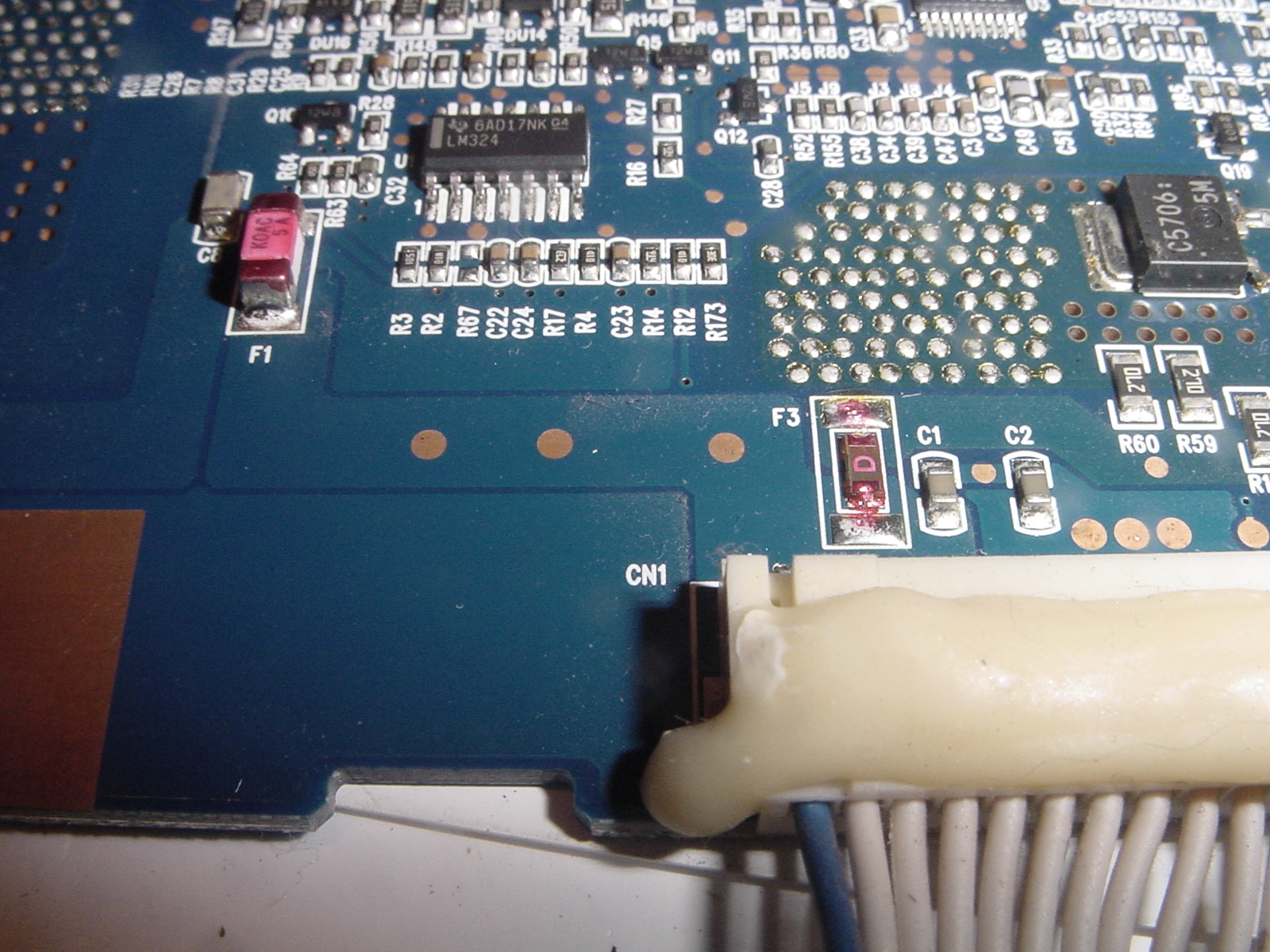

    Found bad caps in power supply and blown 0.25A fuse in the inverter board that supplys the power to the PWM IC.
    Re: Samsung LNT3232HX-XAA
    So inverter board fuse was blown and you replaced it and everything was good (besides the caps you mentioned)??

      Failed CapXon? They never fail!

        @kevin, yes, that's about it. Burn it in for 24 hours before giving it back to the customer.

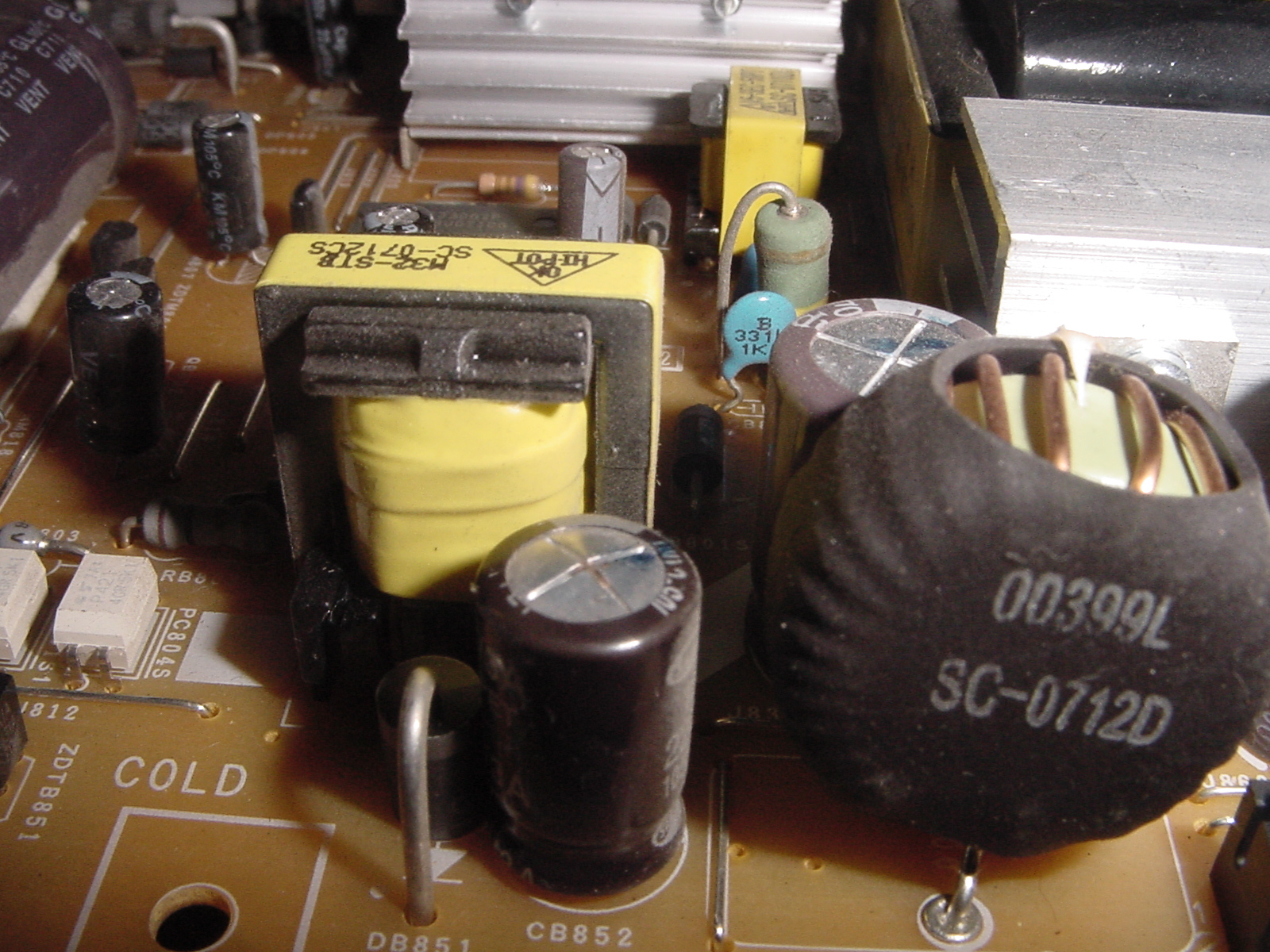

                Was that the 10v 2200uF ones that failed on em? I had a job where we had 15 of those units fail at a hotel.. Had to go from room to room repairing them.. Took me almost the entire day having to setup my work table, equipment, etc then re-pack everything to go to the next room.

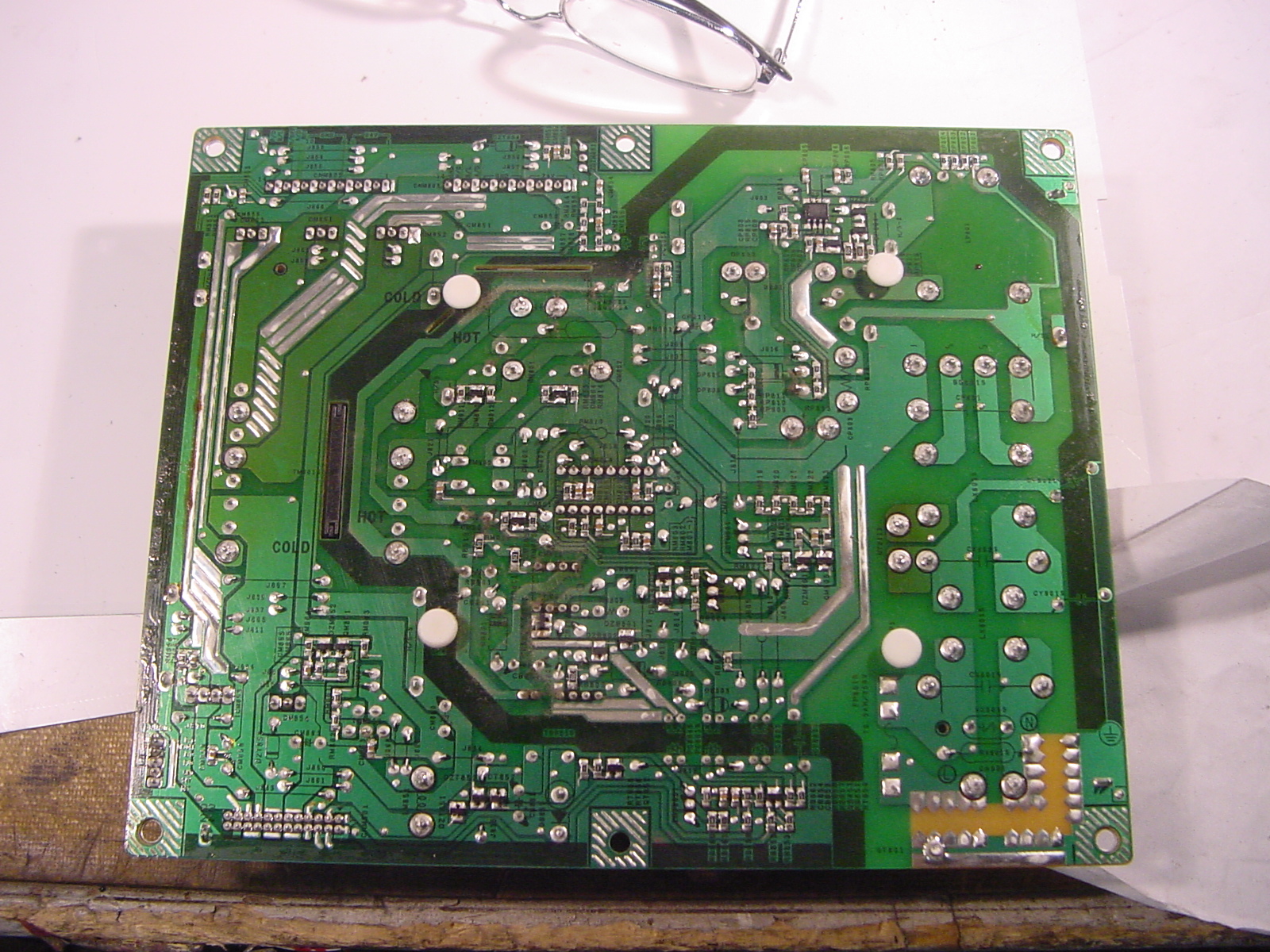

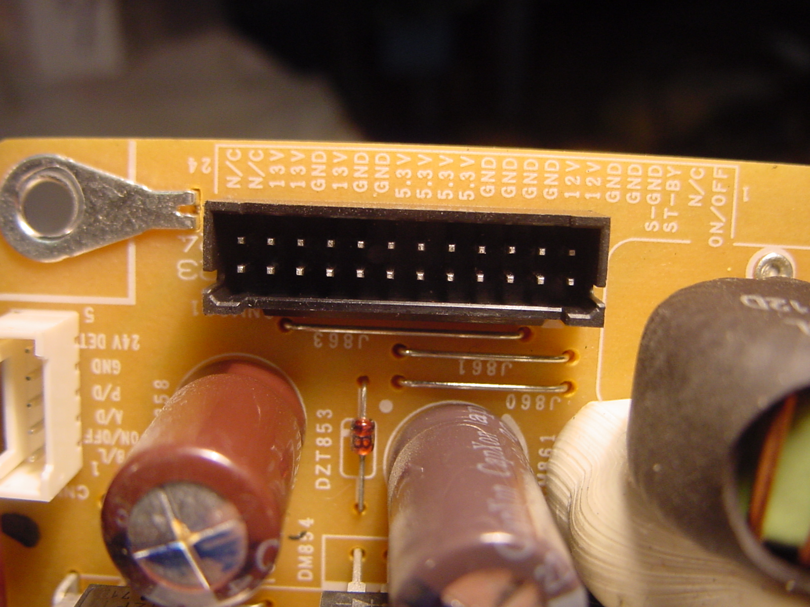

                  Yes, 2200/10V for the standby 5V, and 1000/35V for the 24V. I changed all the caps in the secondary side.

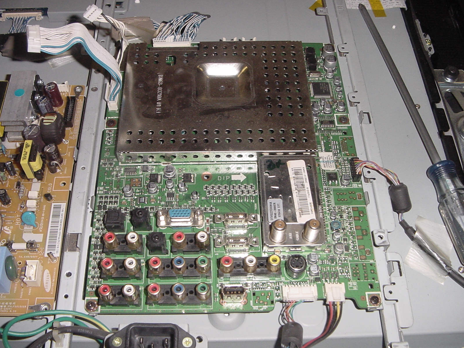

                    @budm, dude thanks so much. I'm a retired industrial electronics guy. never attempted a tv repair until today. your post made it childs play. keep up the good work. the pics helped alot in helping my ailing eyes spot the board level components. thanks a bunch.

                      Interesting. Do you still recap them if they're garbage caps? budm, nice job!!! Thanks for uploading all the pictures.
                        I do sometimes if they are known bad like capxon.

                          More pictures here if you care to look and see if you are working on the same model.
