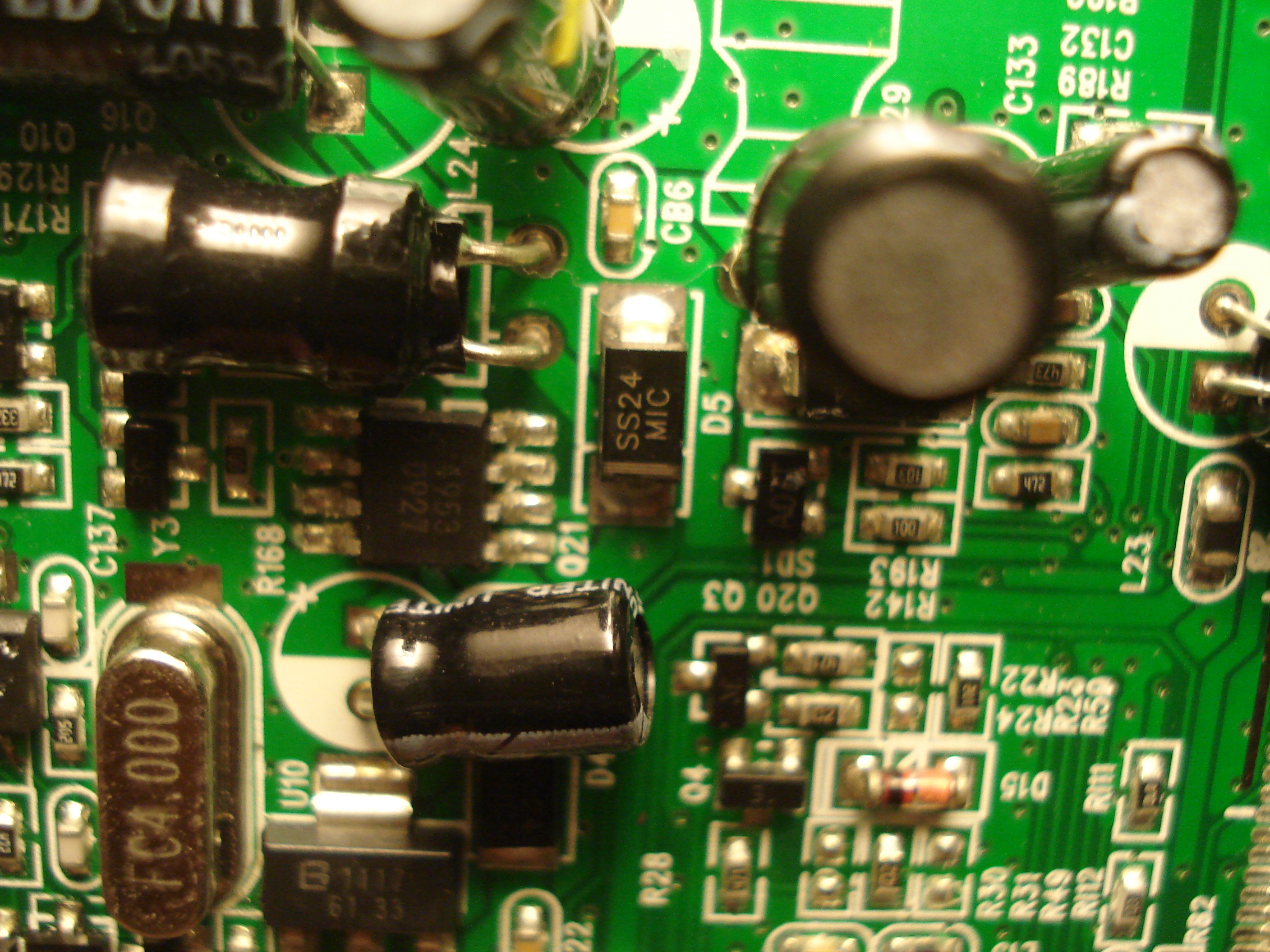

    I have this small lcd tv that I am working on. when I push the power button on I can see faint image but the tv won't turn on. when it is in charging mode, the power button continuously flashing. where should i start? any idea?

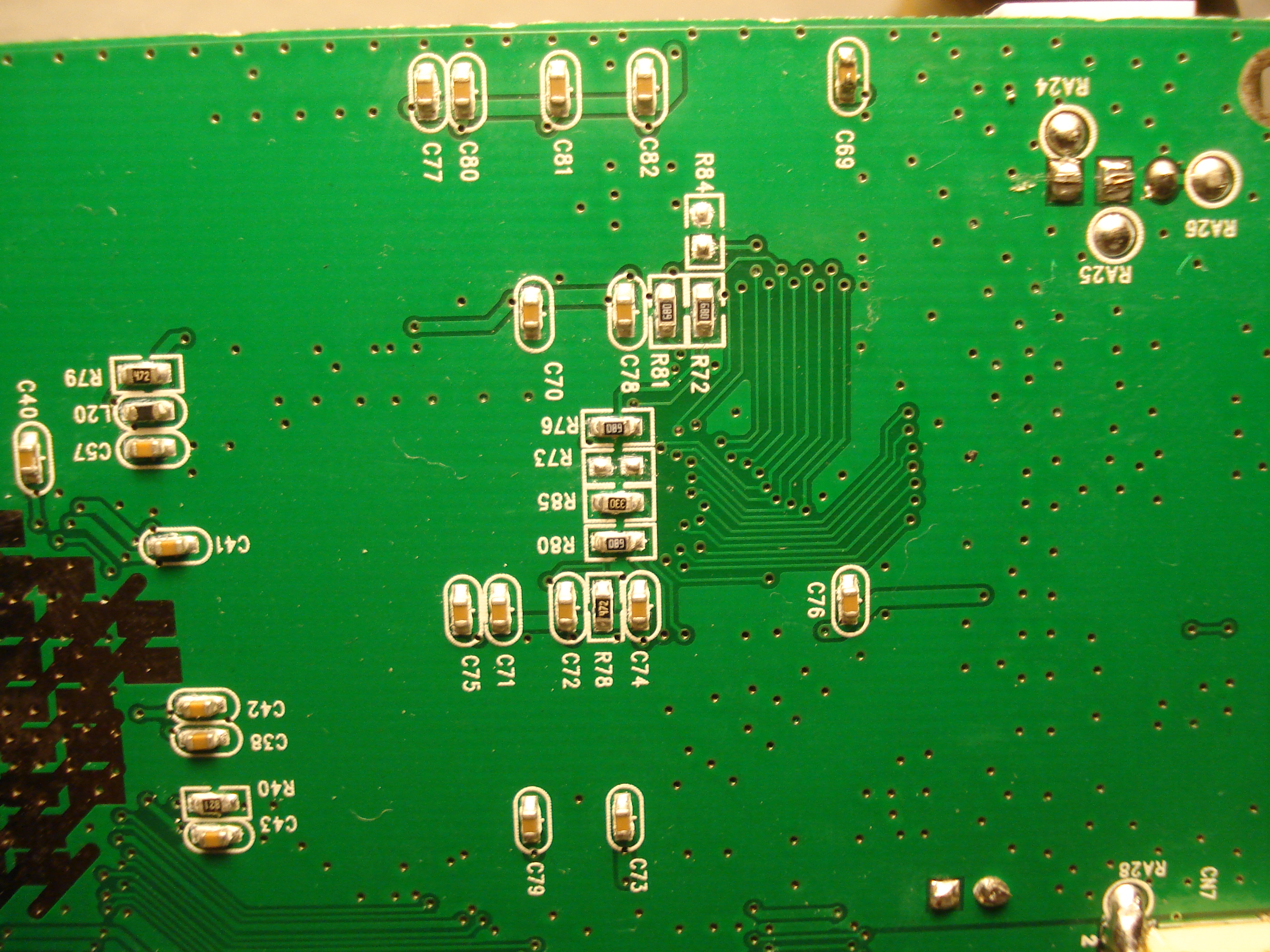

                    • arman960
                      • Sep 2012
                      • 129

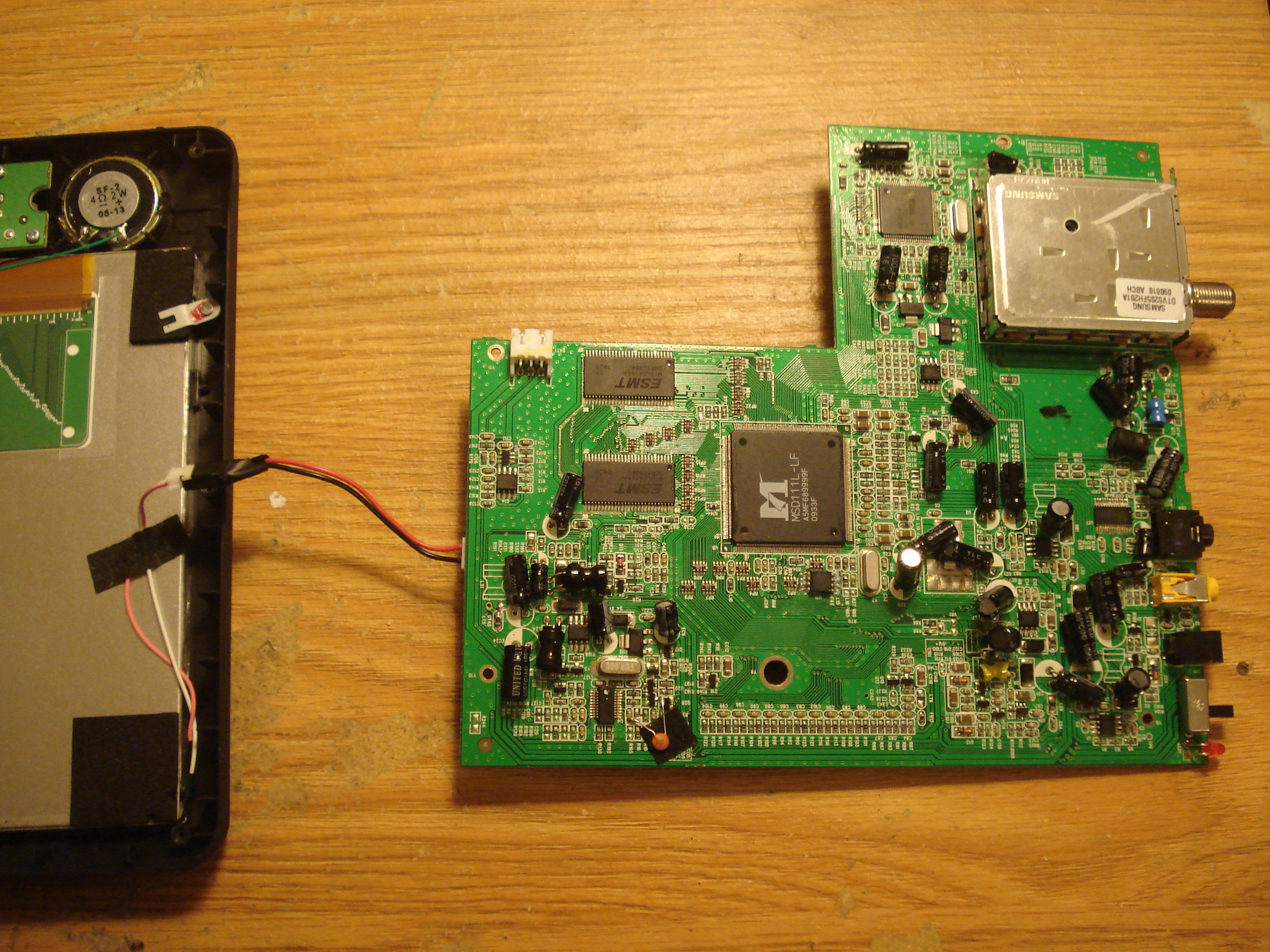

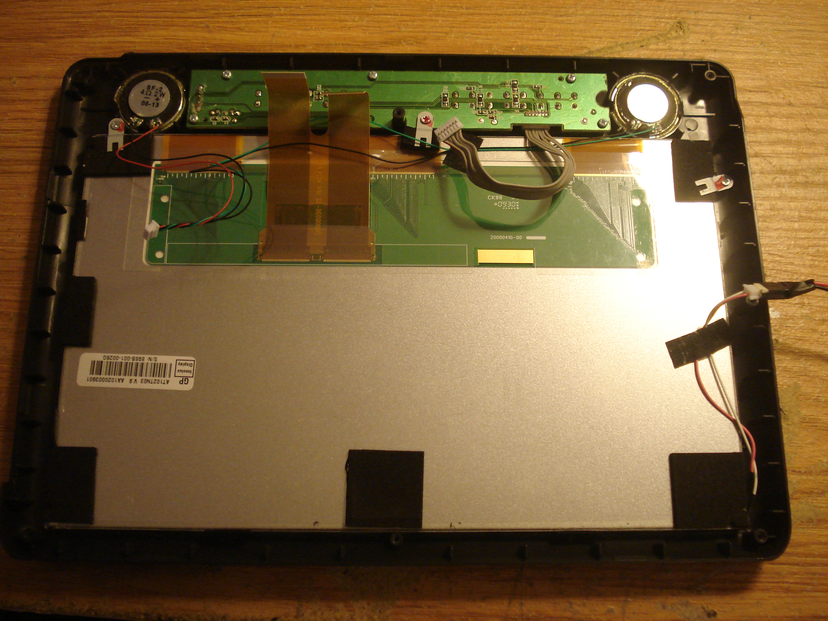

                      Re: HAIER HLT10 No video no power won't turn on

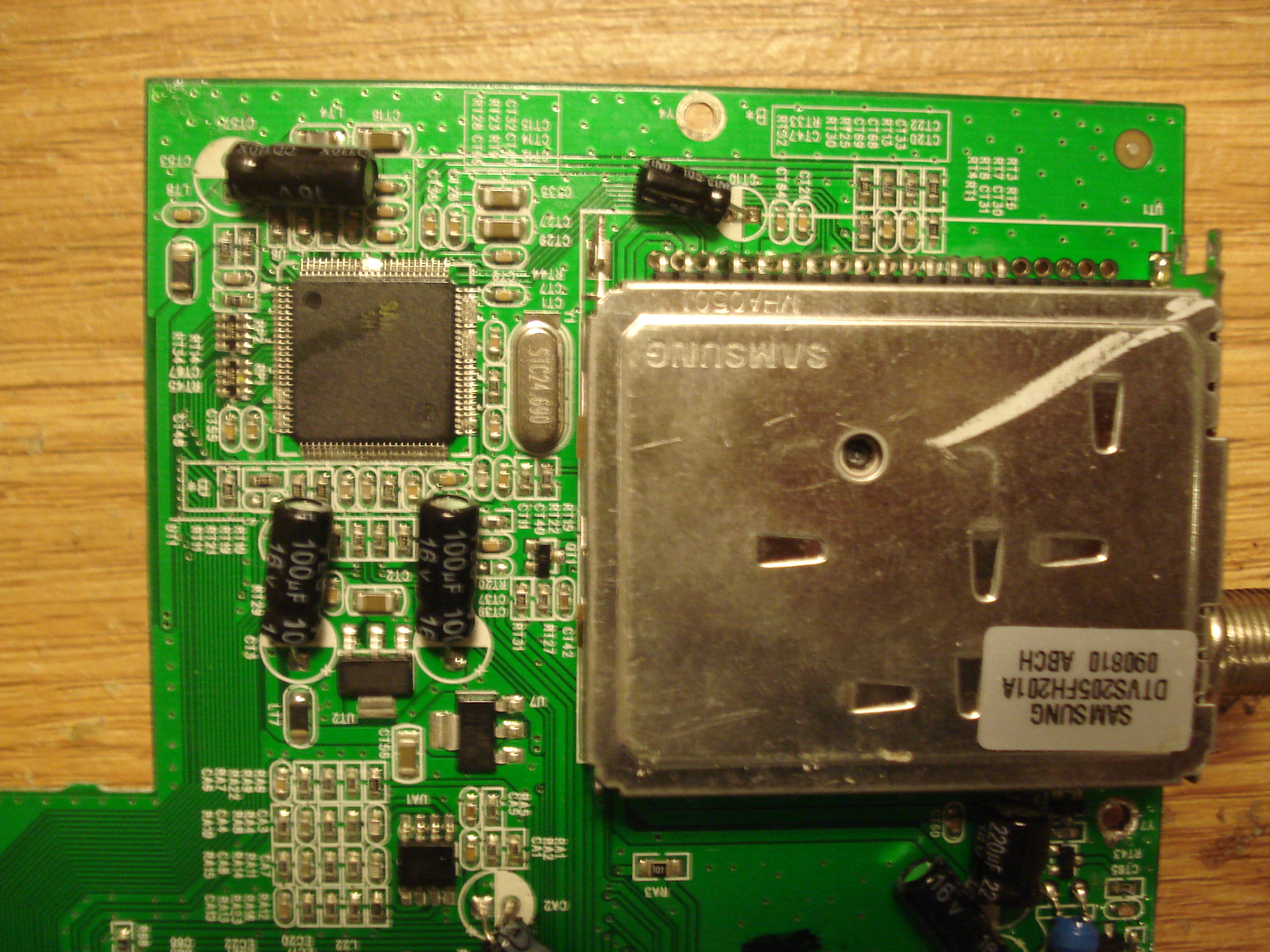

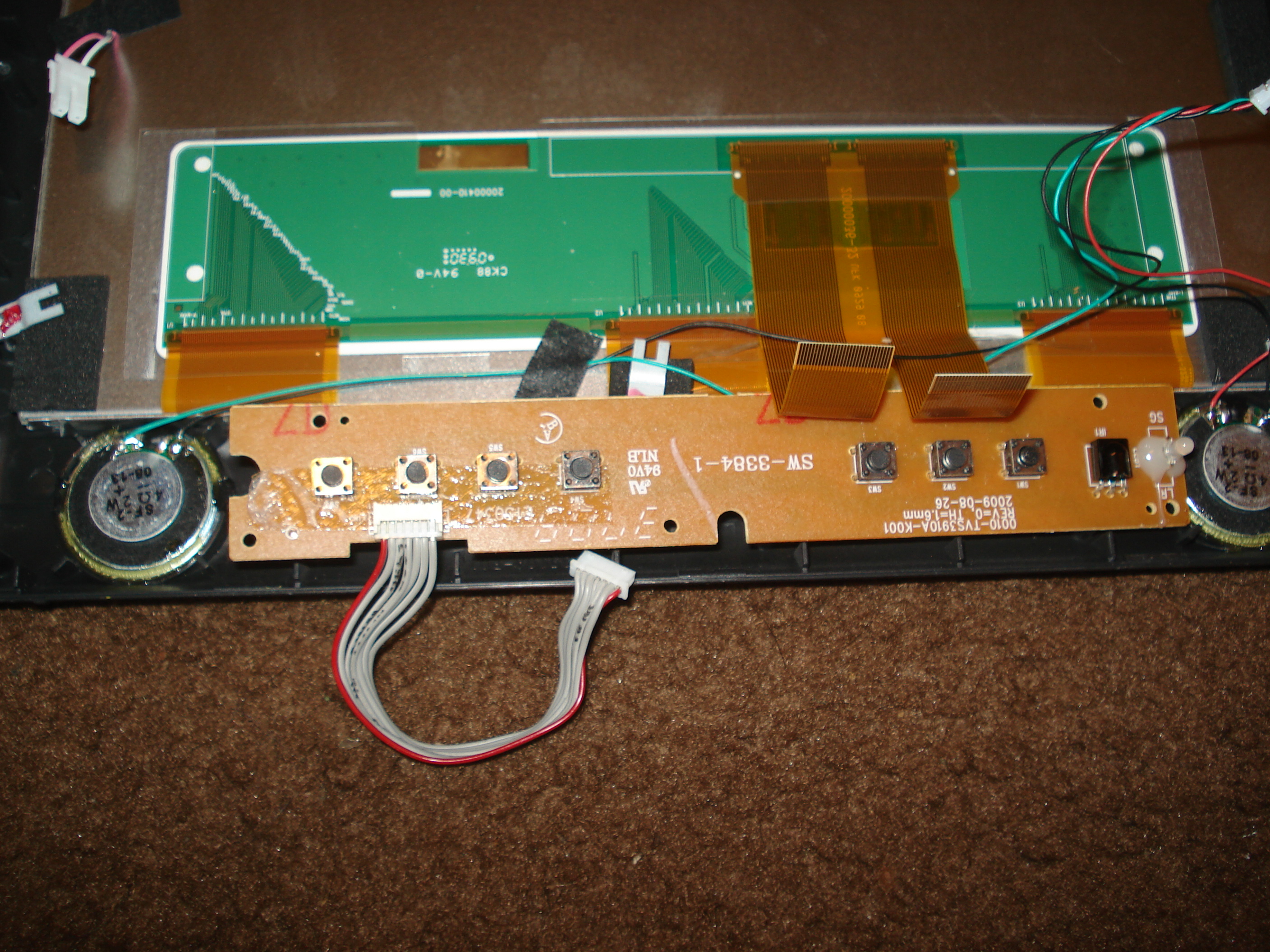

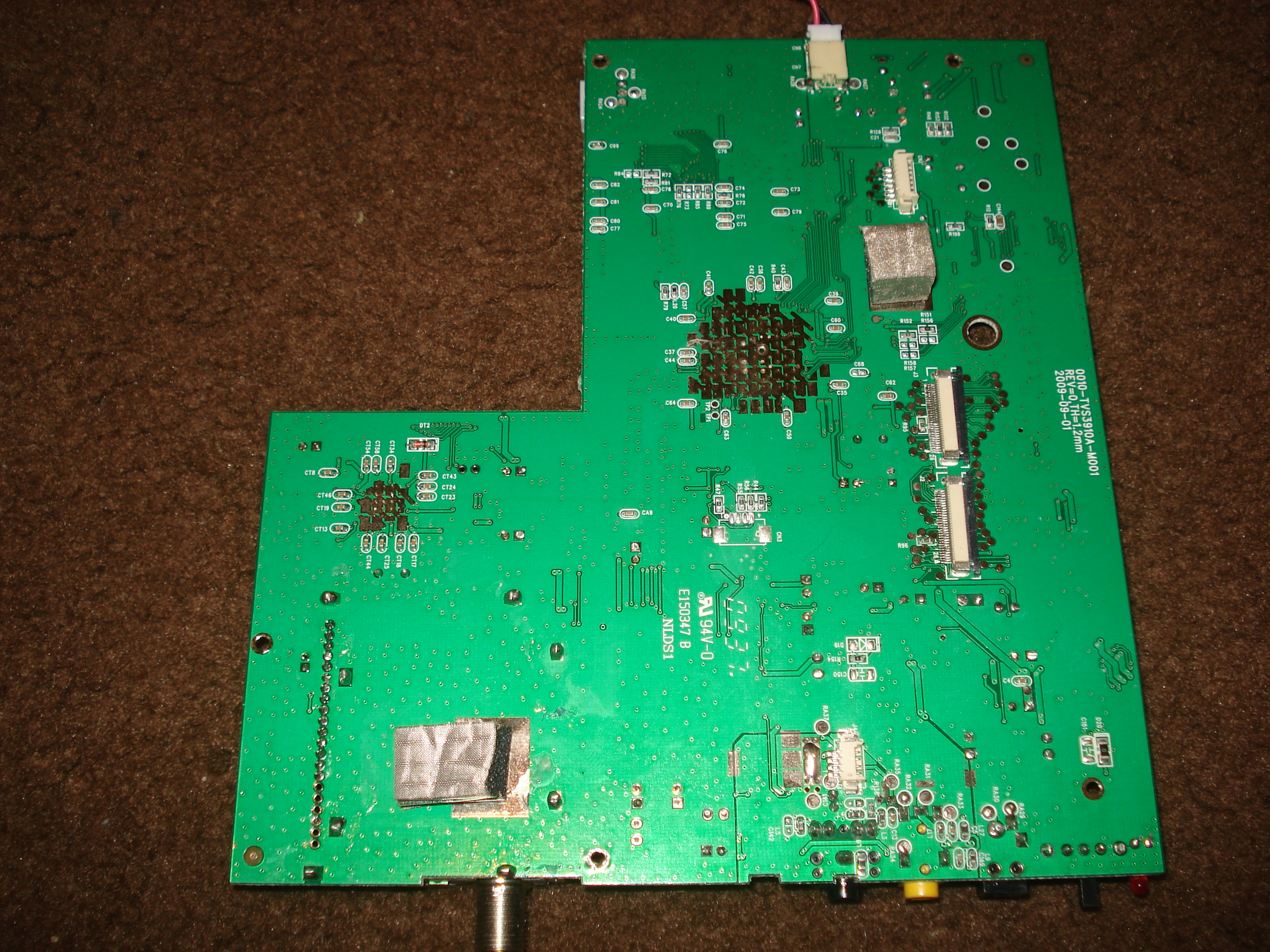

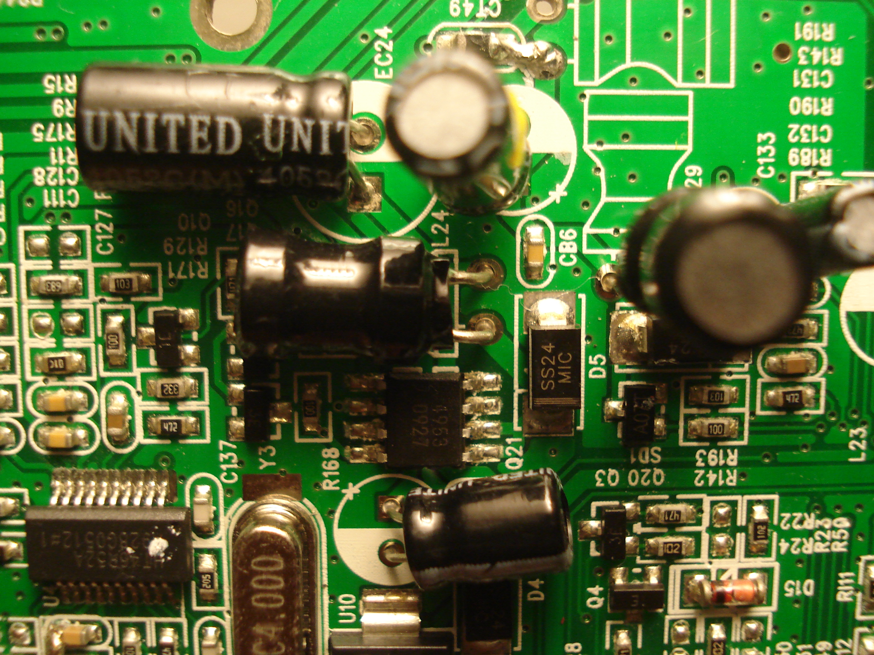

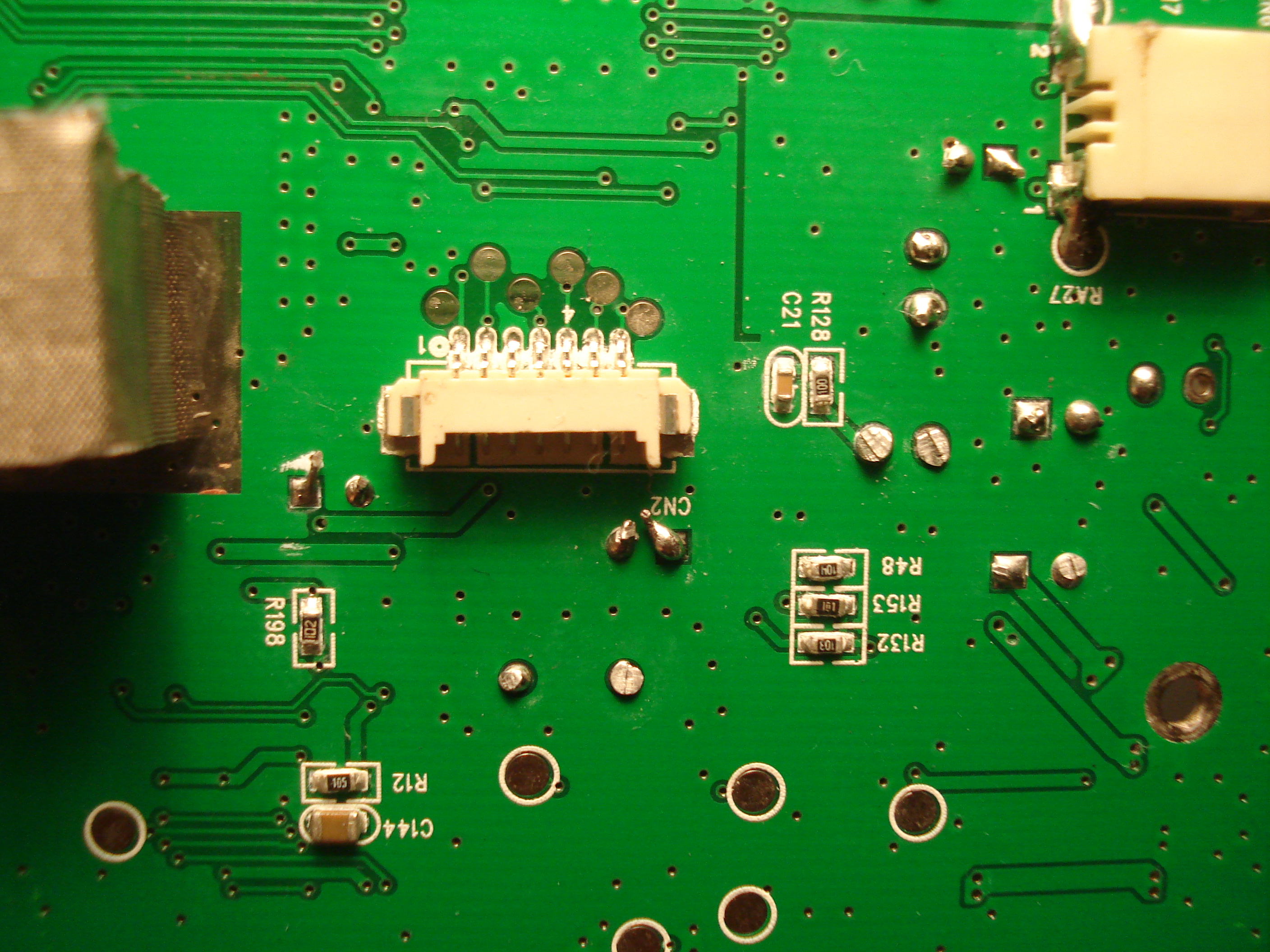

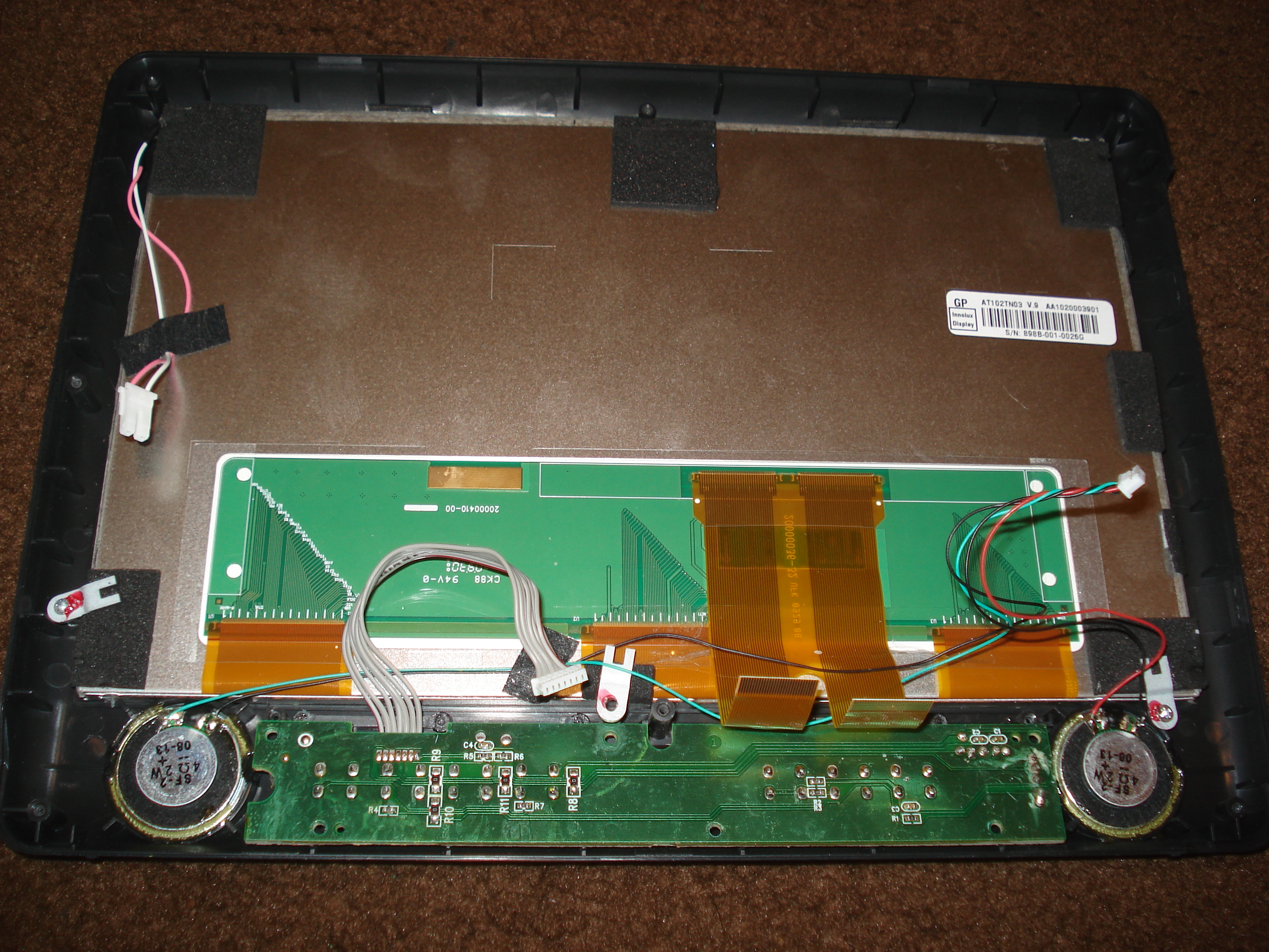

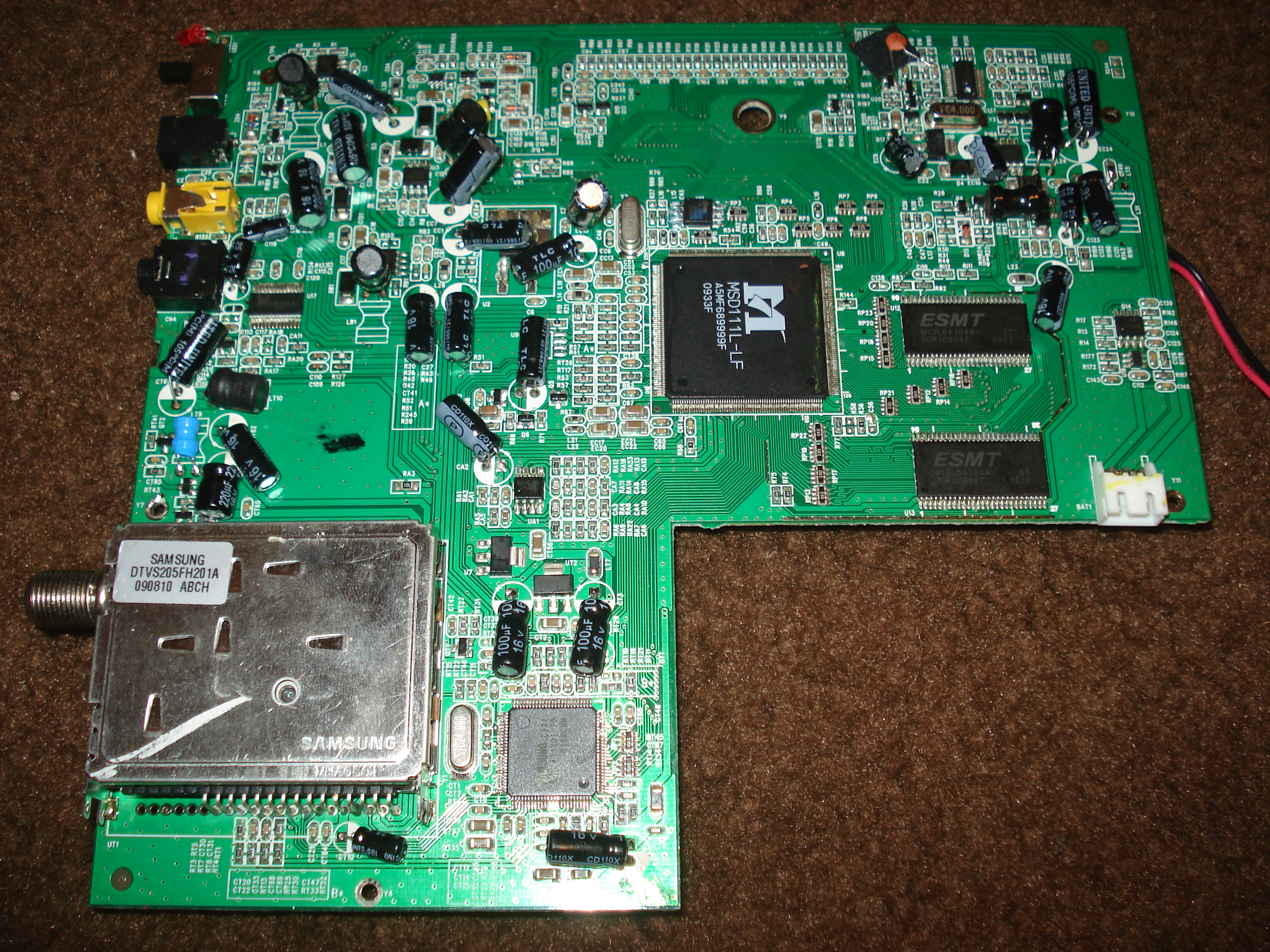

                      Here are the pictures. Let me know if you need additional pictures.

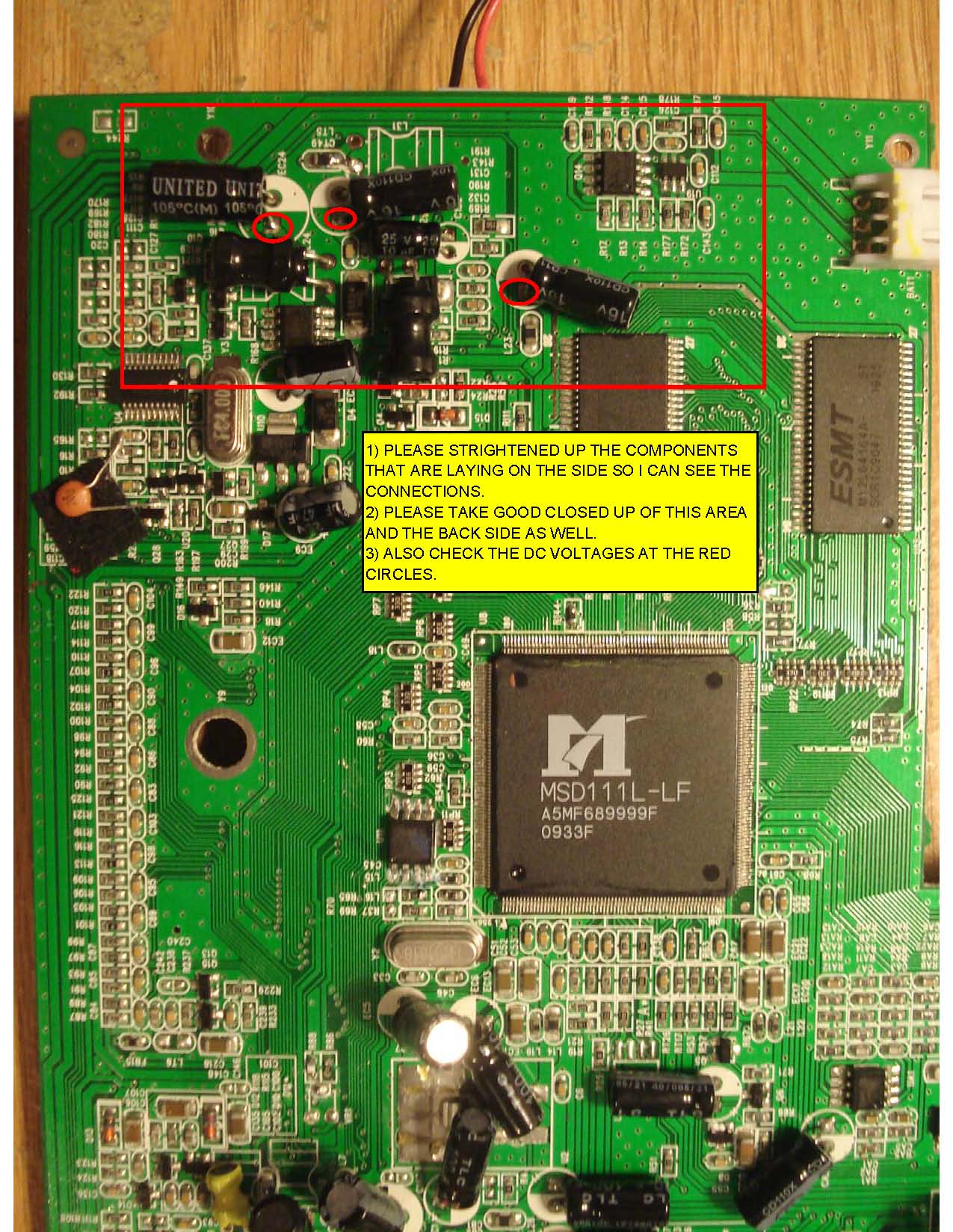

                        On picture #1 I can see a white plug with red and white wires which looks like it is for the backlight. Where does this plug go to on the board? I do not see typical High voltage transformer any where on the board. Can you leave that connector connected to the board and take pictures of that area. This unit may use LED backlight.

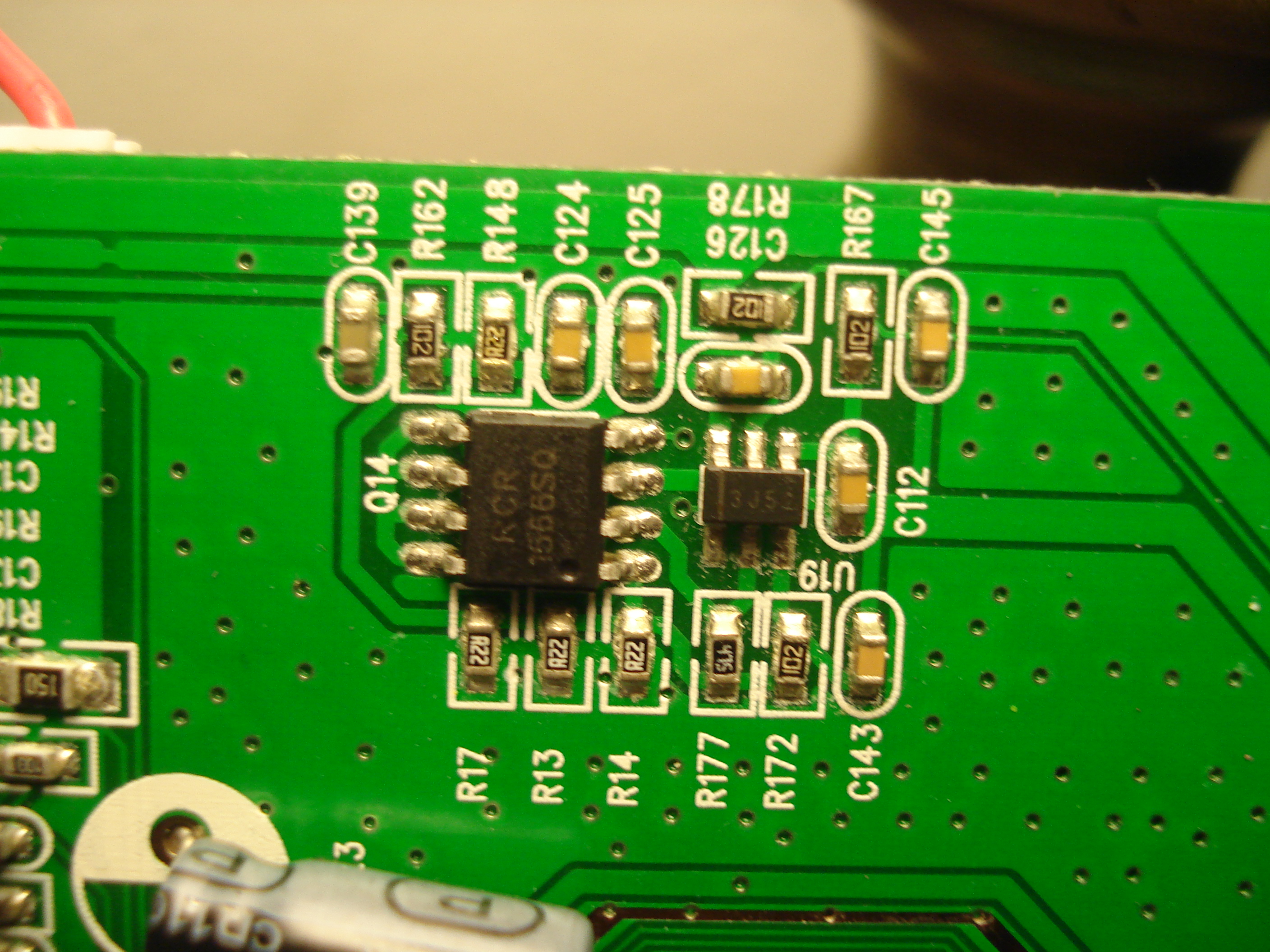

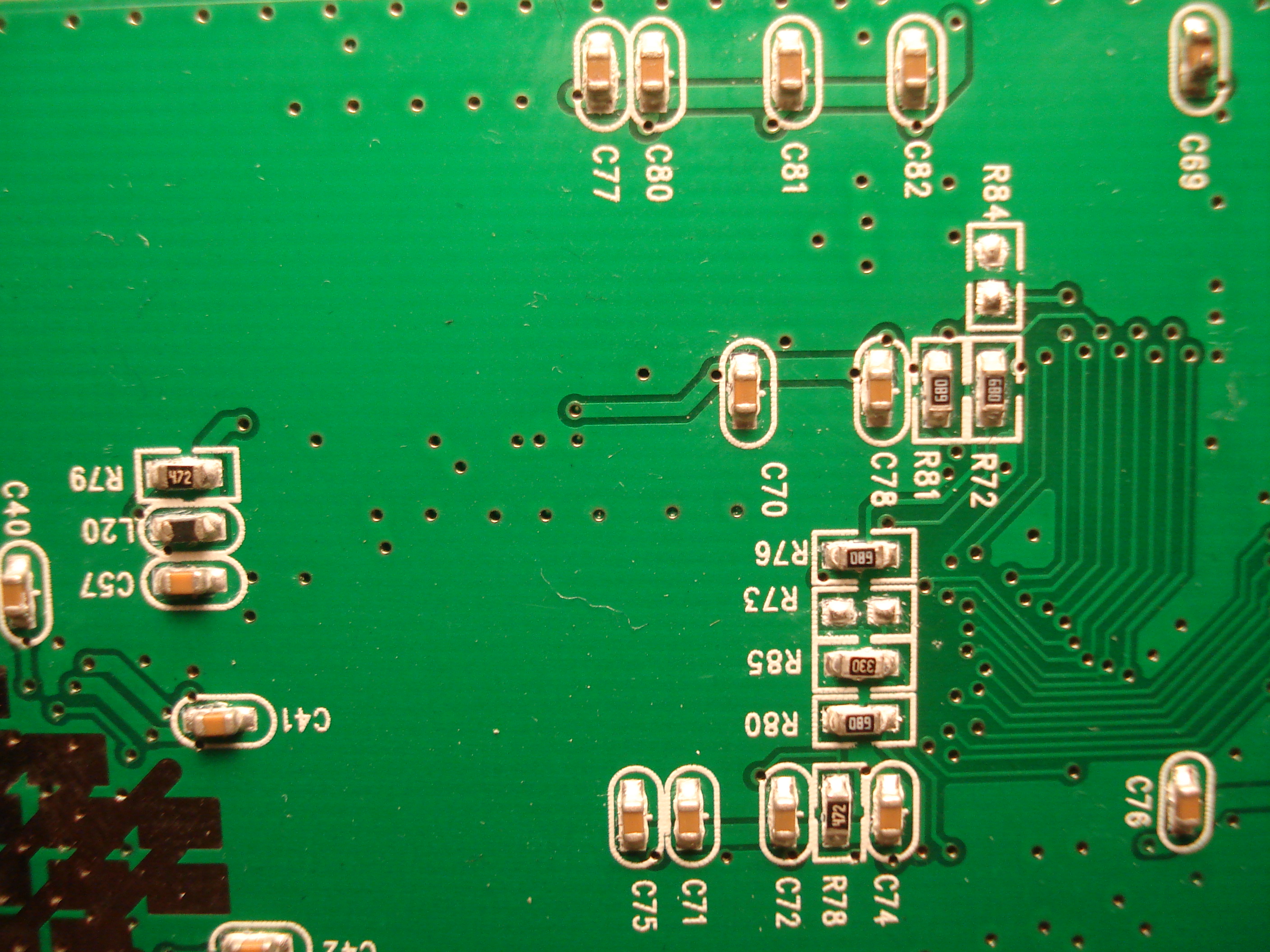

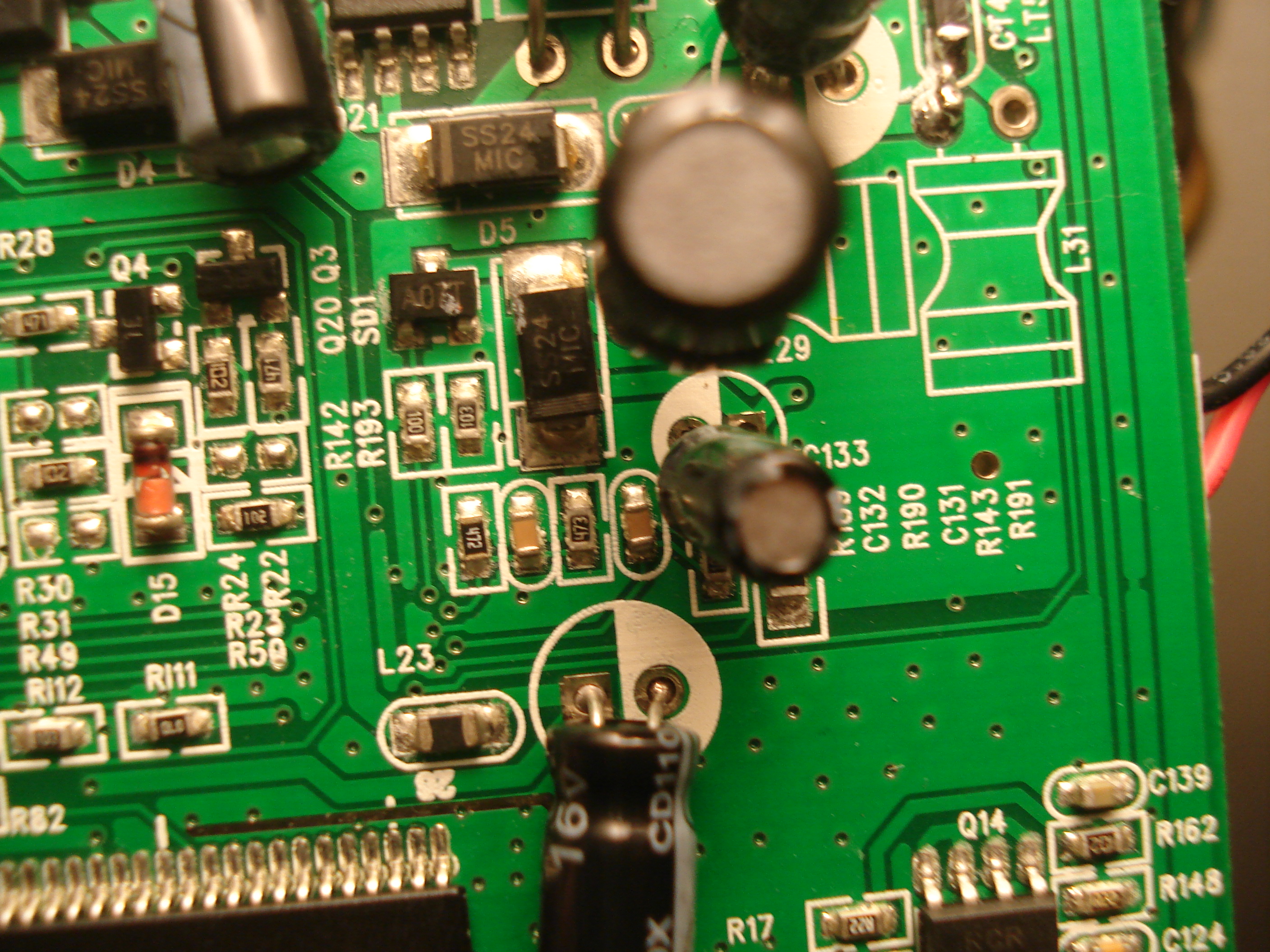

                          you are right. I do not see any transformer on it. I think led on this unit. But LED not working as back-light. LCD panel works though as I can see image with flash light. I will take more pictures and post it.
                            The must be a regulating power supply close to that connector, just need take a close look in that area.
                            Can you measure any voltage on those two pins of the connector? They will more likely to put the White LED in series, so if one goes out, it will kill the rest.

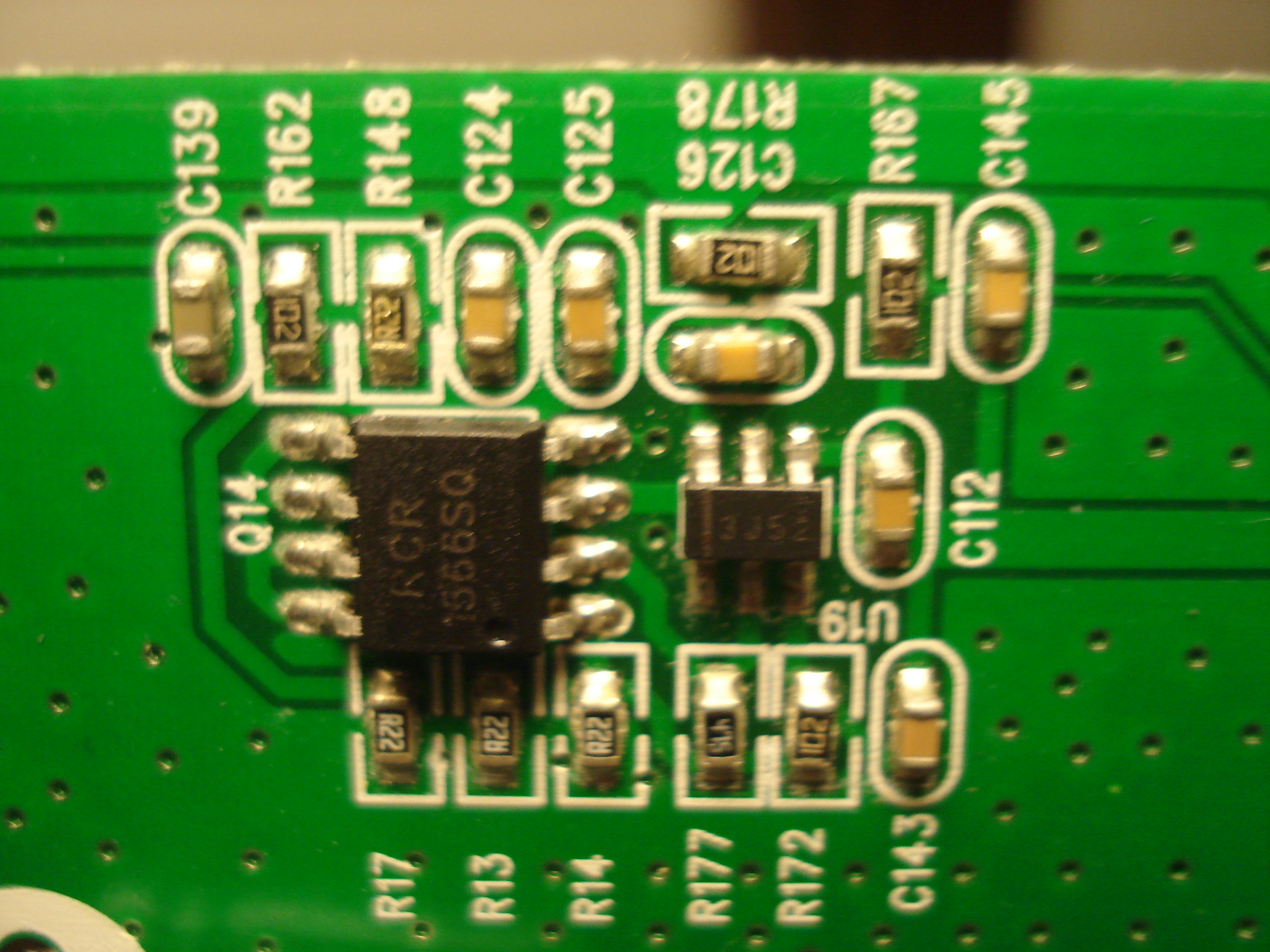

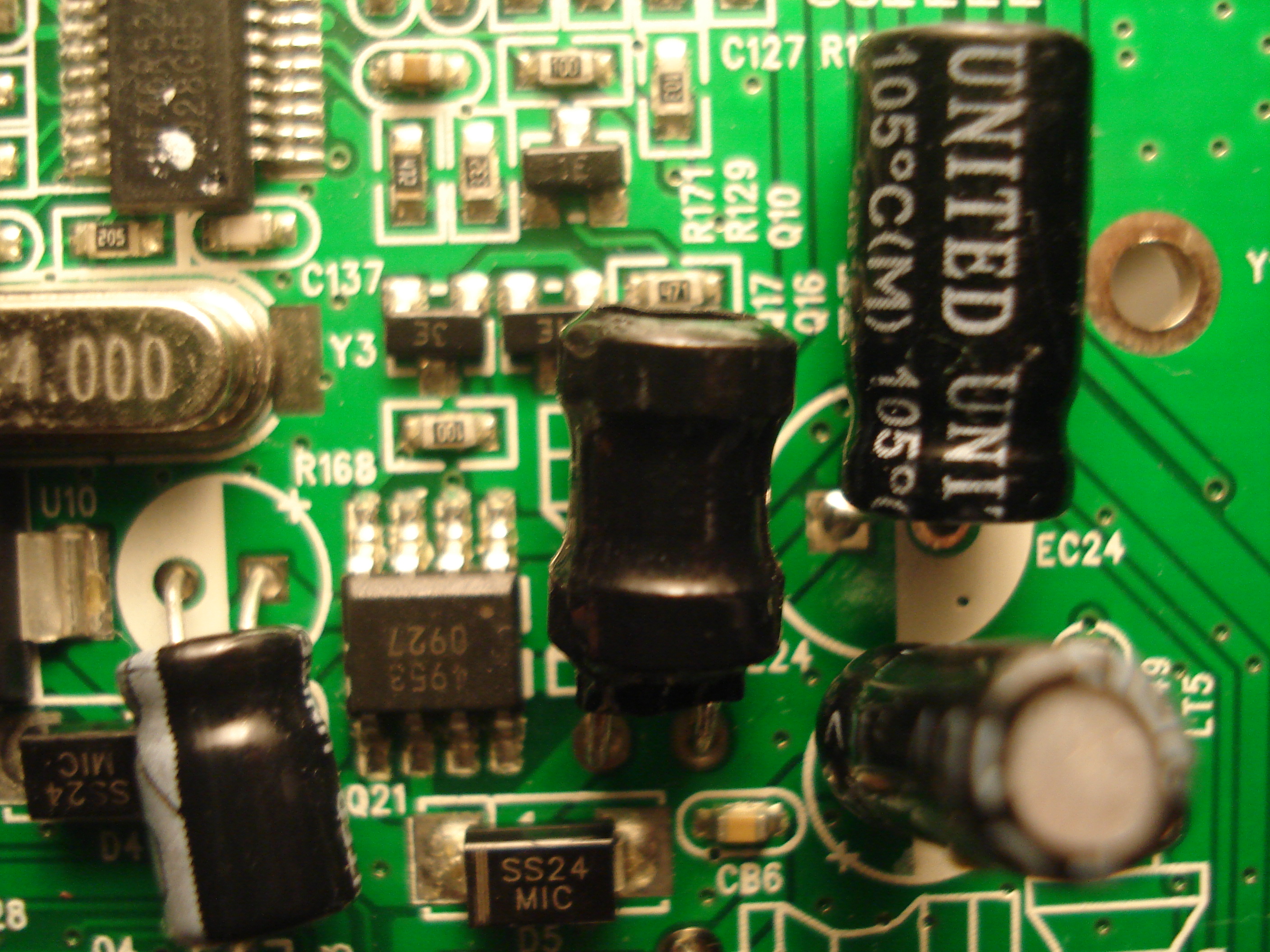

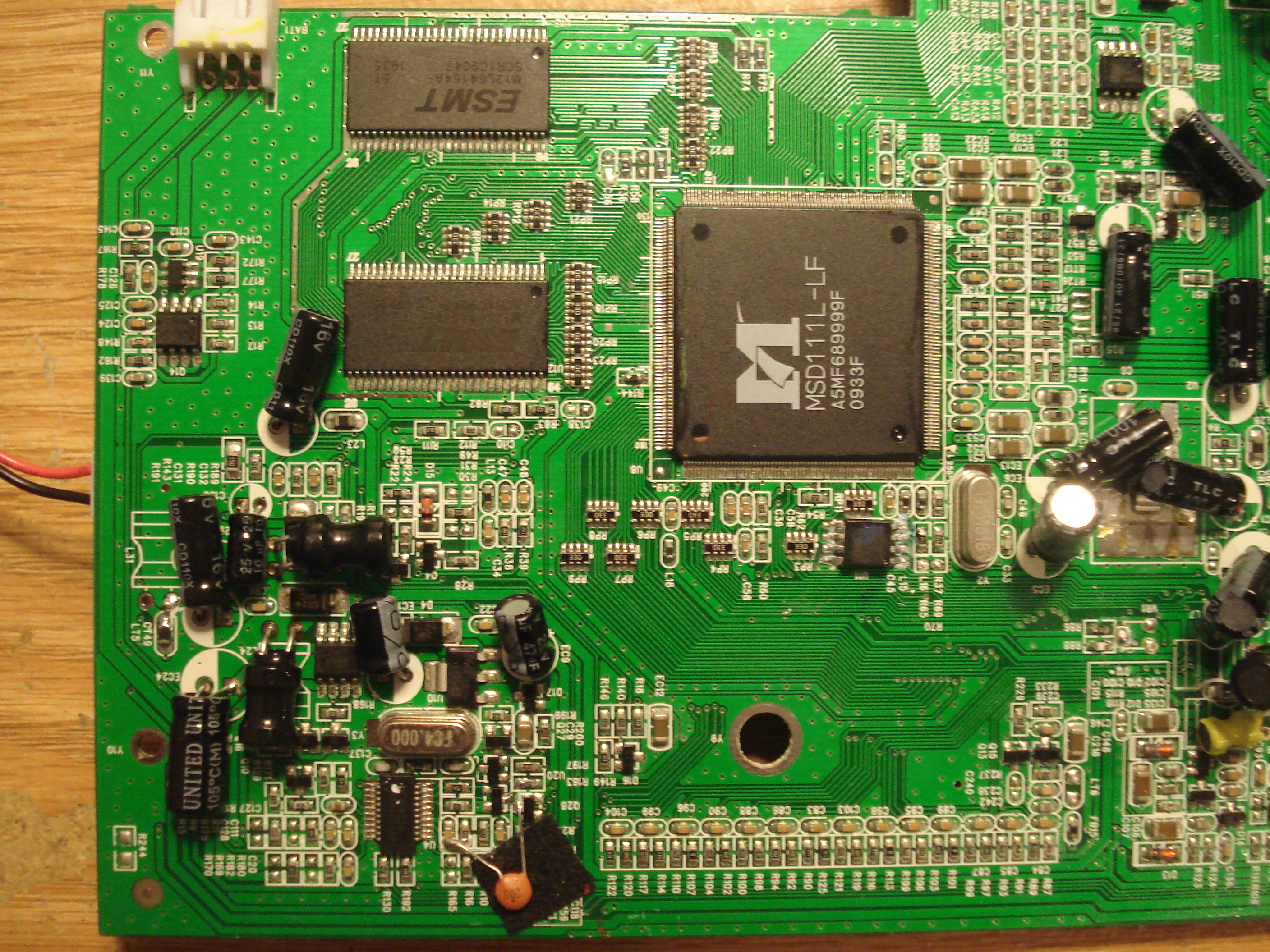

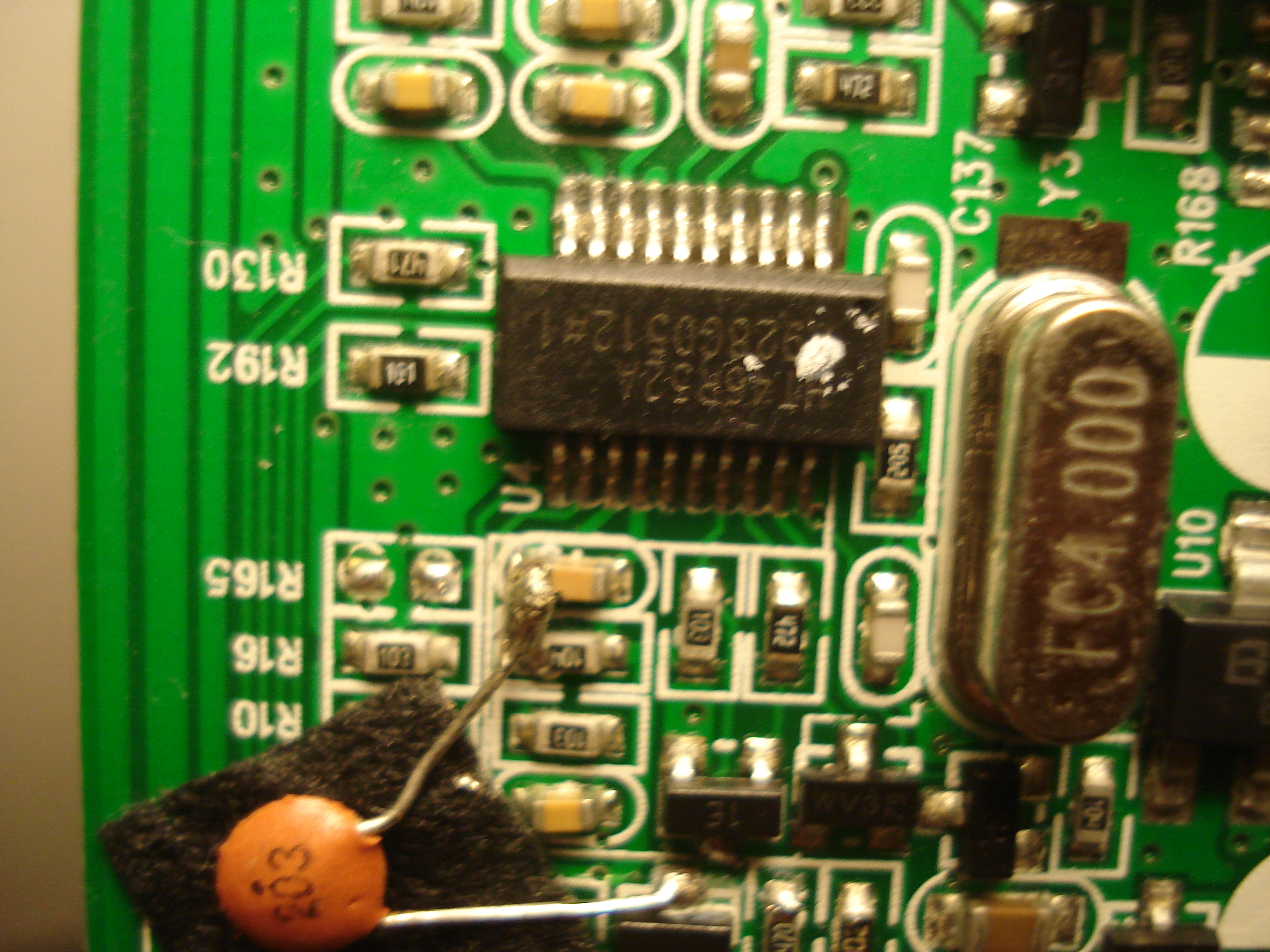

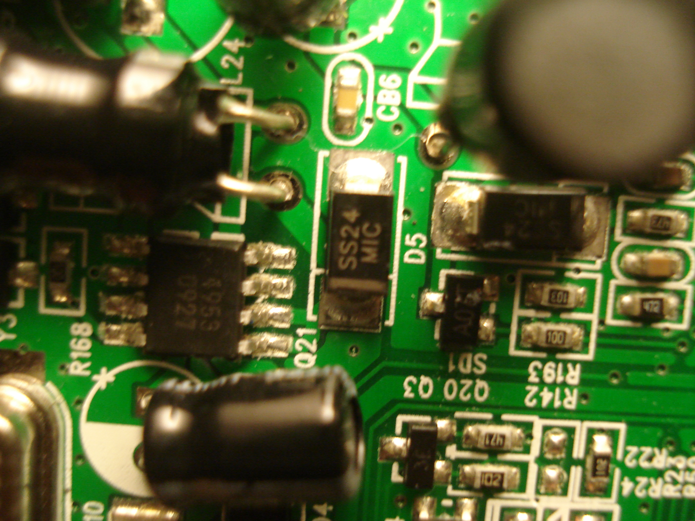

                              I do not see any voltage regulator on the main board or lcd panel. All I see some IC , capacitors, resistors. Please check the board.

                              • heavymachines
                                • Mar 2011
                                • 1028

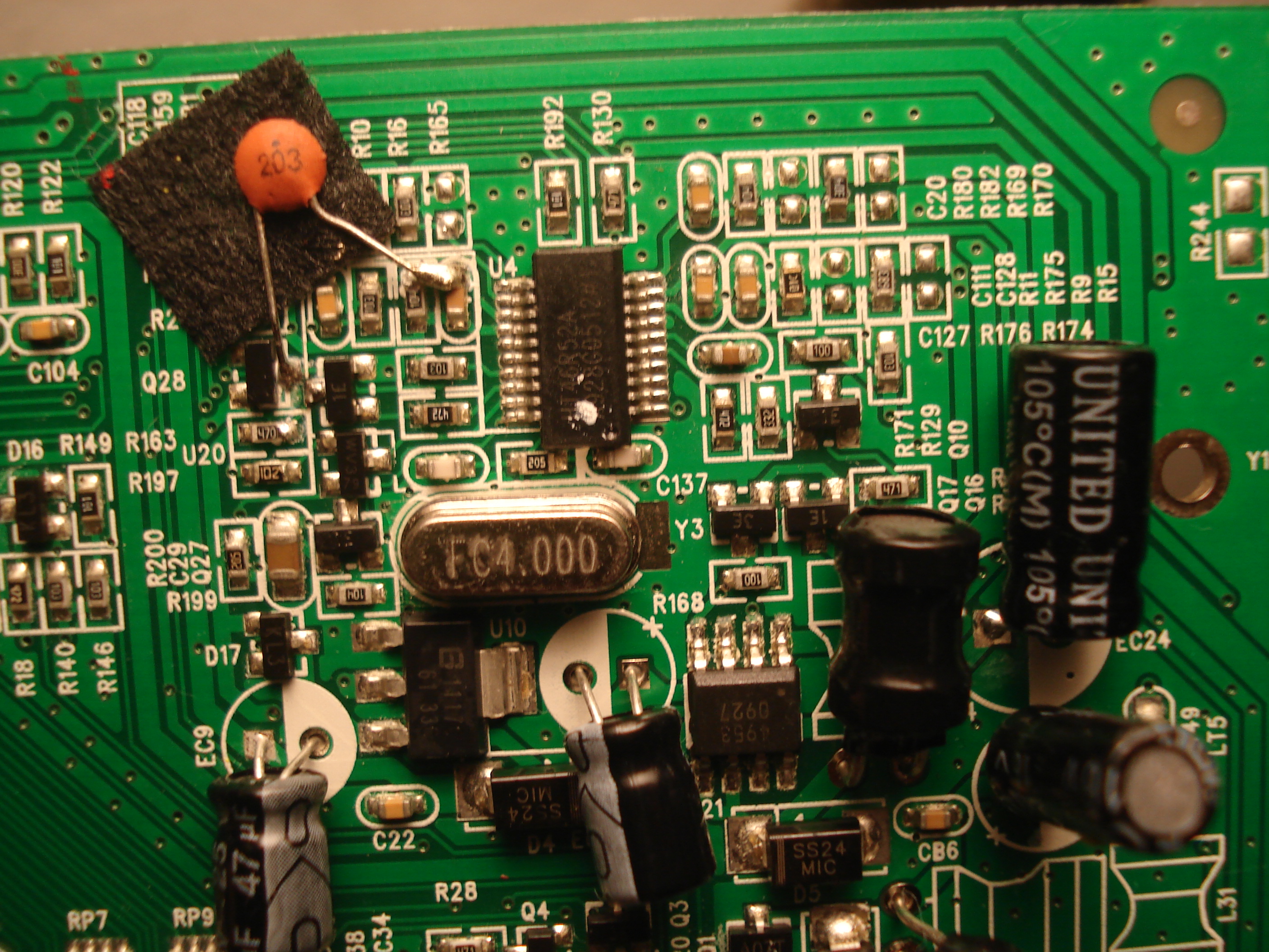

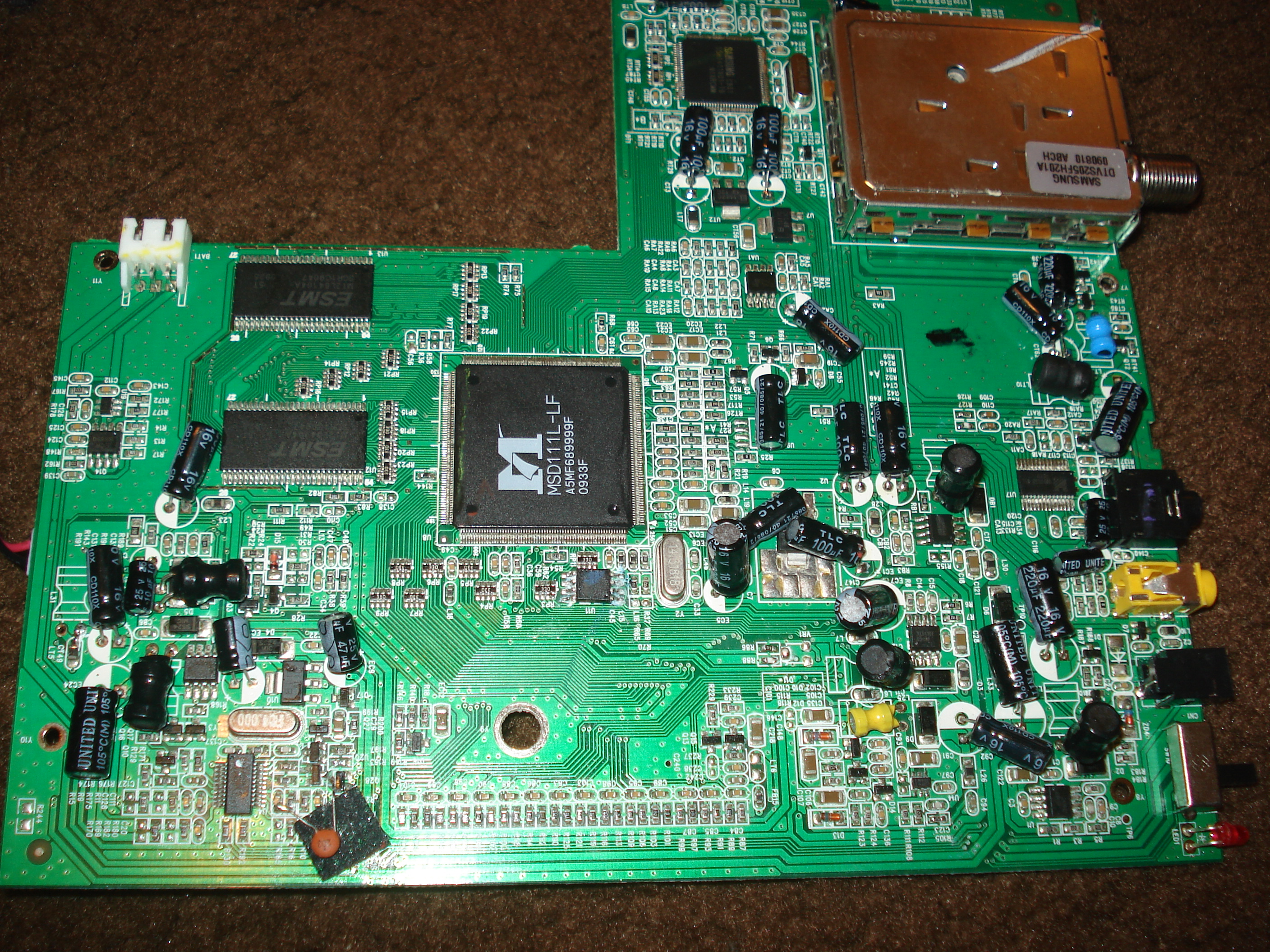

                                Voltage regulator circled in red...

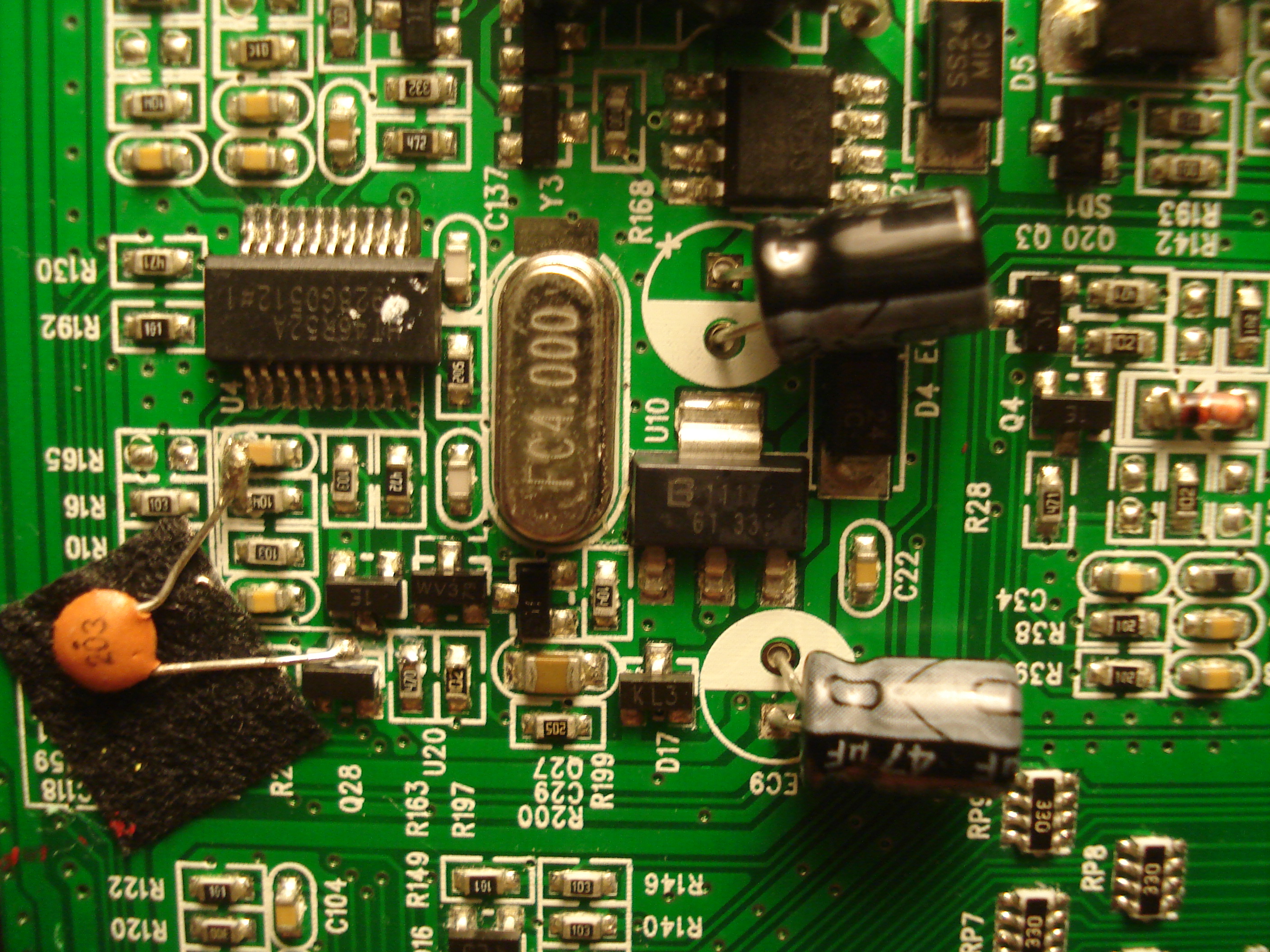

                                  Please see the attached picture.
                                  • heavymachines
                                    • Mar 2011
                                    • 1028

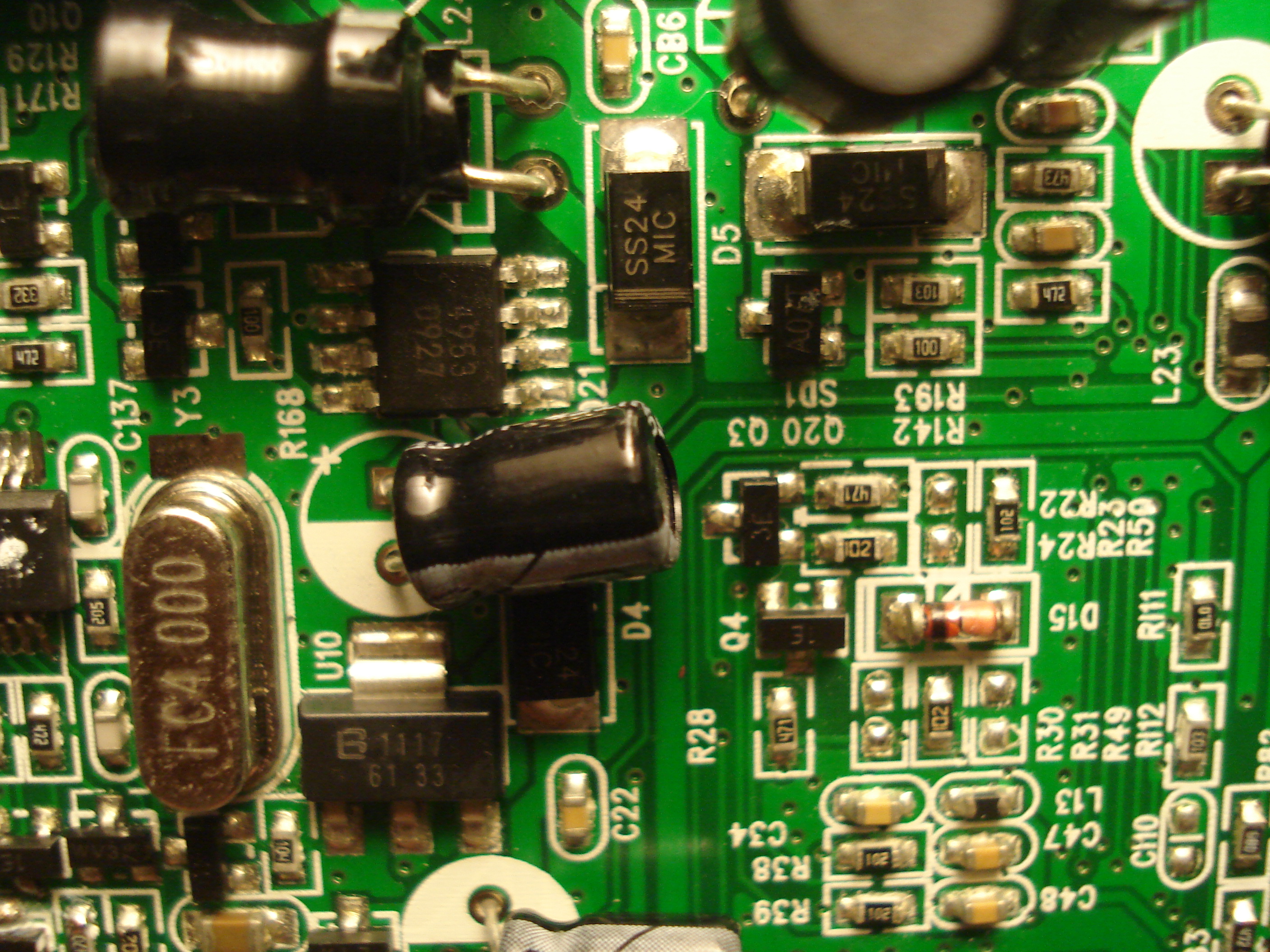

                                    looks like i might have missed one where 2 caps are laying on top of it. just helping along not an expert.

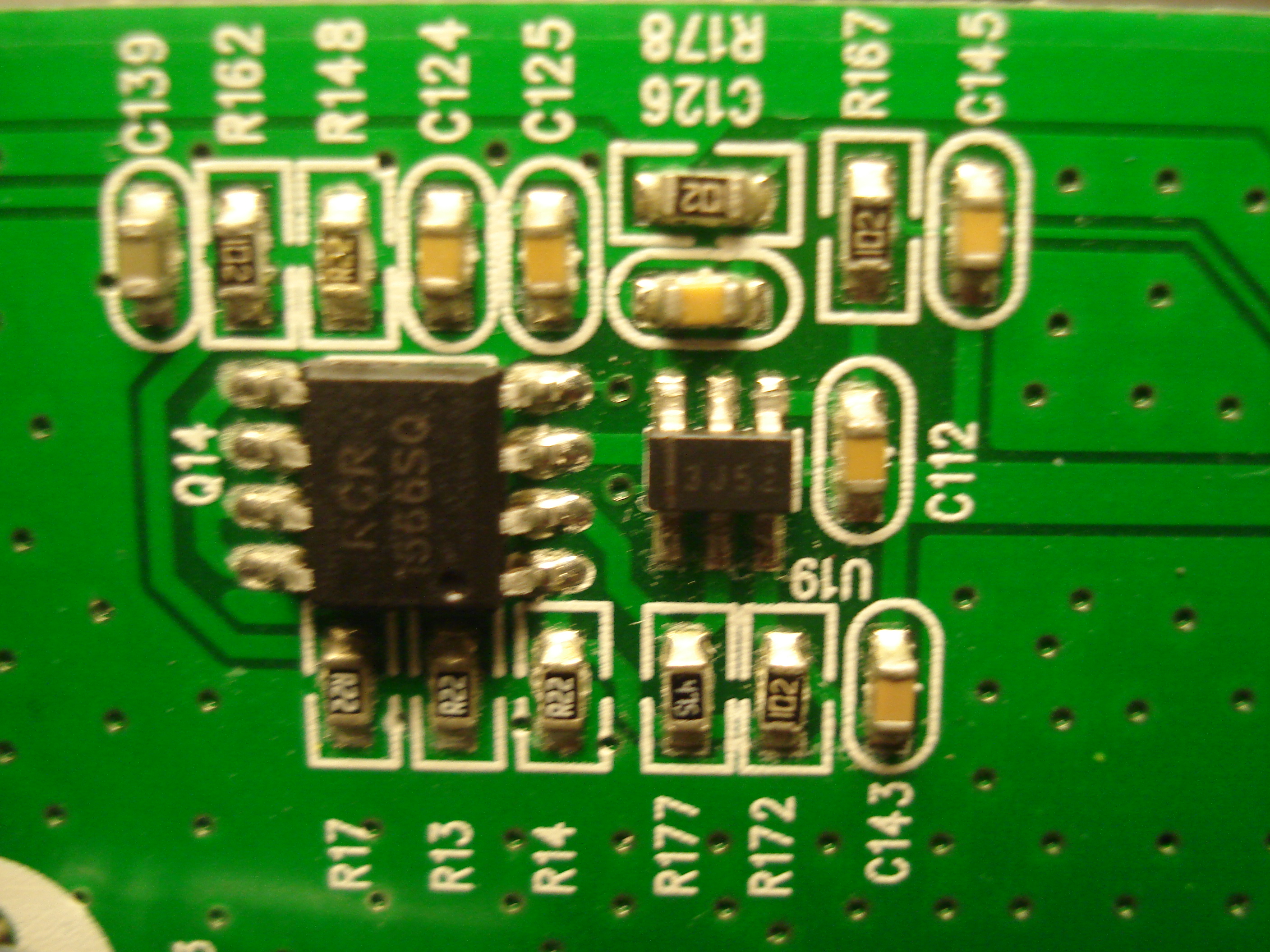

                                    • arman960
                                      • Sep 2012
                                      • 129

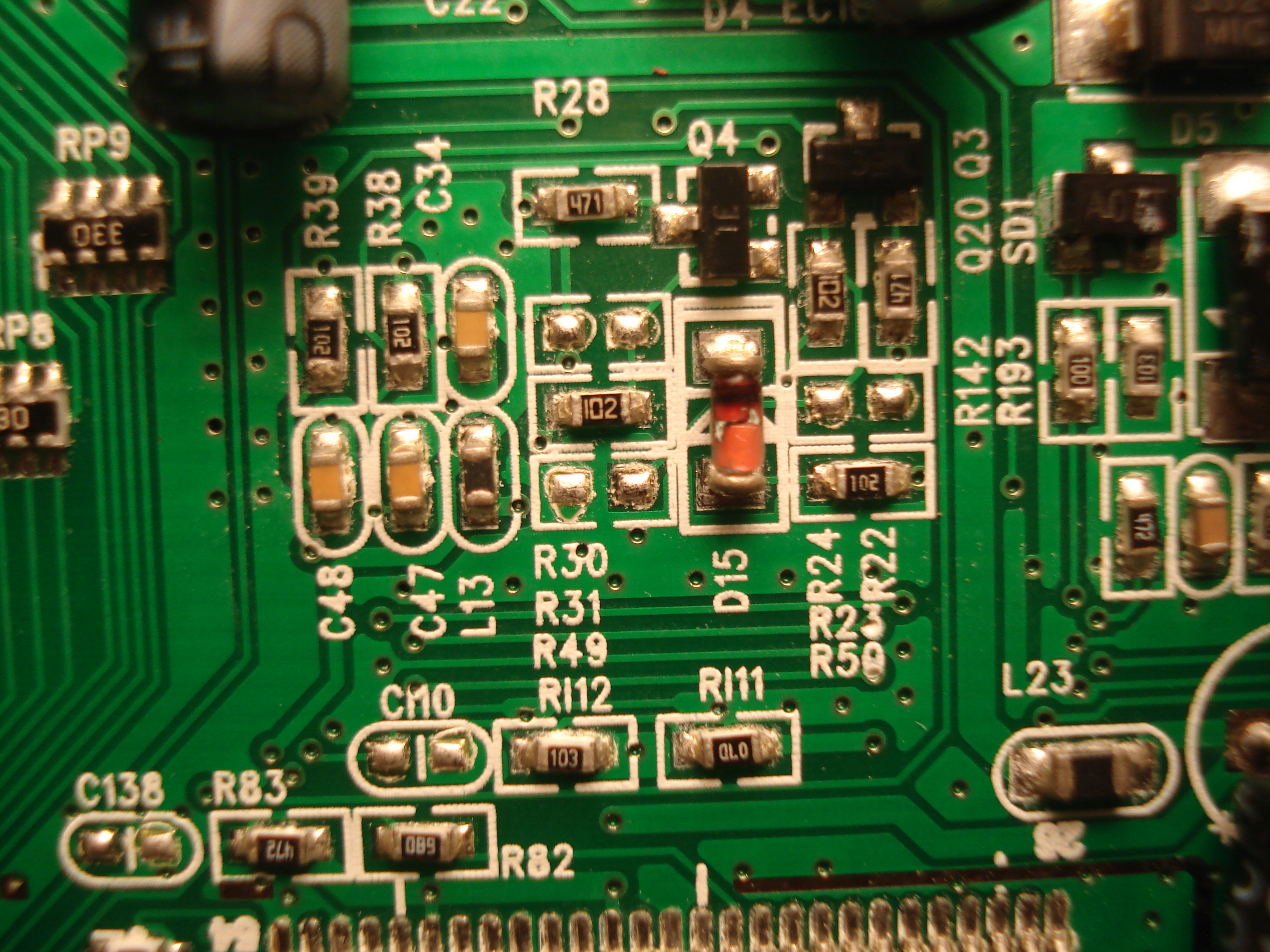

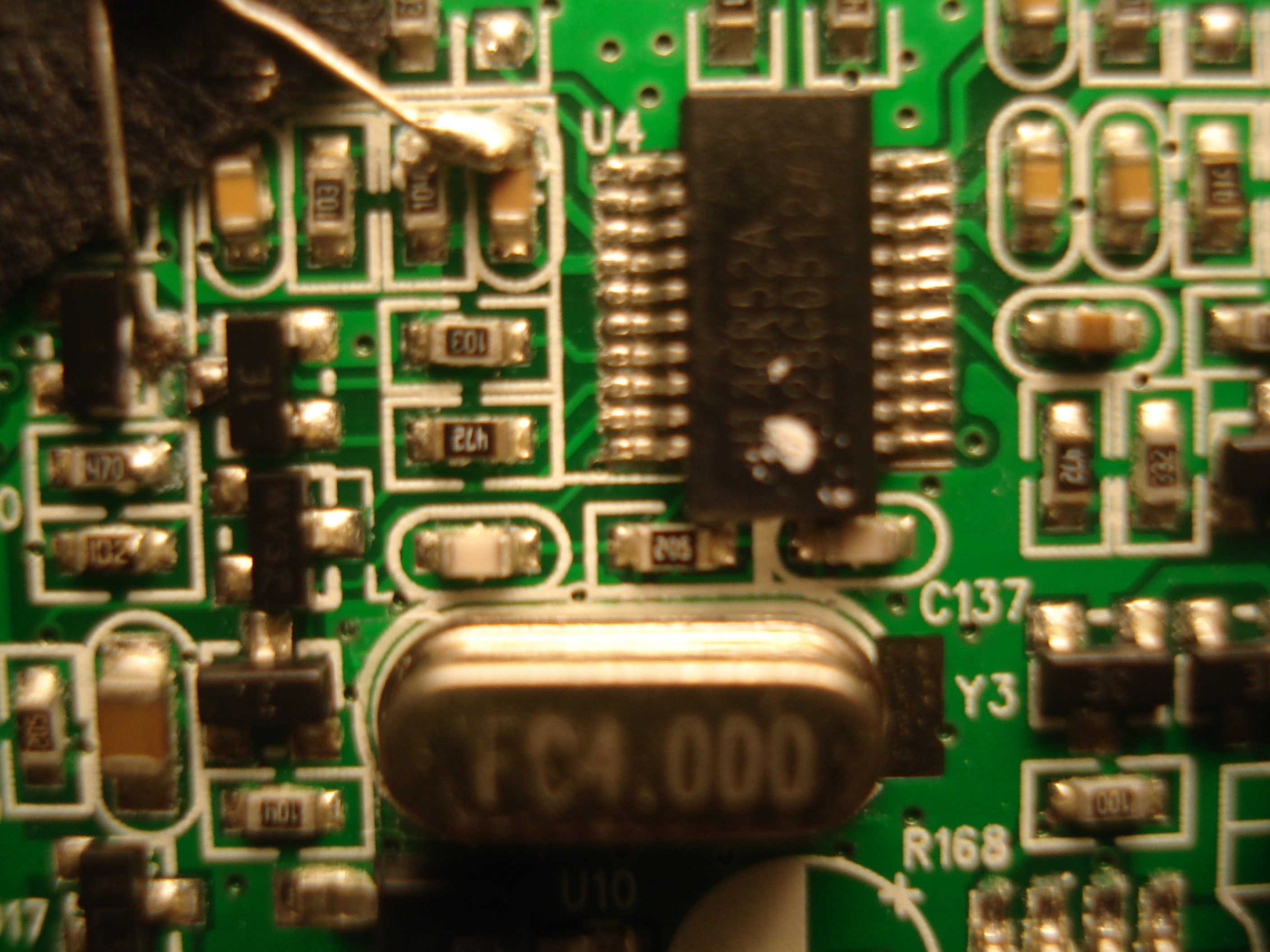

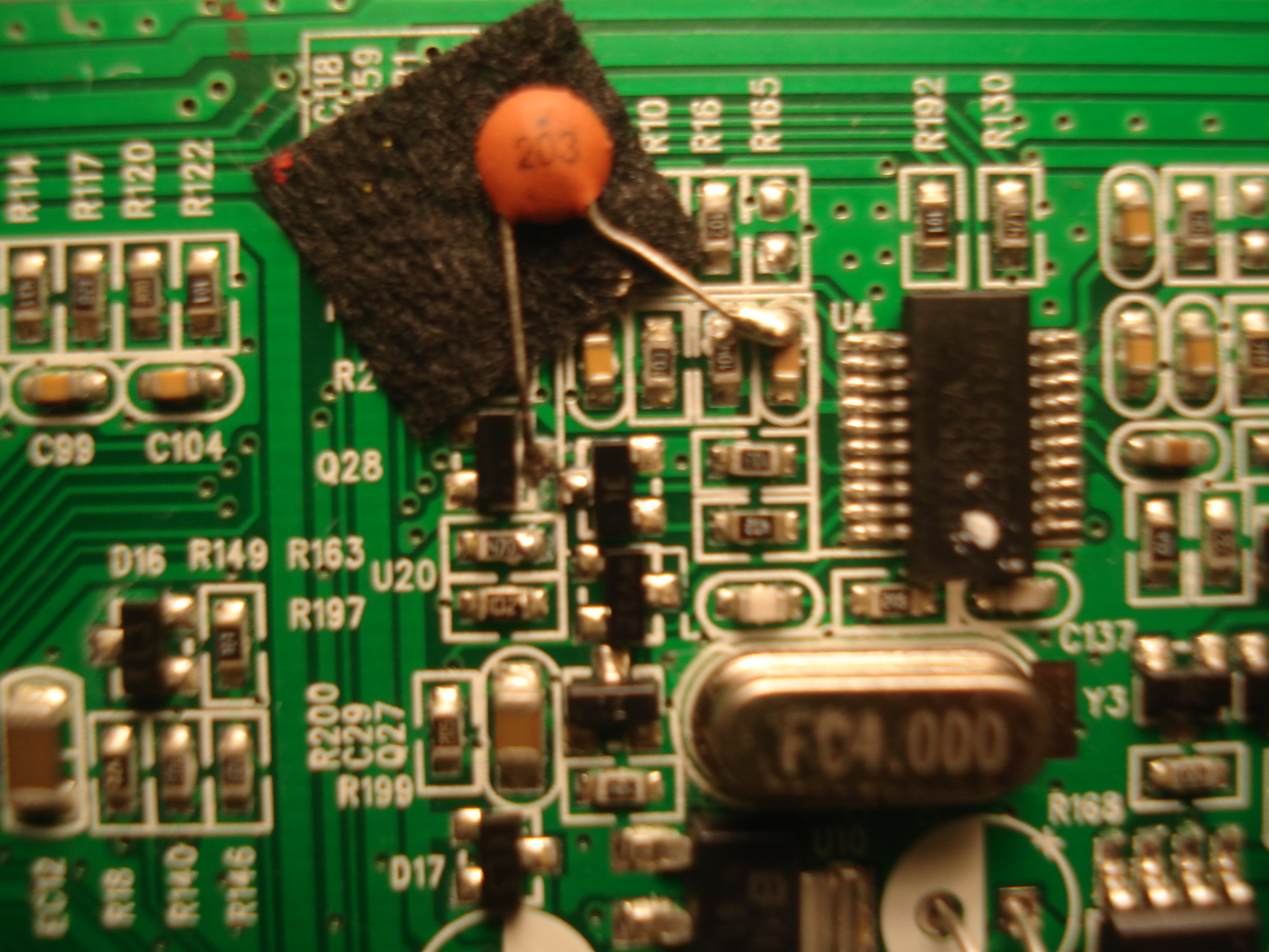

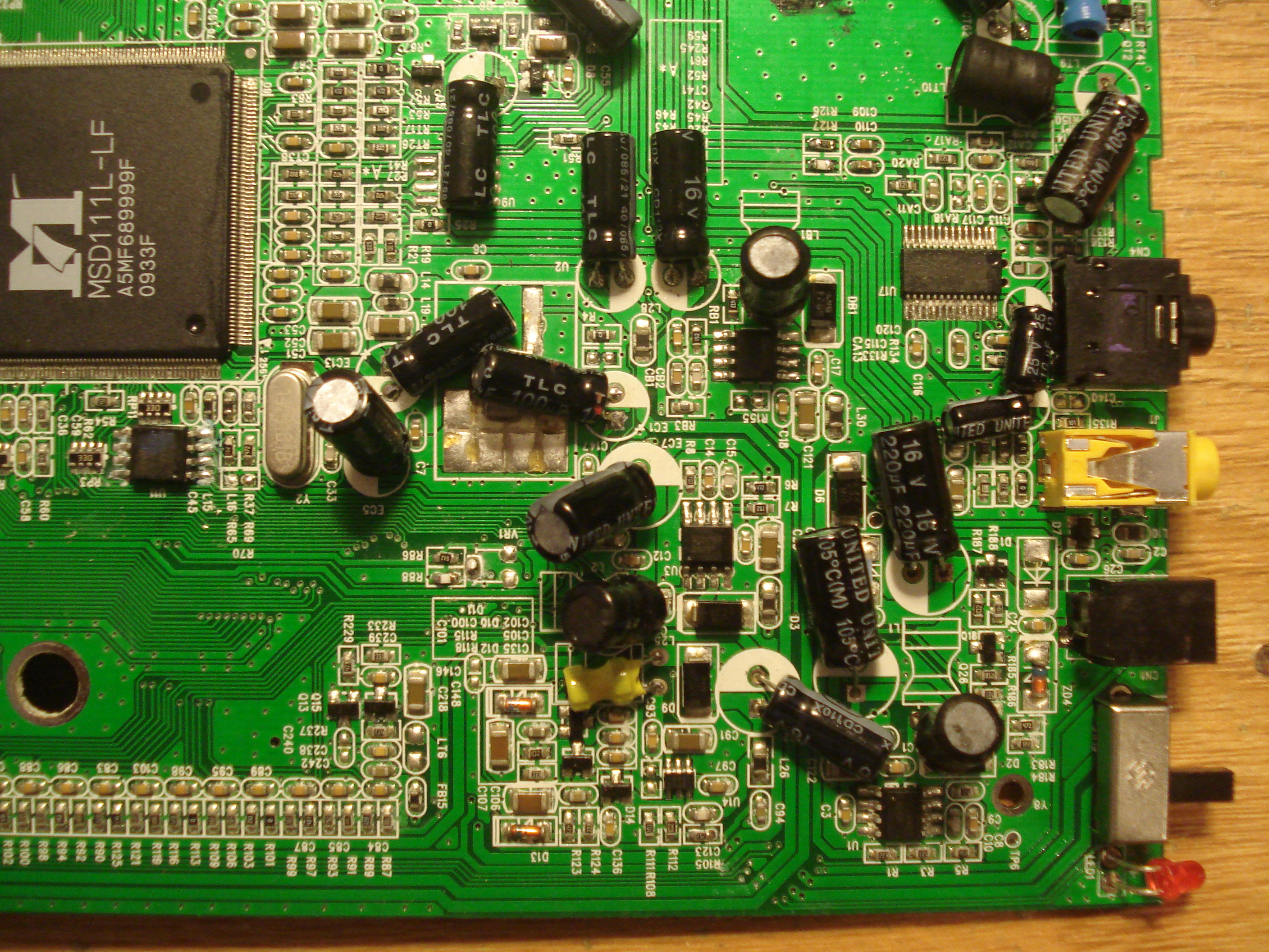

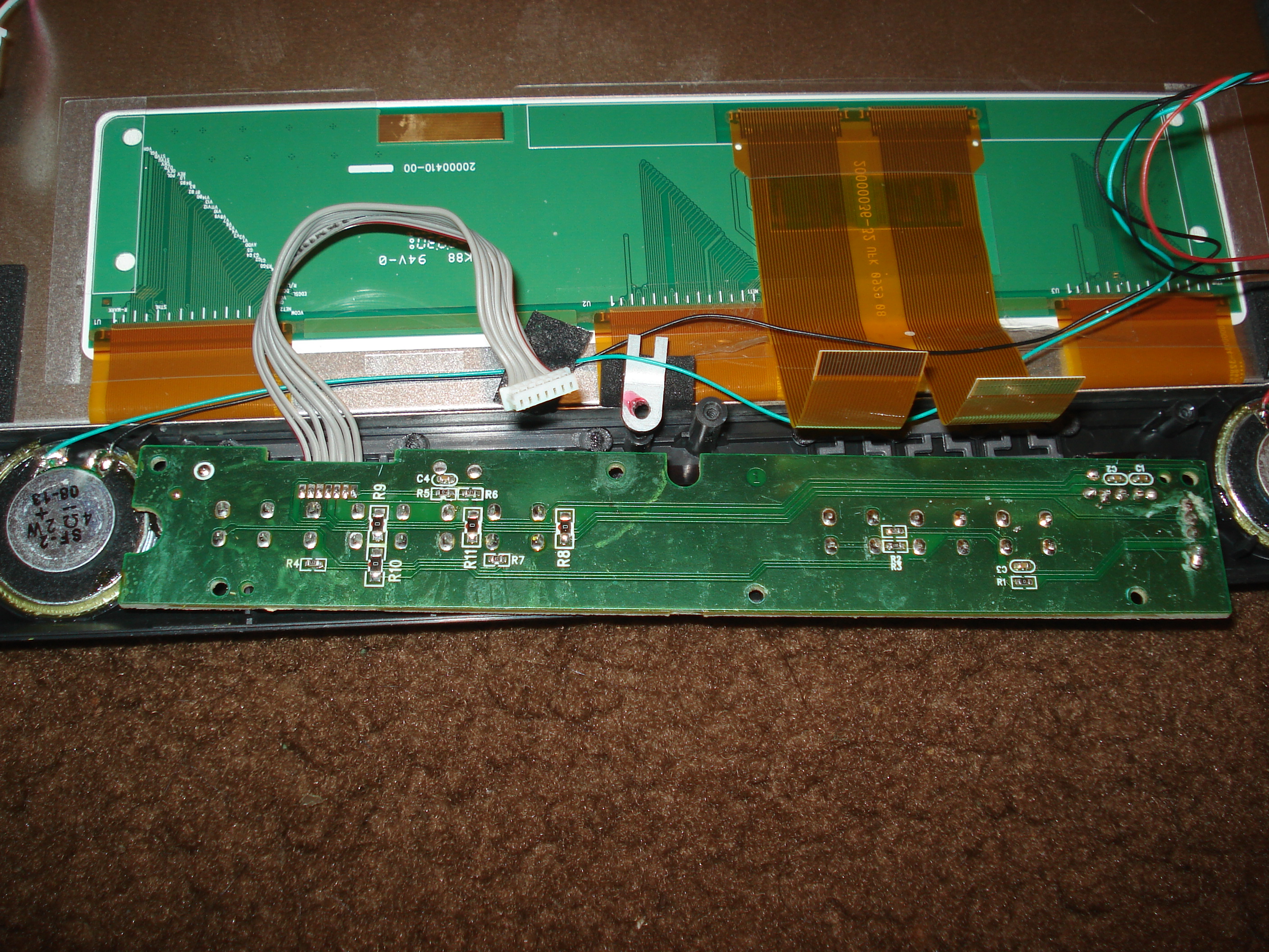

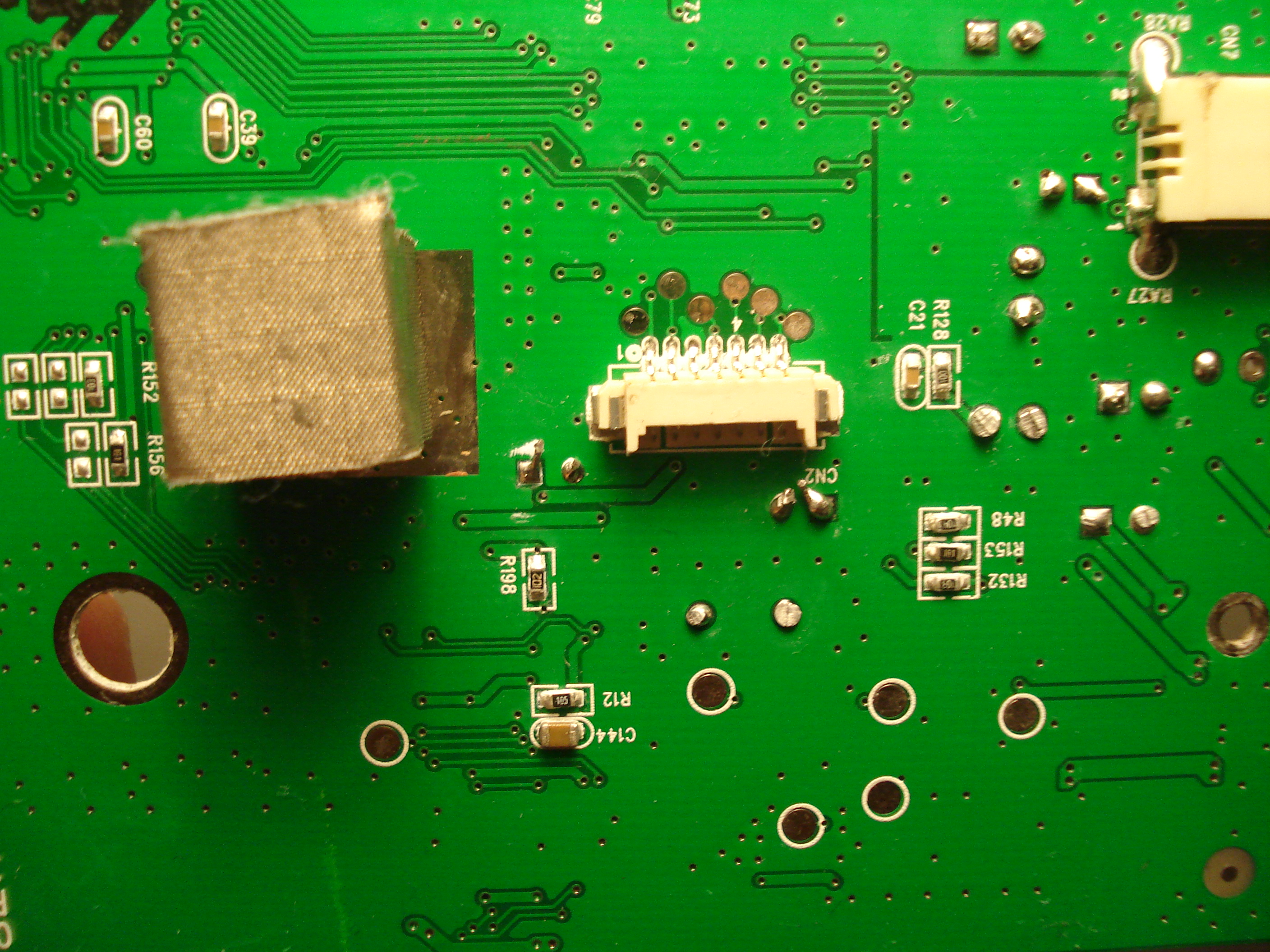

                                      Here is back and front side pictures.
                                      • arman960
                                        • Sep 2012
                                        • 129

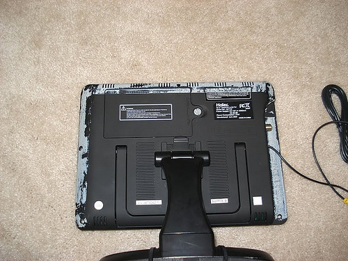

                                        More pictures of the TV
