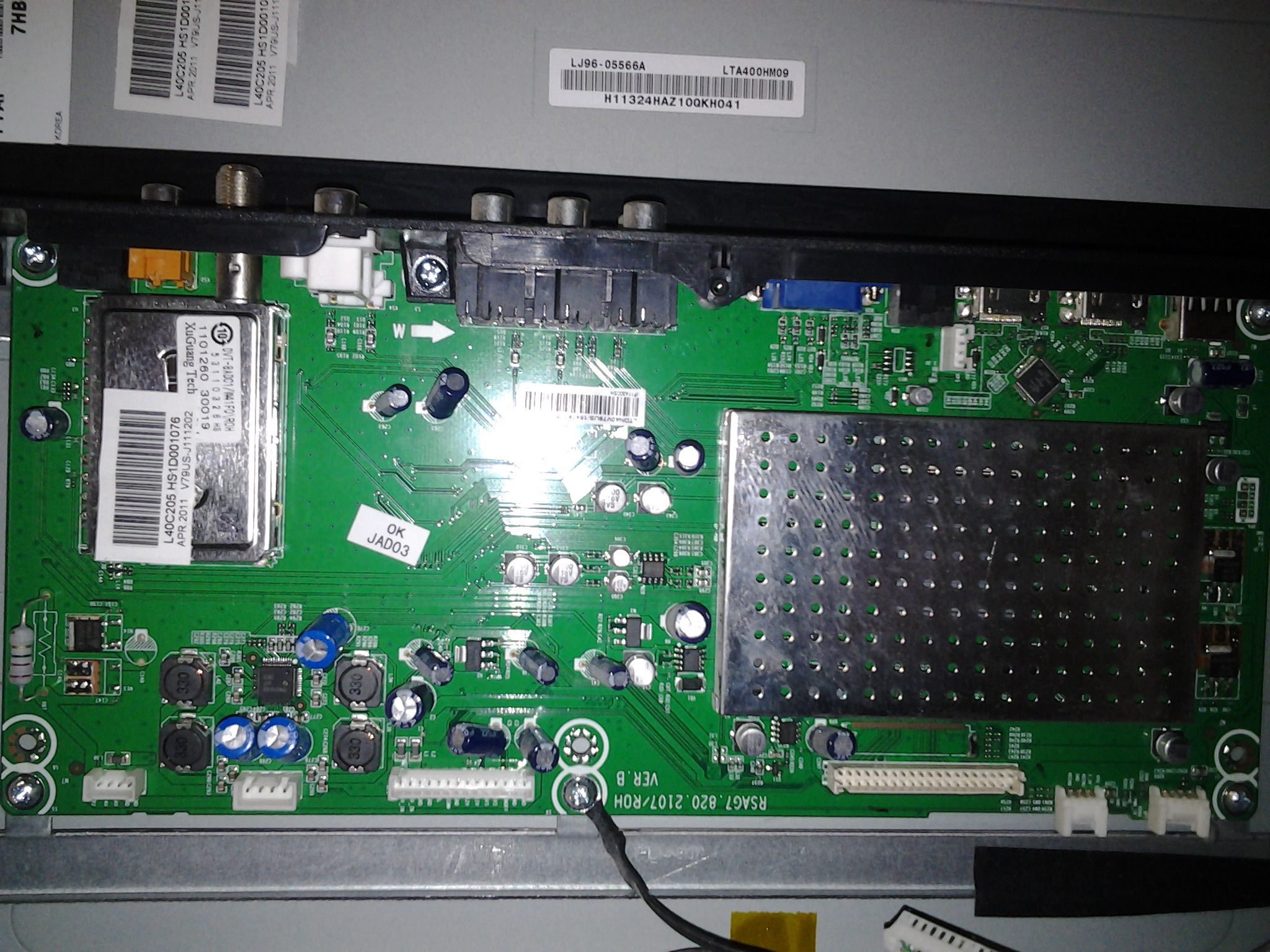

        Ok plugged all the connectors in. STB shows 2.09 volts and doesn't change when i "touch" power. Sw still shows no voltage. The mainboard is a rsag7.820.2107/ROH ver b. Any diagnostics I can run on the main board. I'll get part number off touch board and post a pic after supper.

          I would look at the main board then as the cause of the fault. For now we can assume the power supply is OK, it is doing what it is supposed to, as it is not getting any control signal.

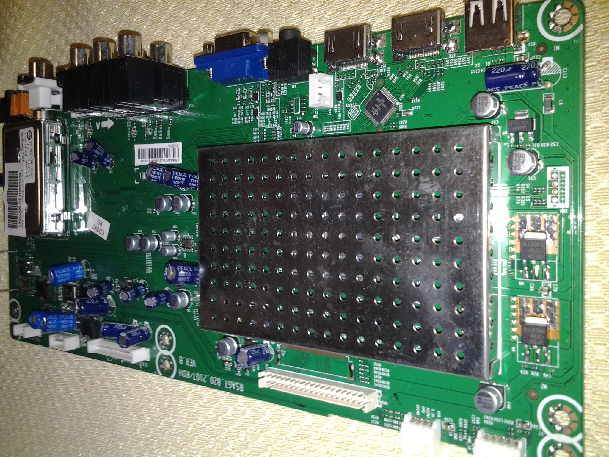

          Can you show us some pictures of the main board? - it's the one with the video inputs on it.

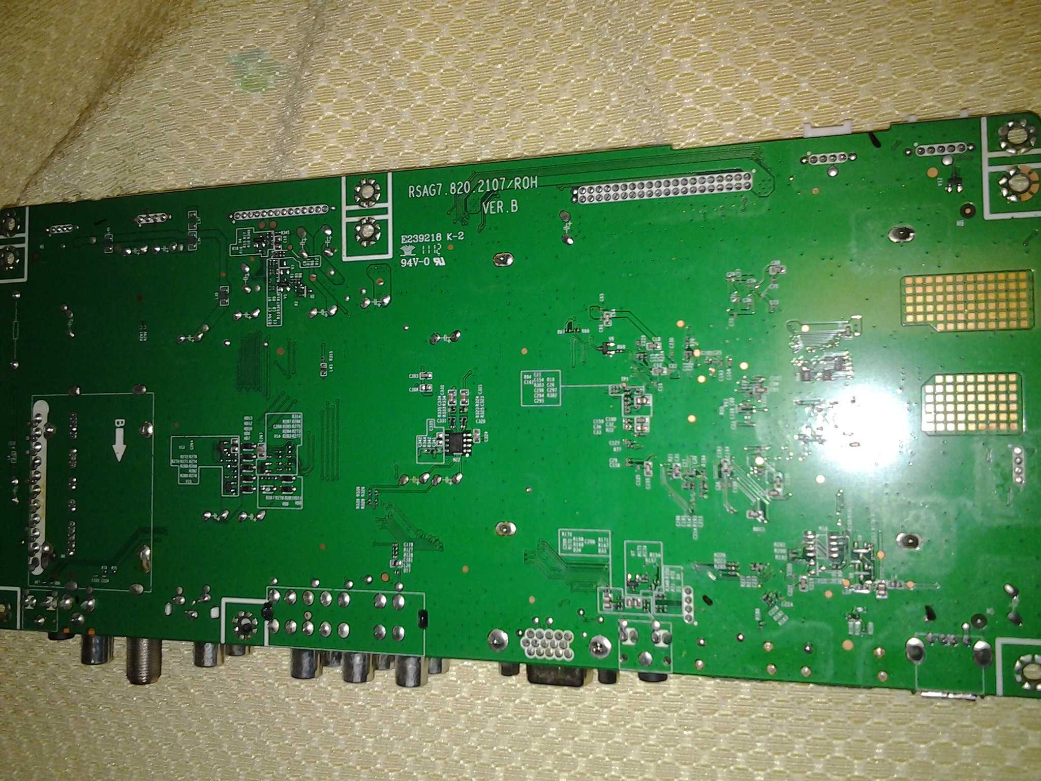

            post 18......let me know if ya need better shots of it.....ill pull it out in a few.
              Re: hitachi l40c205
              Mainboard.
                Re: hitachi l40c205
                let me know if ya need better shots or need to see a different area of board.
                  Re: hitachi l40c205

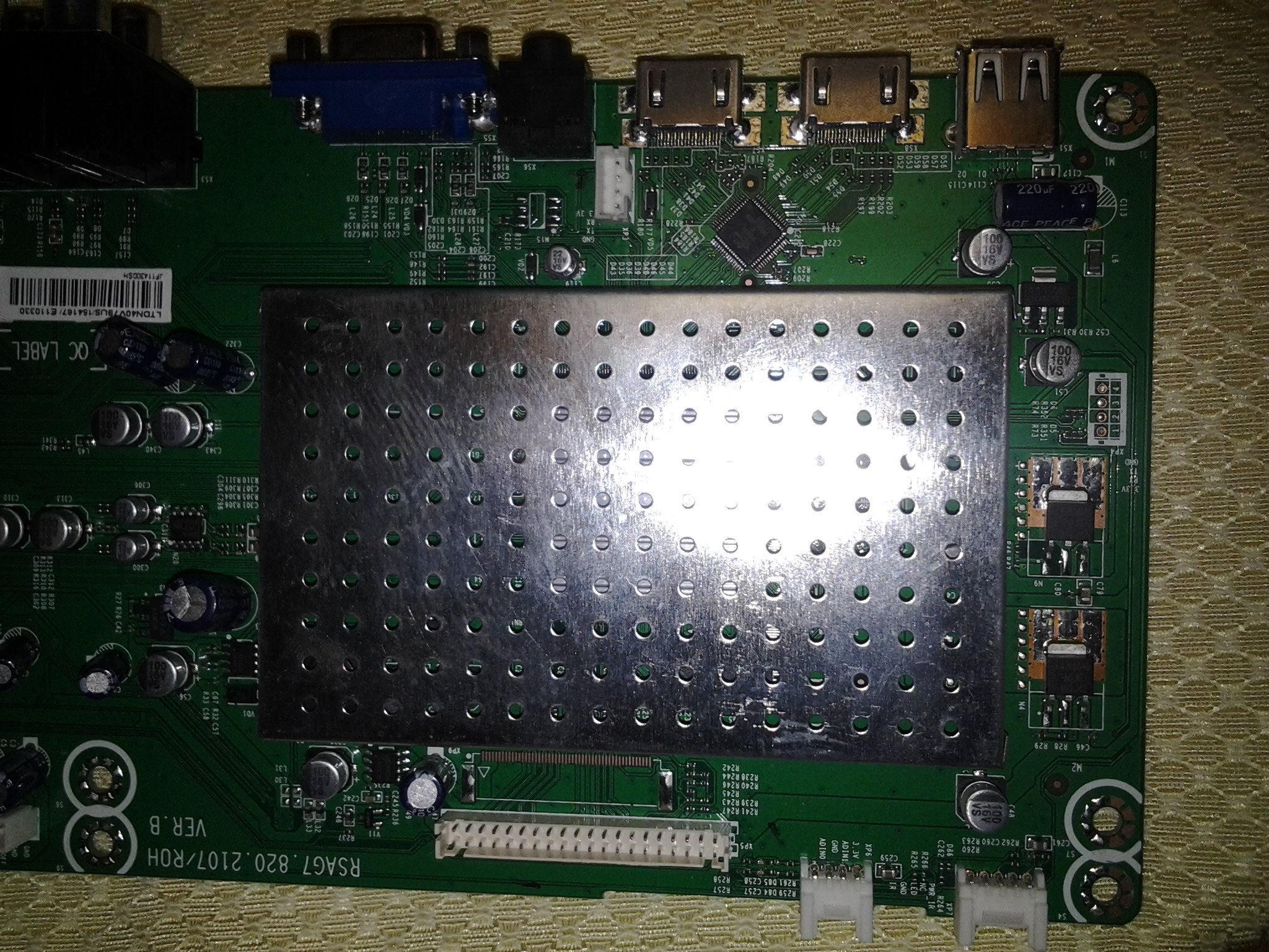

                  They're fine...

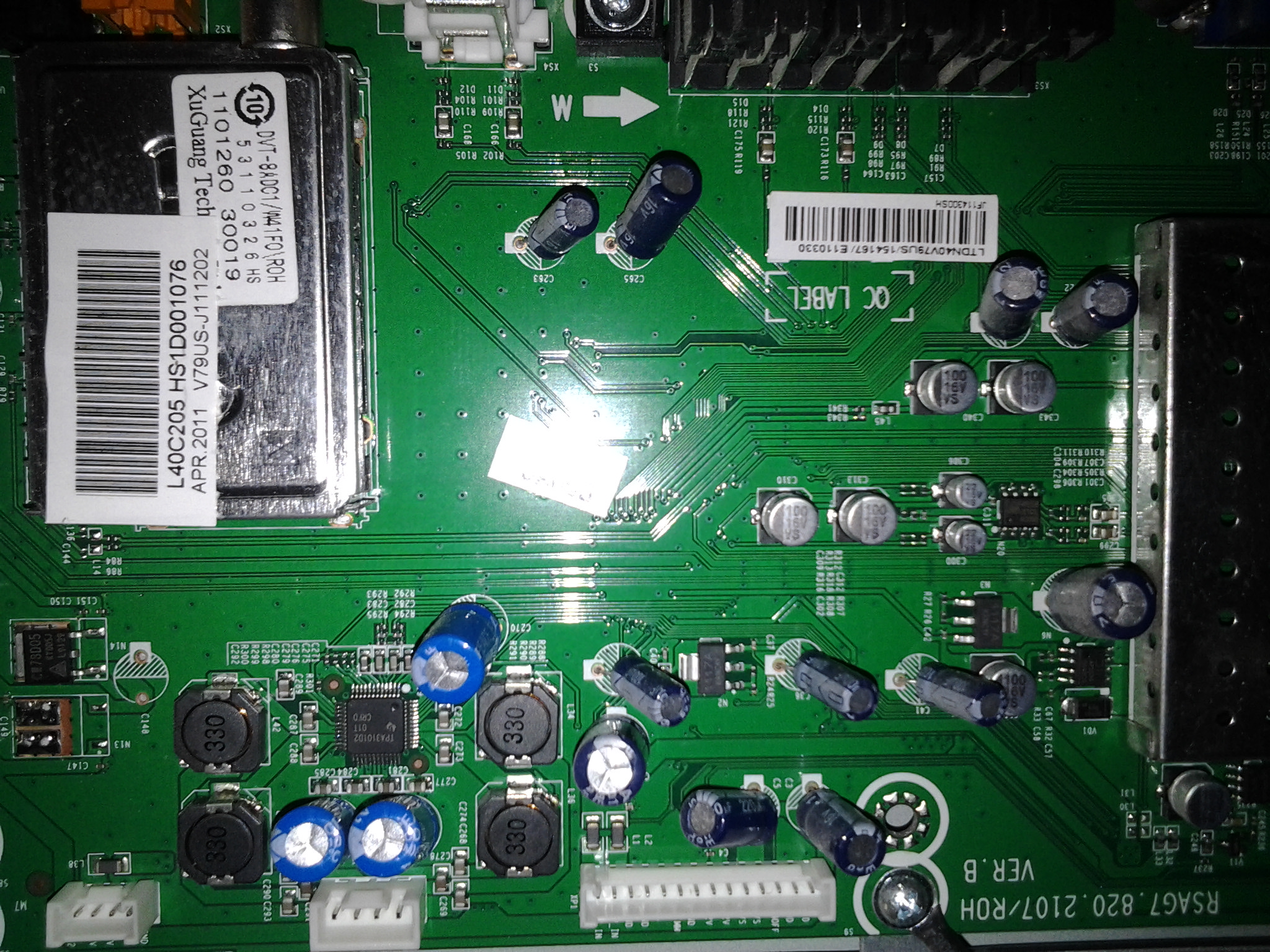

                  I've highlighted some voltage regulators with a red dot.
                  Set the board up in the TV and connect everything. Plug it in.

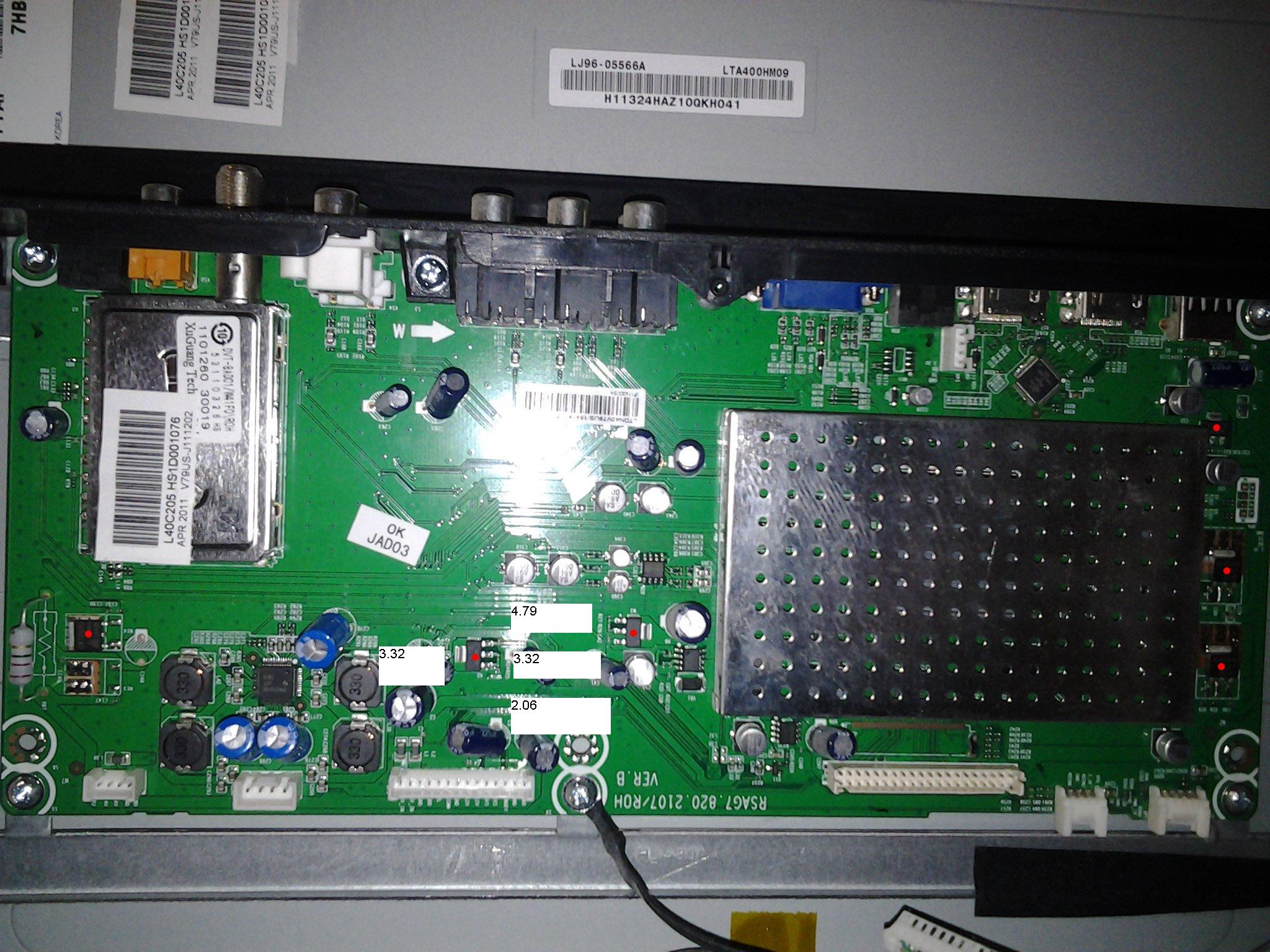

                  Set your DMM to 20V DC. Place the black probe in the frame/chassis of the TV or other good ground point. Touch your meter on each leg of the regulator, including the big tab. Note down the voltage reading, along with the identifier (for example "U7" or "IC33") and part code (for example "UMC1117-33".) Post your results; we're looking for a regulator whose output is too low.

                    This is the only one that has any voltage. I get the numbers in a few.
                      #30
                      Re: hitachi l40c205

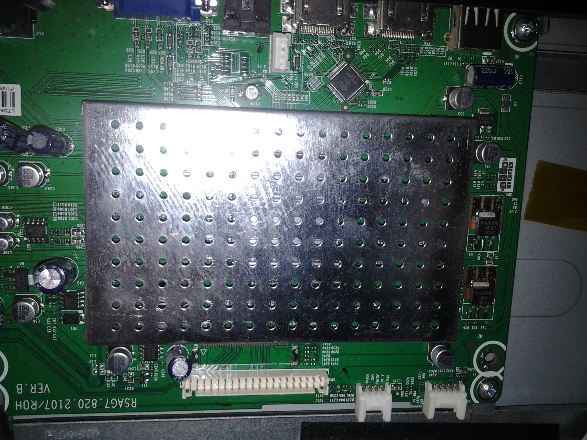

                      The regulator seems fine. The others - all pins measure zero or nearly zero? (<0.5V)
                      Is there any way to remove that metal shield on the board or is it soldered down?
                        #31
                        Re: hitachi l40c205
                        its soldered but i will remove it. ill recheck volts. Did you see pics of damage to orig power suppl1y ?

                          yes all pivs other than them are zero or nearly......2 show .02 volts

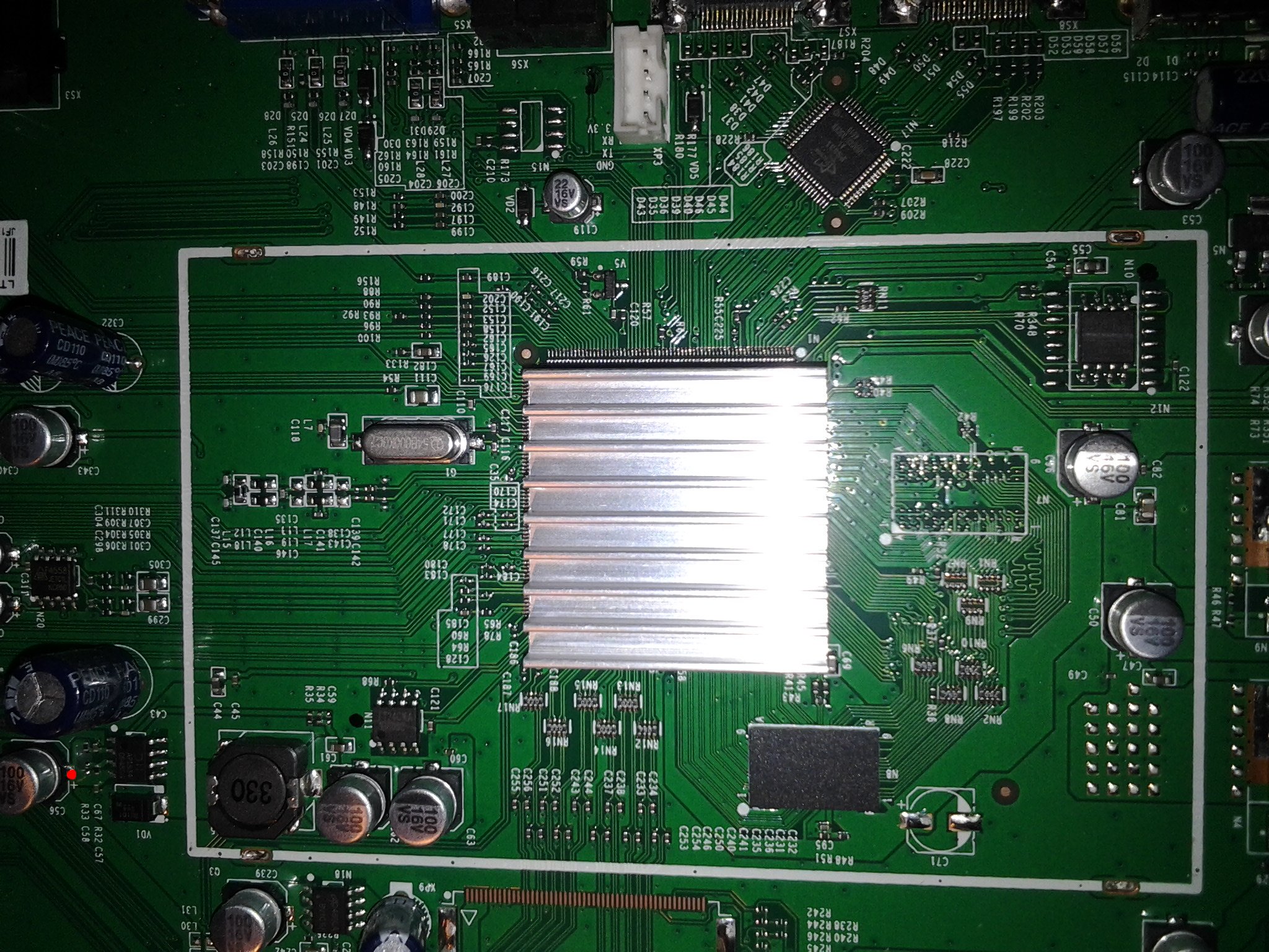

                              Under the shield
                                #35
                                Re: hitachi l40c205
                                OK, there is a switching power supply on the main board. It generates the power for the CPU. Check the voltage at the single pin I've indicated. Place the black probe in the chassis again for this test.
                                I don't know for sure what you should measure, but I'd guess from 1.2V to 1.8V.

                                  0 volts

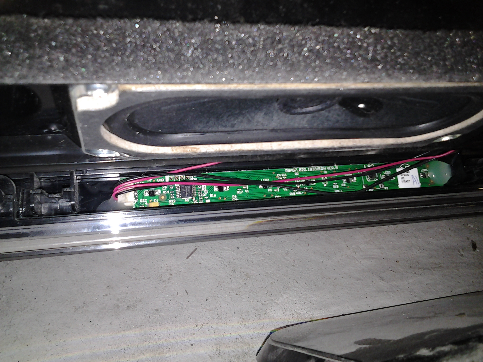

                                    Touch board
                                      #38
                                      Re: hitachi l40c205
                                      OK, check this too. Maybe it's not getting any input voltage.
                                      I suppose it could be the touch board. I will see if I can get schematics for this and figure out the right pin to jump to turn the set on.

                                        .02 volts

                                          rsag7.820.1833/roh ver b for the touch board
