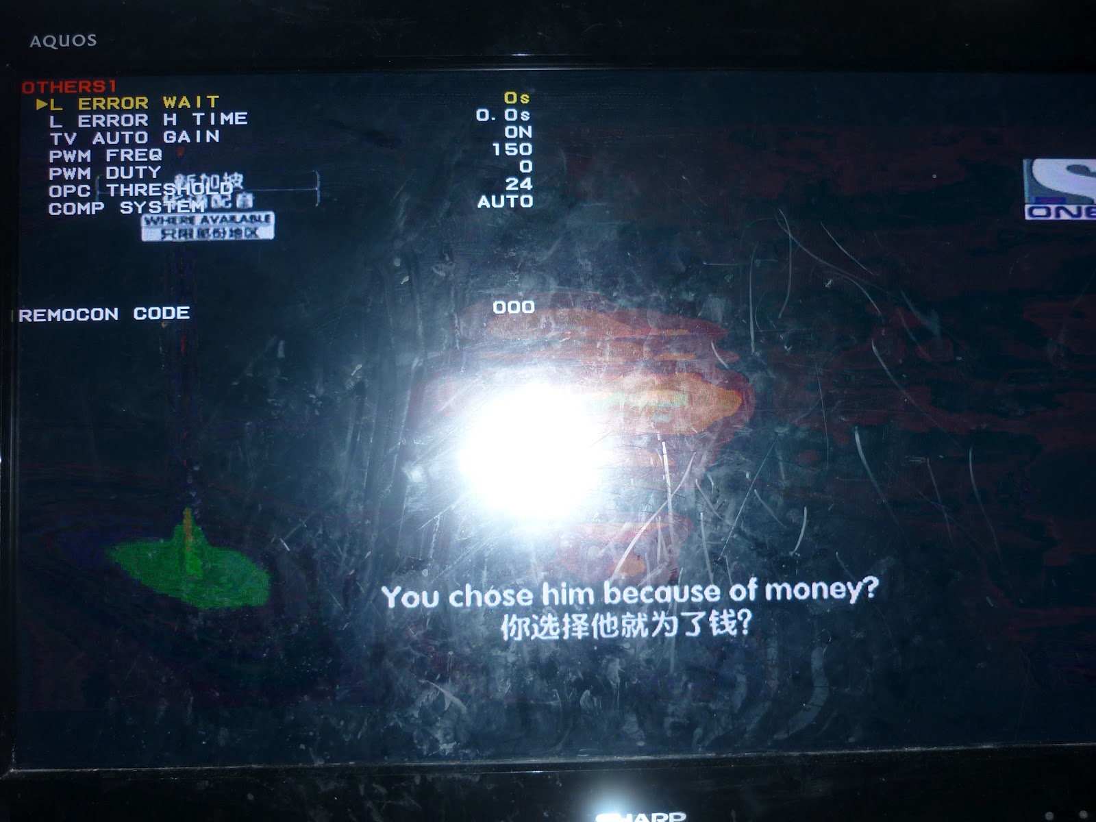

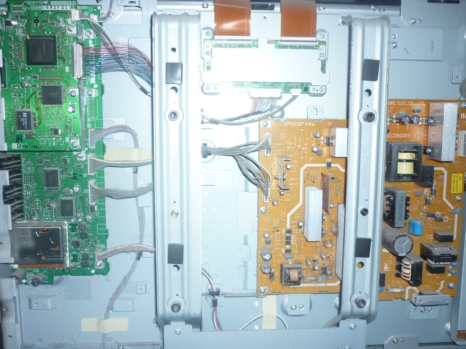

    Hai, to all, sifu, i have a problem with my TV LCD SHARP AQUOS 32 MODEL LC32-PX5M .
    The picture from my LCD panel is having problem.What the course of my tv problem simptom.
    Are bad T-Con card is the culprit for making the problem?
    For information, i already open the back cover panel, and tighten all LVDS and flex riben cabel, but the problem is still same.
    I also have reflow all chipset in the T-con card & the video card with rework station heatgun blower
    Hoping someone in this forum could guide me to repair the problem.TQ

    I had similar picture problems with a Sharp TV, though it was different from yours, it was solved with a simple reset:

                Hi, tom66, tq for answering,.To all sifu & Tv LCD repairer, i have manage to get in to diagnostic & testing mode in my TV system, but i cant find any reset function for the system, please help & guide me to troubleshoot this problem.

                  I can't see anything either... does the distortion affect all inputs, and does it affect the menus such as the setup menu? Do you have the service manual for this set?

                    Hi, Tom66, yes the video problem affect to all input (DVD, satellite decoder input, TV analog input).For the setup menu, the color i think in good shape (red, yellow, blue is ok), only when display the video, the problem acquired.
                    I have the service manual for The TV but I cant find anything that is related to solving the problem.
                    Actually, this problem acquire, after my younger son play with video cable input & hdmi input cable at the right side of the TV.

                        For the setup menu, the color is good.I will attached another picture for the setup menu.

                            Is the video color inverted? It almost looks like animation.. Anyway we've seen a few of those inverted image problems on here but I don't think anyone found what was causing it.. Wonder if your HDMI port was damaged causing this..
                              Hmm, tq kevinm34232 for answering. This model has 2 HDMI PORT, but i have test it, same as other one.
                              The video port is also same problem to all port.If I can reset my TV to factory default can solve this problem?
