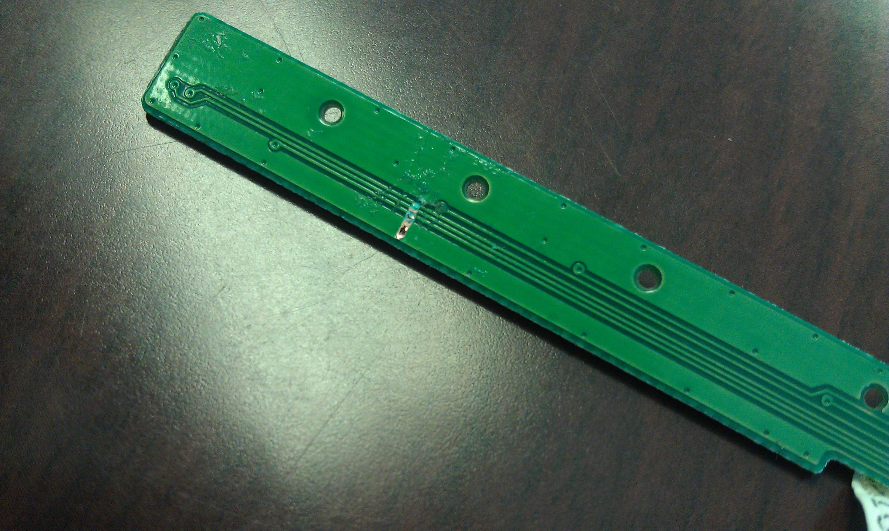

          Replacing the bad caps worked (damn ugly solder job but I can't believe it worked my first time trying something like this!). However, I forgot to put the quick release spring on the back of the monitor so I pried the plastic off again and put a heavy scratch right down the middle of the power button board in doing so. Now it doesn't work again.
          I can't seem to find a replacement power button board anywhere for this monitor. Any ideas where I can find one (with the ribbon that attaches to the power supply as well) for a Dell E177FPc online?
            Re: Dell E177FPc chirping, no picture, LED off
            You probably just cut one or a few traces on the button board. It would be possible to repair those traces with wire soldered between where they should connect.
              It looks like that's exactly what I did. The traces are too close together (for me) to solder a wire - I'd inevitably create a short for the two circuits.
                You can scratch off where I marked red to expose the copper (or platting) and solder a wire there and then connect it to the other side (wherever it is going)....I chose those spots for the slightly bigger surface area you can work with and less chance for shorting - might as well try since it is useless otherwise.
                  If you trace the circuits, you will also likely be able to just wire the switches on the front of that board directly to the connector or at least to a spot where you can solder on the appropriate traces.
