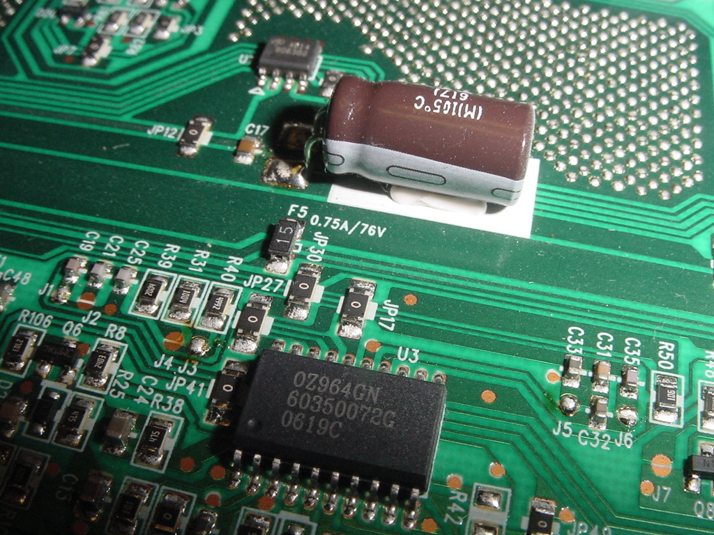

      Hi budm, you said the black F1 fuse might be bad. Do I have to remove the fuse before I jump it with wire?
      I have only 30w soldering iron. But I have ordered one 60w soldering iron. I have not received the fuse yet though. Will jump with wire anyways. But was not sure if it is necessary to remove the fuse or not.

          for now you can just jump the fuse with a piece of wire across the top of the old fuse i would probably use a piece of 3 amp? fuse wire this is only just to test you will still need to change the fuse if this works.
            #45
            Re: LG 42" LCD TV 42LG20-UM No video ONLY sound BAD inverter board or bad power boa
            There is not much room at the end of the fuse on this black fuse, yes that black fues is BAD. This fuse doe not have top solder ends like the white fuse that you can easily solder on the top of the fuse. You can add more solder to the pads to allow you to solder small wire to it.

                    budm, problem solved. You are genious. That black fuse was bad. I put one small thin wire to jump the resistor. But it was very difficult , because so small space. But I put extra solder to remove it just like you told me with one 60 watts soldering iron. Now I will have to order the surface mount small fuse from online.
                    Also I do not have the half darker screen at start-up either. Screen is bright all the way.

                        Thank for posting the result, the half screen brightness make sense due to only the Slave Inverter was trying to drive the lamp without the Master inverter working.

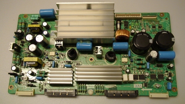

                          budm, have you worked with SANYO DP42746 Plasma tv?
                          I am trying to repair the Y-SUS on this board.
                            #53
                            I do not repair Plasma TV at all, too heavy to work on it by myself. Tom66 is real good at it.
                            • arman960
                              • Sep 2012
                              • 129
                              #54
                              yes tom66 looks knowledgeable in plasma tv. But he said he never worked with any board with IPM Y-SUS.This is my first plasma tv that I am working on. And according to copperville tv repair test it seems like my upper buffer board and Y-SUS is bad. I think palsma tv is too heavy and makes too much heat. I will never buy another plasma tv to repair. First and last one.
