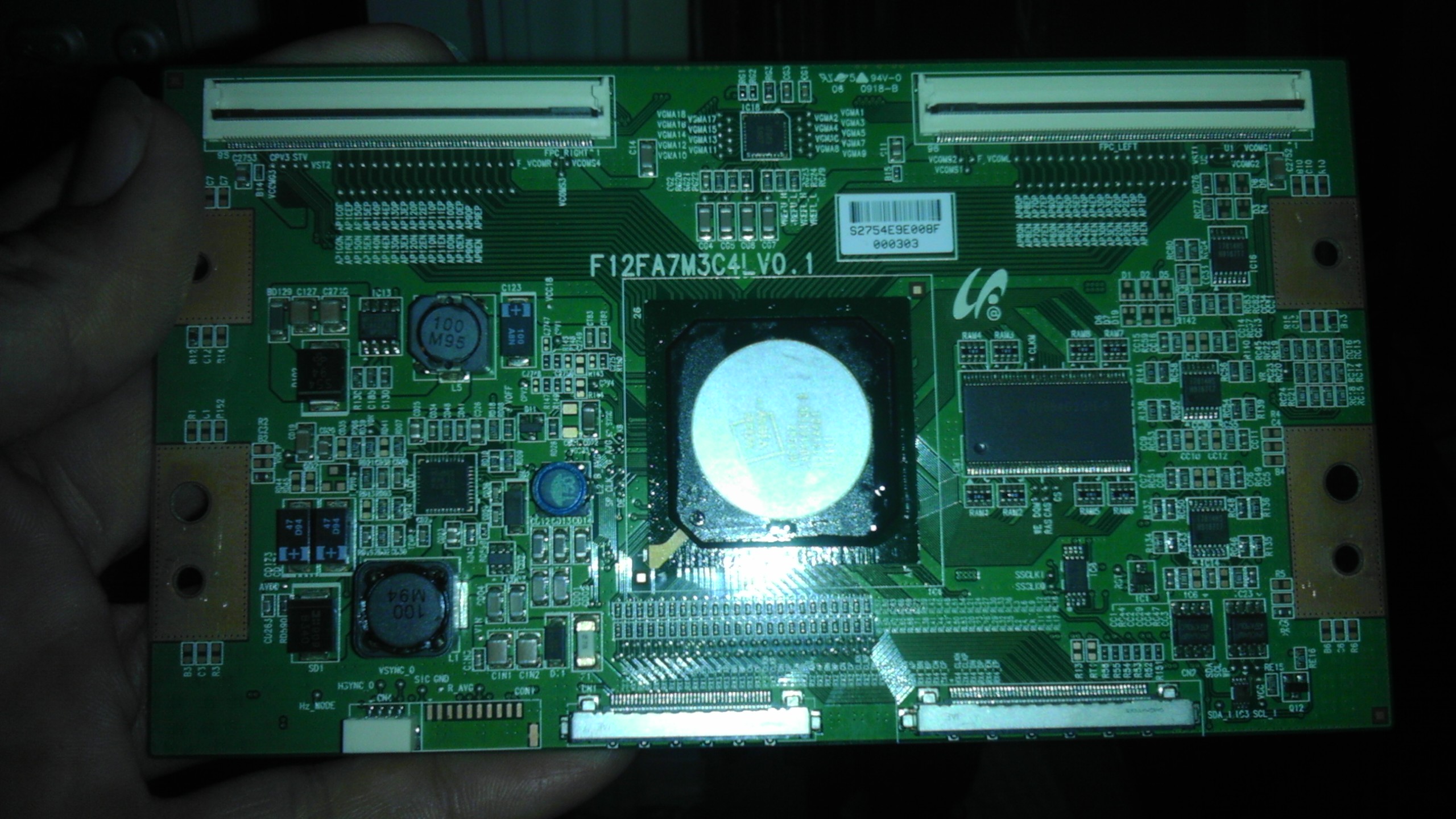

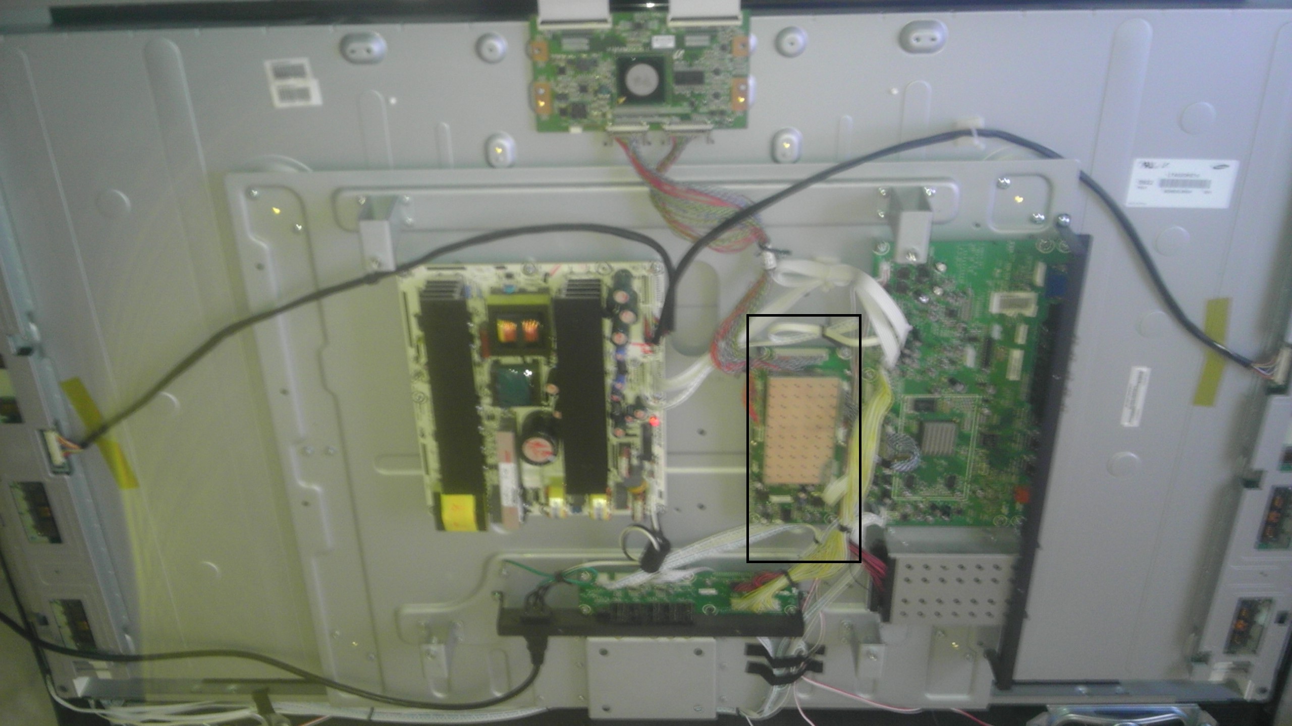

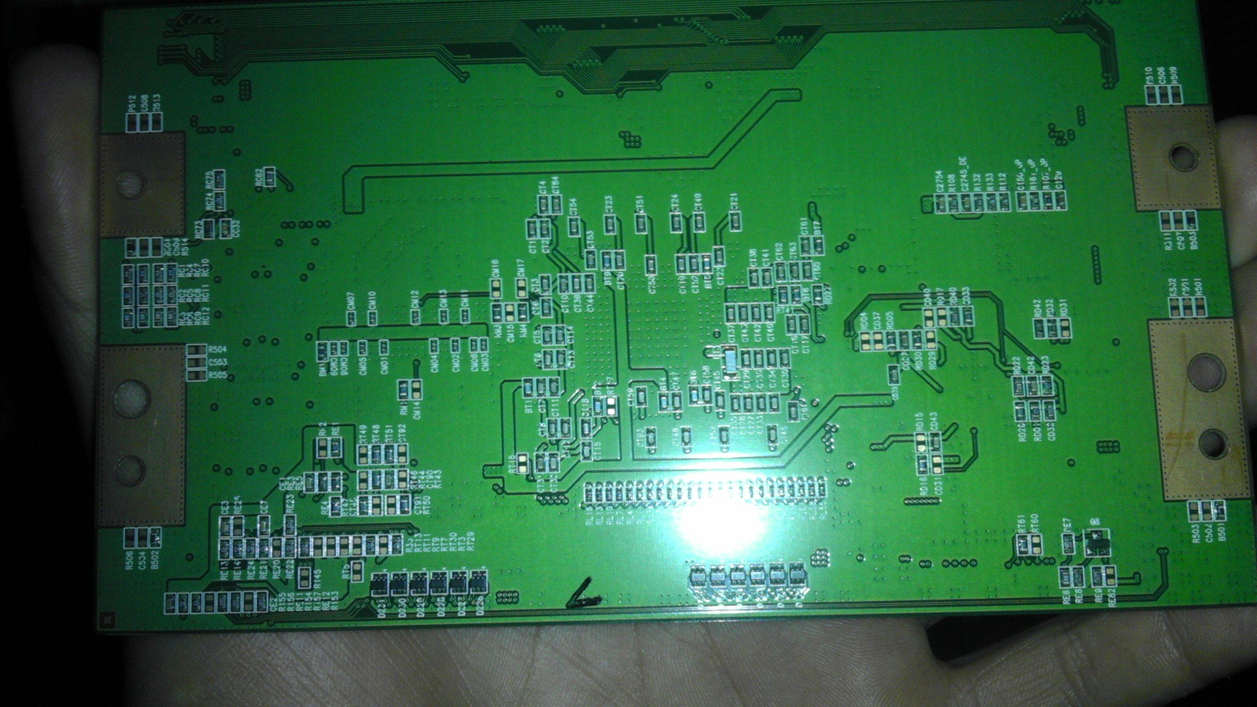

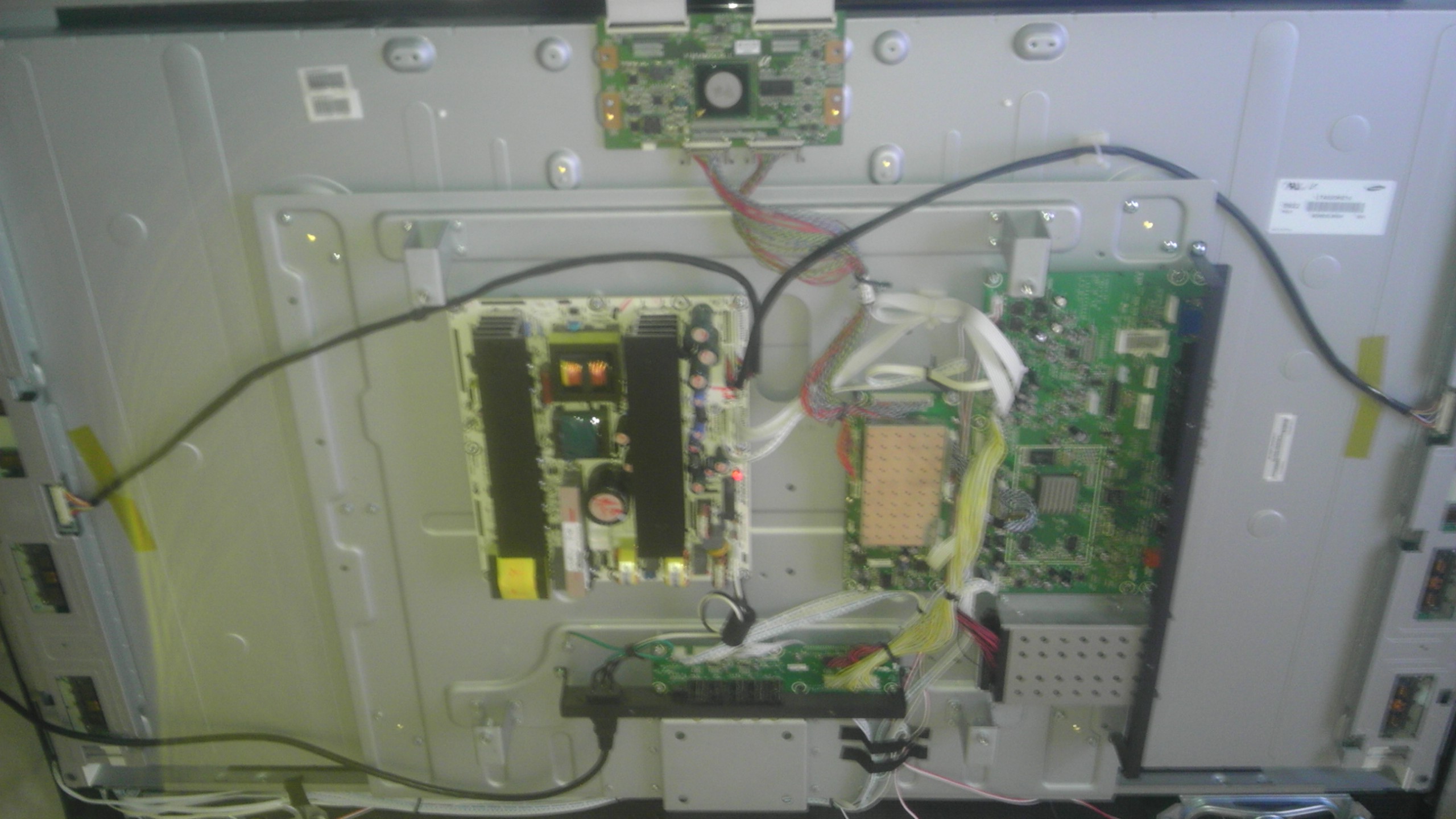

    I have a 52" Nuvision NUV52FX5 that has a problem with the picture. I believe it is the tcon board. But looking for some insight. The tv turns on and the backlight comes on as well. There is just no picture. I have checked voltages on the psu and all are good. I checked the fuse on the tcon and it was ok as well any other ideas? Does it sound like the tcon board? I checked the voltage at the fuse on it as well and got 12VDC. Please any help would be great. I have added some pics of the back of the tv. Sorry for picture quality that is the best i can do until my girl gets home with the good camera.

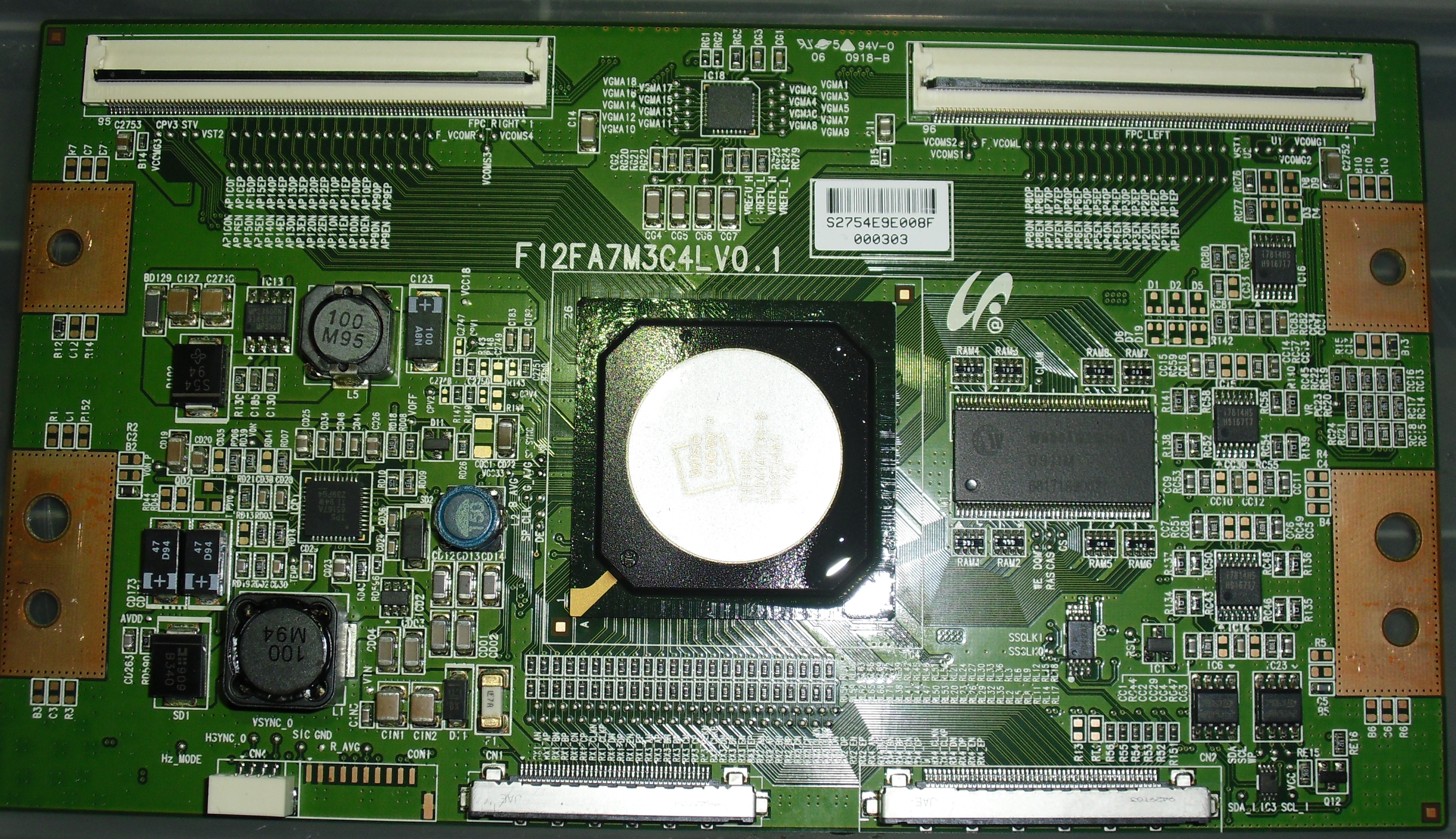

                That is a terrible picture but I looked at the tcon there are no regs on it. Also where should I check the voltages at?

                  Here are some better pics of it.

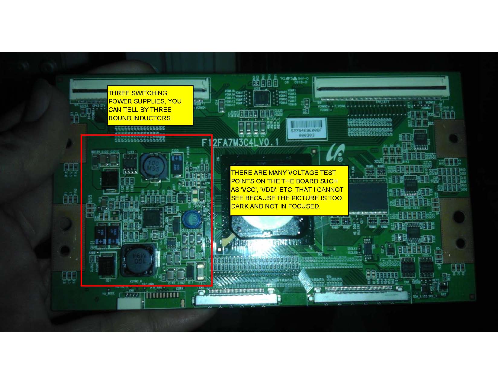

                    Re: Nuvision Nuv52fx5 no picture.
                    There are at least two switching regulator circuits ont the board, the picture is very poor for me to point out the test points for you to test.

                        I already checked the fuse. I said that in my first post. Bud can you point out the 2 that you are talking about and I can get a better pic of that area?

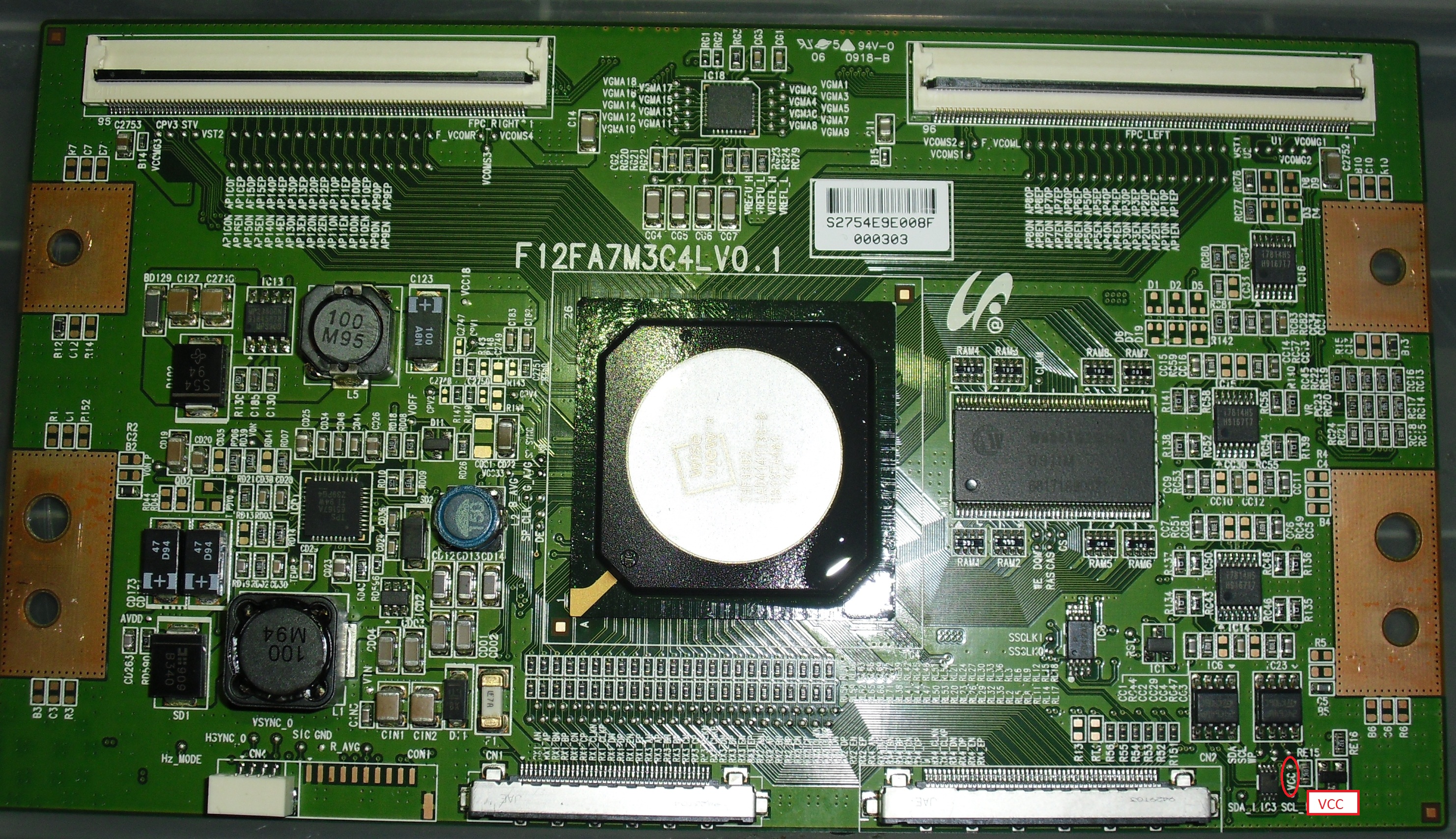

                          Please see attached picture, we really need good bright picture to see the test points.
                          From the look of this T-CON board with two connectors at the bottom edge, there must be another big board that drives this T-CON board, more likely that this TV can do 120/240 frame rate? This will make it real difficult to troubleshoot due to that frame rate driver board.

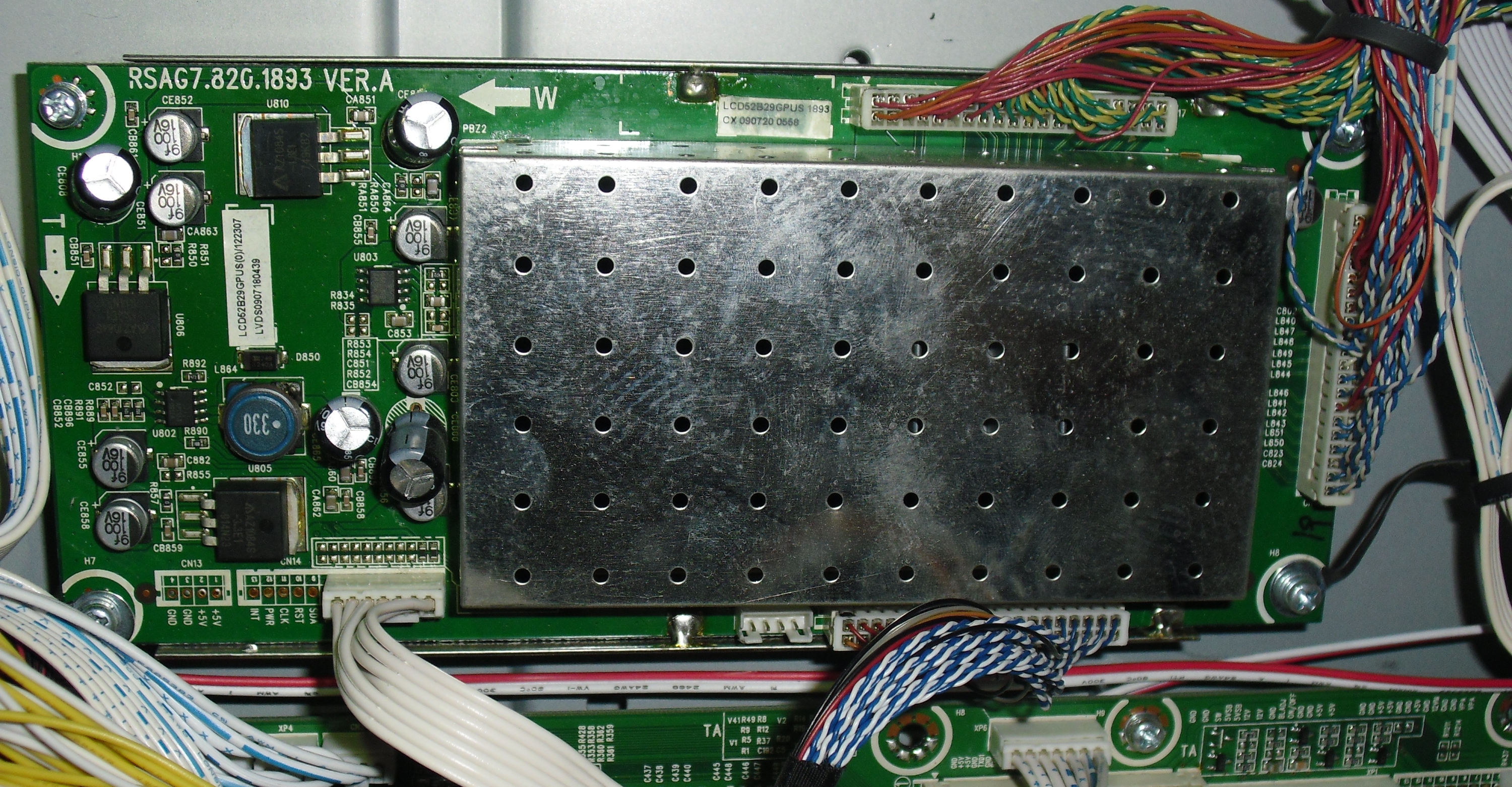

                            There is the board in the picture that I have outlined.
                            • burner6999
                              • Jun 2012
                              • 89
                              Here is a better picture of the tcon board and that other board.

                                Anybody? Are those pictures good enough?

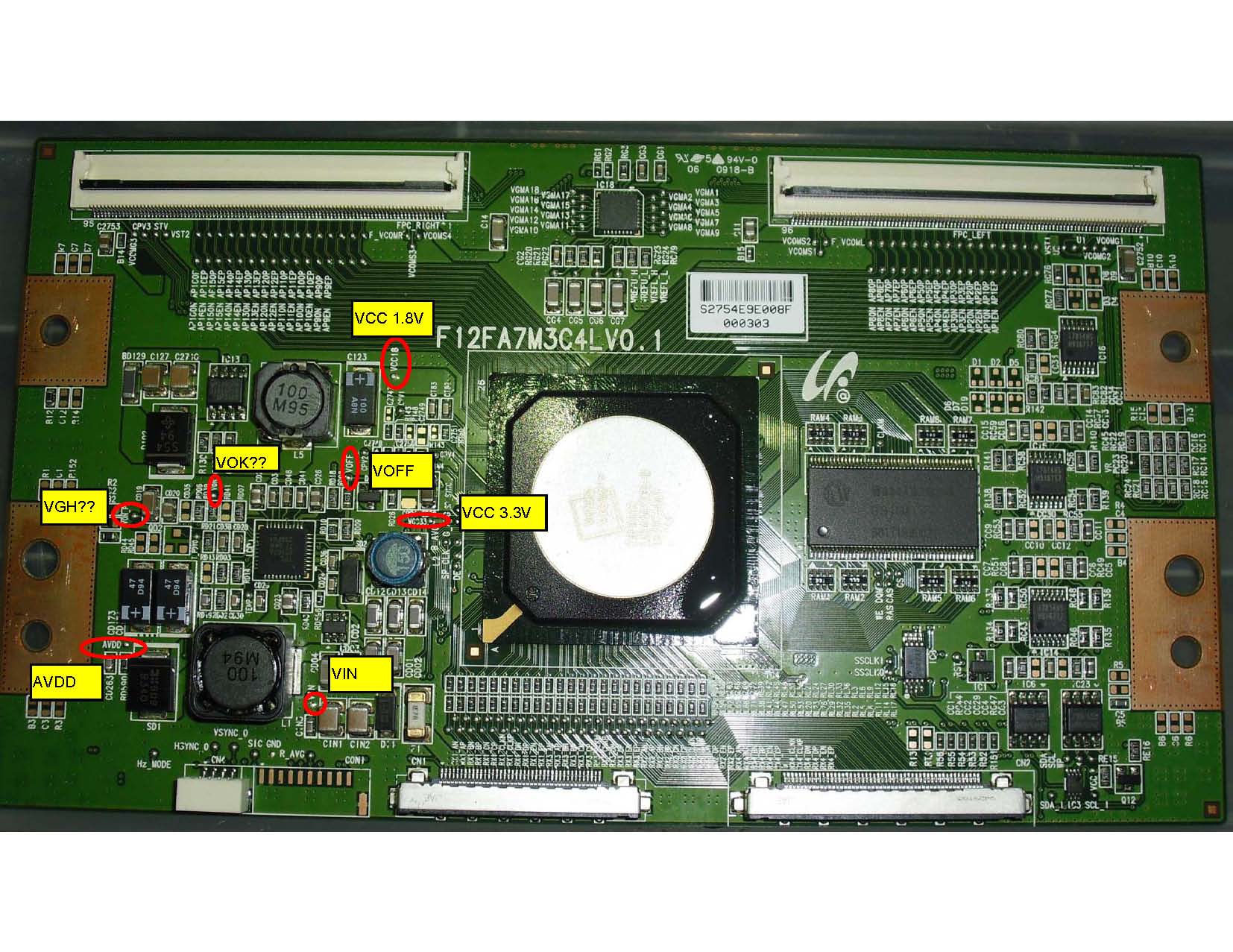

                                  OK, these are some of the voltages in the picture that we want to see what you have with the TV on.
                                  • burner6999
                                    • Jun 2012
                                    • 89
                                    Ok I also tested the other one marked in my pic cause it said VCC too.
                                    VCC = 3.2
                                    VCC3.3 = 3.2v
                                    VCC1.8 = 1.7v
                                    VOFF = -7.3v
                                    VOK (Actually VON)= 21.8v
                                    VGH (Actually VON_P) = 24.9v
                                    AVDD = 15v
                                    VIN = 11.8v
                                    Does that help any?
                                      They do not look bad to me, may be some one else can chime in.
