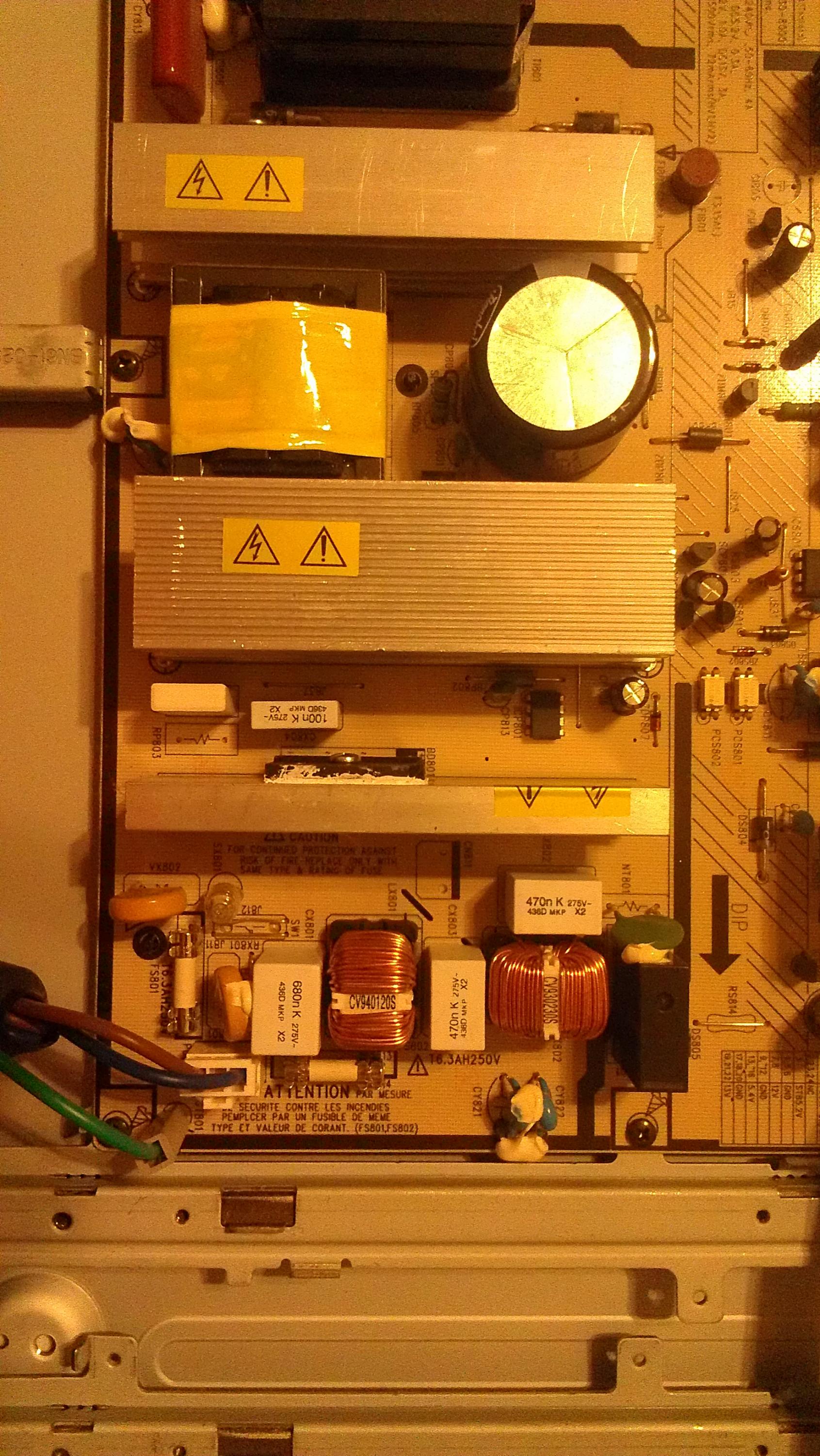

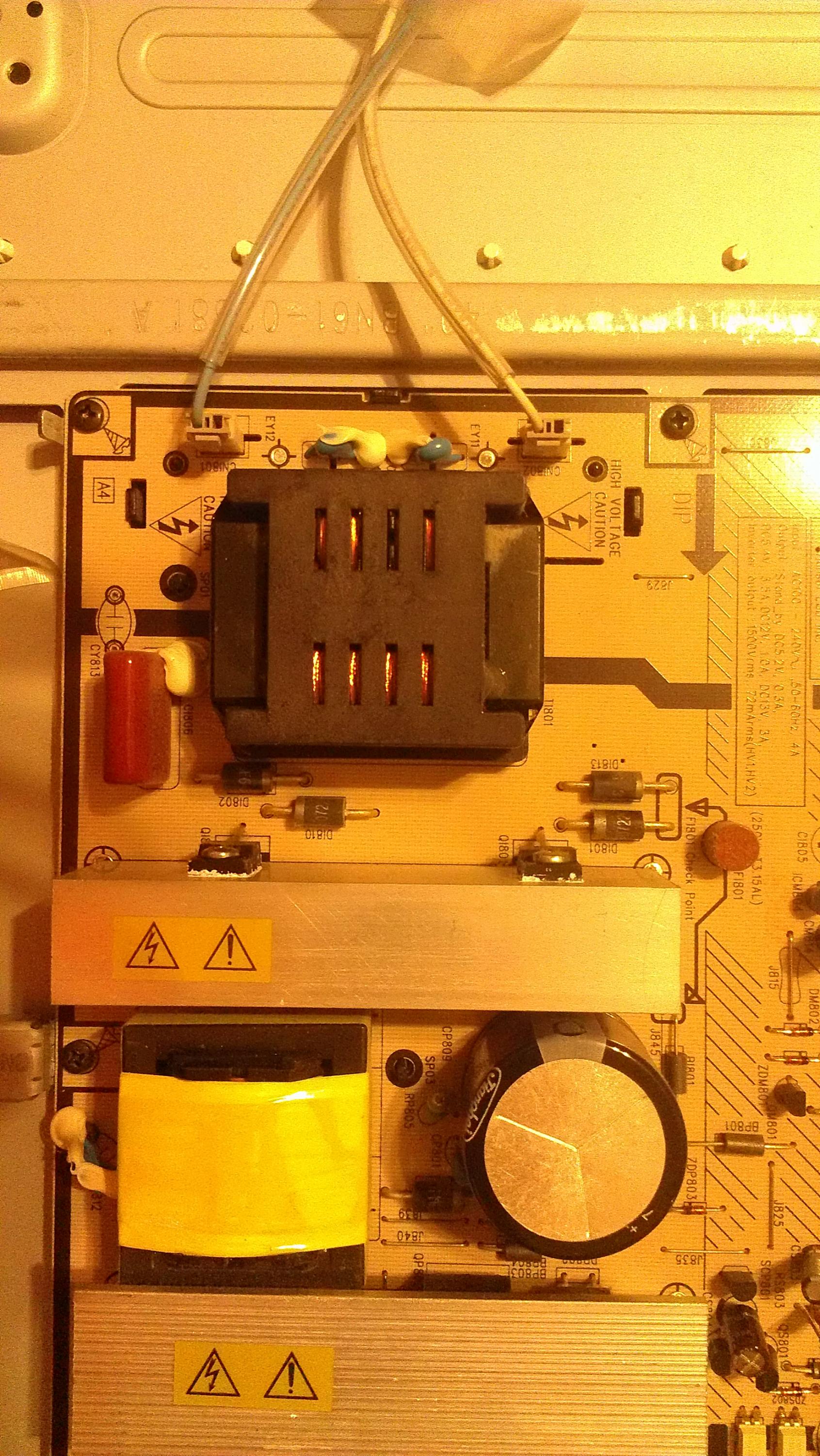

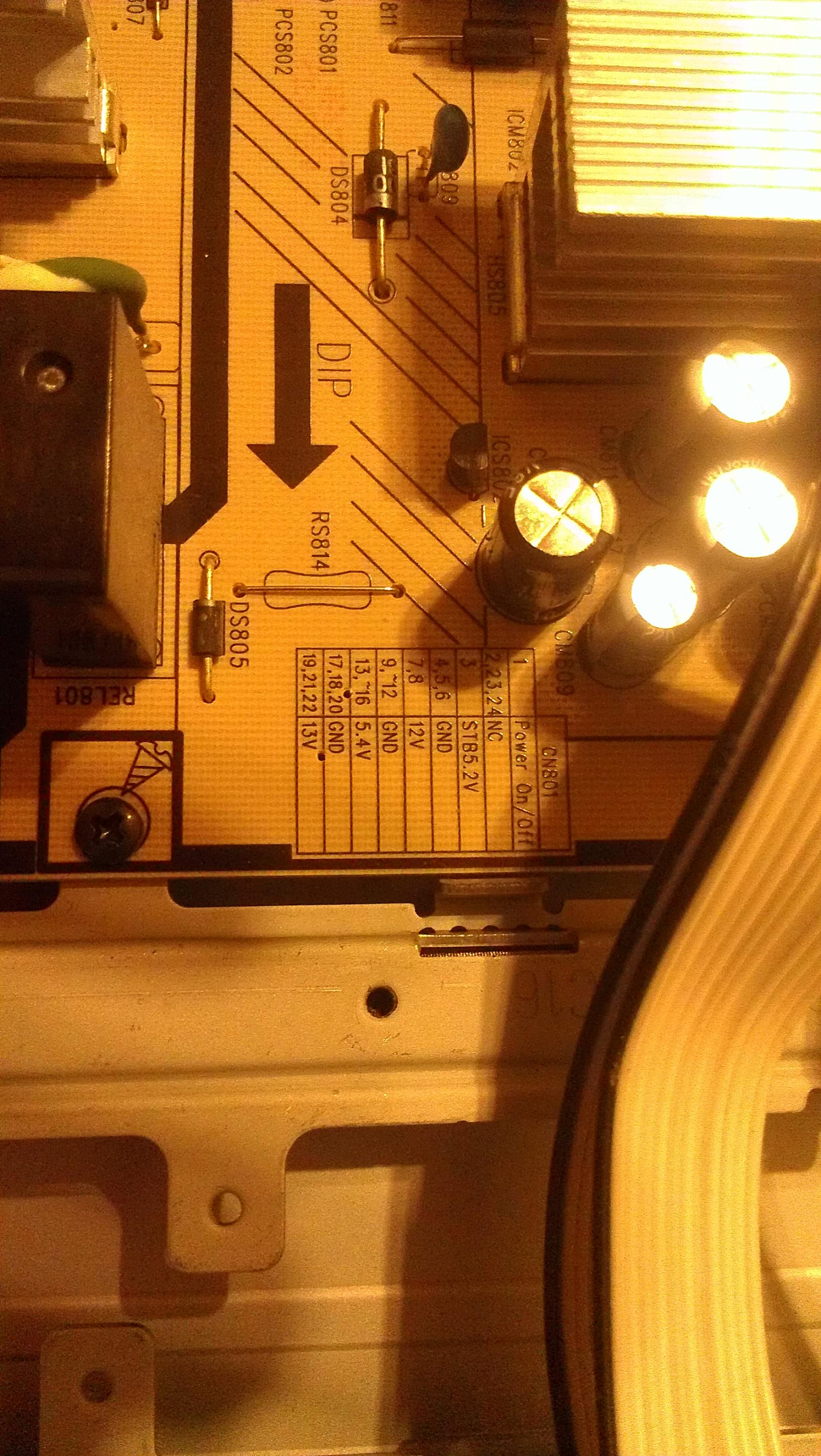

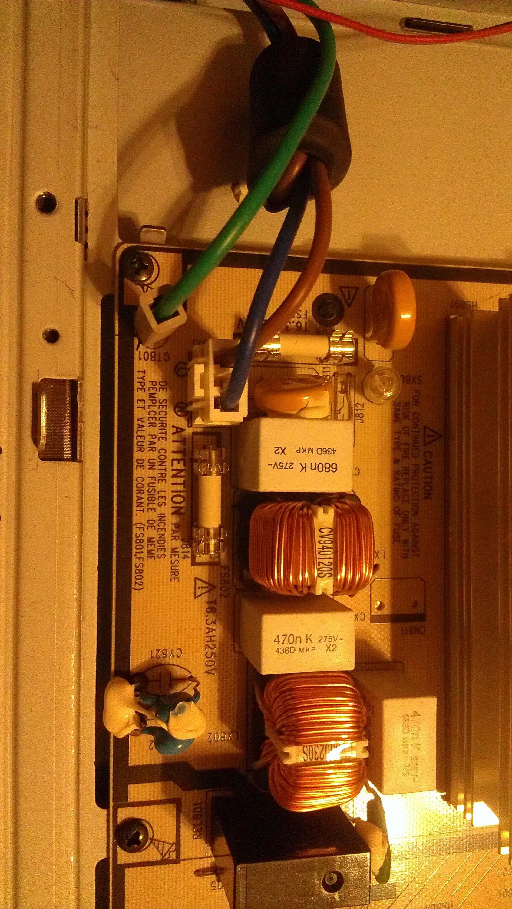

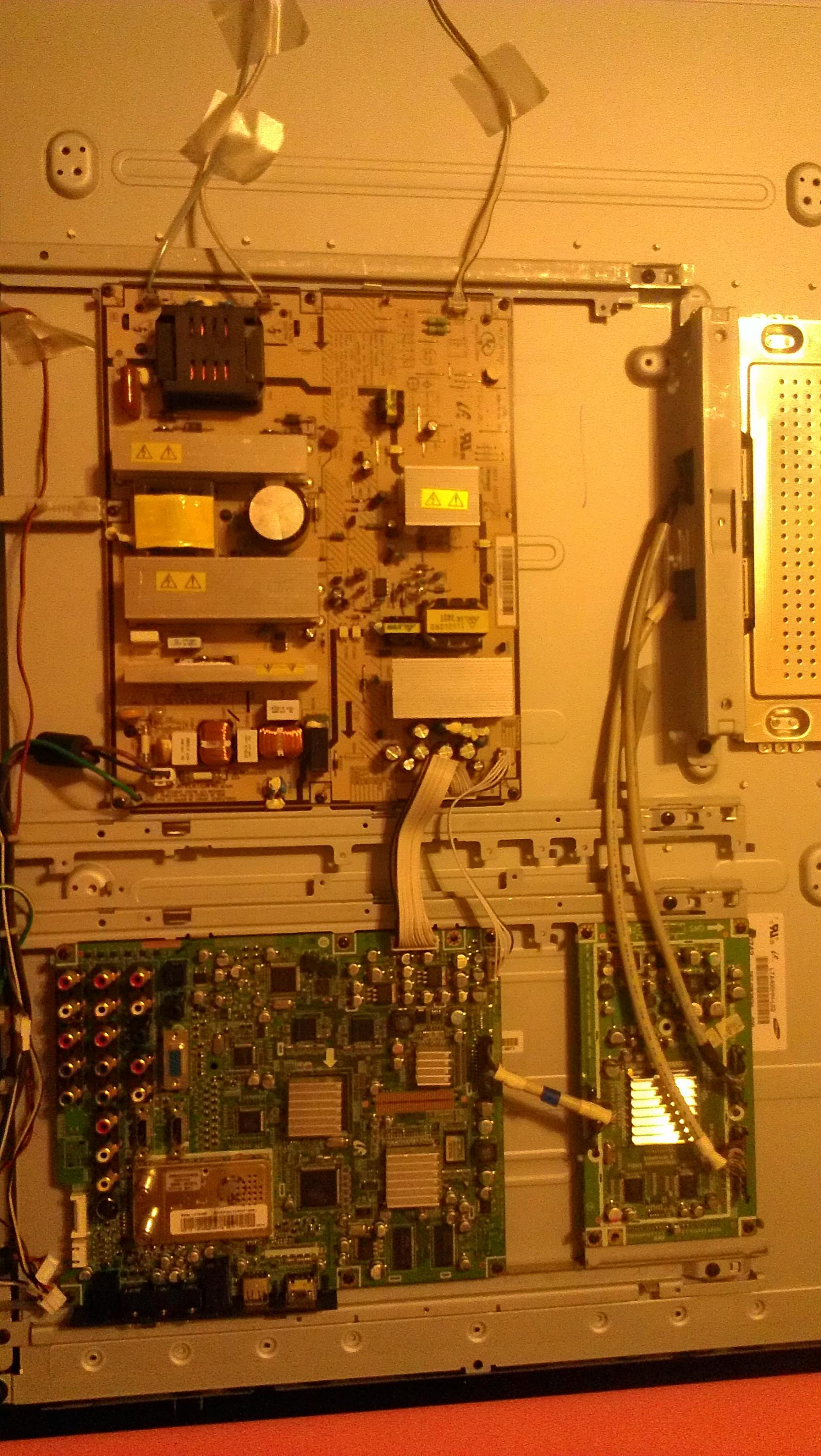

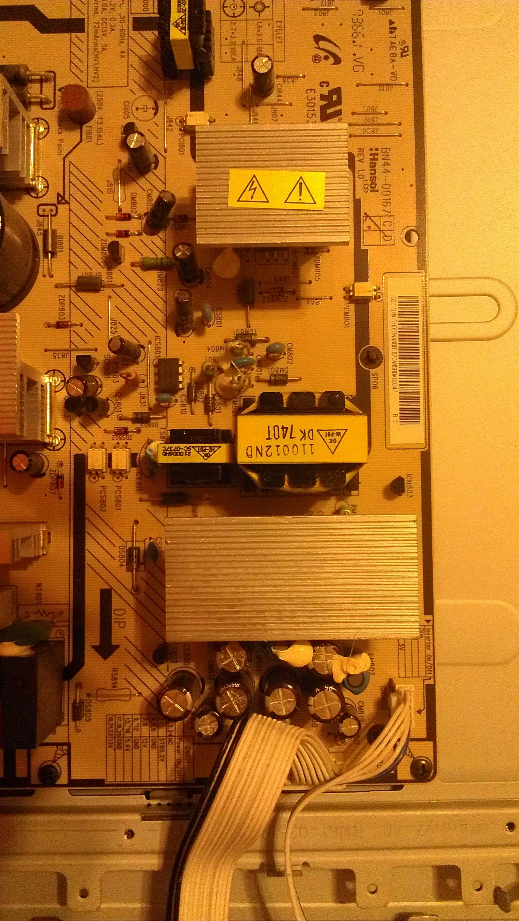

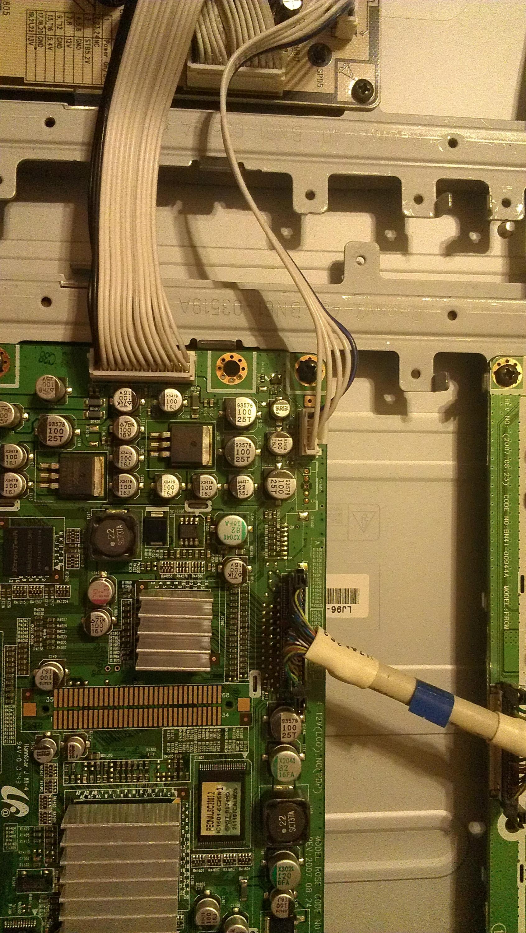

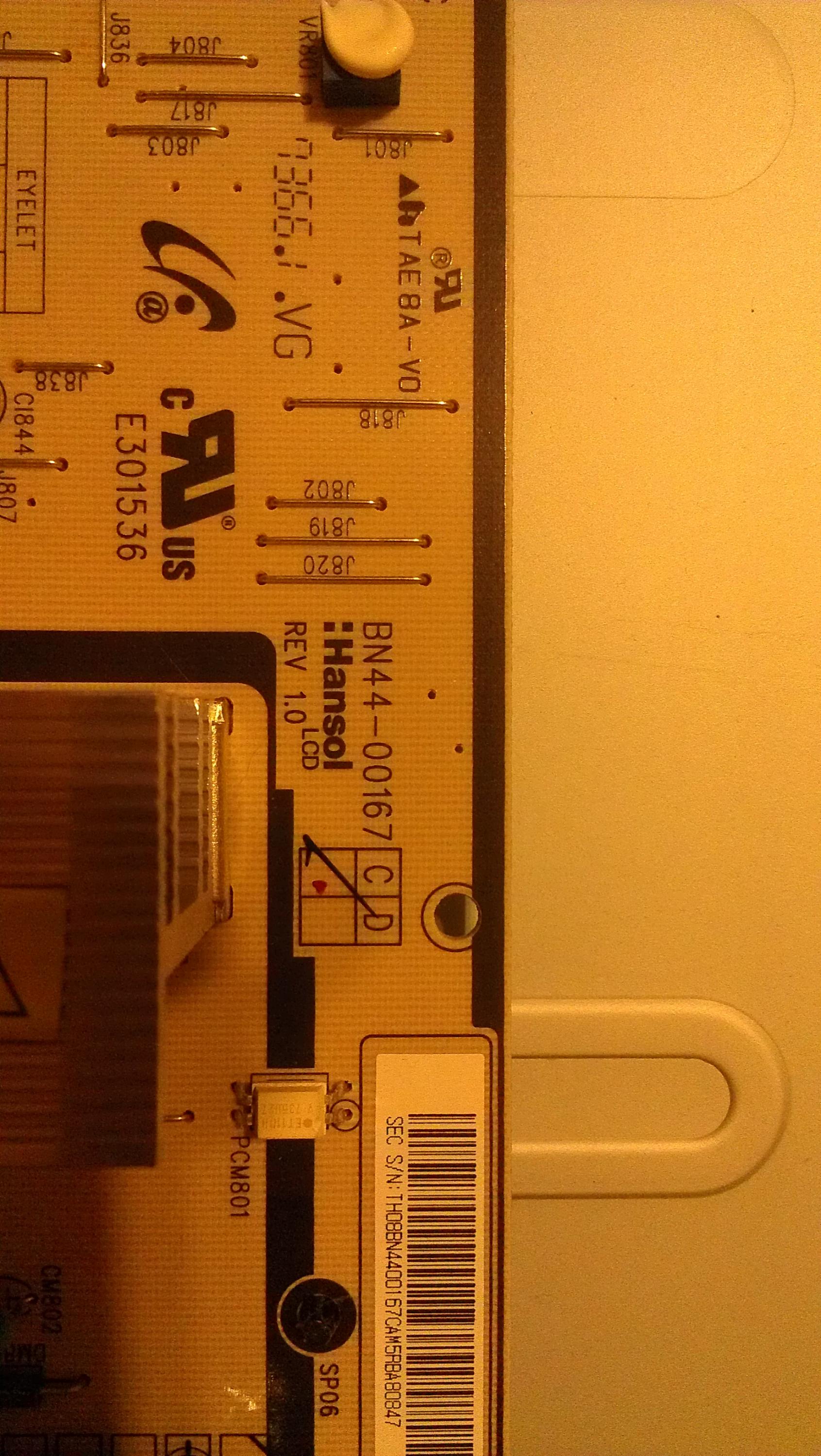

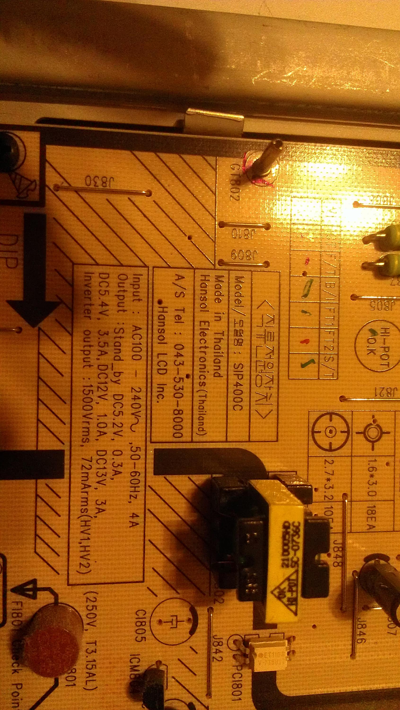

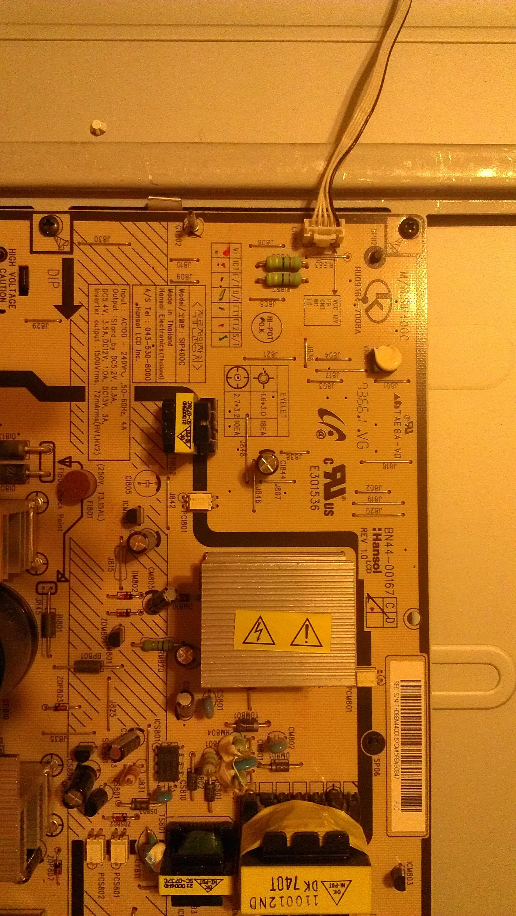

        I've taken some pictures and attached them. I will gladly take better ones of specific areas if that would help. Any suggestions on what my next steps should be?
        Thanks!

          Re: Samsung LNT4069FX/XAA Picture but no sound

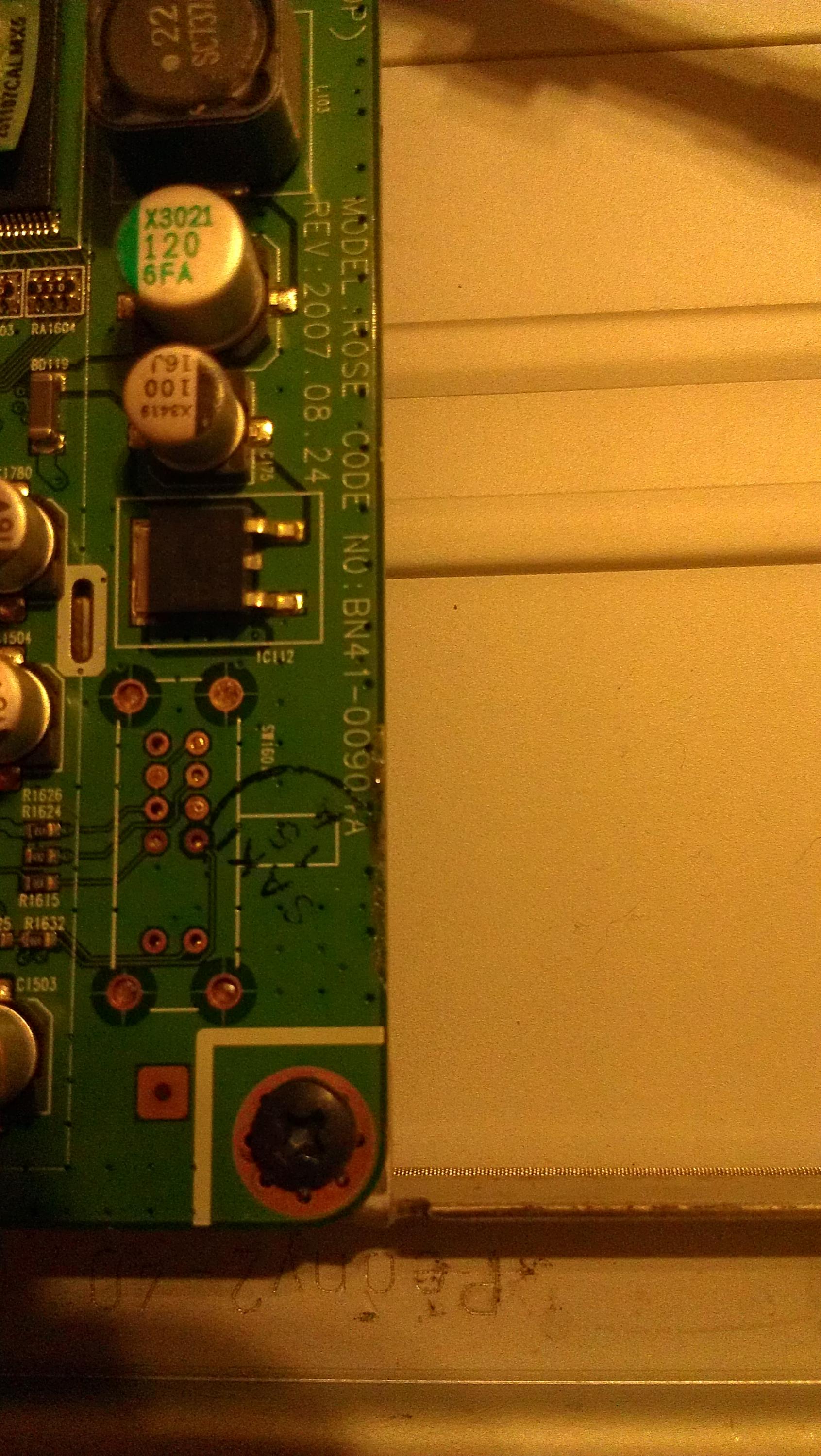

          In case it comes to this, I think I have found a main board for this model:
          http://www.shopjimmy.com/samsung-bn9...4069fx-xaa.htm
          From the image on the website - it looks exactly like the one in my TV.
          The only thing is... the one on shopjimmy has a different model number than the one actually inside my TV.
          the one in my TV has this code:
          BN41-0090#A
          (the # is a number/letter that I cannot make out on the board - it's obscured)
            You need to match the numbers on the bar code sticker.
            • ookla_the_mok
              • Sep 2012
              • 4
              Ah - I see what you mean.
              That actually makes it this one:
              So - is that the best next step here? Replace that board?
                It seems this might be your only option since your not getting output at the rca jack too. The only other thing i could suggest would be if your using a box (dish/cable), output the audio from it via optical to a surrond sound unit.
                Here is a link to ebay for your board
                http://www.ebay.com/itm/Samsung-BN94...item3a79c5a84e
                  The troubleshoot down to component level on this board will take a lot of research on Identifying which IC's are for the sound processing, the service manual will be needed also. Even if you find bad IC, do you have the right tools to do surface mounted repair. I done many repair but sometime I will replace the board due to time restriction.
                  You can contact Jimmy to verify what you have also.
                  • truep
                    • Aug 2010
                    • 373
                    I had a samsung with the same problem. Even the optical didn't work. The main board fixed it.
