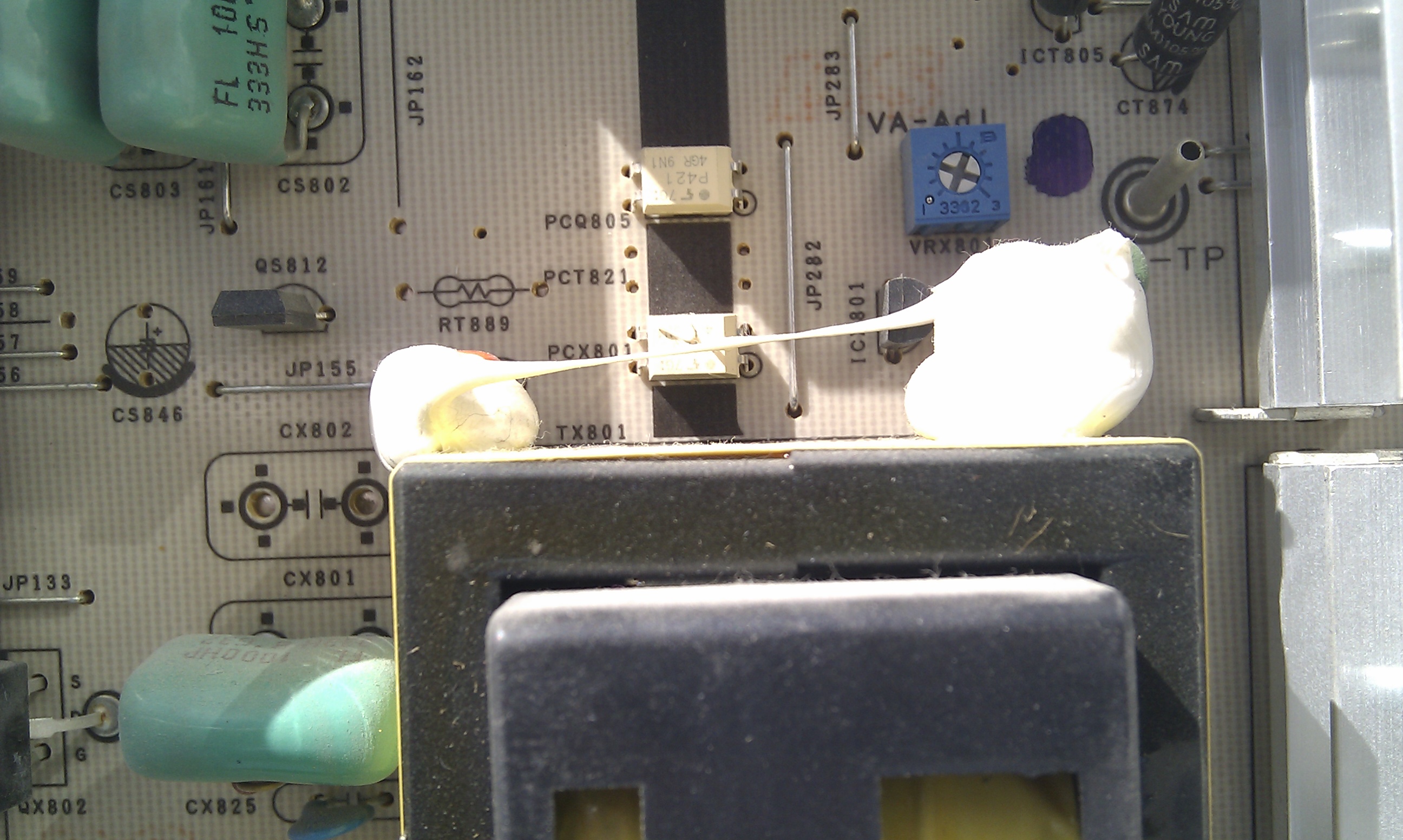

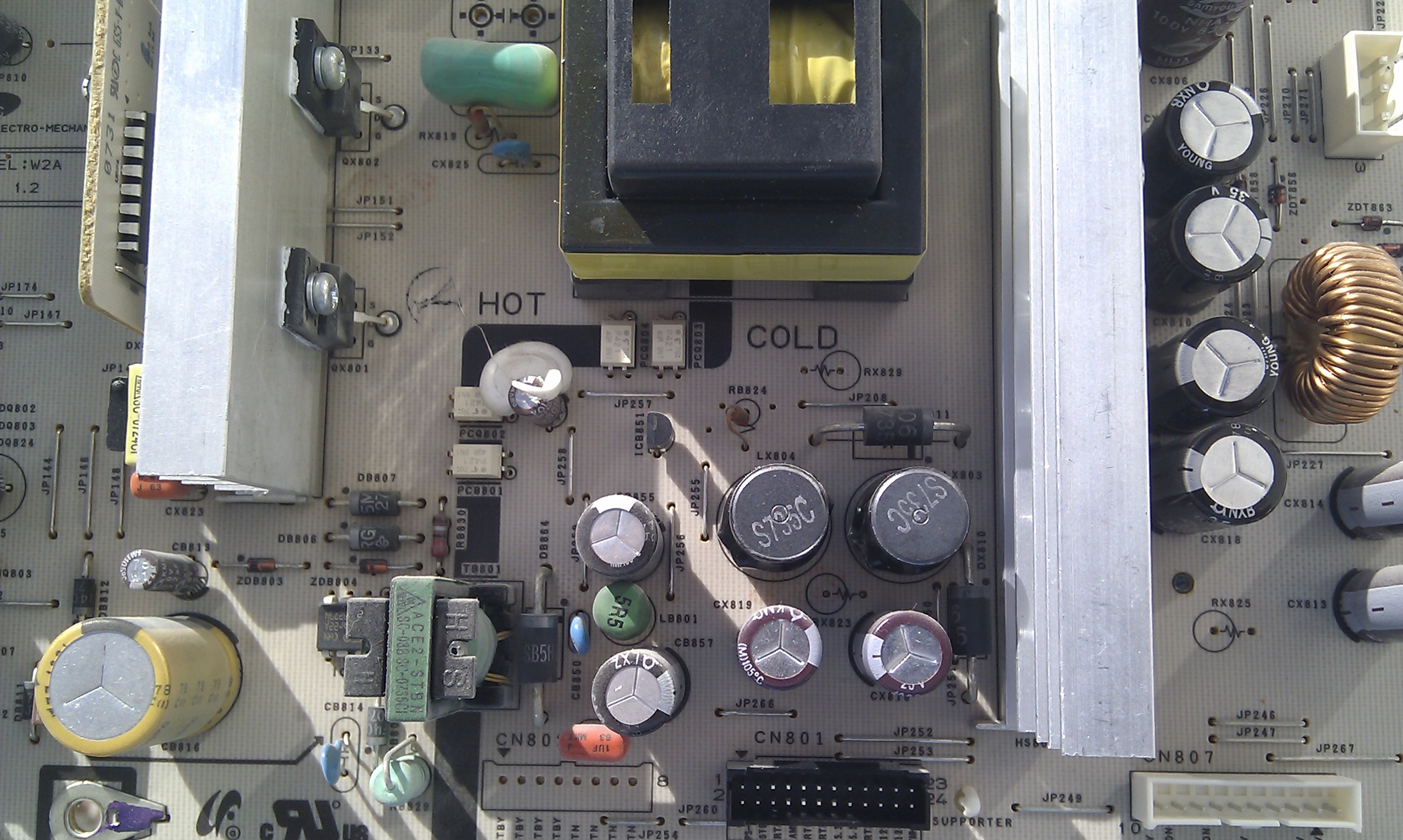

    My 2007 Samsung 50" has developed the problems of black screen & no sound. After a little research I came upon the problem of rogue capacitors, however, when I removed the back of the TV, no capacitors have blown top or bottom or show any kind of distortion.
    The only sign of any spillage from any components is what I can only describe as a sort of white glue that is on some components. It looks though it has been applied during production, I'm sure someone will know if this normal or the cause of my problems.
    Other information is that the TV starts on remote, there is one click and then the start up tone comes on. 3 green lights come on behind one of the boards (one of them winking on and off).
    The TV stays on for about 15mins and then turns itself off. In that time all the heat sinks on the power board are warm to hot and most are, on the X,Y boards.
    I am hoping it is still a capacitor problem but would welcome any ideas or suggestions (apart from using it an expensive door stop!!!)
    Finally, I have bought a test unit to test the capacitors, do they have to be removed from the boards to test or can I test them in situ.
    Many thanks, I can post photo's if required

    I must ask if this was on another input like HDMI, if so then there will be no sound. The reason I ask is because there is a start up sound and if there is no signal then some sets will shut off.
    Check to make sure all the voltages from the P/S are correct...so check Vs, Va, -VY, VSC. (last two are on YSUS board). I also think there should be like a SET_UP and Z-BIAS voltage. (all of this is on a sticker on the panel)
    Also check the LVDS cable.
    The white glue is from production...most likely a security glue.
    The green lights are normal and is most likely on your controller board...the blinking one acts as a temp guage.
    Caps do have to be tested out of circuit.
    And yes post photos.

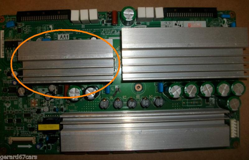

      Sounds like shorted y buffer and blown y-sus. Can you post some pictures of the ysus and buffers.
      If this model is related to a PS50Q91HD then I know they will power save and shutdown if no signal is present for a period of time. Mine did.

        Blown FETs usually on this heatsink . 88N30W. One of these shorted will short out all the other 88N30W. I don't have this board anymore to take a high res shot.

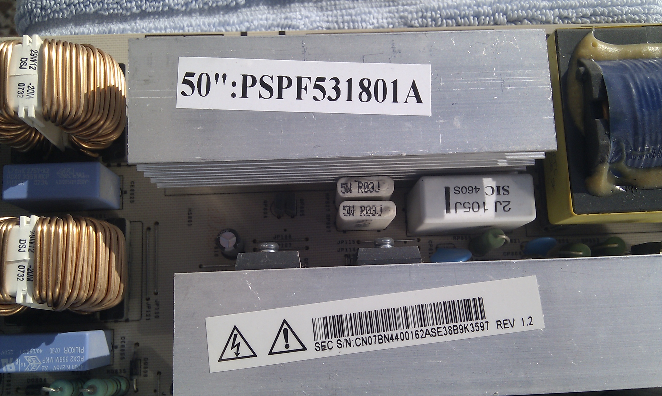

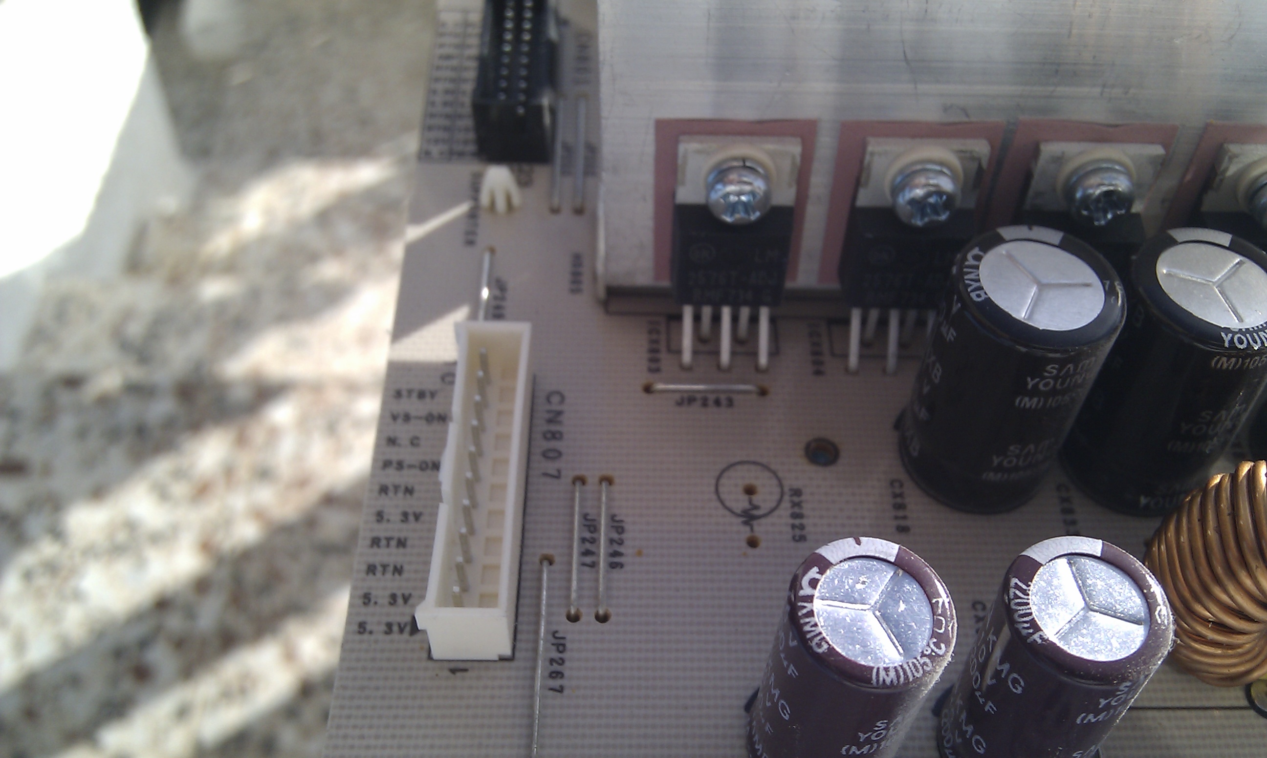

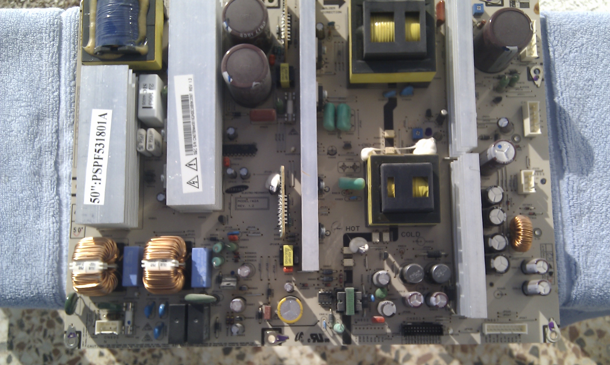

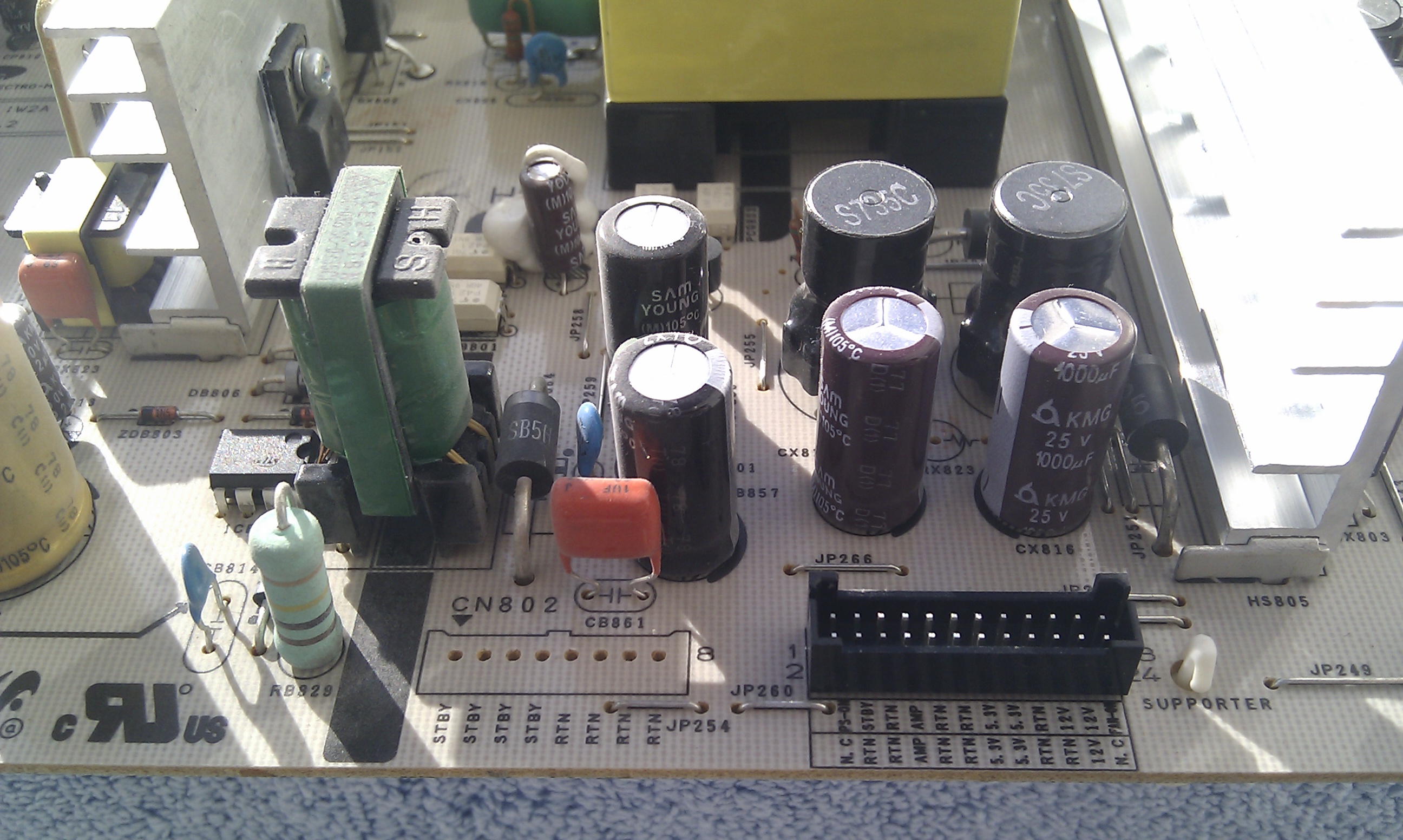

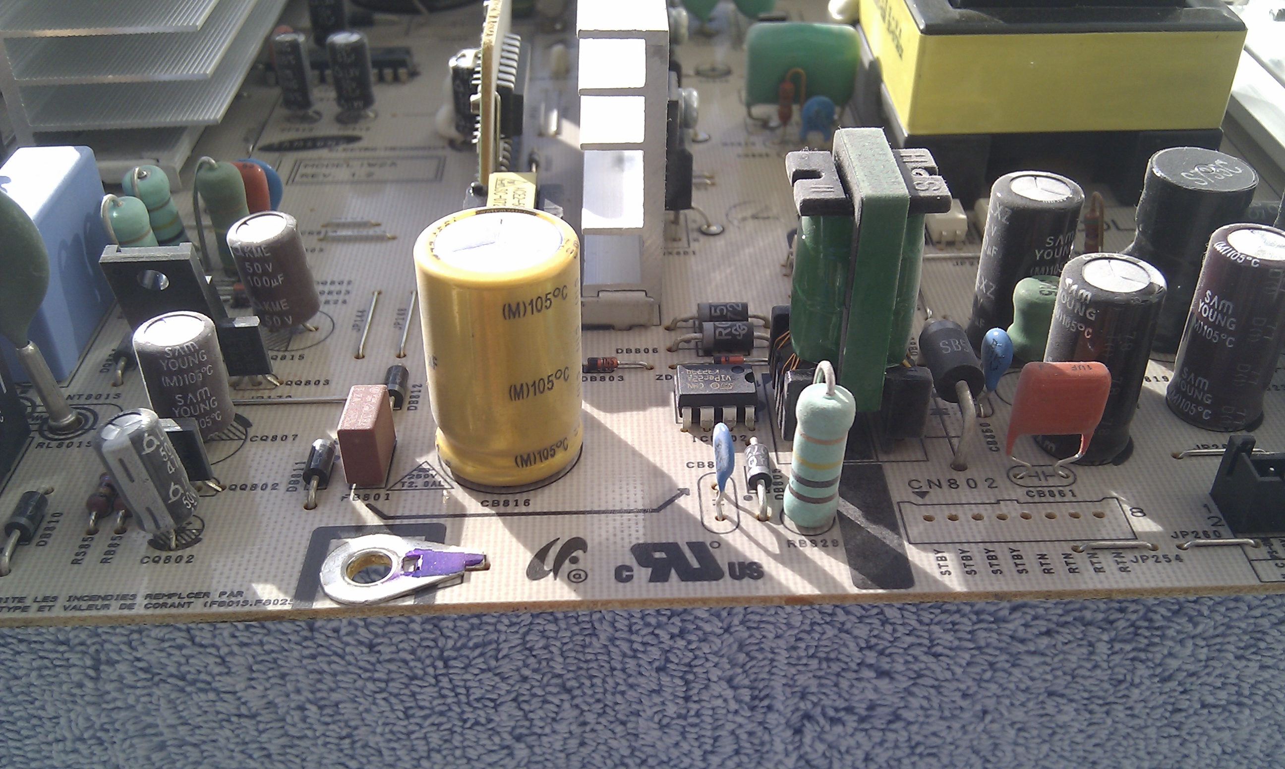

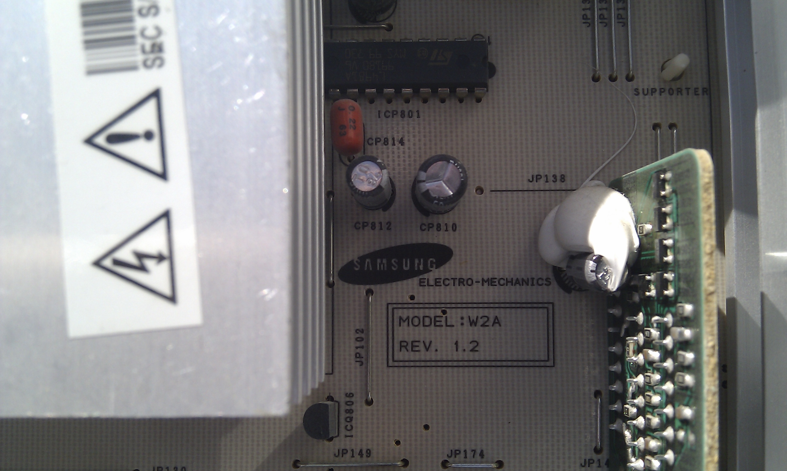

          Hi Guys,
          Sorry for the delay in posting Pics. However I have taken some of the ? main power board where I thought the problem may be and I will post pics of other boards in the next couple of days. please bear with me if I ask stupid seeming questions, as you can probably guess I'm not a TV engineer just a reasonably handy guy who's jacked off at paying out €1800 4 years ago and now I have got an expensive door stop. If you think you have customer service probs in the US or Oz try living in Spain. Anyway any help or suggestions gratefully received----i have my capacitor tester and solder remover etc; but will hold fire removing goods until further advice. Thanks Bridgie
          • drpj23
            • May 2012
            • 528
            Re: Samsung PS-50Q97HD Black screen, No sound
            Wait, what are the voltages coming from that power supply?
            Two, your main power supply is probably fine and as tw2005 stated, the problem most likely resides in the Y section of the TV. The fact you have sound/cuts on and does not go into a protect circuit is the reason for that diagnosis. Two you also may have a blown fuse on the YSUS, so check for that as well, which will be a good giveaway.

                It can be either. As tw2005 said in post 4, your FETs have probably shorted out.
                If you want your TV back quicker then buying a YSUS is usually under $100....err 80 euro perhaps......and it should fix your problem. But with this problem, we cannot see other problems that could be there.... but that is probably not your case.
                For checking voltages, get a digital multi meter and put the black probe on ground (chassis or screw) and the red probe on the corresponding pin that you are testing. If you have to set ranges, make sure the voltage on the meter is higher than what you are checking and make sure the meter is set to DC (not the squiggly).
                Check the FETs this way. ((As per the 2 seconds to black sticky))
                If you have a manual range multimeter, set it to 200 ohms (two hundred). You can test for shorted transistors "in circuit" (with power off and unplugged)
                a) put black probe on pin 1 and red probe on pin 2 - read/record ohm
                b) put black probe on pin 1 and red probe on pin 3 - read/record ohm
                c) put black probe on pin 2 and red probe on pin 3 - read/record ohm
                If any reading is less than 30 ohms you might have shorted transistor. Remove the transistor and repeat the tests out of circuit to verify.

                    Can you tell us what you've replaced and tested on the ymain + pictures.
                    Also are you running the original buffer boards? If so probably not a good idea. I found on all 3 tvs with dead ymain the upper buffer was bad also.
                    I mentioned the buffers in post #3

                        Ok well that's most likely why you have not made any progress.
                        You need to test the transistors on the board where I circled earlier for shorts.
                        The buffers are the 2 long boards which are connected to the ysus.
                        Test first and post results

                            Ok,after a crash course from U tube on testing Diodes and Transistors here are the results for the FET's that you highlighted in post three. I tested the FET's in situ and because I didn't know which leg was which I tested each pin in every combination I.E.
                            1 2 3
                            R B x
                            B R x
                            R x B
                            B x R
                            x R B
                            x B R
                            Where B & R are the black & red probes of the multimeter which was set to test diodes and when setting the function to test the diodes a No 1 showed on the screen.
                            FET 1 FET2 FET3 FET4 FET5
                            0.47 0.97 0.97 0.97 0.005
                            0.47 0.98 0.97 0.97 0.005
                            0.46 0.97 0.97 0.97 0.005
                            0.001 0.001 0.001 0.001 0.001
                            I fear the worst. Am I right in assuming that as so many of the values are the same that all the FET's are shorted or--as is quite possible I have carried out the test incorrectly.
