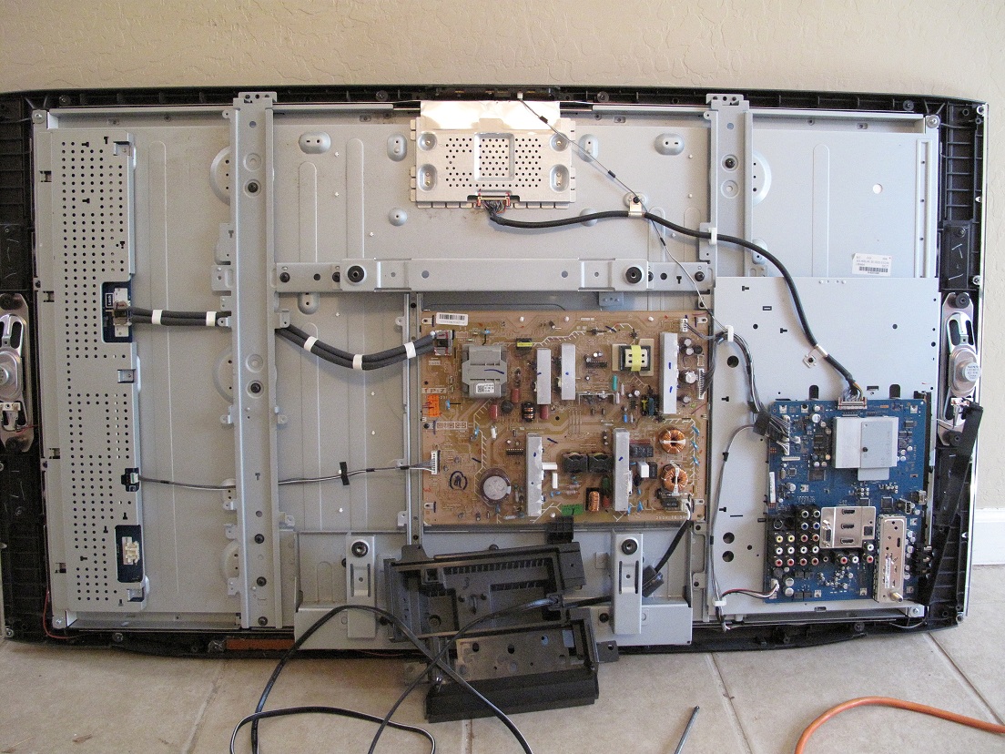

        Re: Sony KDL46SL140 - Works when hot, doesn't work when cold
        Attaching picture of back of set. The two boards that seem to be ok when hot or cold is the orange one in the center and the blue one on the bottom right.

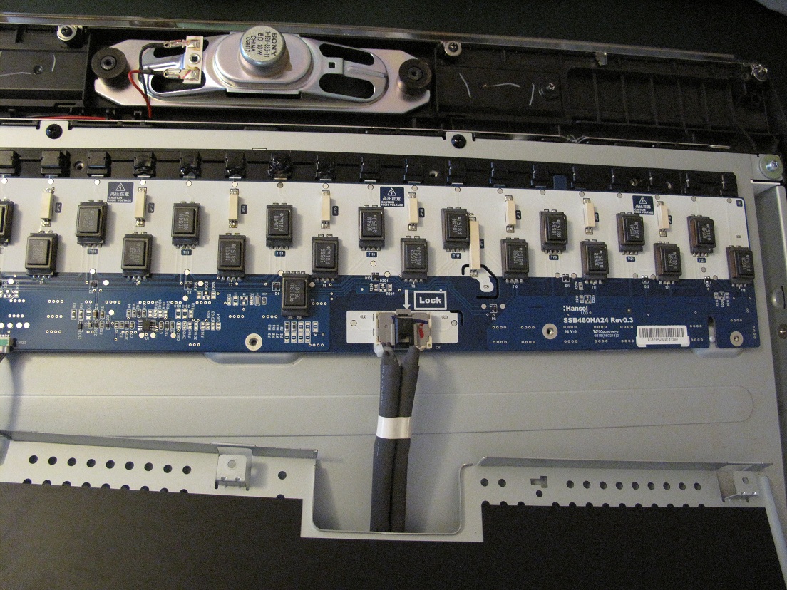

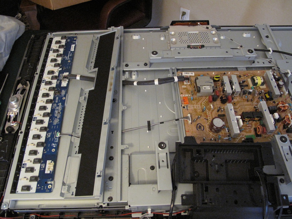

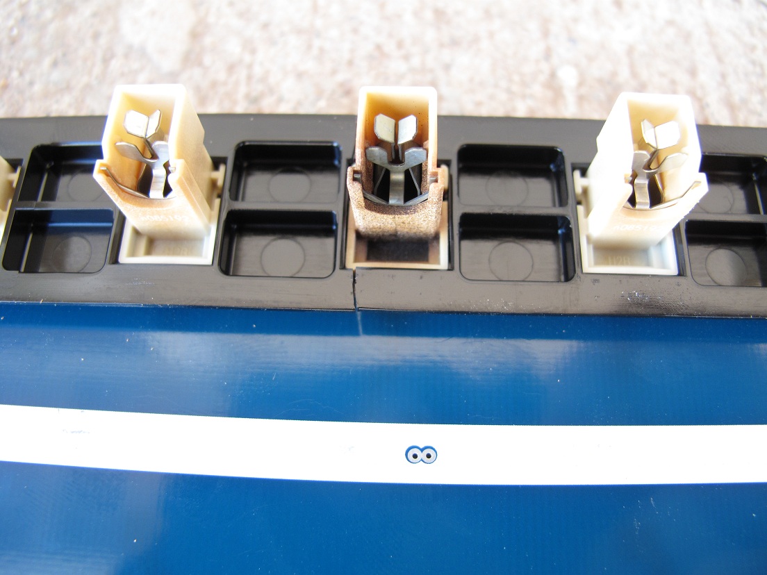

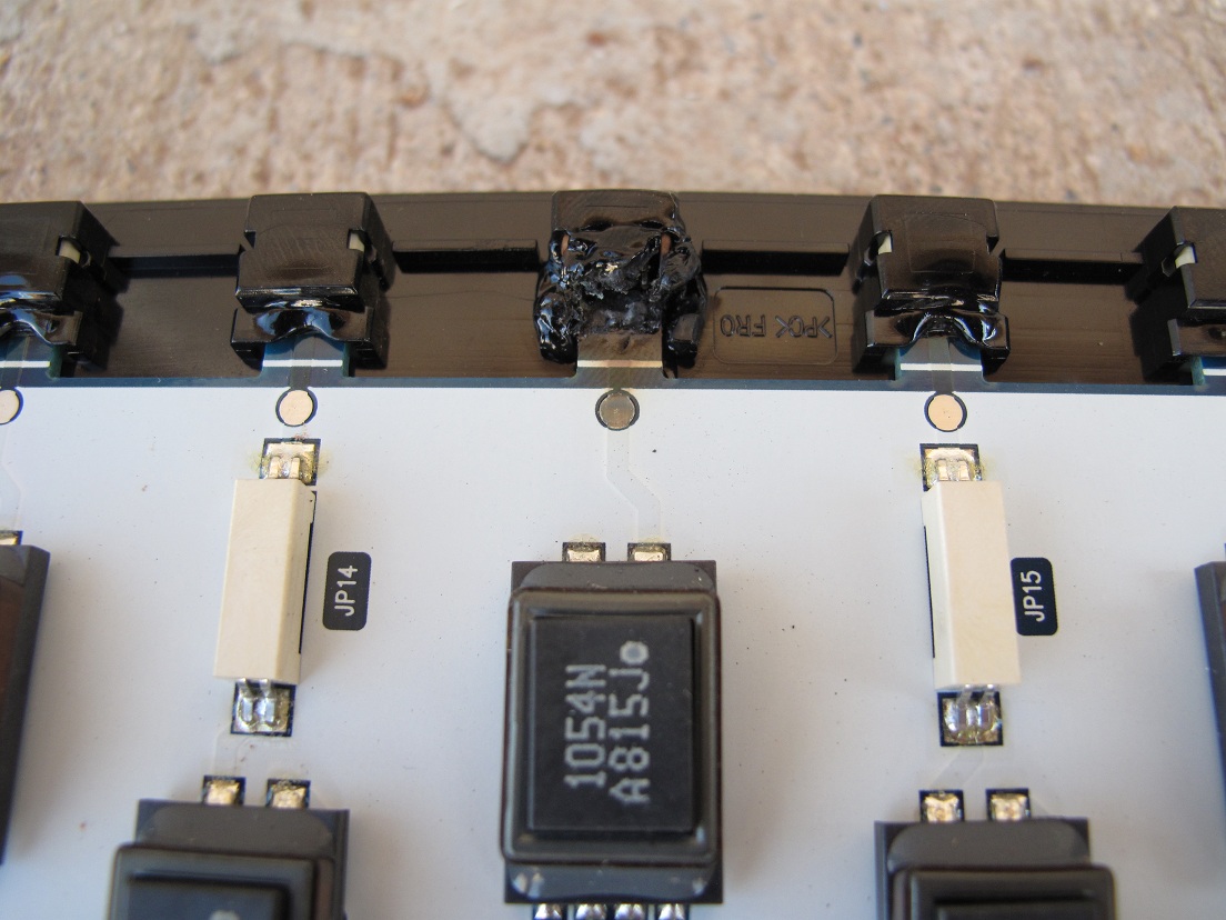

                I believe I have found the problem! The board on the far left which I think is the florescent bulb driver board is definitely the problem. When the entire TV is cool but that board is hot, the TV works.
                Upon examining this board I see some melted plastic pieces. I believe this is where the problem is but I don't know how to fix it yet. The plastic doesn't come off very easily to see what is under it. Attached are photos. Suggestions would be great at this point on how to fix the melted area!
                  Yes, that is the ballast board. This PSU is similar to Samsung and LG, but different from most other TVs, in that it generates one high voltage (approx 3000V) which is distributed to all the bulbs individually. Normally one voltage is generated for each. The black things (transformers) balance the current between each bulb and detect faulty bulbs. I suggest all you have is an intermittent contact, the arcing 3000V has burnt the connector. Use a scourer to clean off the surface and make sure the contact is properly cleaned. Reseating it too, as well as tightening the screws on the ballast board, could help.
                    SONY calls this Balancer board, it works as TOM said. I can see at least 3~4 more in pix #3 that the black plastic pieces are deforming. You should remove the board and clean the copper pads on the board real well with an eraser and then clean them with Alcohol. Clean off any carbon tracks that you can see also.

                        TV works great now. I cleaned the contacts just as suggested and now there is no buzzing or arcing. Thanks guys!
