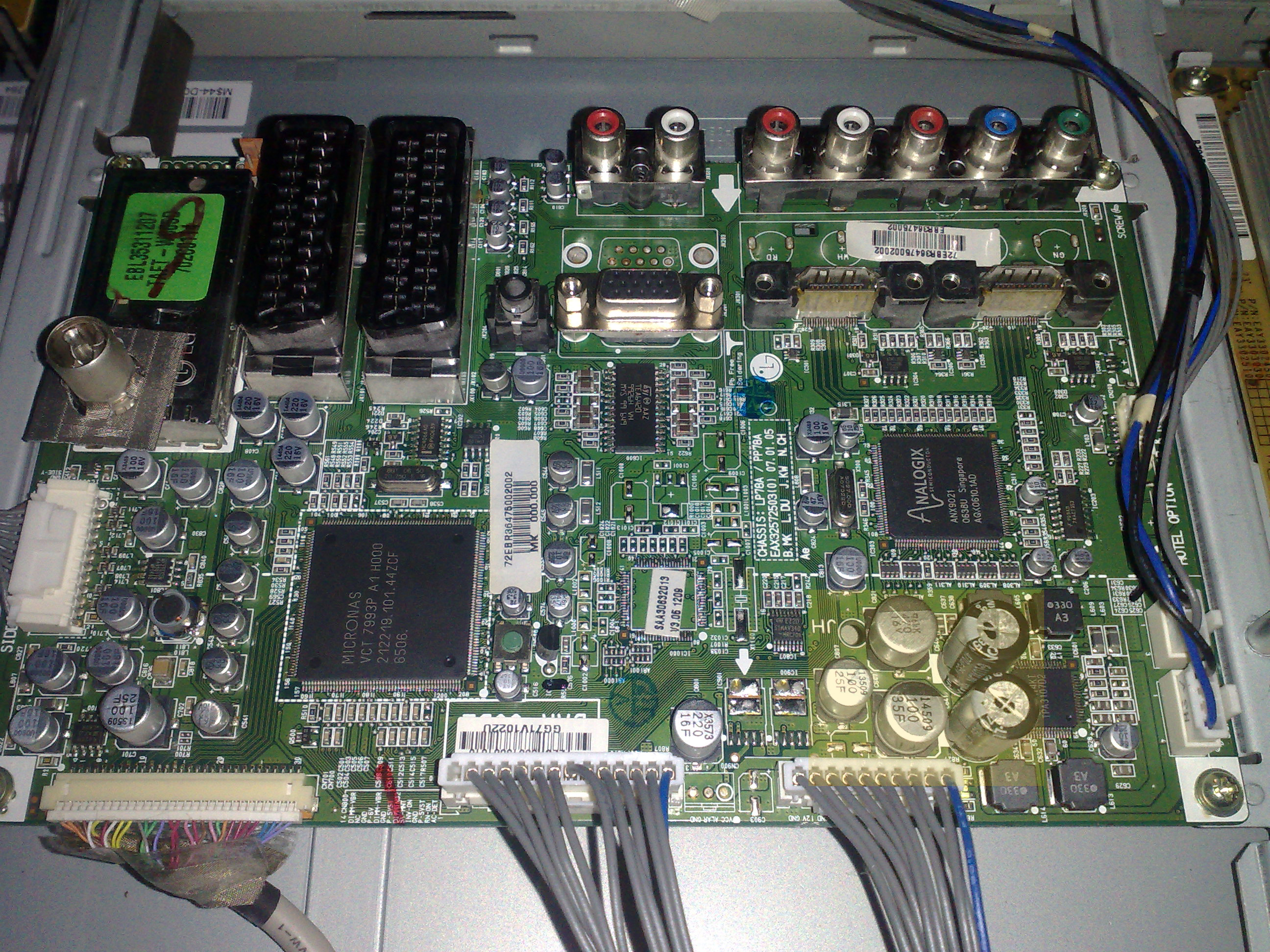

    Hi guys,
    Have one of these on the table at the moment. It shows a blank screen and then comes on after about twenty minutes. voltages on the PSU checks out OK.
    When I put the hairdryer on this bank of caps,
    on the video board. it takes life after about a minute.
    My question is: If I measure the voltage across these caps when I first turn on (and the screen is not working) and then heat up the caps with the hairdryer and measure the voltage again (when it is working), should I be able to identify the bad caps?
    (nb. I know I should change them all anyway, I am just wondering should I be able to identify the faulty ones this way??)

        Re: LG 26LC51 with bad capacitors..
        Two "X" caps - G-Luxon. Known bad.
        Left middle - Chemicon, good usually.
        Others - Don't know maybe Samwha/Samyoung (known bad.)
        Those caps look like for the audio amp? They may be unrelated to the problem and you could be heating up other parts.
          I found a dry joint on an inductor on the power board, which I resoldered and seems to make it come on more often (though that could be just in my head).
          that's the board with the section with the caps in yellow, I dont think it is part of the audio circuit.

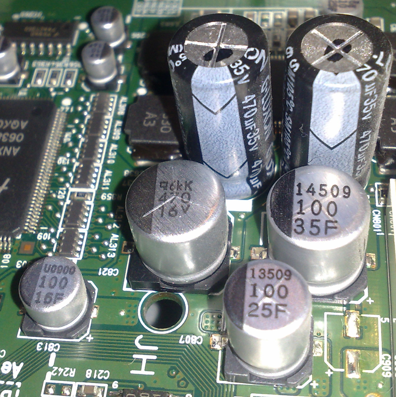

            Okay I swapped out those two Gluxon 35V caps and since this the TV has come every time...... but ONCE ... of about 100 switch ons, some from cold....
            There is also physical damage to the A/V board.. you will notice the S video connector is slight pulled off the board and the coax port is damaged badly.. So I've priced up a new board.. Looks like it got one hell of a belt, either a drop or somebody reversed in to it with a truck..

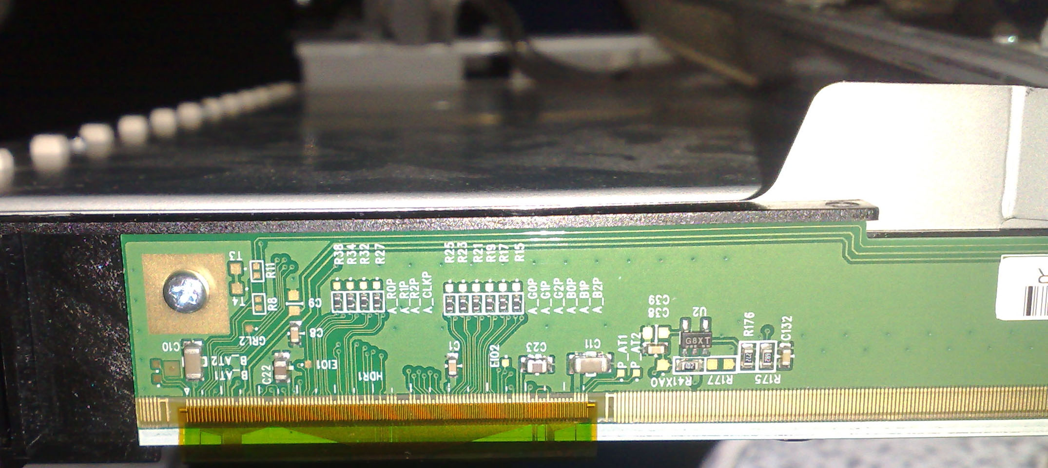

              After spending literally a couple of days on this ..... I've found out what the problem is...... NOTHING to do with the caps at all... After noticing that the picture seemed to "unfreeze" when the TV was physically moved, and reading John Preher's book, I stripped the TV down so that I could see the Flexible PCB cable that connects the driver board to the LCD screen.....
              When I touch my insulated screwdriver head off the left most FPCB cable the TV comes back on every time.
              The books say "there is no way to fix the FPCB cable". Is there anything at all I could do to hold the cable in place?
                It is a common fault with Samsung, but I've never heard of LG's with the issue. You can insert a spacer or piece of foam in between the metal and the flex. It works ~90% of the time so give it a shot.

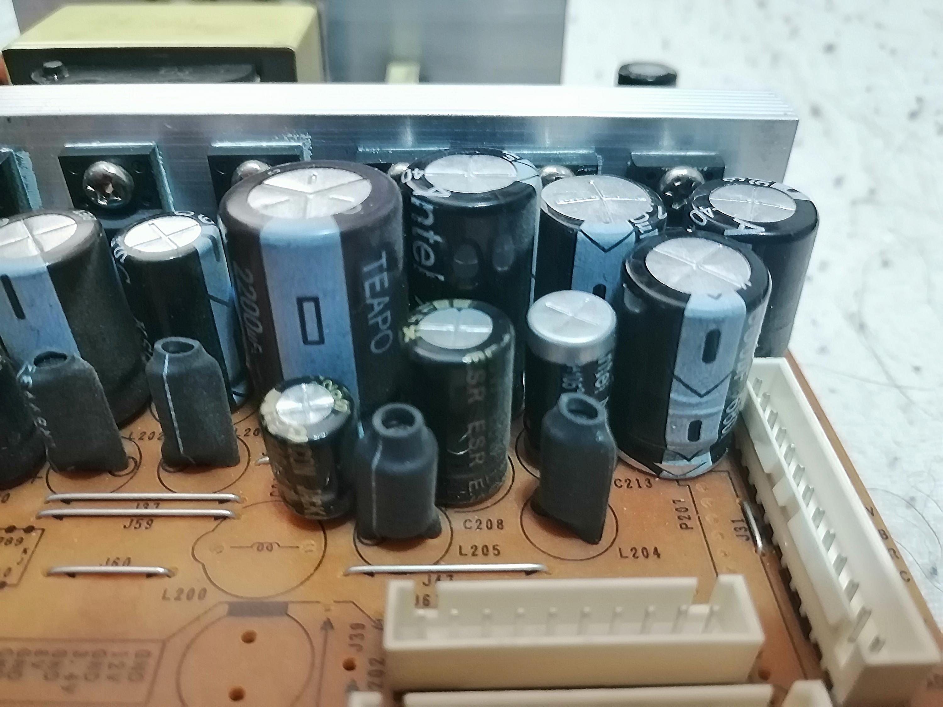

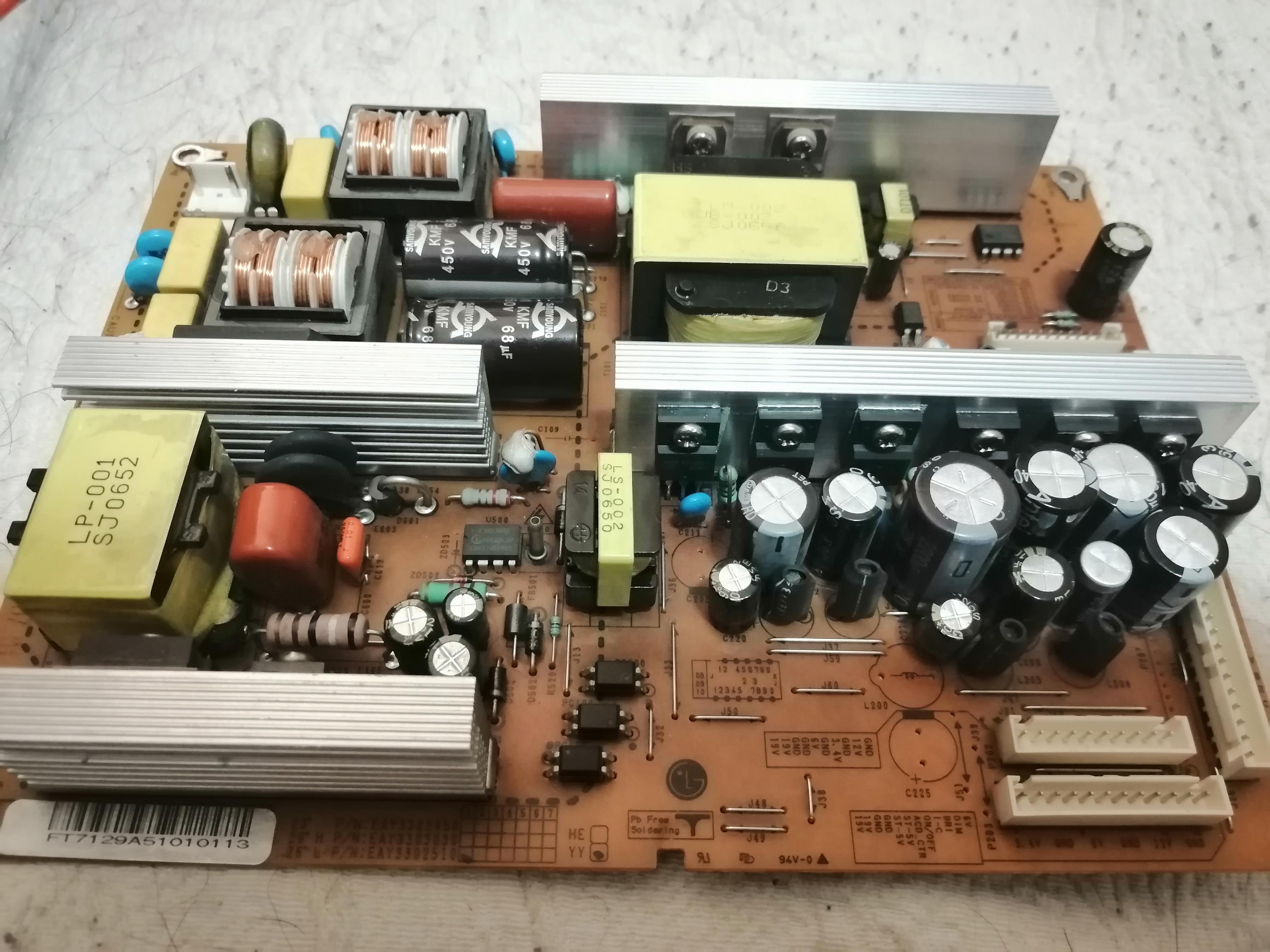

                        Does any one have the schematics or circuit diagram for the PSU of this TV?
                        The board its a part numb. EAX31845101/9 07.01.11 rev1.0
                        EAY33025101
                        Has can you see, some of the caps are boldgie a one of them almost explode!
                        The service Manual for this TV doesn't have all the capacitors description for replacement.
                        Can anyone help?
                        Thanks!
                          Capacitor info is written on the side of it, uf, voltage etc. you want to get low esr caps not general purpose.
                            Being 14 years old, I'd start with replacing the electrolytic capacitors on the powerboard, might be able to leave the 2 big filter caps and change the rest. Hard to tell which ones are good without the test meter/s or seeing obvious doming or something, they don't have to be domed to be bad. As always respect the HOT/DEADLY side of the powerboard, be careful what you touch.
                              I leave the list of the caps I retrive from pcb and their location:
                              C502 - 33uF 63V
                              C506 - 100uF 50V
                              C507 - 47uF 63V
                              C203 - 470uF 35V
                              C123 - 1uF 63V
                              C220 - 470uF 16V
                              C204 - 3300 uF 10V
                              C215 - 2200uF 16V
                              C212 - 2200uF 25V
                              C216 - 470uF 16V
                              C208 - 470uF 35V
                              C207 - 1000uF 35V
                              C213 - 470uF 25V
                              C221 - 680uF 35V
                              C223 - 680uF 35V
                              C222 - 680uF 35V
                              can anyone validate this?
